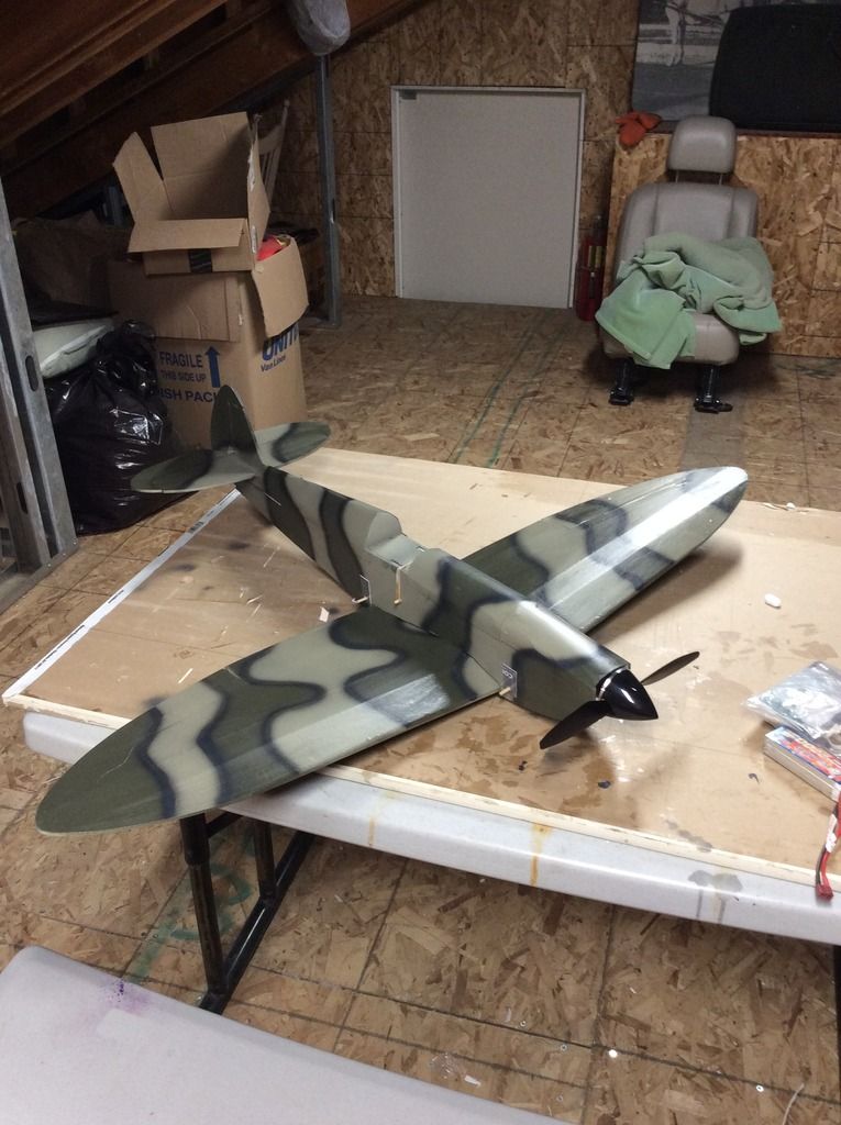

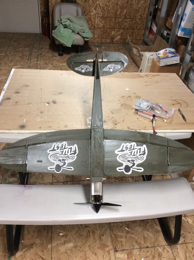

So the Spit is almost ready for the maiden flight test. It came in at 515g w/o battery, I am going to use my 2200mah and that is another 185G but balances out well. I still need to dial in my throws and hope for a decent day this upcoming weekend.

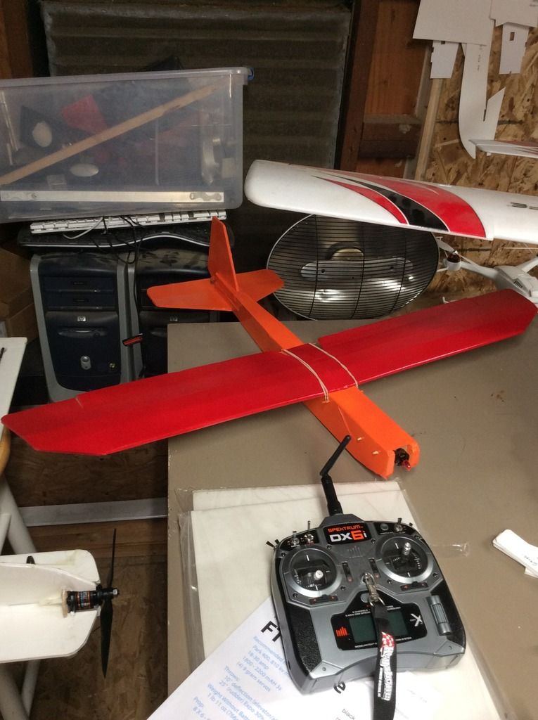

Got the tiny trainer 4ch ready and prettied up for its re-maiden now that the expos are set the right direction.

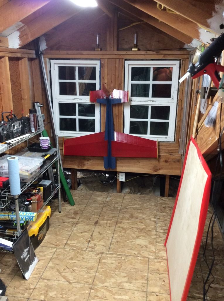

I also have my built up Edge 540.1 ready for gear but I'll wait till I get better with my regular 540.
