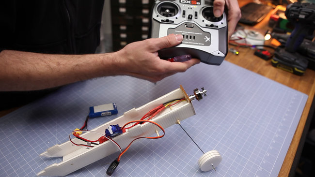

We've shown you how to build all sorts of aircraft but we've never really gone into details on the basic setup of connecting the electrics into your scratch built electric airplanes.
This specific overview is to help you with your Flite Test Speed Build Kits.
A list of the components used in this video are available here.

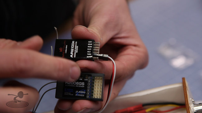

Be sure to read through the user manual of your specific radio and receiver because each one may have a different procedure.

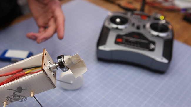

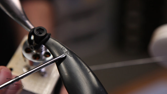

As a safety tip, use tape in place of the propeller to avoid any accidents where the motor may turn on. To be sure you have the prop on correctly, a simple check would be to see that the motor should be turning counter-clock wise.
When you have the motor running in the correct direction, and it's time to install the prop, prop savers are a great way to offer some more safety and give you longer life out of your props. To be sure the prop is facing the correct direction, the numbers should be visible on the front.
