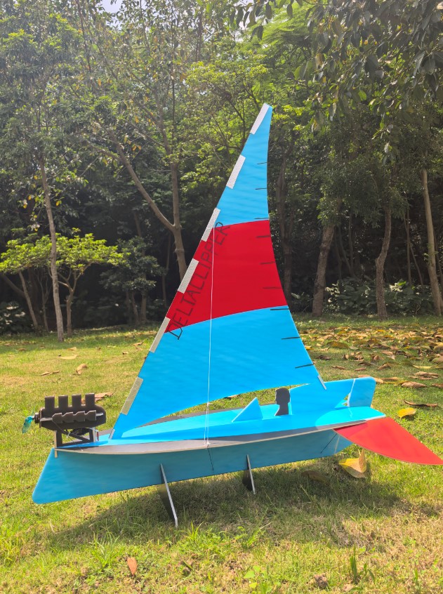

This is a Crazy Mad Aerobatic Flying Ship.Flies Very Smooth.
这个是机动性好的离谱的飞行帆船。操纵手感非常顺滑。
it will never stall, never wing rock,ultra stable and high manuever.
永不失速,大攻角不会晃动,兼顾稳定和机动性。
Add some magic to aerodynamic so a sail ship can fly.
仿佛给空气动力学加了点魔法。
Huge sail makes big lift at turn, and low aspect ratio ship like wing makes very high stall aoa.
巨大的侧面积在侧飞时升力很大,转弯不掉高;船型的小展弦比机翼失速攻角很大。
weight<300g
span 550mm
length 930mm
AM40 motor with T/W ratio>2
Only rudder and elevator,3CH is enough.
仅方向舵和升降舵,3通道遥控。
建议配置:AM40电机,9克舵机,3S500电池,KT板要用热板,重量控制到300g以下最好。
