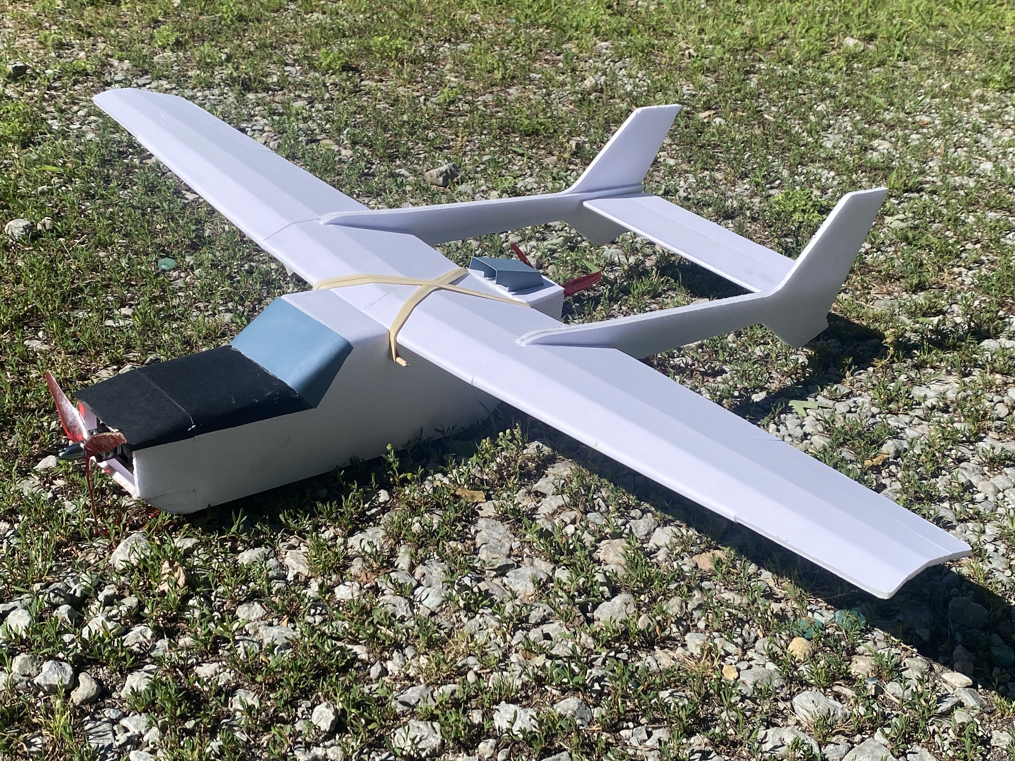

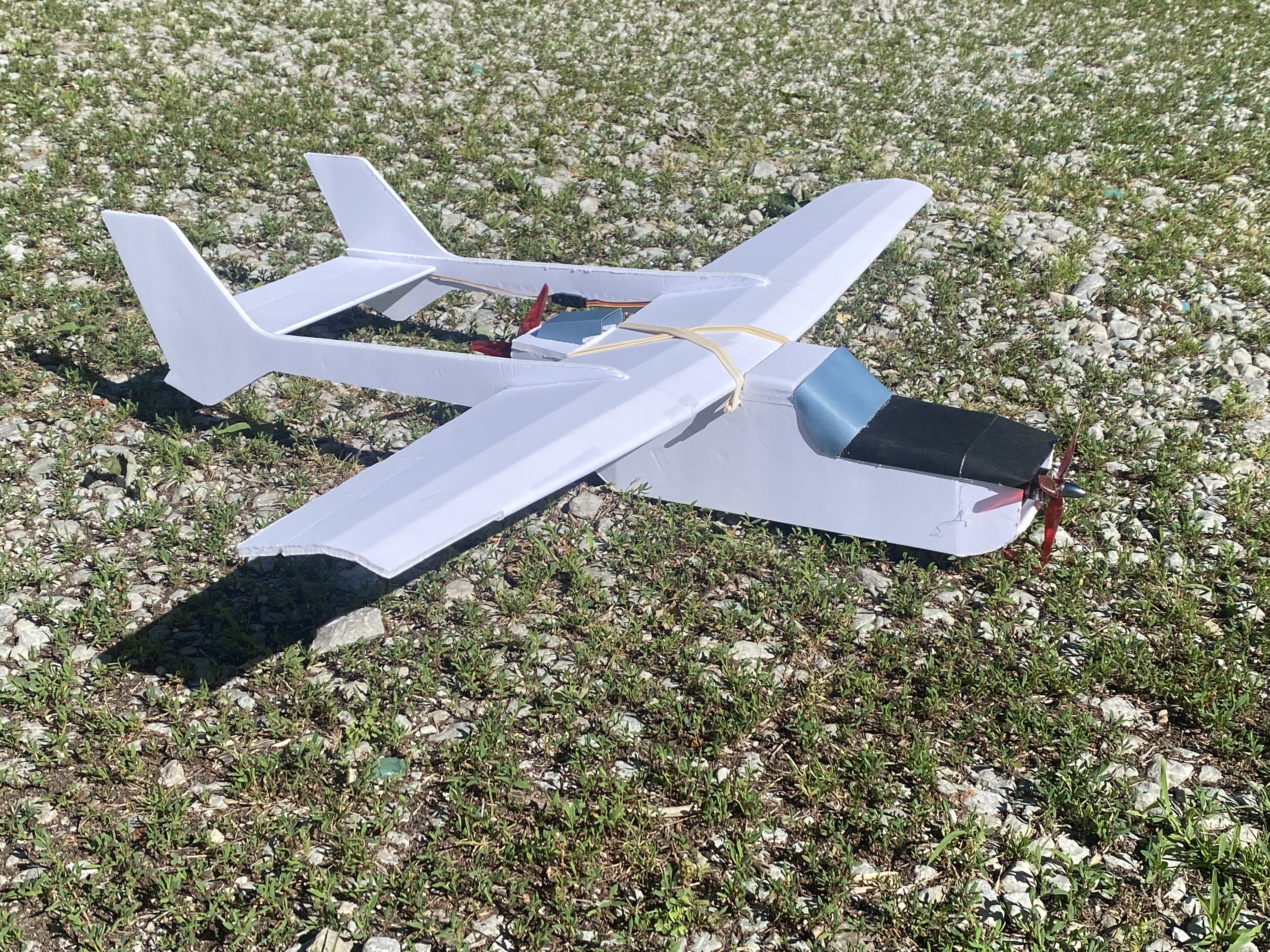

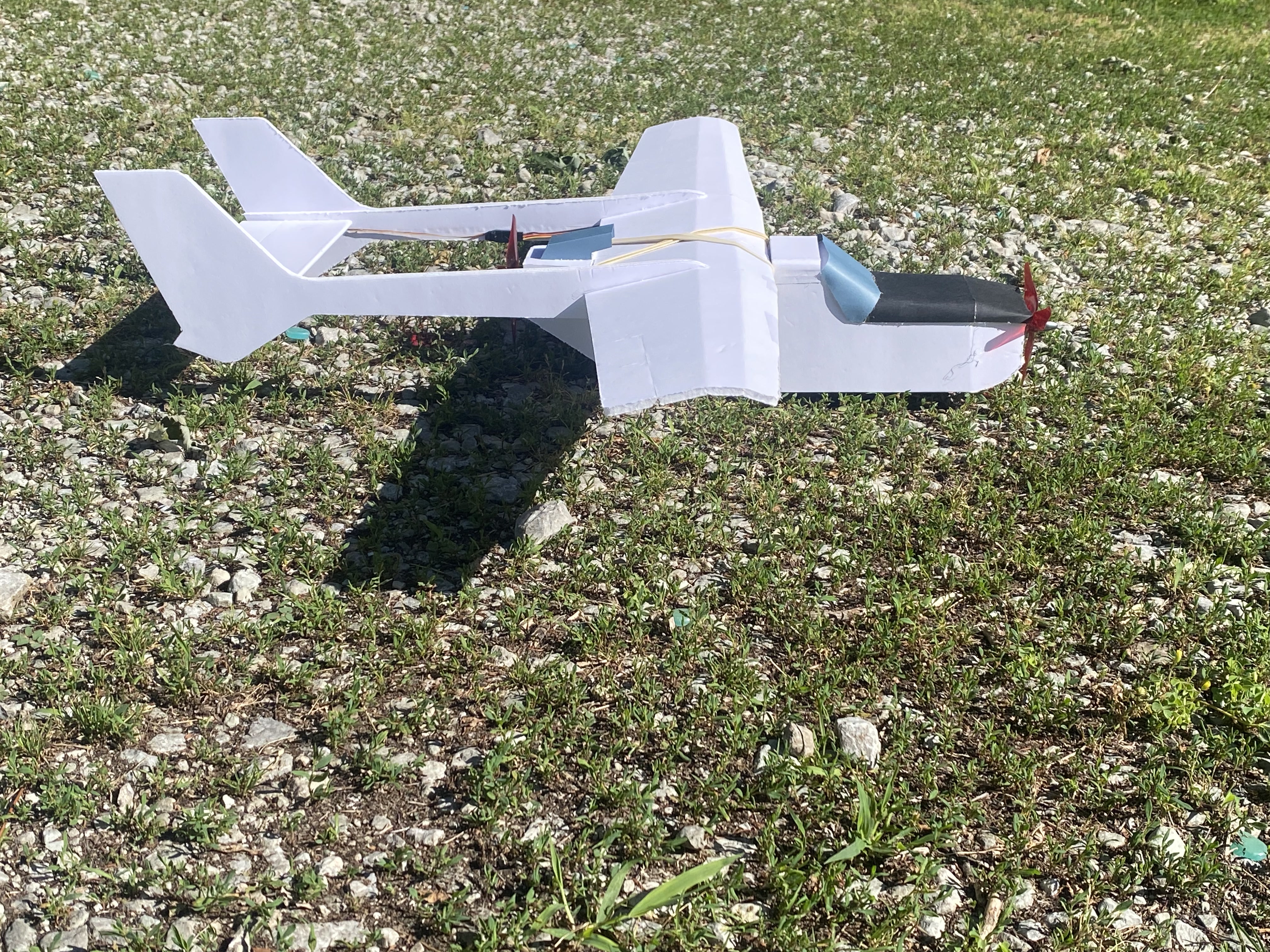

Versions 1 and 2 had their problems. A little twitchy, small battery compartment and the booms were fragile. In V3 I have:
  • Increased the size overall to 110% of the original
  • Put in a larger battery space
  • Increased the boom size and V stabs
  • Added an extra layer of fb to the spar for a higher aspect airfoil
  • Most importantly added 5mm carbon fiber tube to the booms
The changes make all the difference in how it flies. And still on three sheets of foam board!
AUW: 450grams (with 1300 3s battery)
to
AUW: 496grams (with 1300 3s battery)
so about a 10% increase.
All the changes:
5mm cf in the booms
Booms taller and larger V stab
Battery tray lowered for more room
