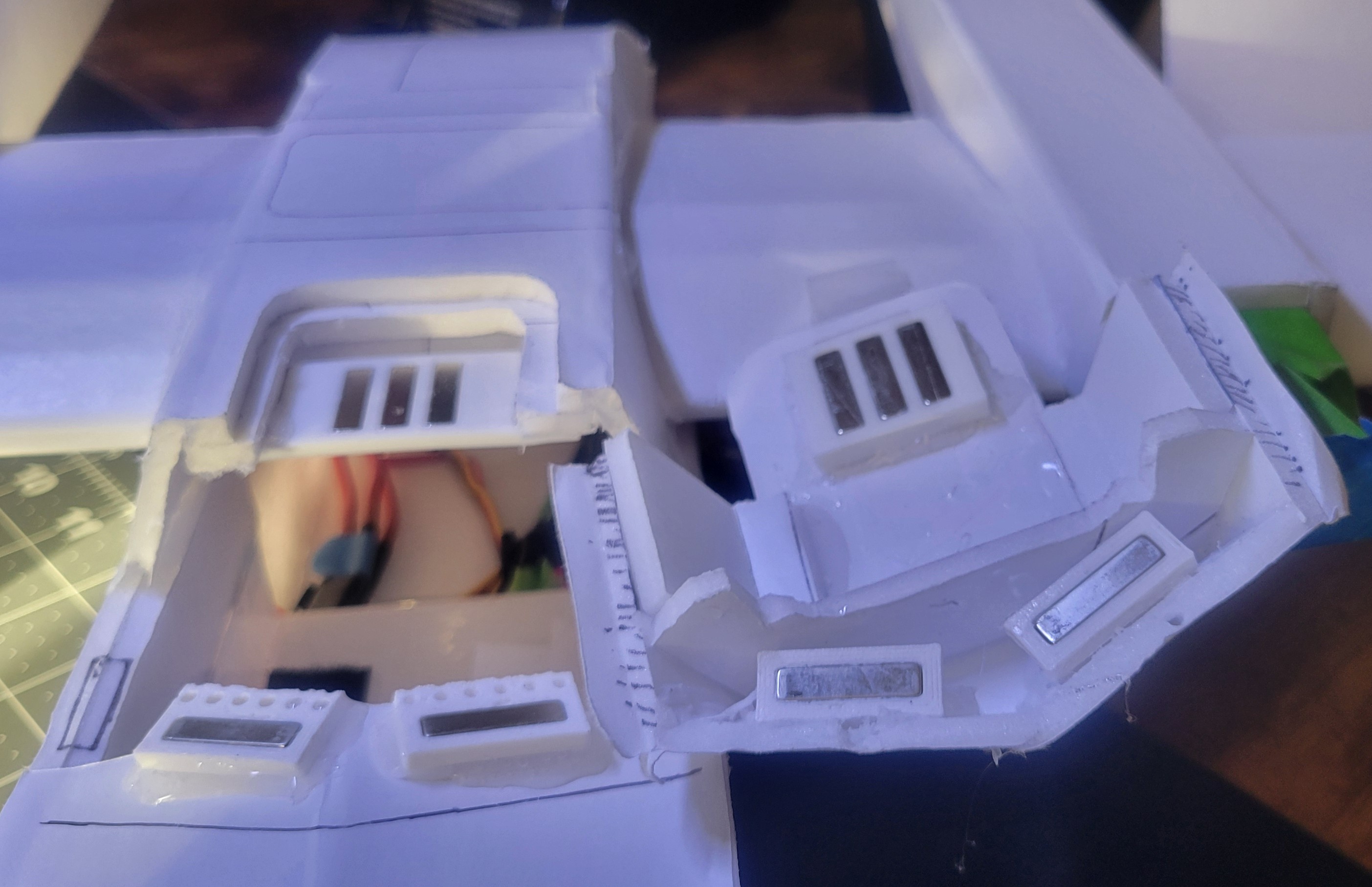

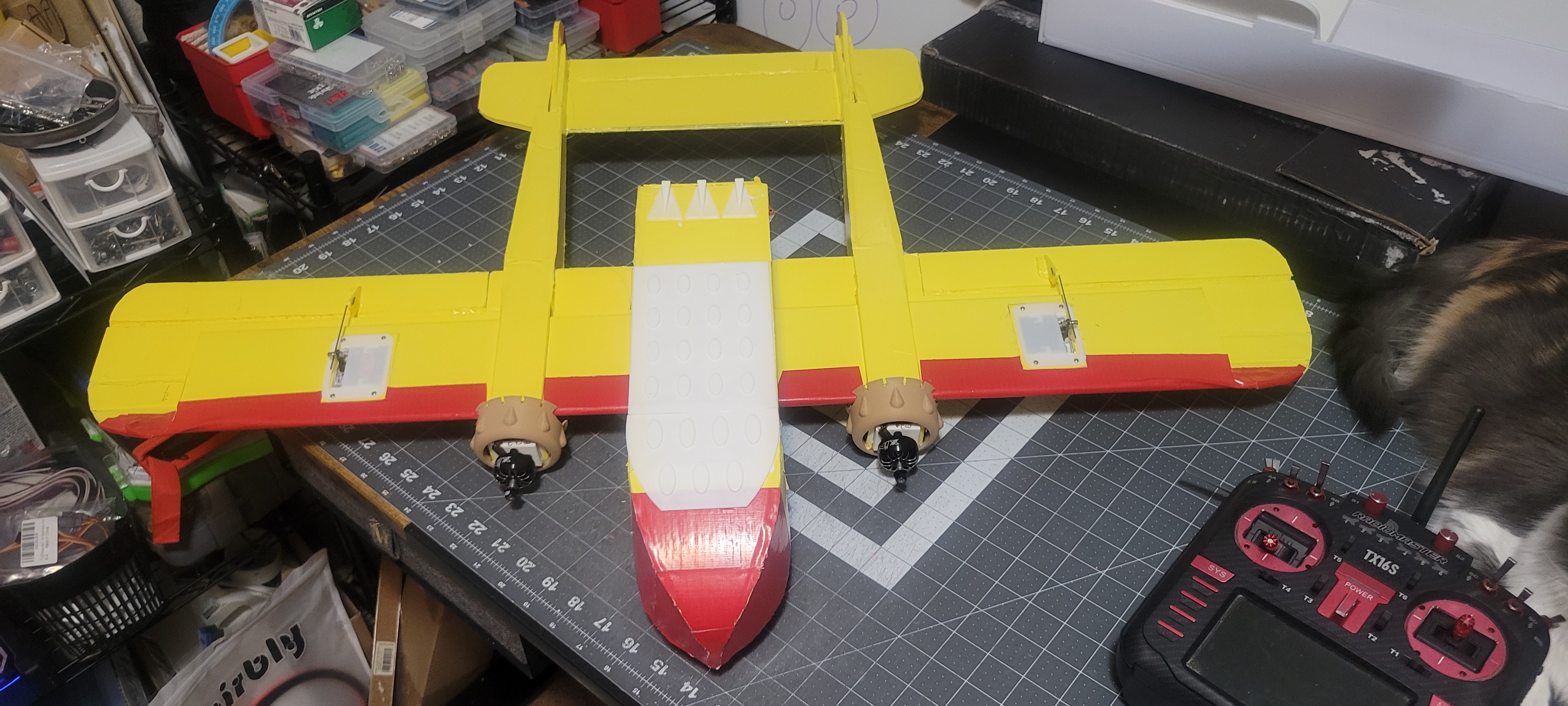

These are some 3d printed files that I made for @Horseman3381 Mighty Mini sea duck. https://forum.flitetest.com/index.php?threads/mighty-mini-sea-duck.74418/ The Cowling was not made by me, but shared on Thingiverse. https://www.thingiverse.com/thing:3925766 I printed x and y at 69%, and z at 67% for a real nice fit on the Mini. I would print the firewall in petg or something stronger than pla. I also use 20x5x2 magnets on the hatch.
