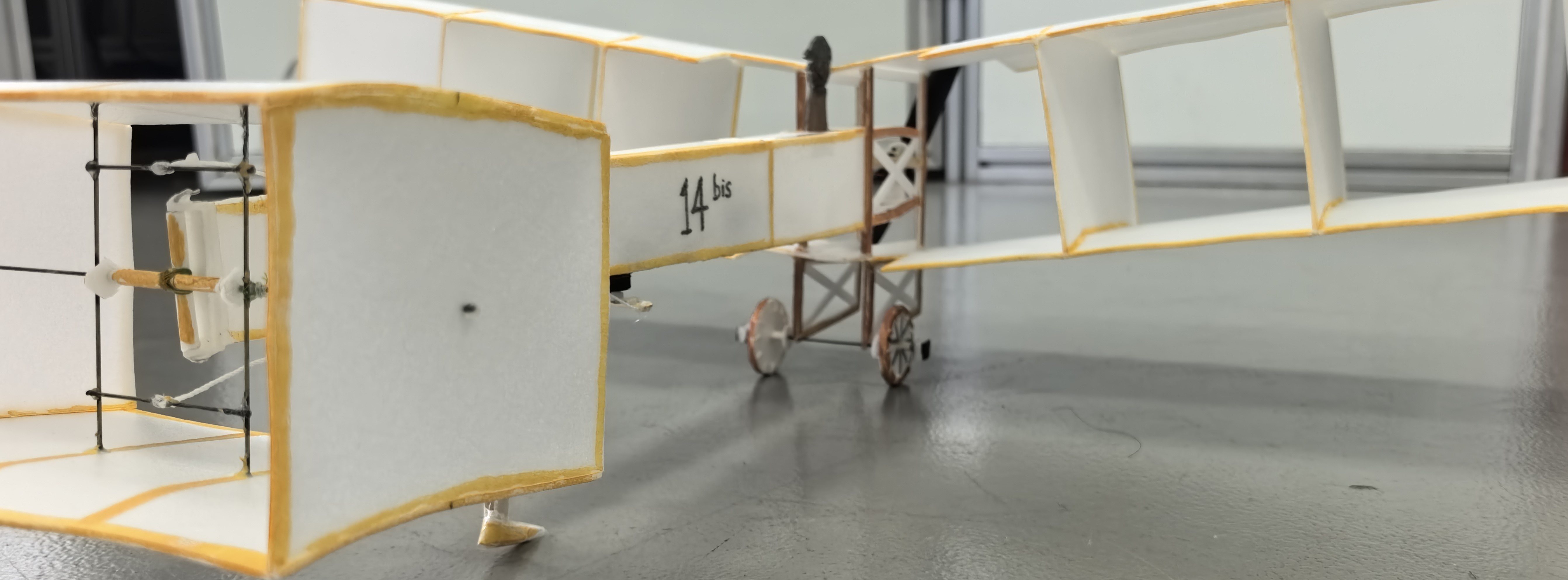

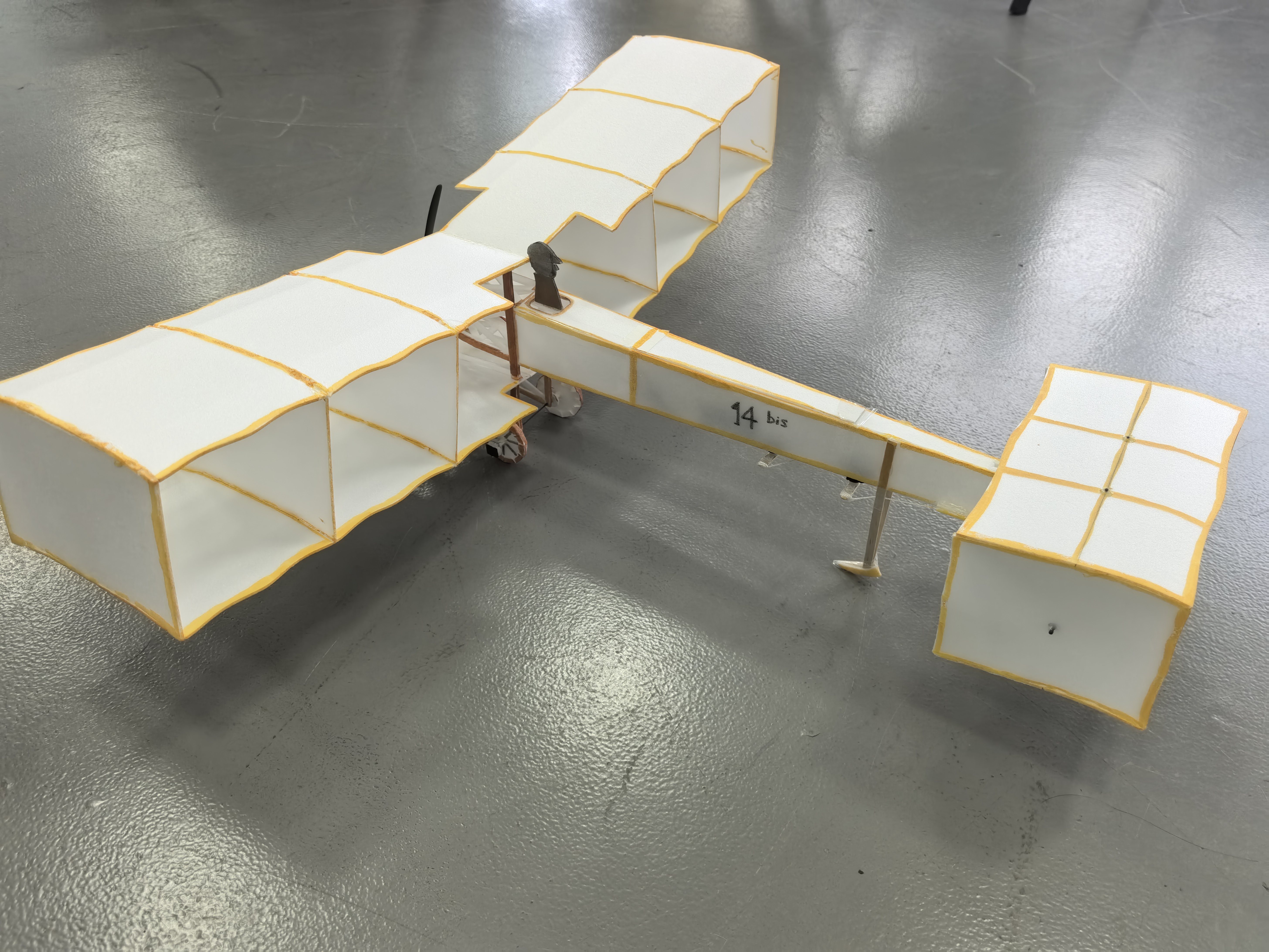

span 650mm;
take off weight 67g;
720~8520 motor,4~5inch propeller, 1s 300mah bat,2 * 2g servo.
Laser cutting 2mm epp or depron board, use coffee wood stick to make wing support struct and front landing gear.
Canard center point is about 10deg pitch angle, wing is about 4deg attached angle.
Warning:
Not very stable,some dutch roll when controlling rudder.
Not easy to built because rudder and elevator use a two axis hinge.
Upper wing and lower wing art not the same, Do not mixing them.Do not mixing leading edge and rear edge!
