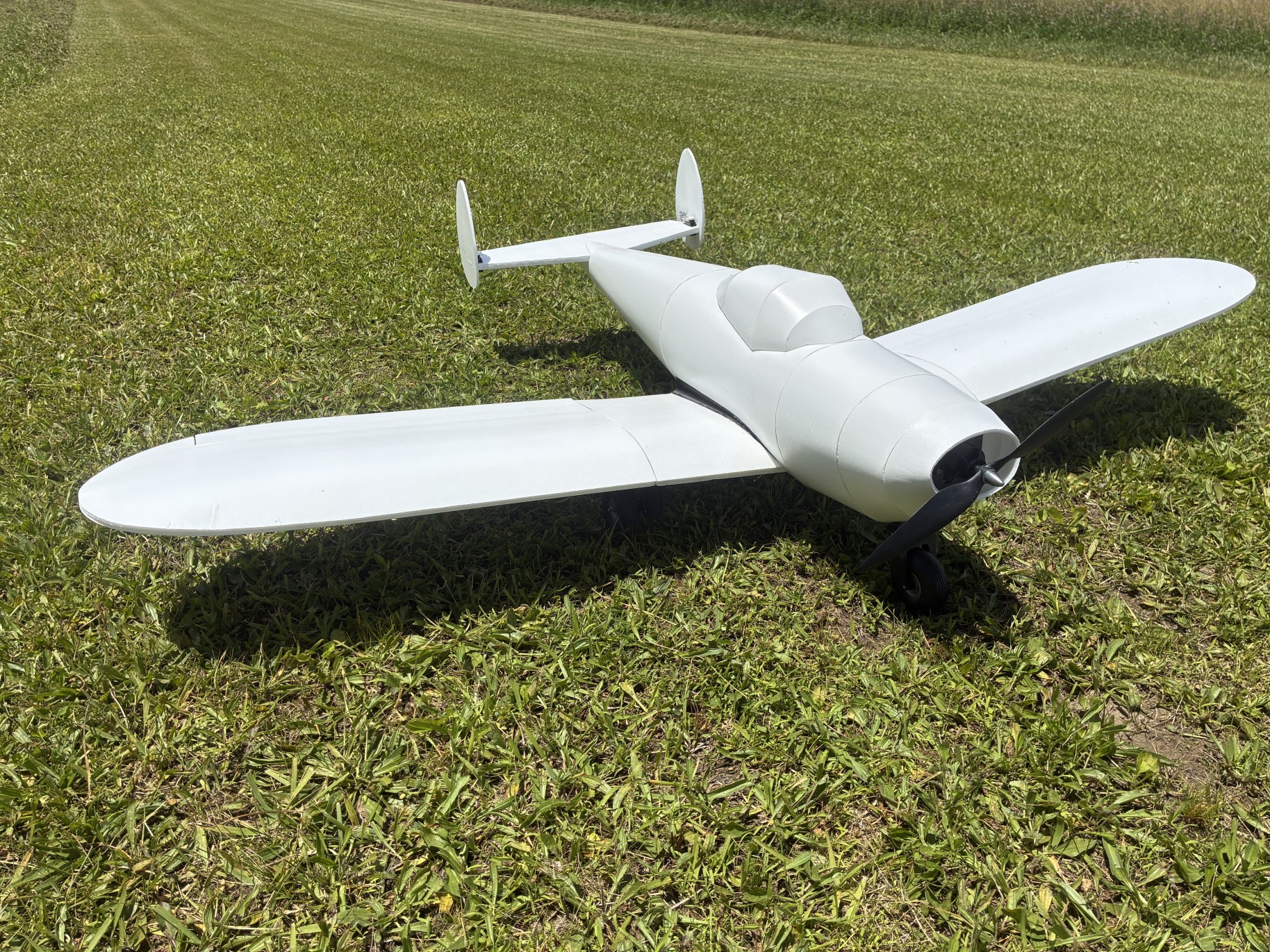

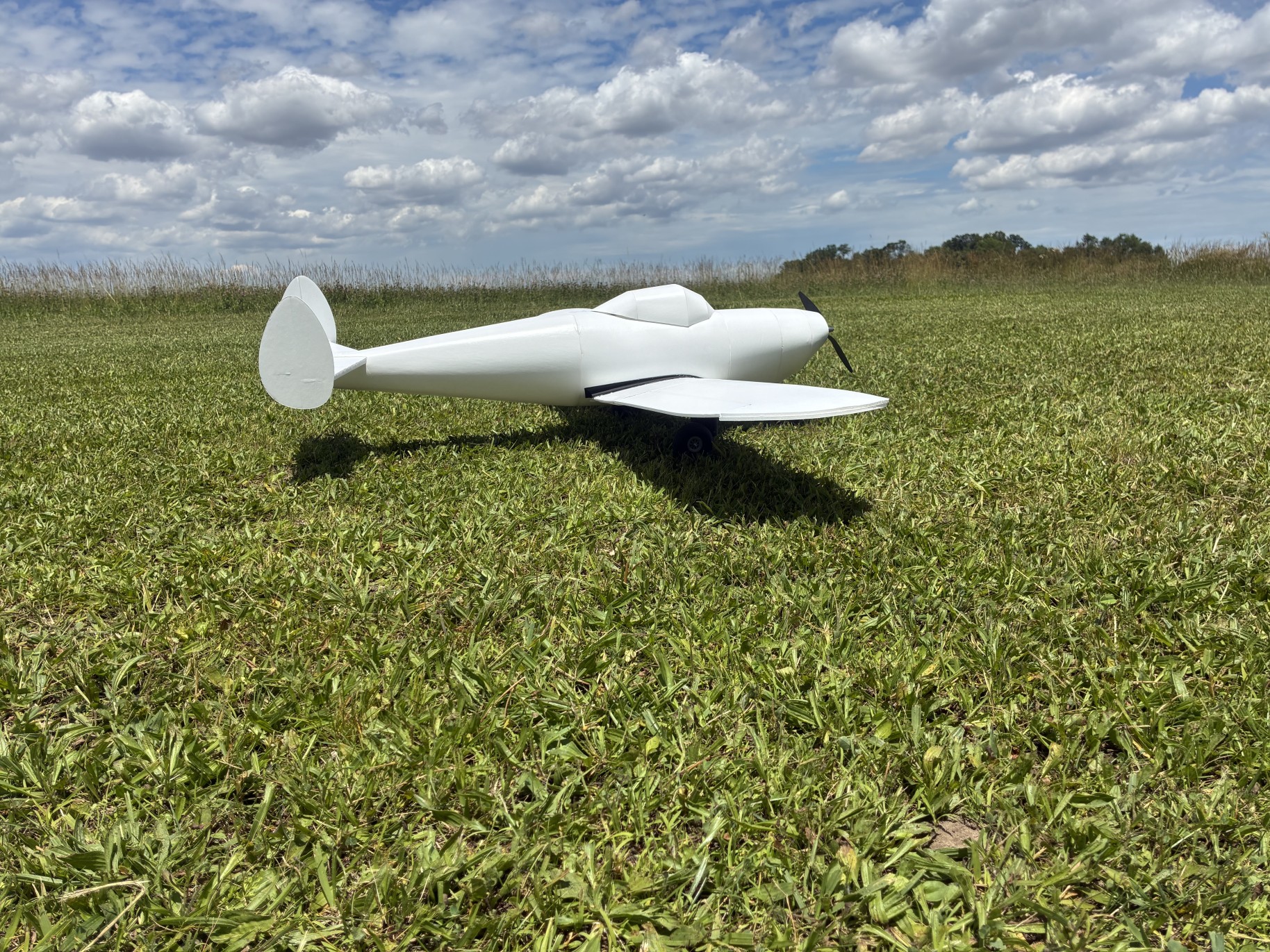

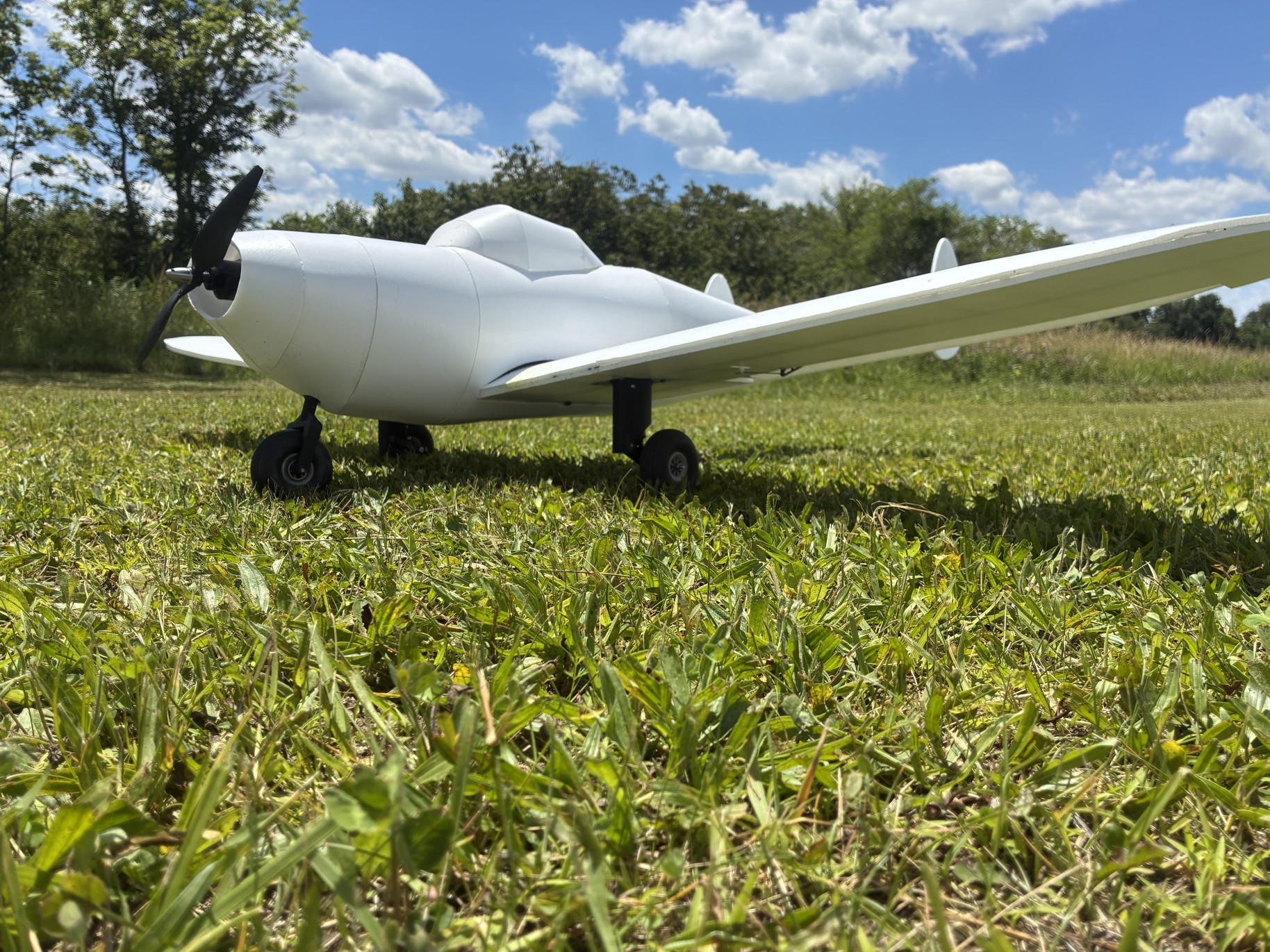

Our Rendition on an master series style Ercoupe. Been over a year in the making with V1 going to flite fest last year. This plane is really fun to fly but way more fun to land. I designed fully suspended gear nose and main so it rides like a Cadillac which makes for some very satisfying landings. The wings are designed to come of just like the original. V2 Unlike V1 has just a slider to lock the wings in instead of 4 bolts that you had to screw out. Any questions can be answered in the forum. There is also a whole bunch of photos of the build process if you want to make your own. I will have the cad for the whole project available on onshape if you need any help for the build as well. I would recommend not building this unless you have a 3d printer and a erc or laser cutter. You can hand cut it but there are many complex parts that would not be easy to make.
