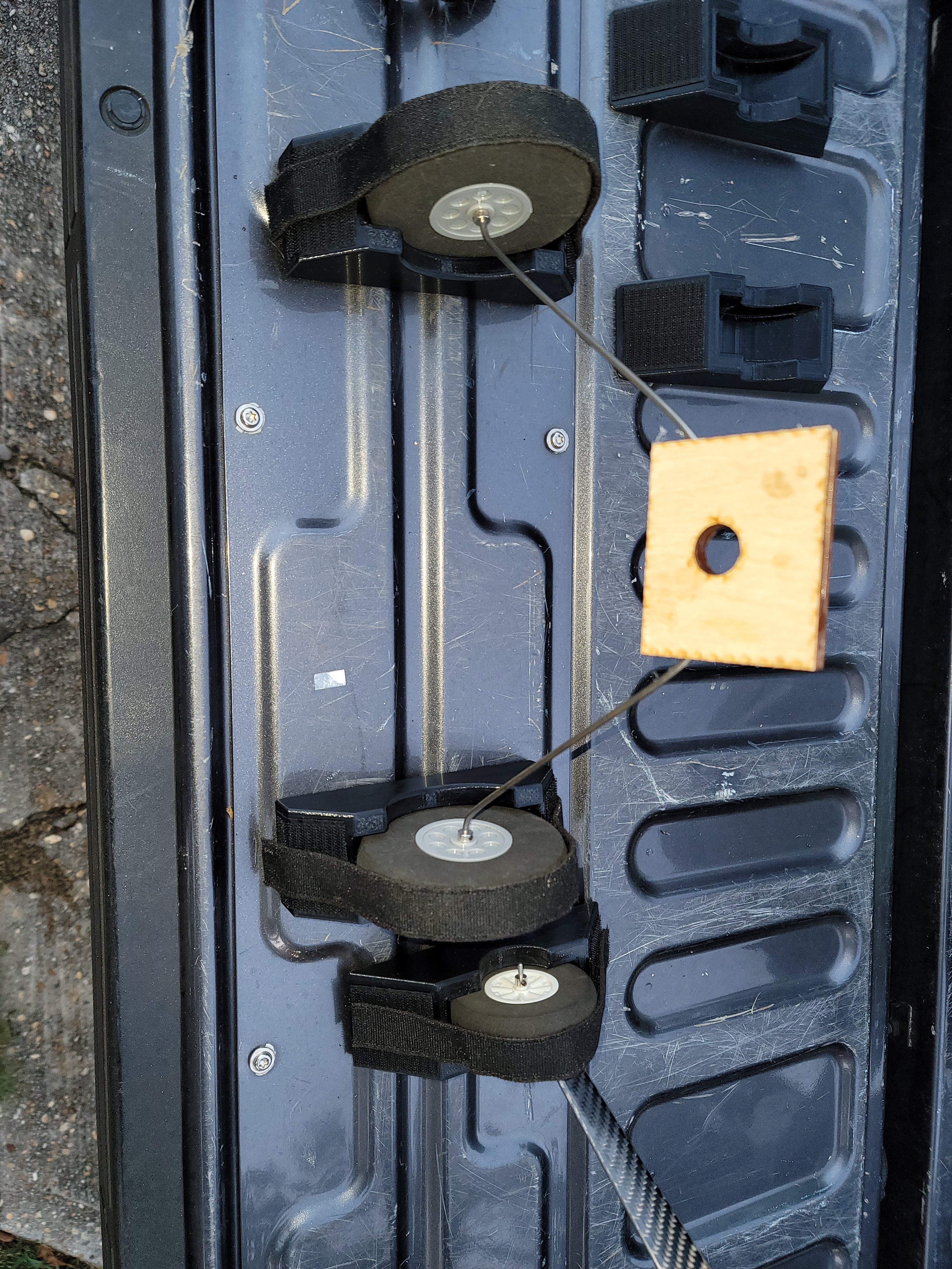

I've gotten tired of just taking my chances with larger models in the back of the truck so I have started this side quest to hold them down properly.
This first set is for the tires that come with the XL planes.
  • You will need magnets such as these for mounting. magnets
  • I made mine from PETG, but you can pick what you think is suitable
  • Use enough infill that the screw holes don't break free. I found 30% works well.
  • If your slicer allows, exclude the screw holes from support material
  • Add Velcro as desired to hold wheels in the chocks
