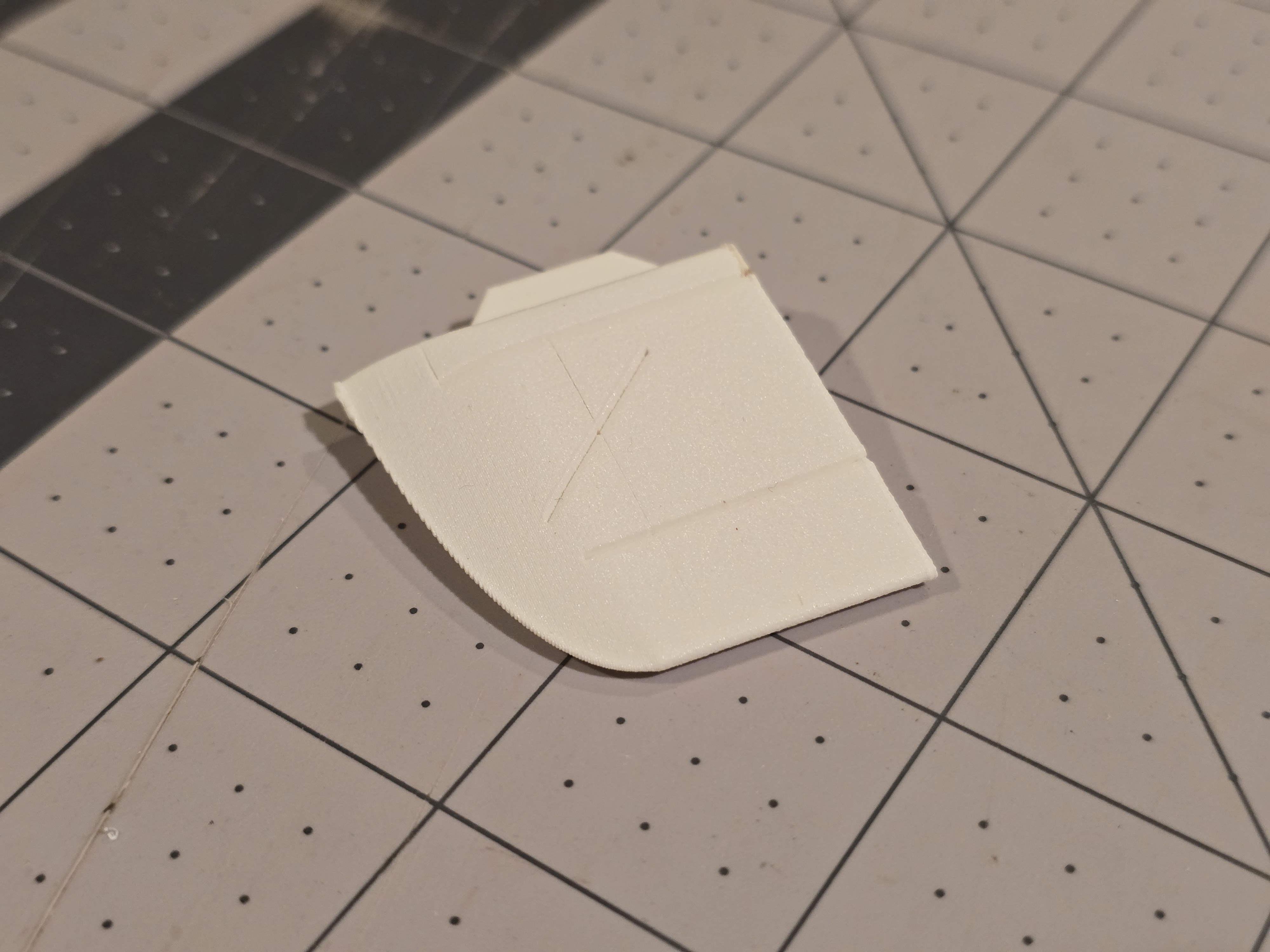

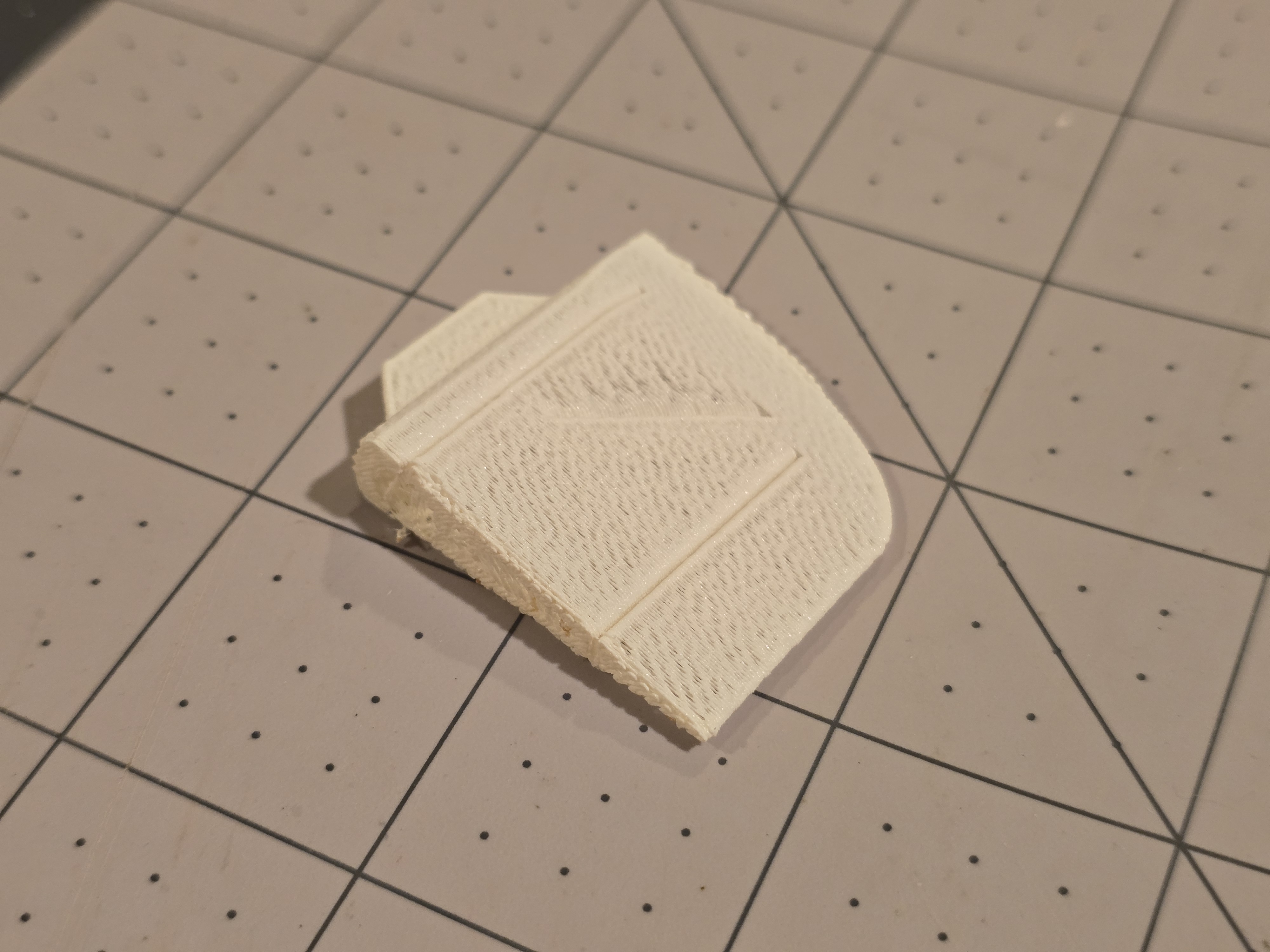

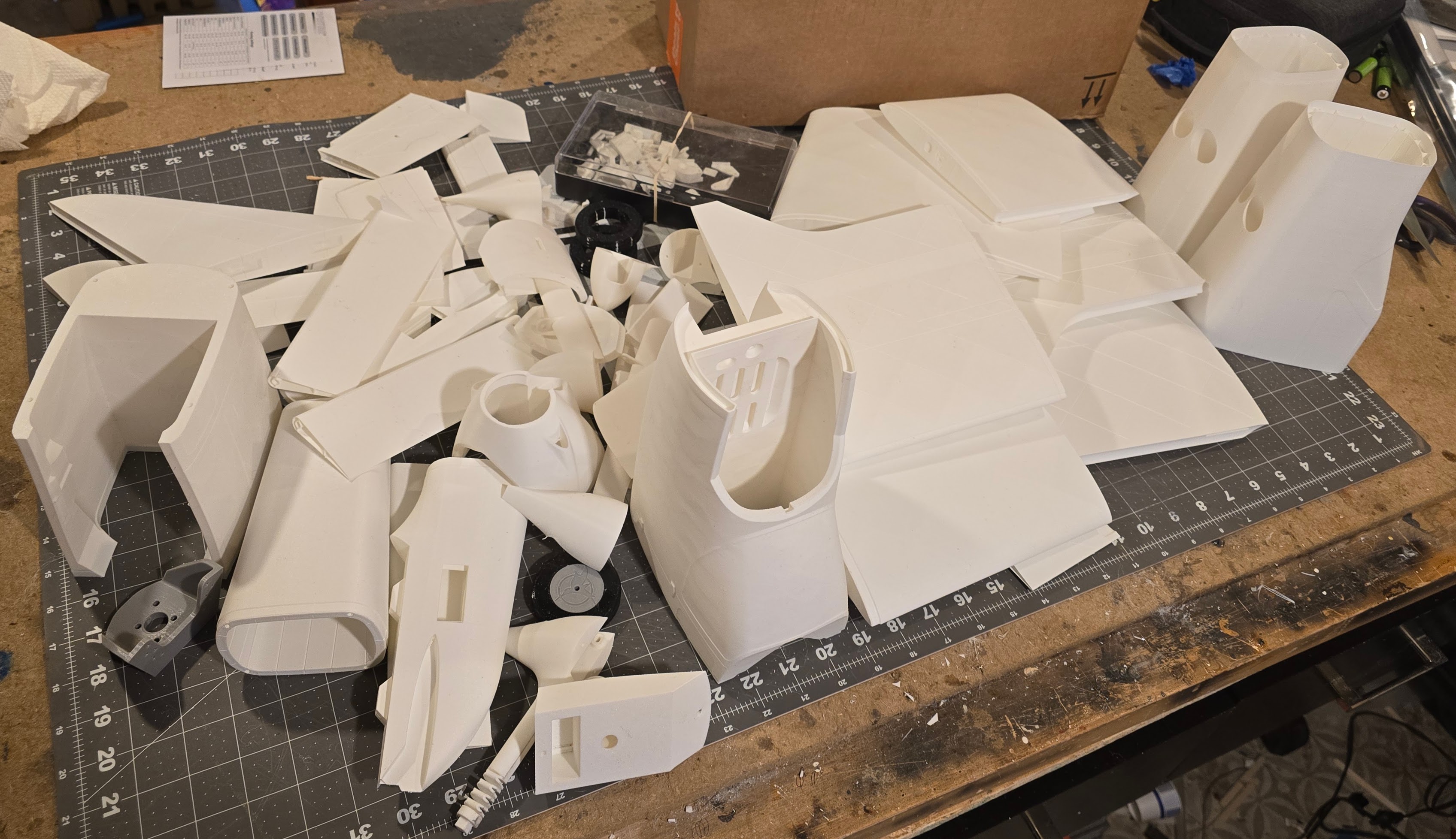

I am using Overture PLA Air, which is a pre-foamed LW-PLA. Having absolutely zero knowledge of printing with this stuff, I loaded Eclipson's 3mf file and hit print. Completely expecting to get an unusable part, but it would at least give me a baseline.
I cannot believe this part can even hold its shape :LOL: It felt like a sponge! But I have a baseline to work from.
Make adjustment, print test, and repeat... It only took 3 or 4 tries to get it pretty well dialed in. Time for some bigger parts.

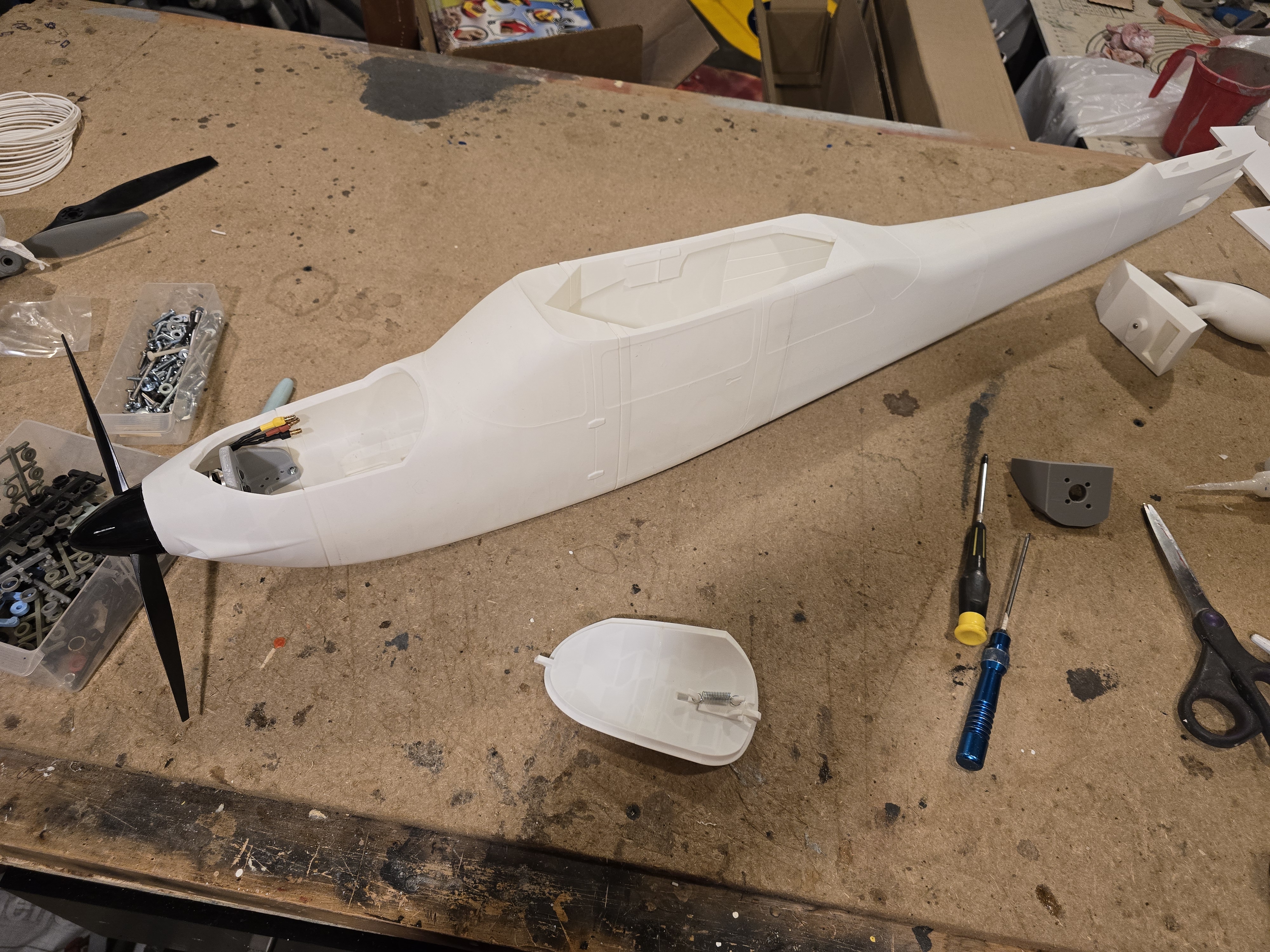

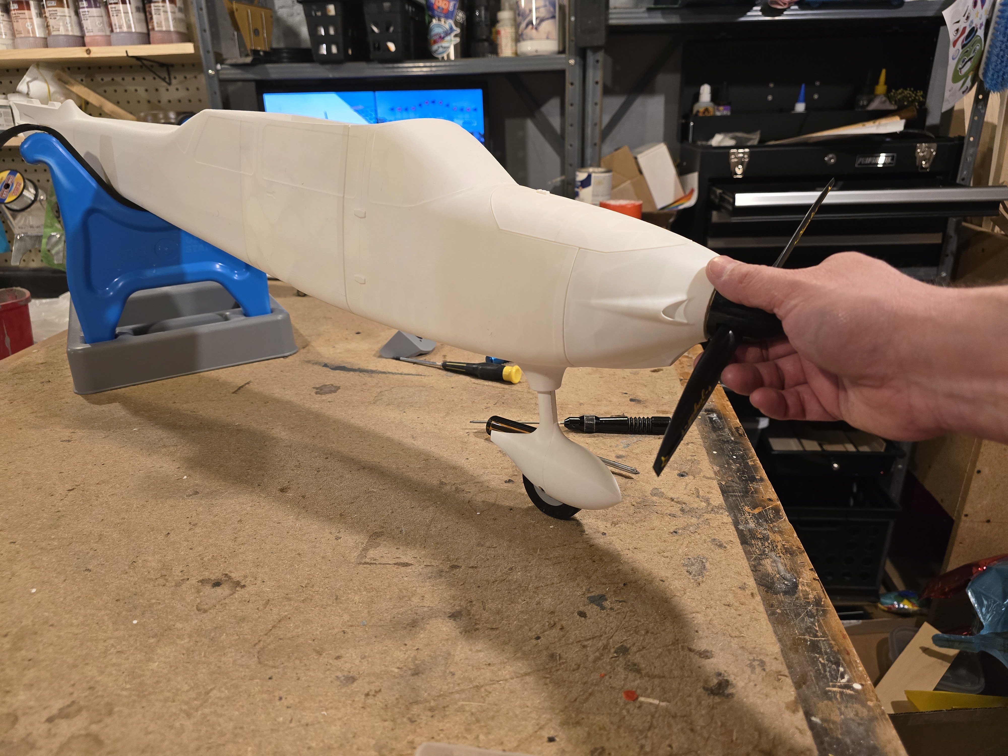

Fuse is done.
Nothing too exciting here. Went together super quick with really no issues. But I did make a few modifications.

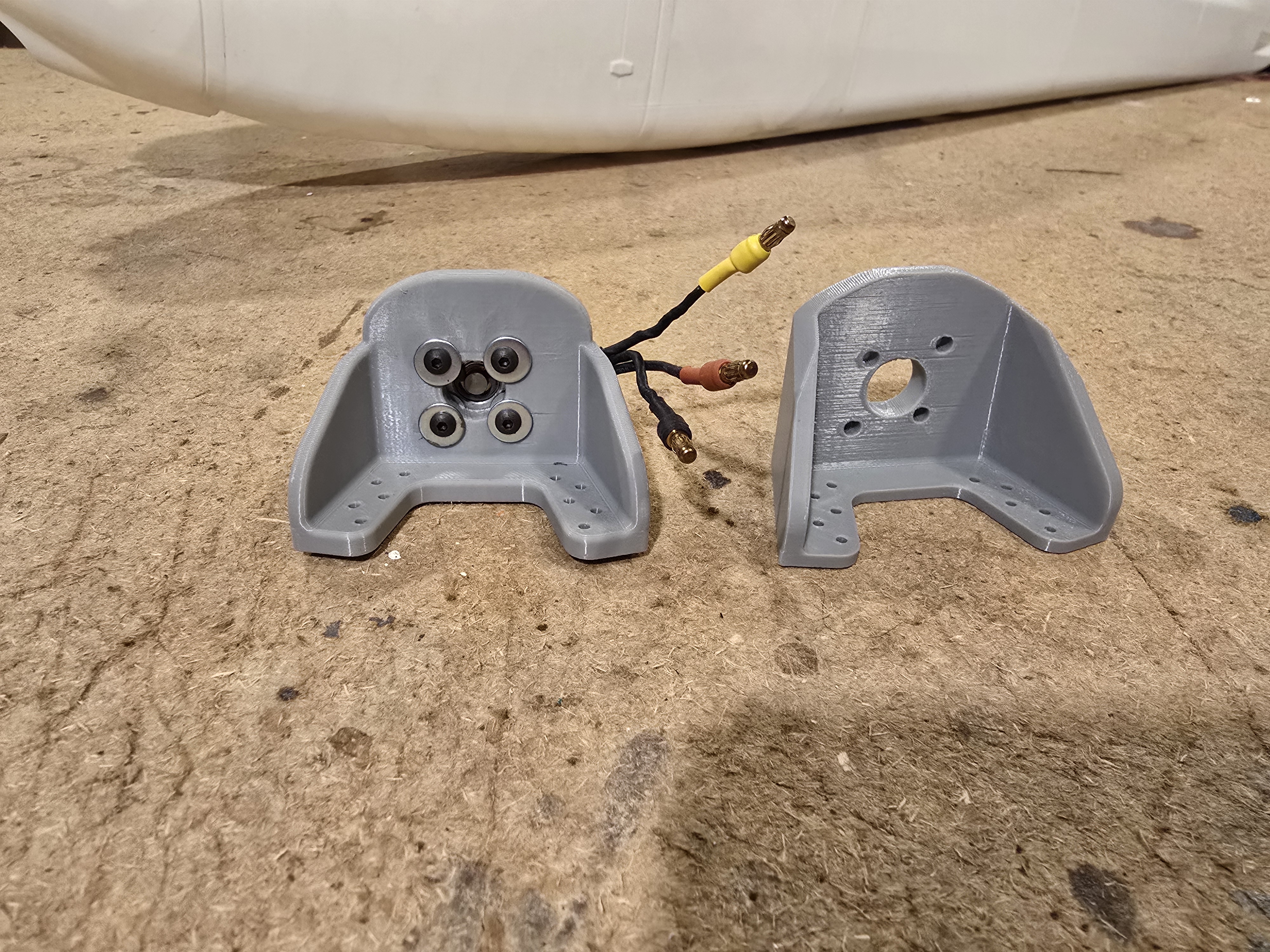

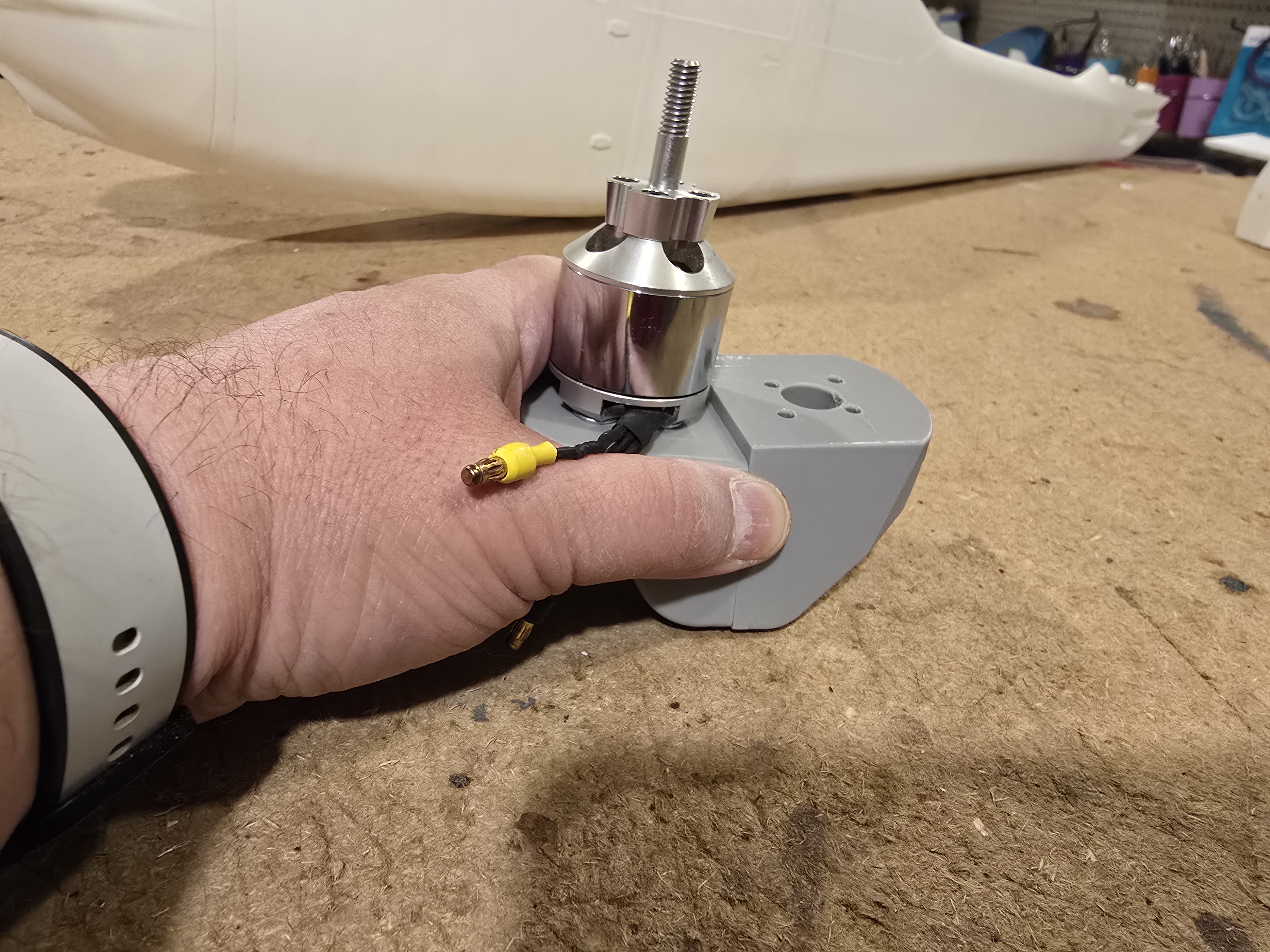

First thing I adjusted was the motor mount. Nothing wrong with the Eclipson mount, but my motor had a different bolt pattern and was a little longer than what they designed for. I did a quick redesign in Fusion and now everything lines up the way it should.

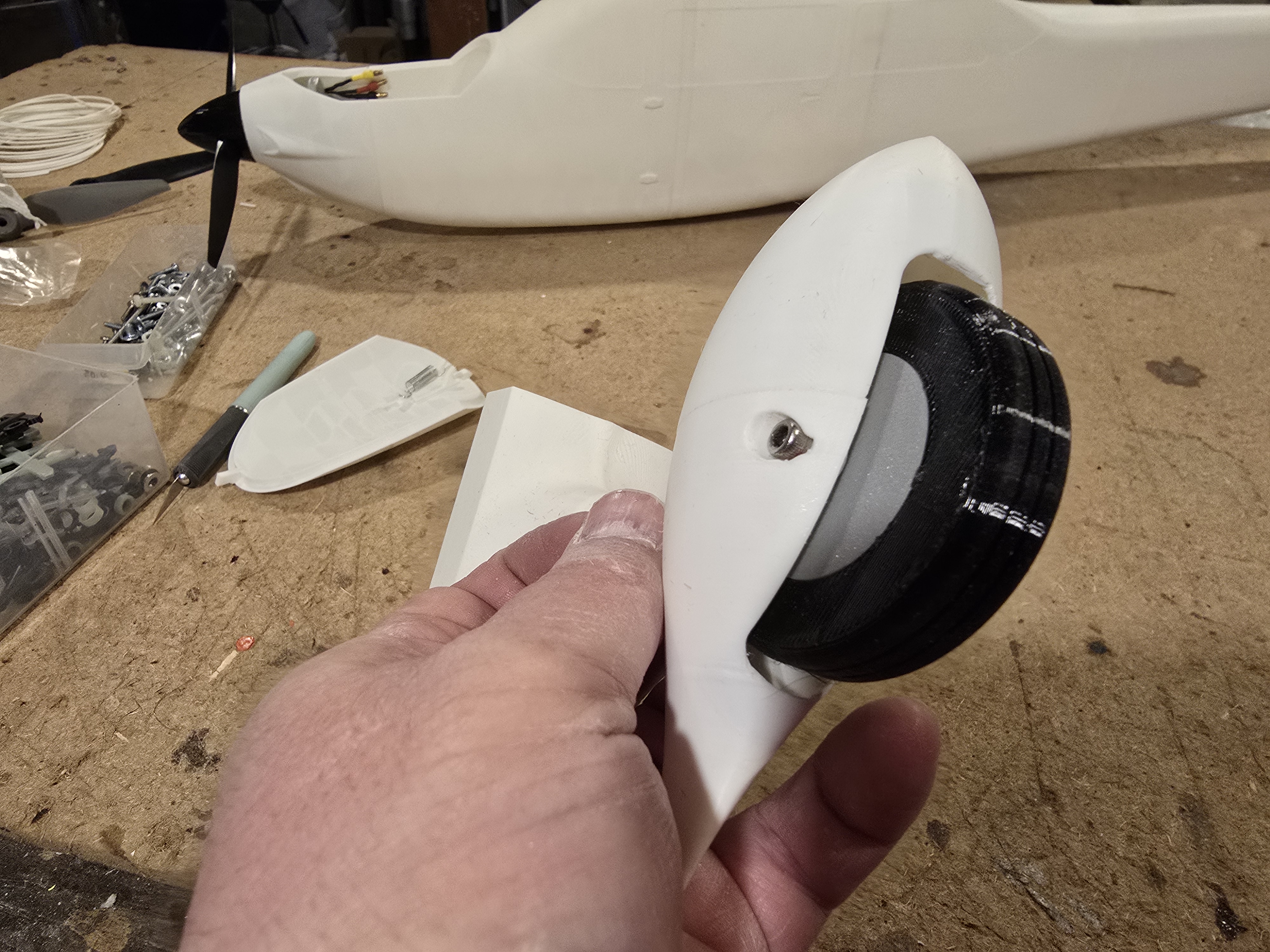

Next was the wheel axles. Instead of using a piece of metal rod and some sort of keeper, I tapped the holes in the wheel pants for a 6-32 socket head bolt, then drilled out the wheel hubs for proper clearance.

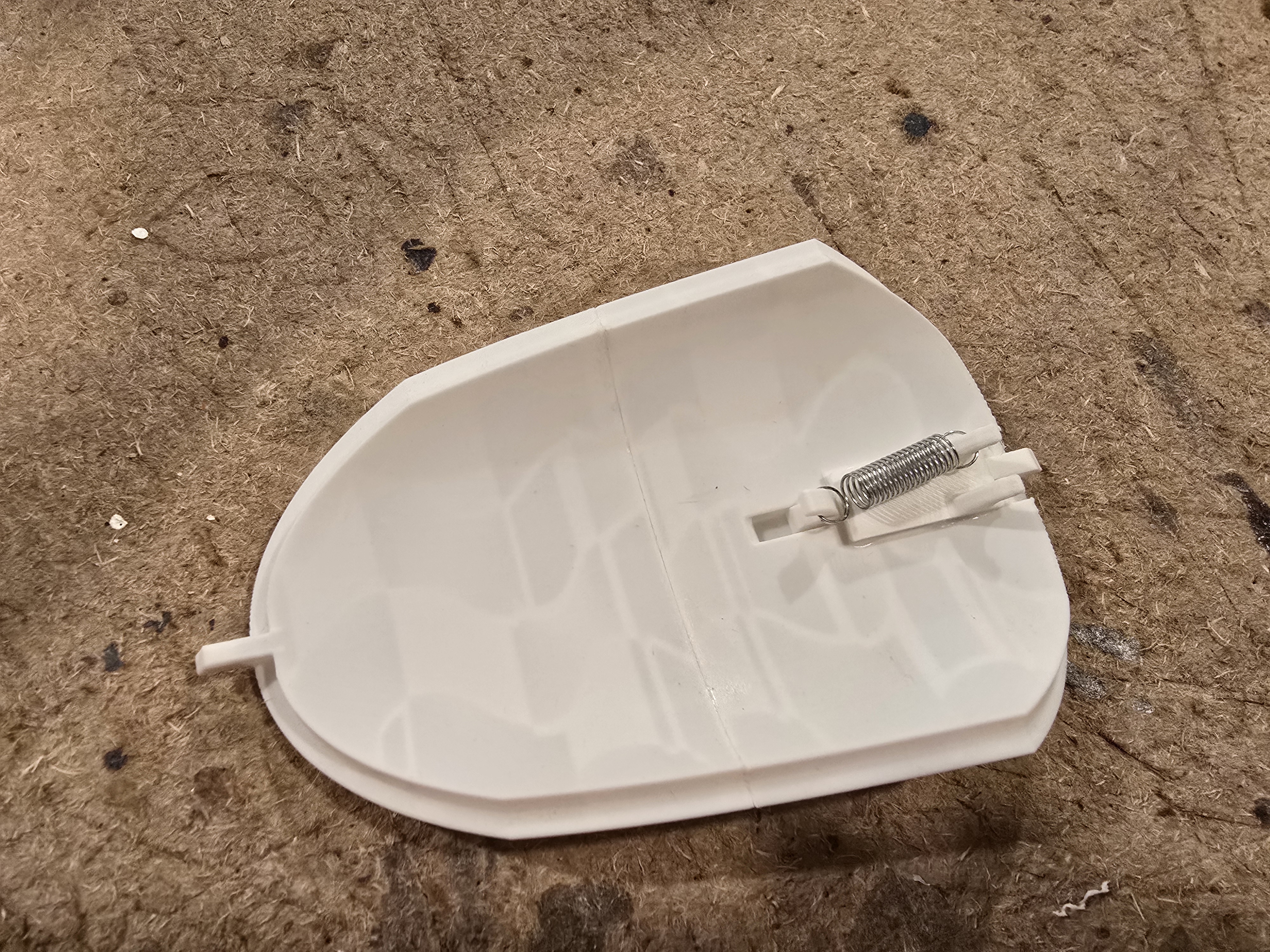

The last change was to swap out the rubber band specified for the hatch latch with a small spring. Again, their design is fine, but I have bad luck with rubber bands breaking at the most inopportune times. Springs are far less likely to break.

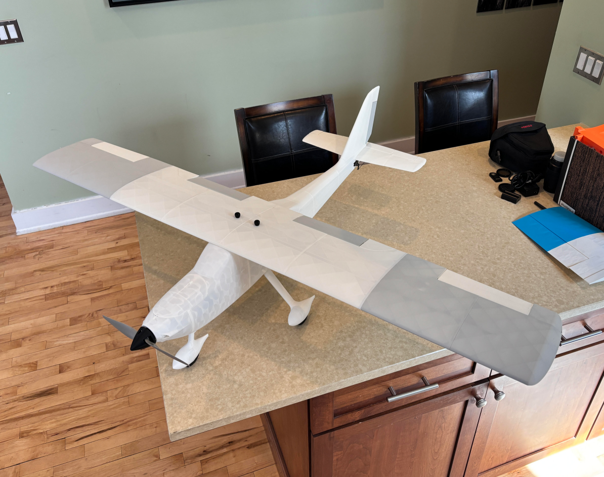

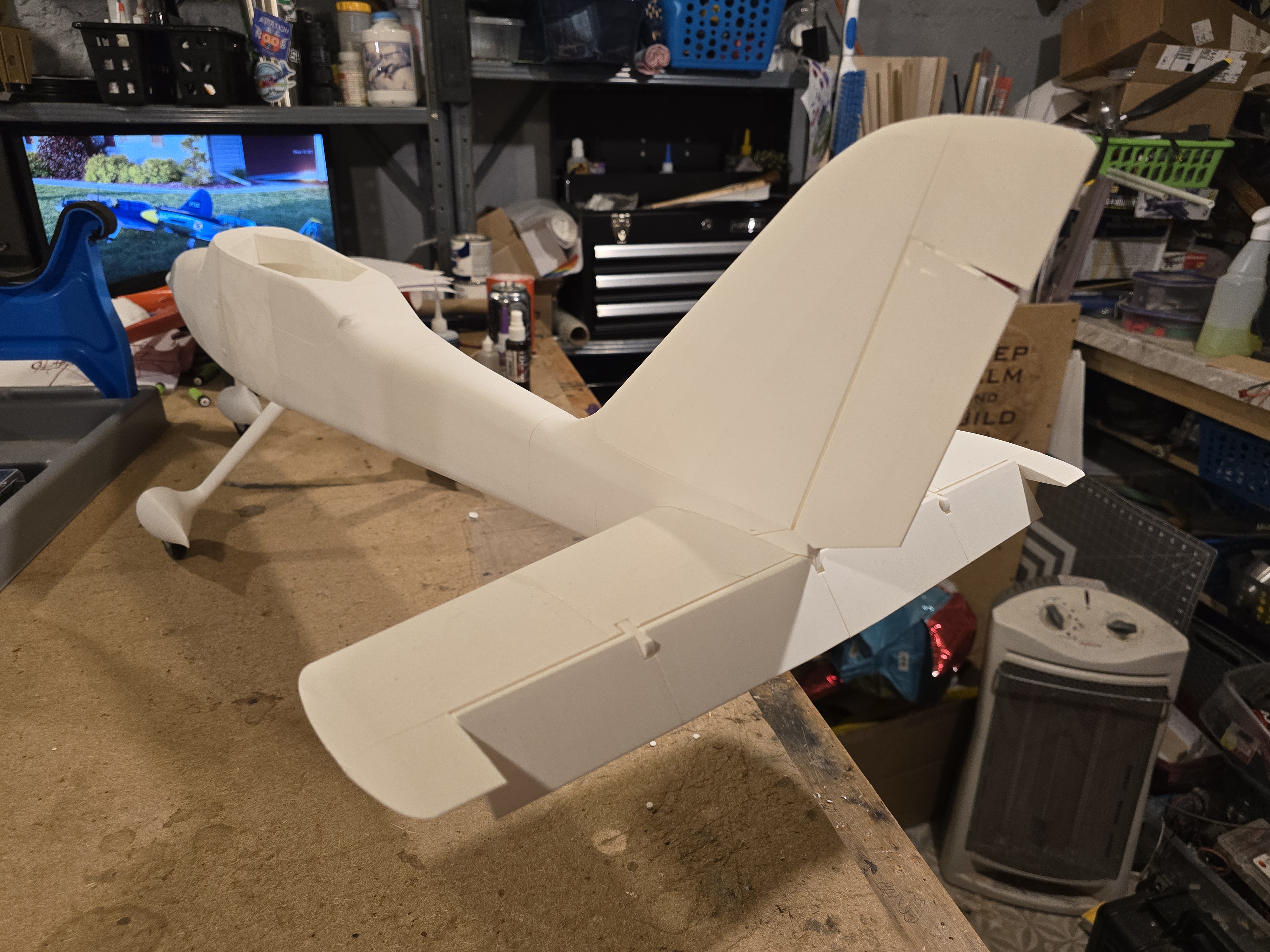

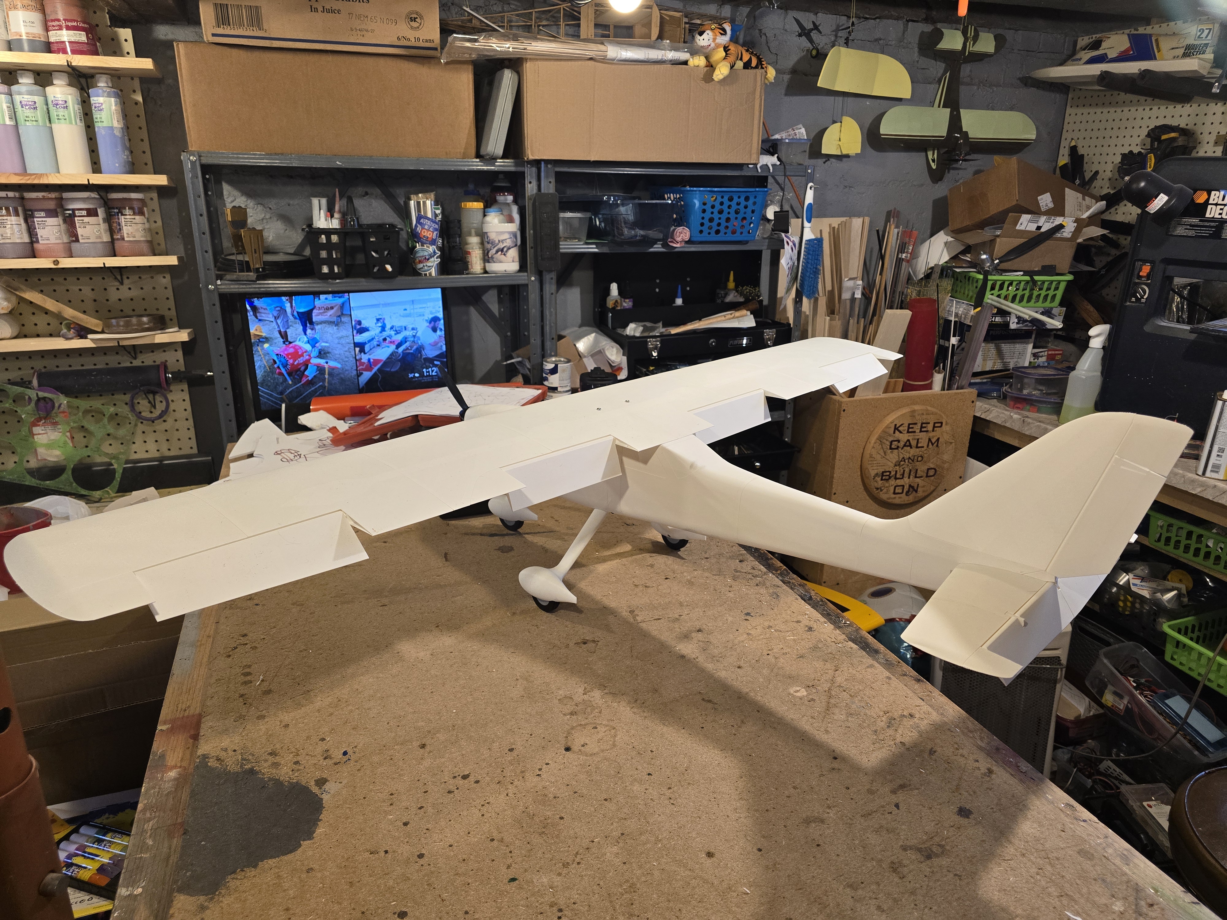

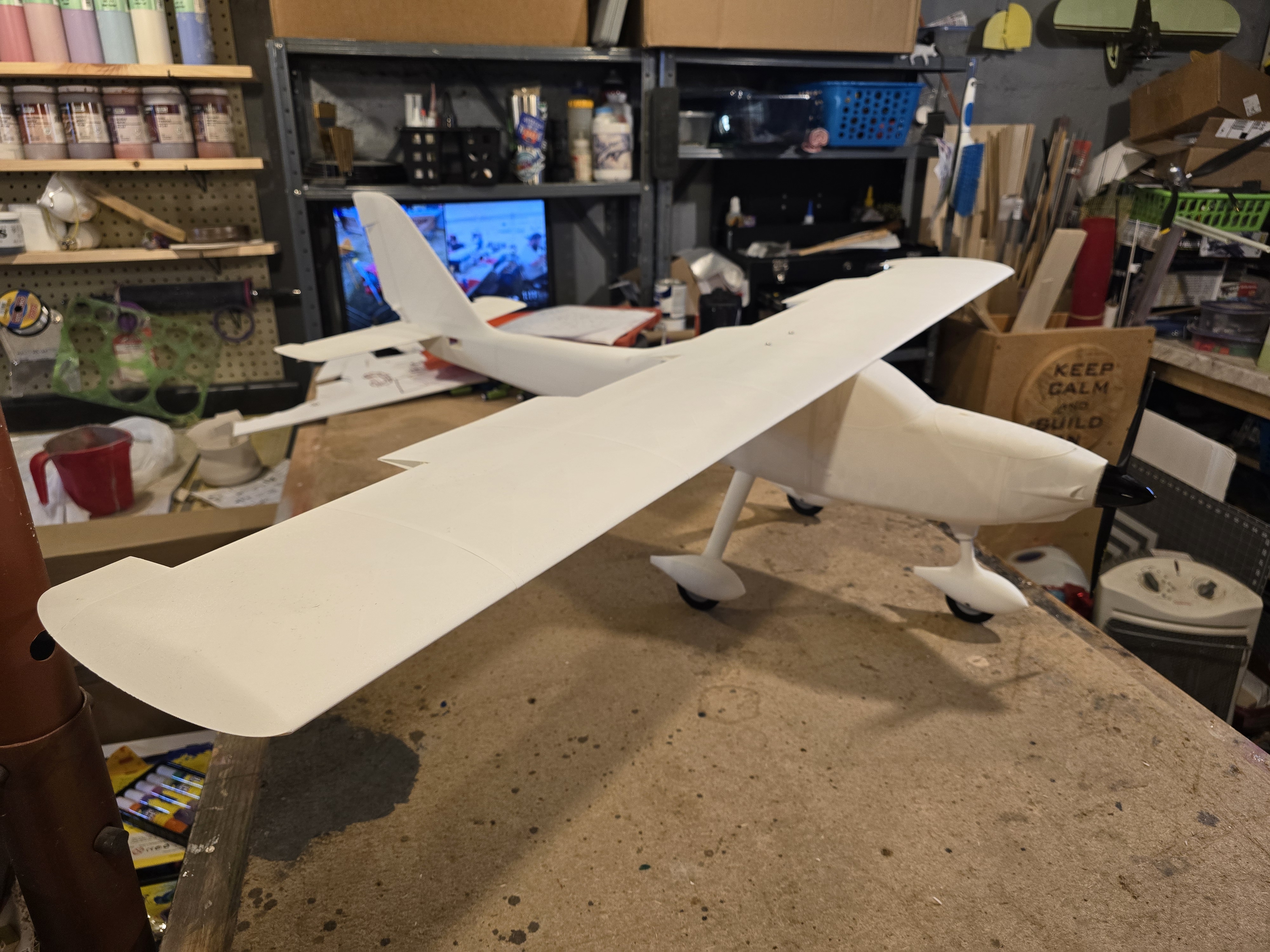

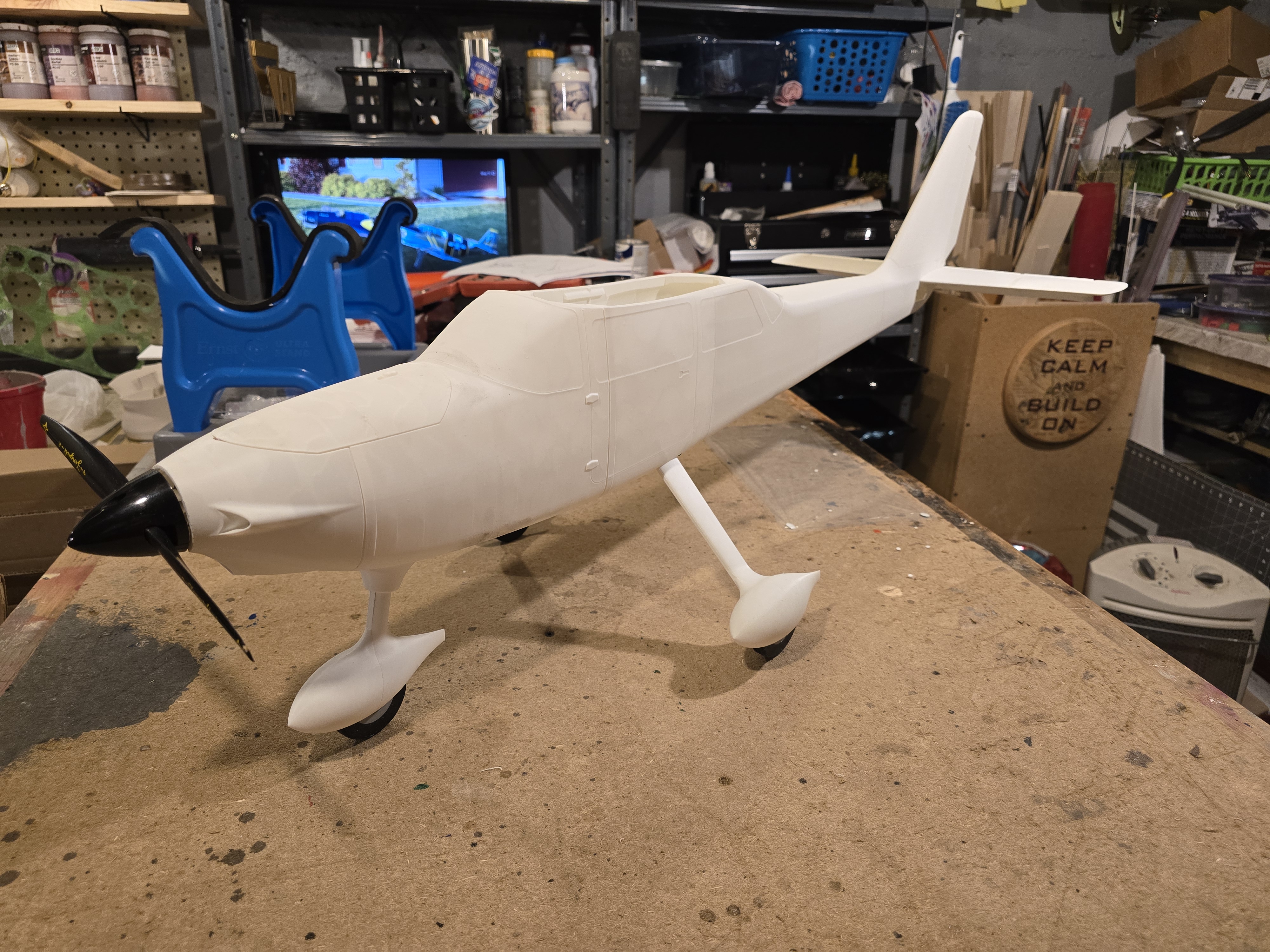

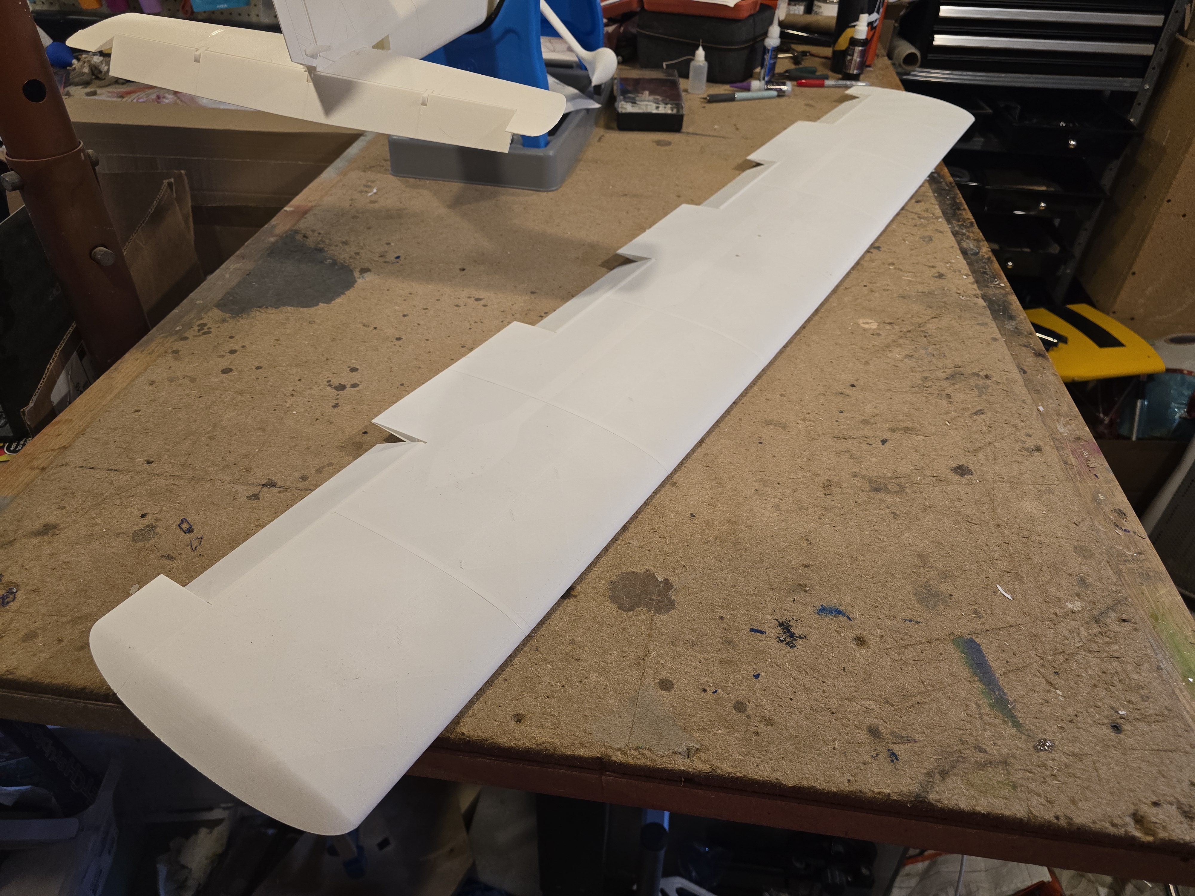

The airframe is together!
Nothing really worth noting, everything just slid together. I had the wing and tail done in about an hour.
Plan now is to give it a light sanding, then a couple coats of Polycrylic to seal it.

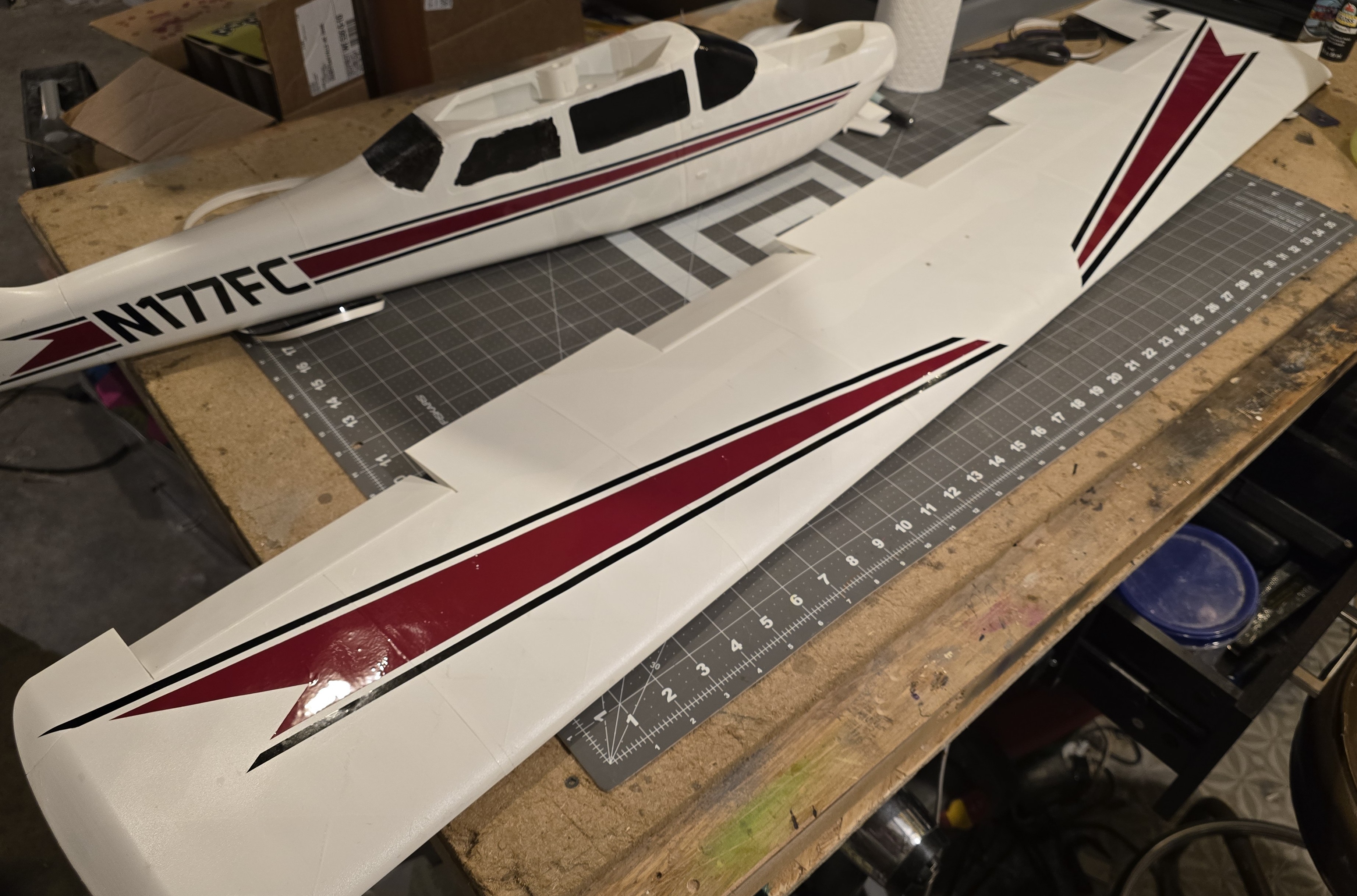

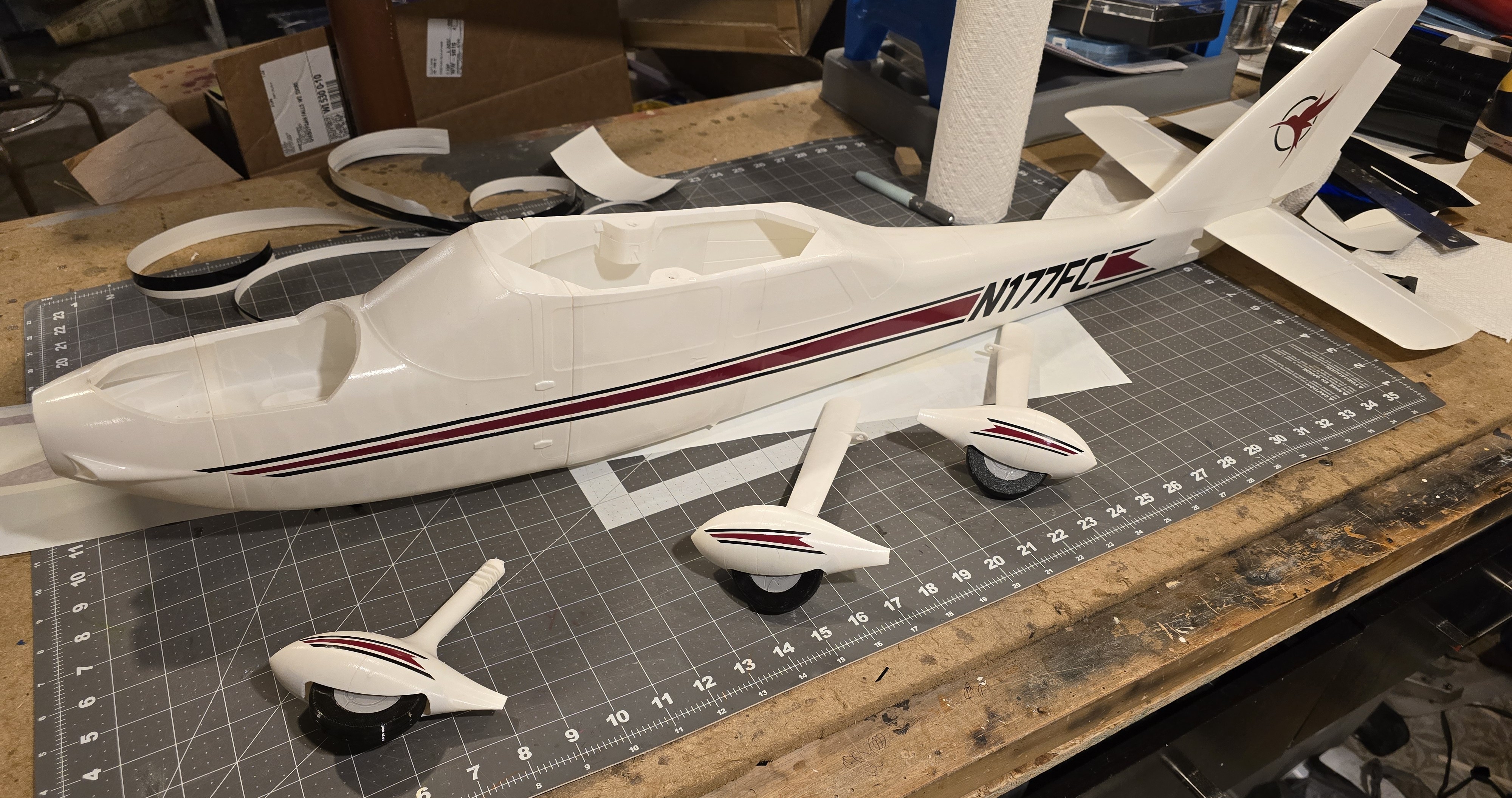

Graphics cut
Fuse stickered up
Wing done
I was warned that vinyl doesn't stick well to 3D prints. I was hoping my couple coats of Polycrylic would eliminate the issue...it didn't. Probably made it better, but I still had some areas that were refusing to stick. I used very light heat to help those areas stick down and that seemed to work. But man, it does not take much heat to soften the skins...
I had the same problem, even Oracal didn't want to stick. I used a tack coat of 3M Super 77 on the sticky side of the vinyl. A little messy but it worked.
FlyingTyger
My guess is that it has something to do with the texture of the print. FWIW, the Polycrylic didn't stick as well as I expected either.
The next printed project will get self-etching primer and a real paint job. Any markings should stick fine then as there will be no texture and a good 3-4 coats of paint and primer over the plastic. But that much finish work was not the intent of this project...
