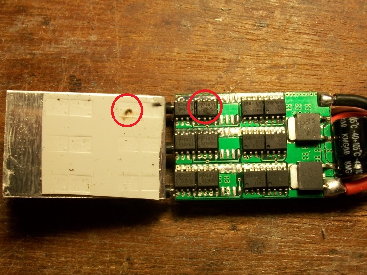

I've never seen a regulator burn out at full throttle and crash. The regulator can burn out when the motor windings are closed on impact (not high-quality Chinese wire winding) or moisture gets on the power switches, at high current consumption (the screw does not meet the specifications), at high battery voltage (3S recommended...they installed 4S). factory defect (not soldering or poor quality of mosfets).There are no miracles.A lot of words...It's time to take a photo of a naked regulator, rather than guessing on coffee grounds.)))

A low level take off crash, so with full power, into the ground is quite a likely scenario for a stalled motor burnout scenario unless you are very prompt in cutting the power. A motor burnout is also quite likely to damage the ESC too but you are unfortunate that it ended with a short circuit. All my ESC failures have failed to open circuit.
The problem is you have no way of knowing if the ESC has been damaged to open circuit other than to remove the shrink wrap and heatsink to visually check individual MOSFETS. A "blown" one will likely show a mark when the circuit inside has disintegrated from the overload.
Unlike mechanical things with electrics it is always better (& cheaper!) to try to identify why something has failed before trying again.
