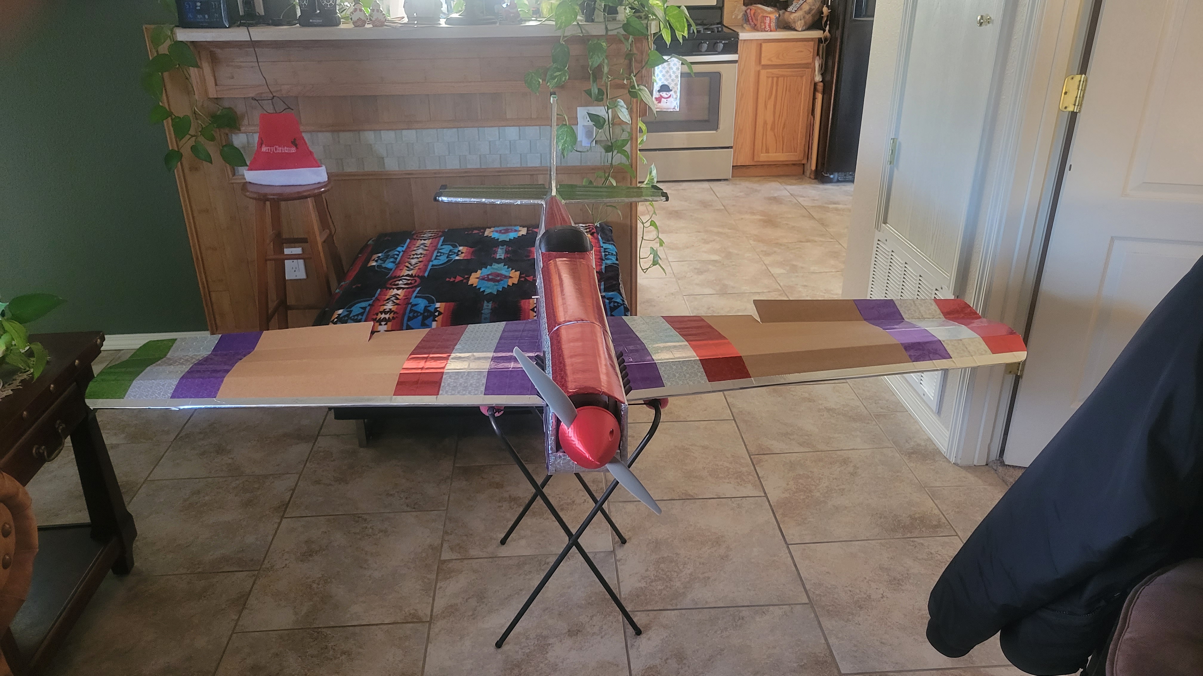

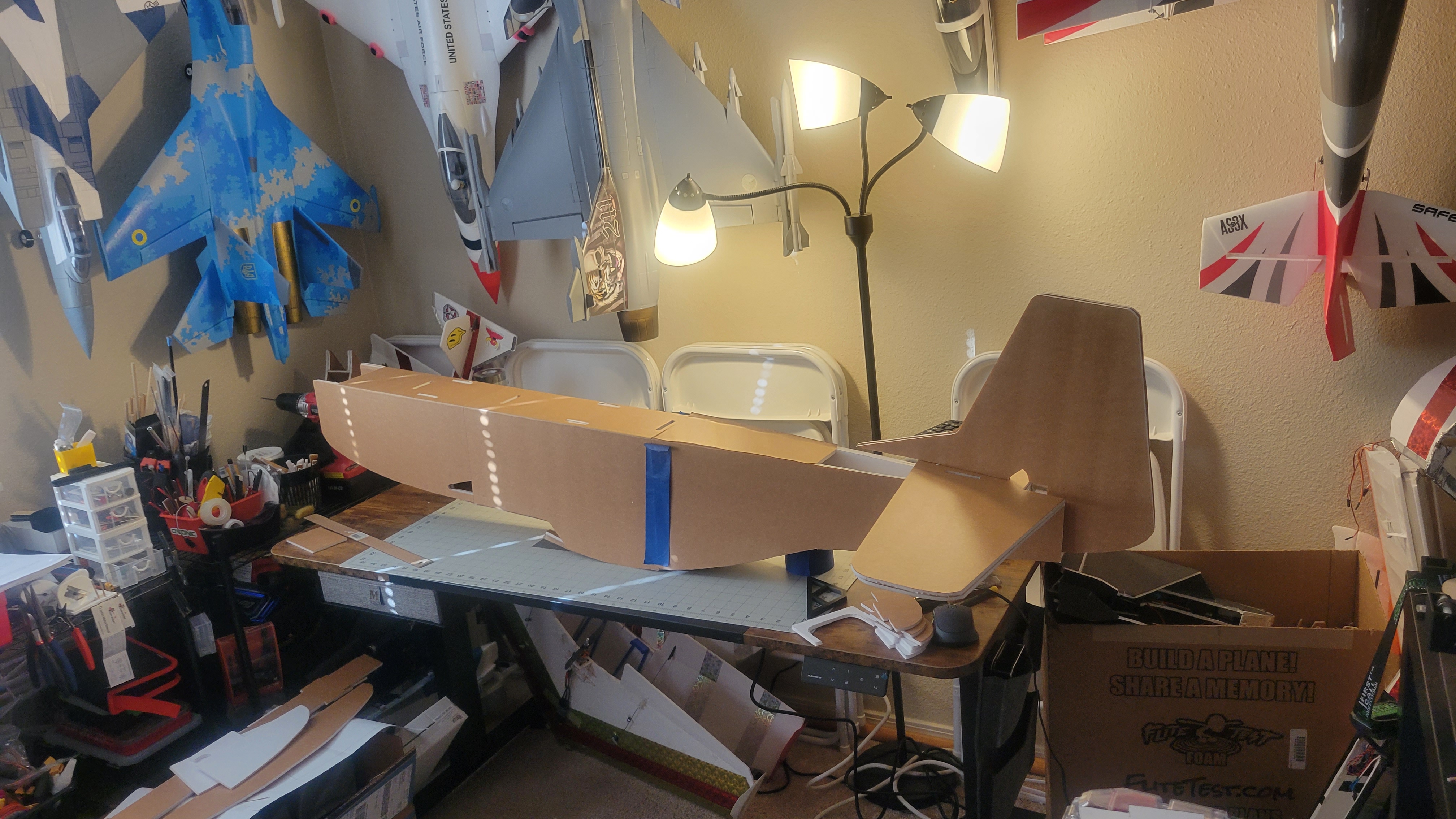

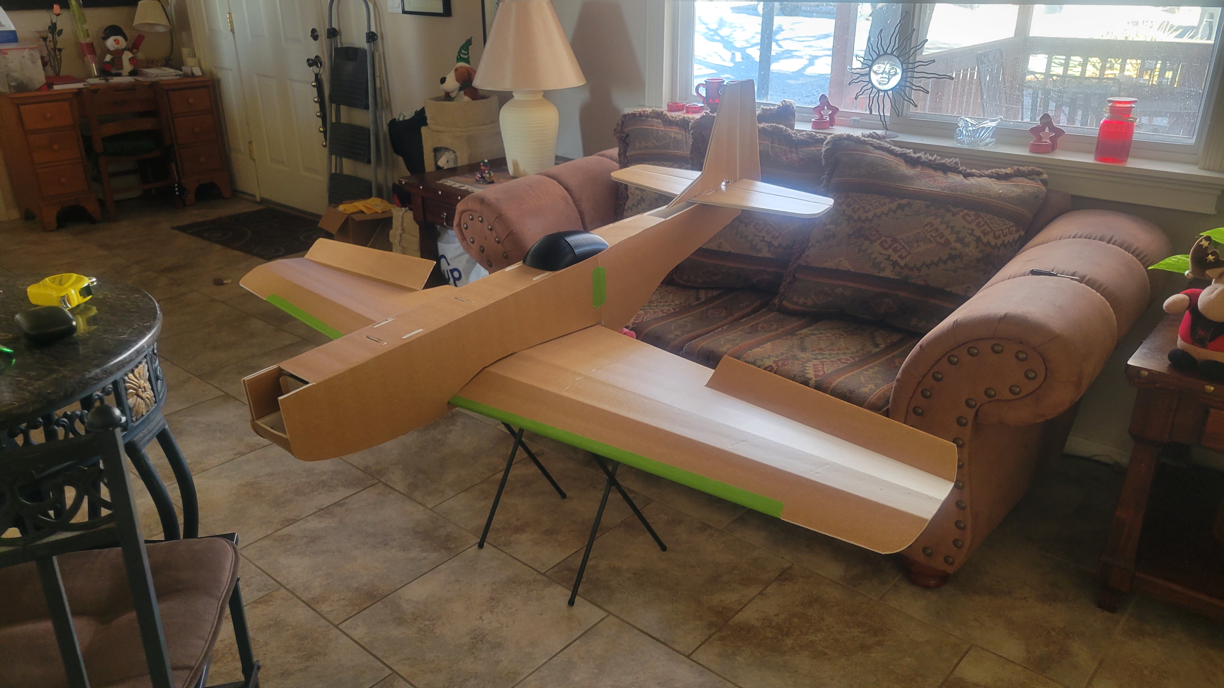

This is my 200% Mustang build. Flys on a 5065 400kv motor, 80A esc, 6s setup.

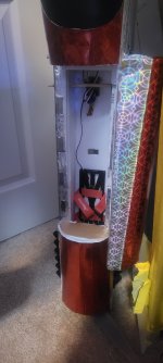

Battery does go through the top. I hate bottom load batteries. Magnets hold the hatch in place. Did the power pod like this cause it holds the battery, but I did glue the power pod in so I didn't need rubber bands (sticks were used, but glued it right away) . Esc is on the under side of the pod.
