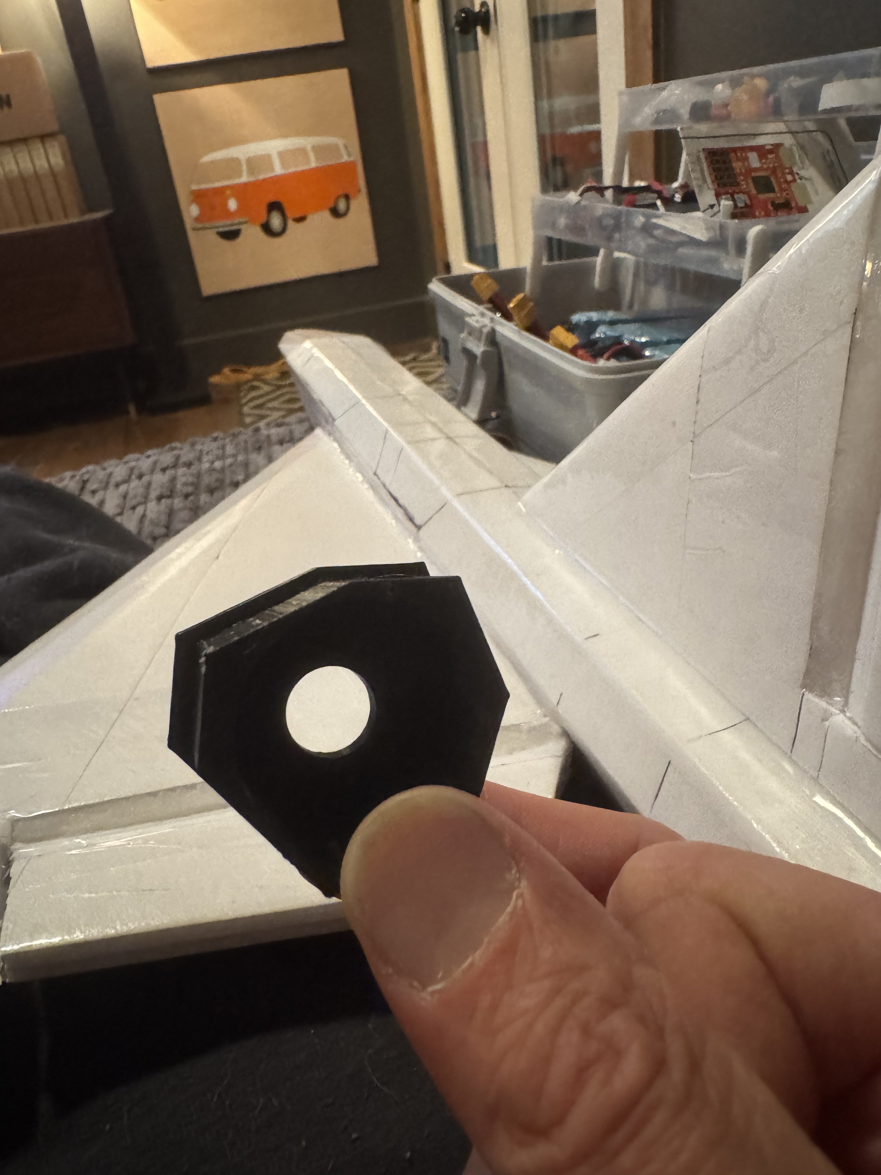

alright fellas…

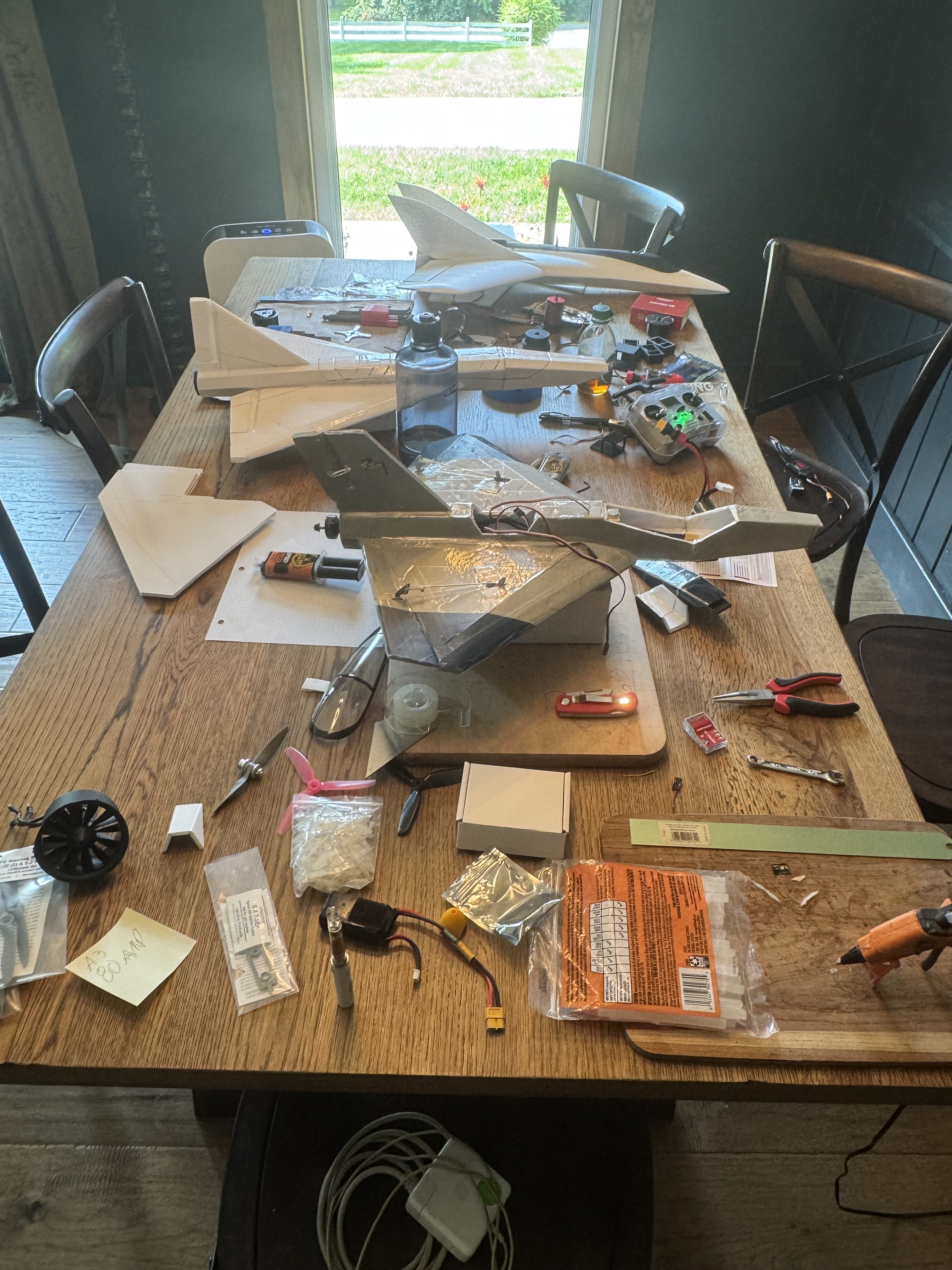

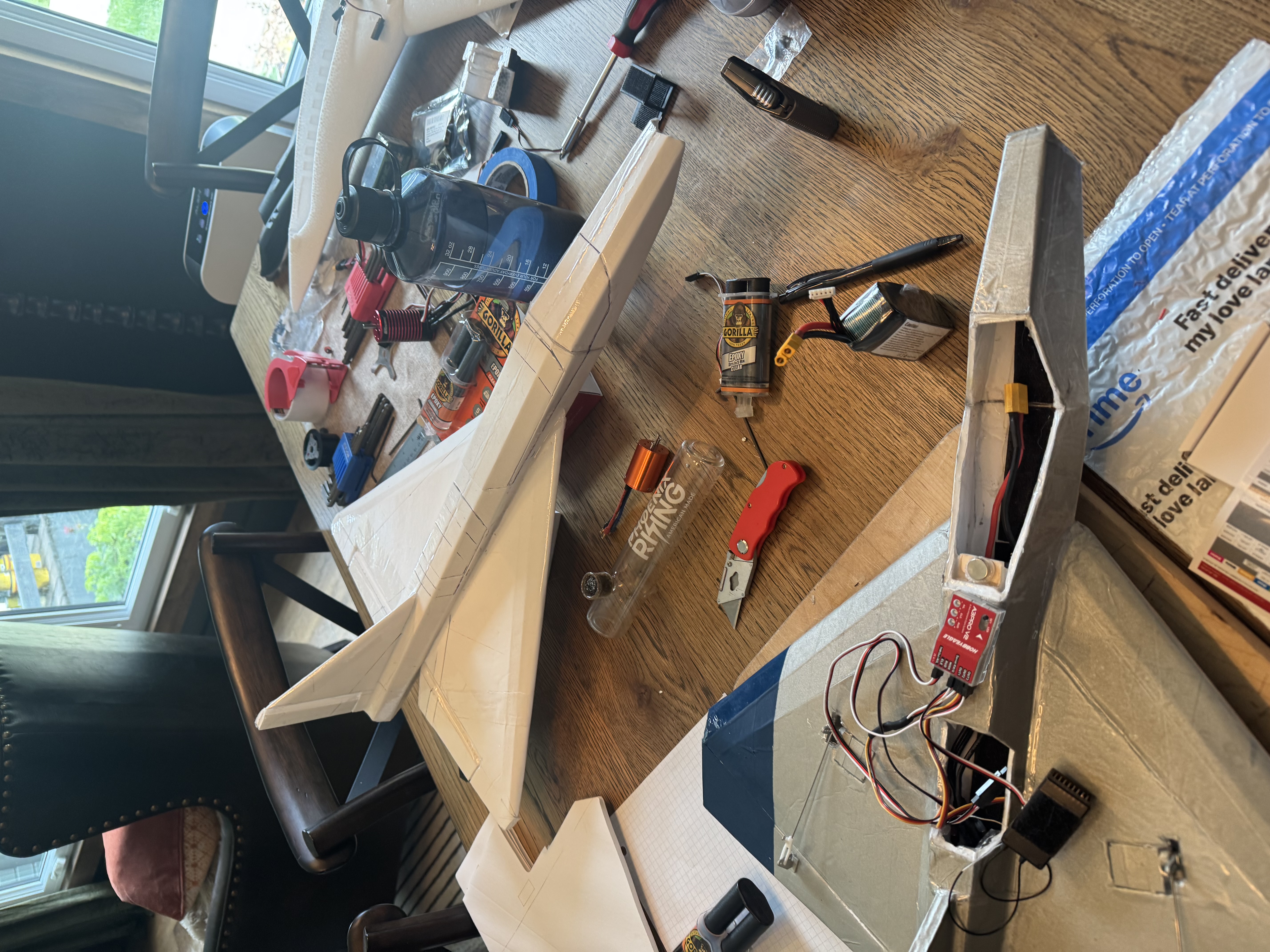

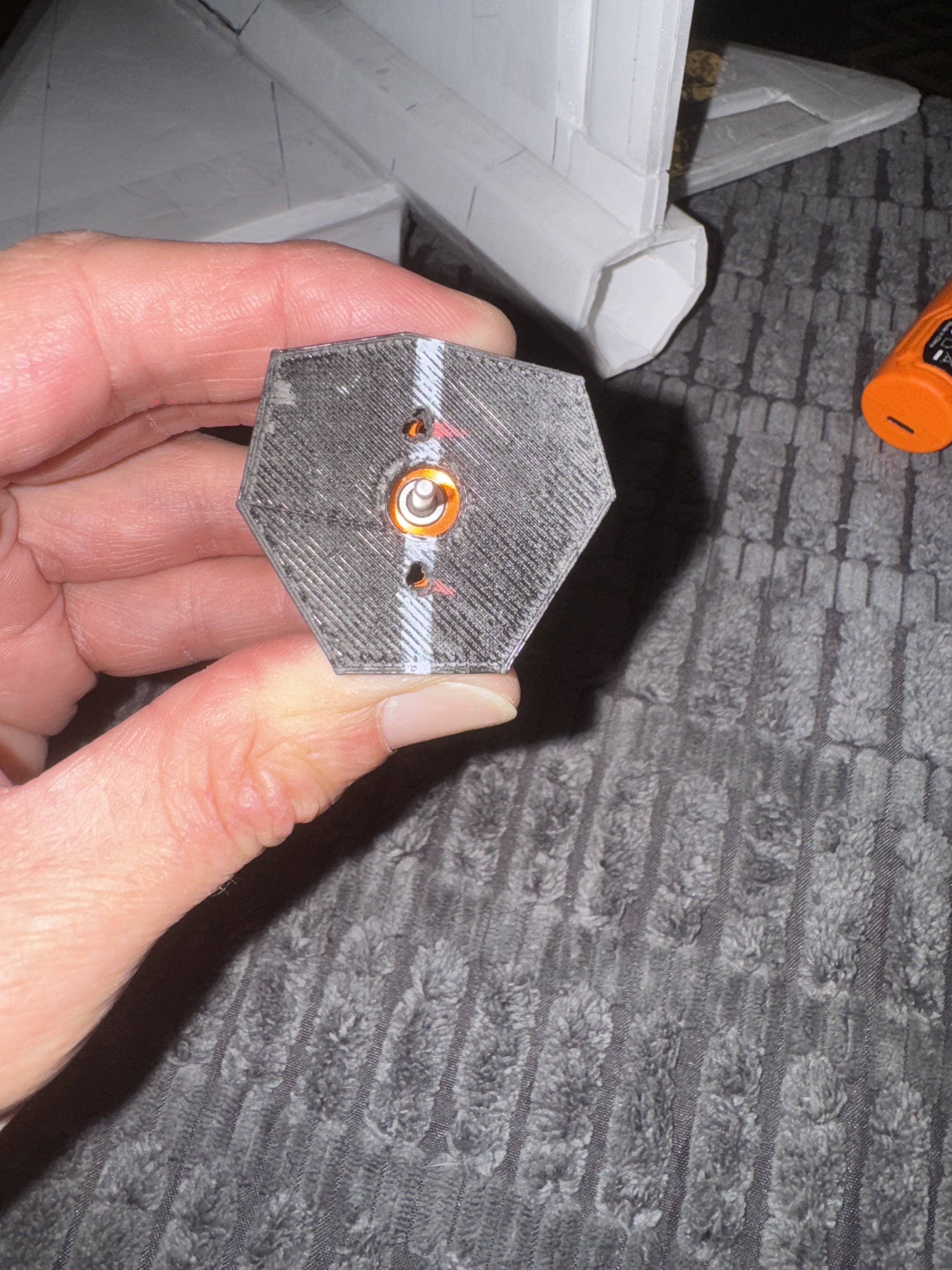

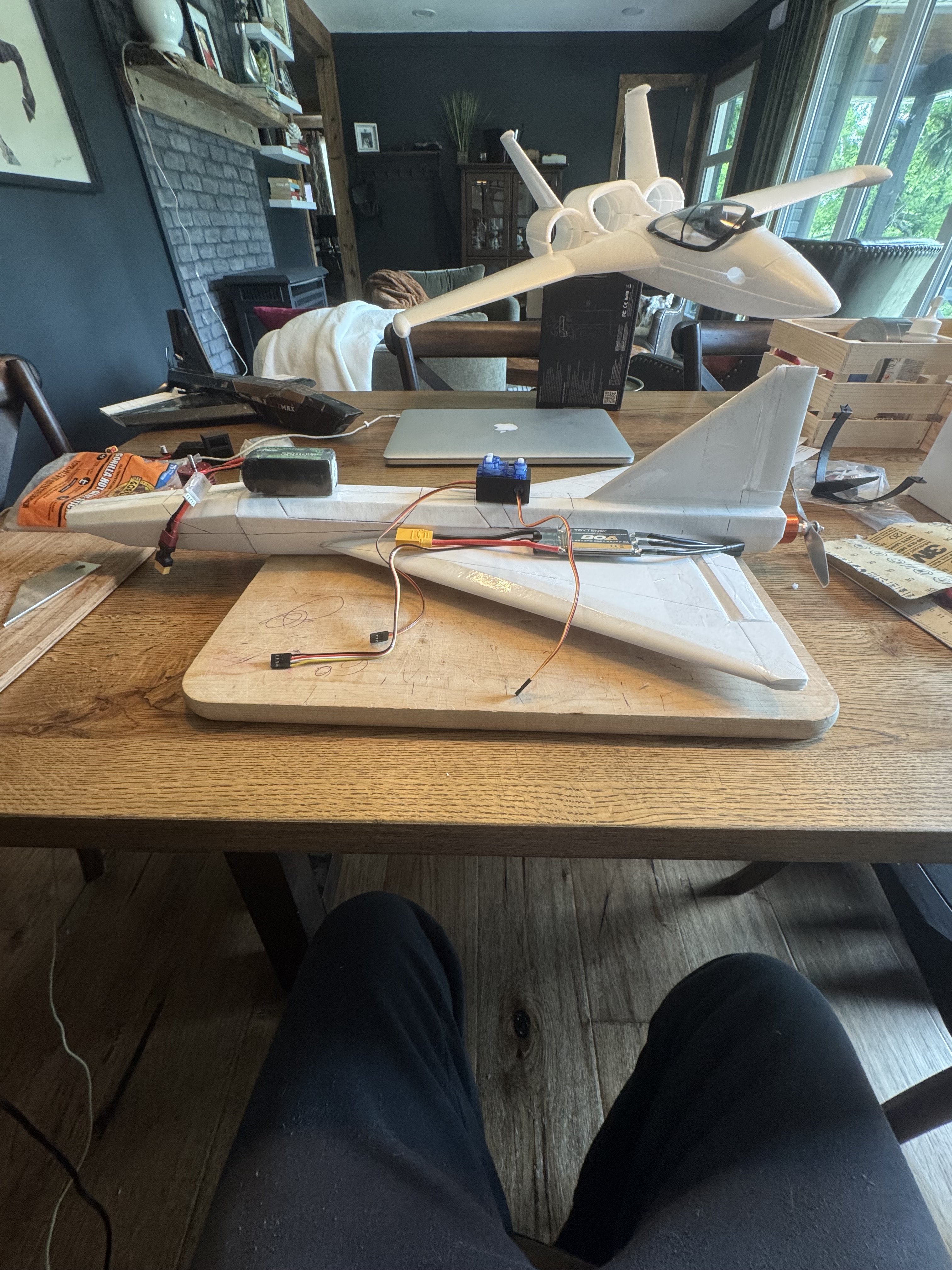

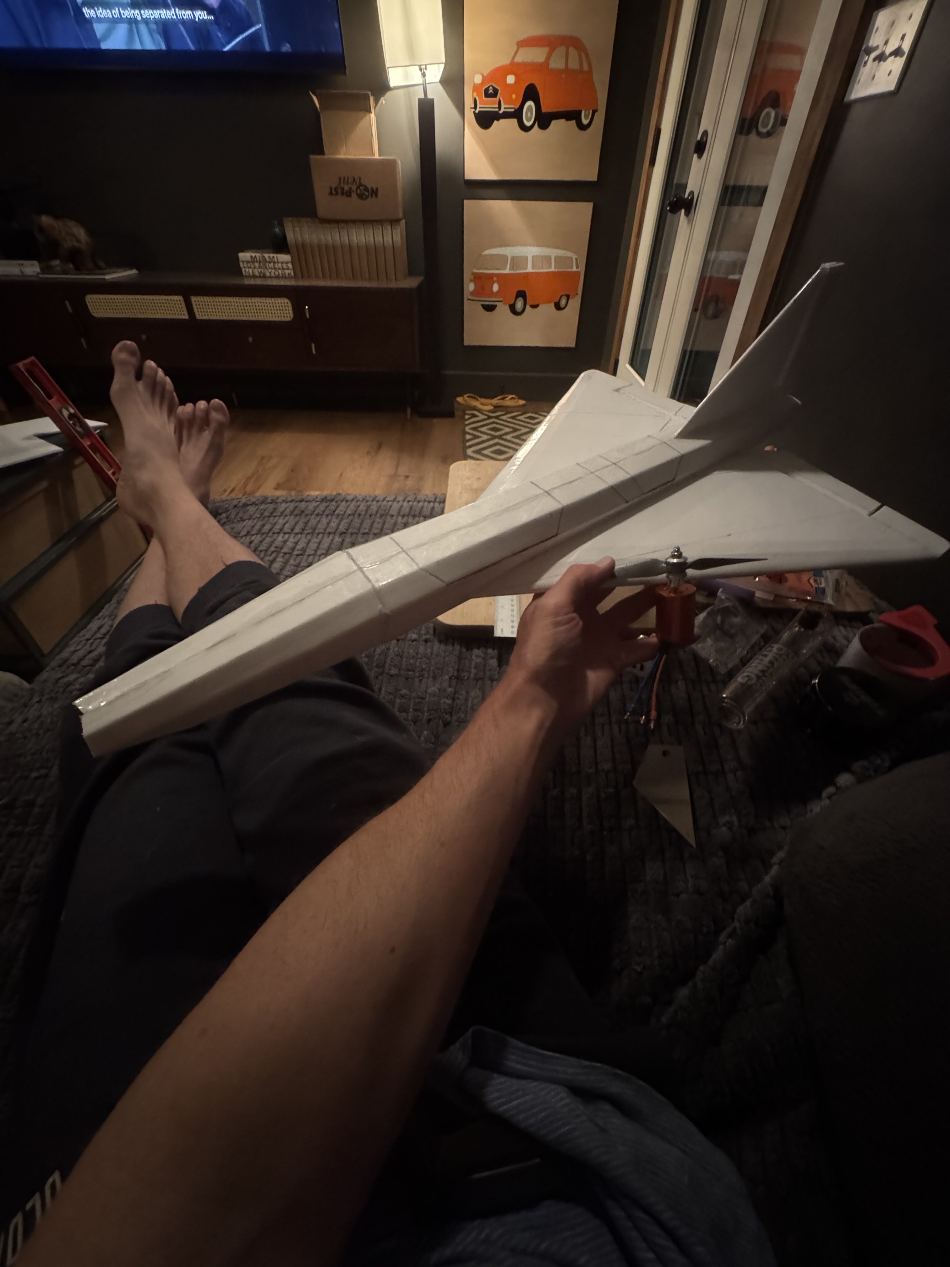

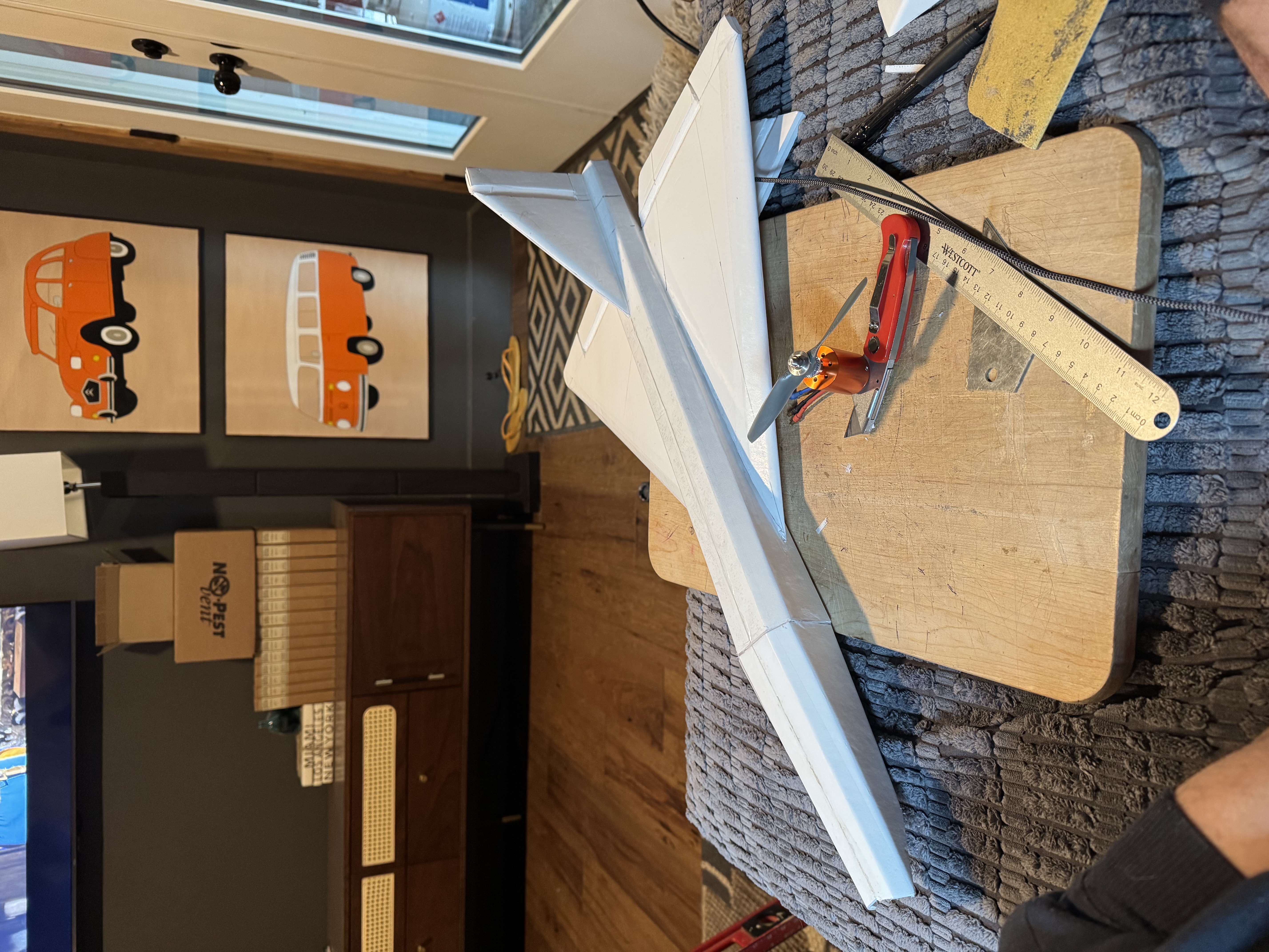

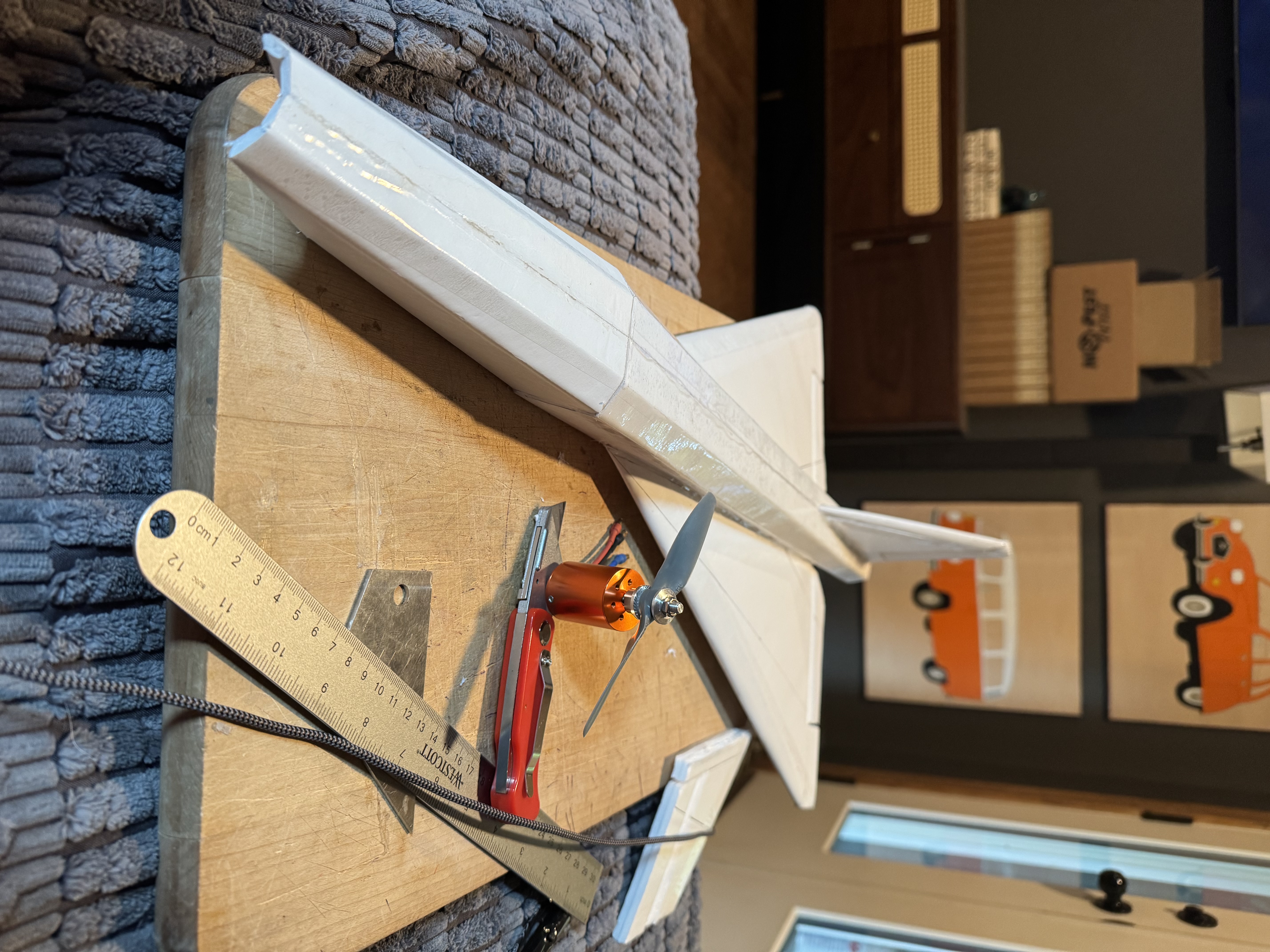

been working on motor mounts and thats about it.
i am essentially going to try this with two frames, a built and purchased.
here is a sneak peak at the build. i sketched the rear where motor goes and made a “plug” that holds the in runner.

in honor of The Crazies @Mr Man & @Houndpup Rc i am doin this thing.

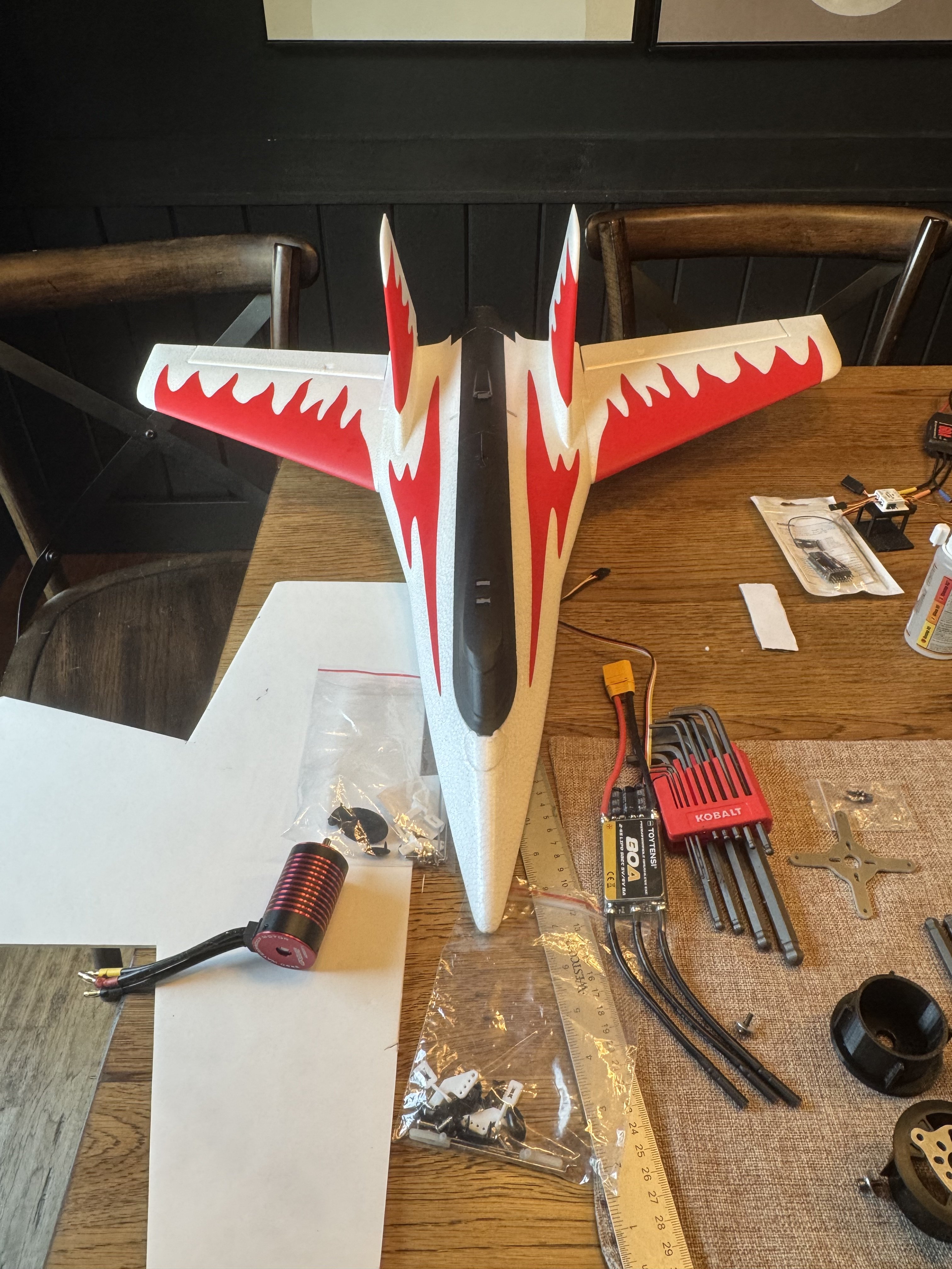

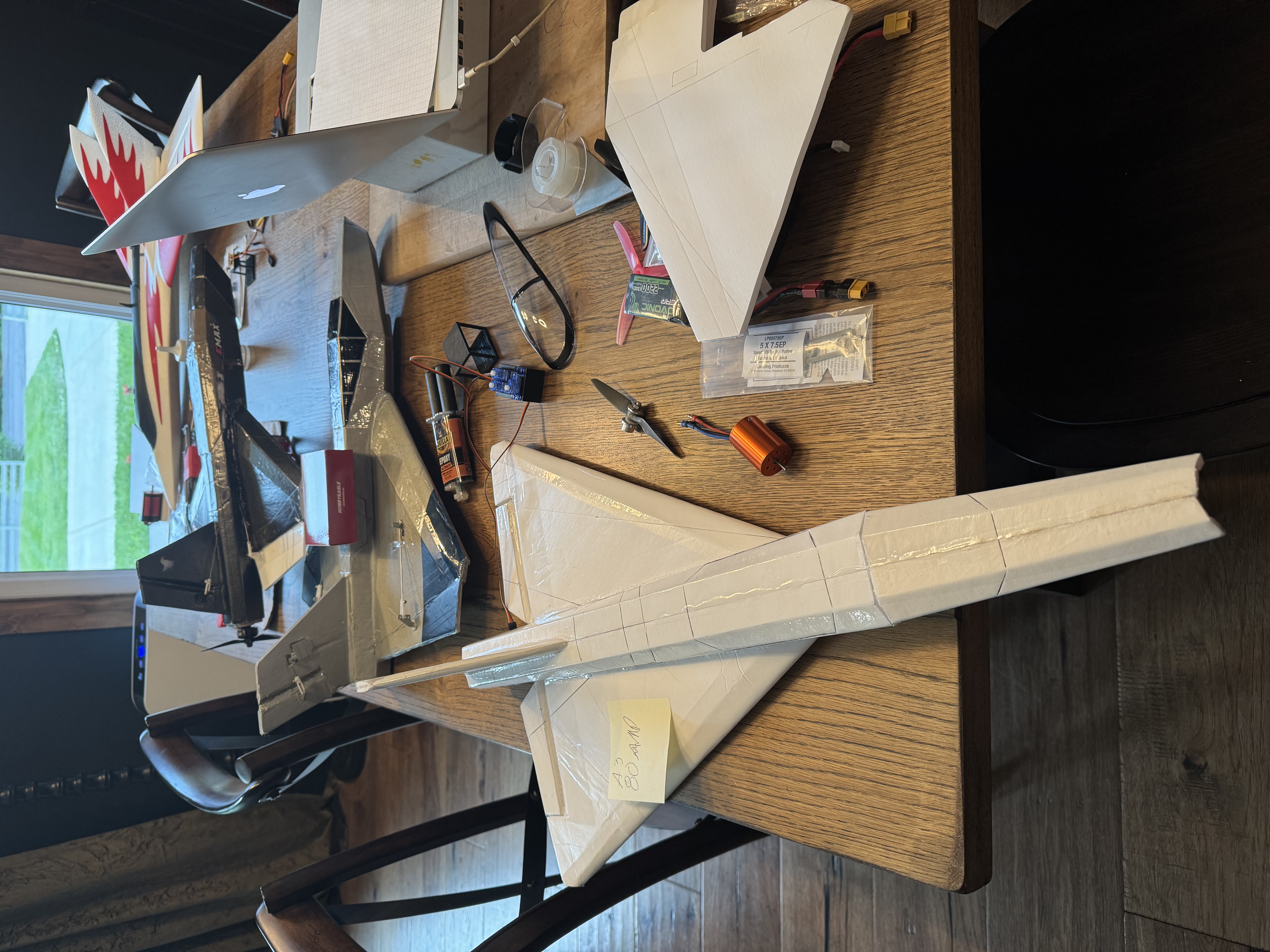

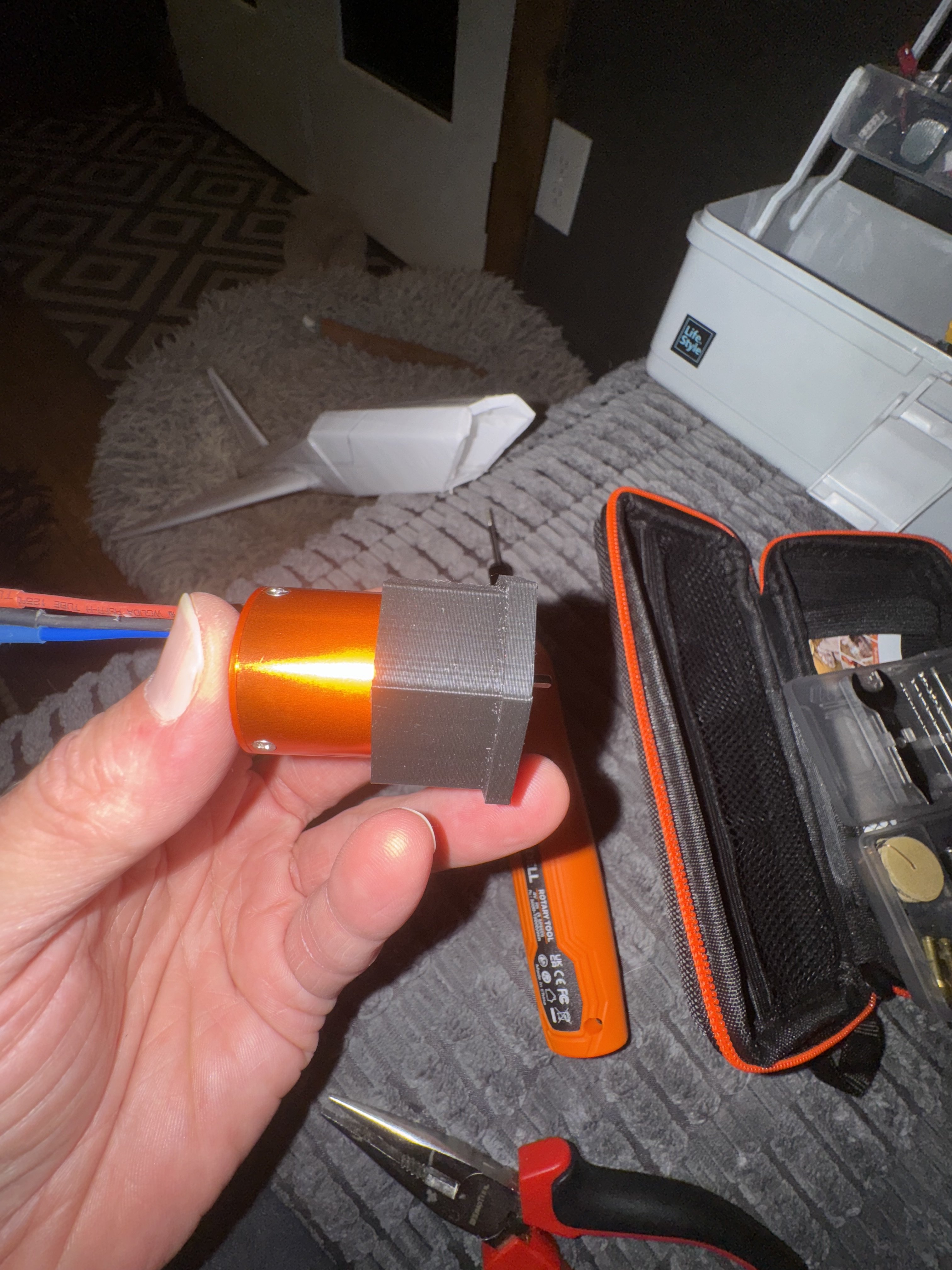

spent most of today thinking out the two planes i am trying this with, thinking out past mistakes, electronic matching, printing motor mounts, printing flight control decks….but here is where we are. my hope is have these two in the air by tuesday.
man thats cutting it close…maybe extend the end date one more weekend 😎 🙏 😜
motors:
3660 4200kv
2836 3800kv
yeah…i know…i know….pray i dont cut my face off when launching…

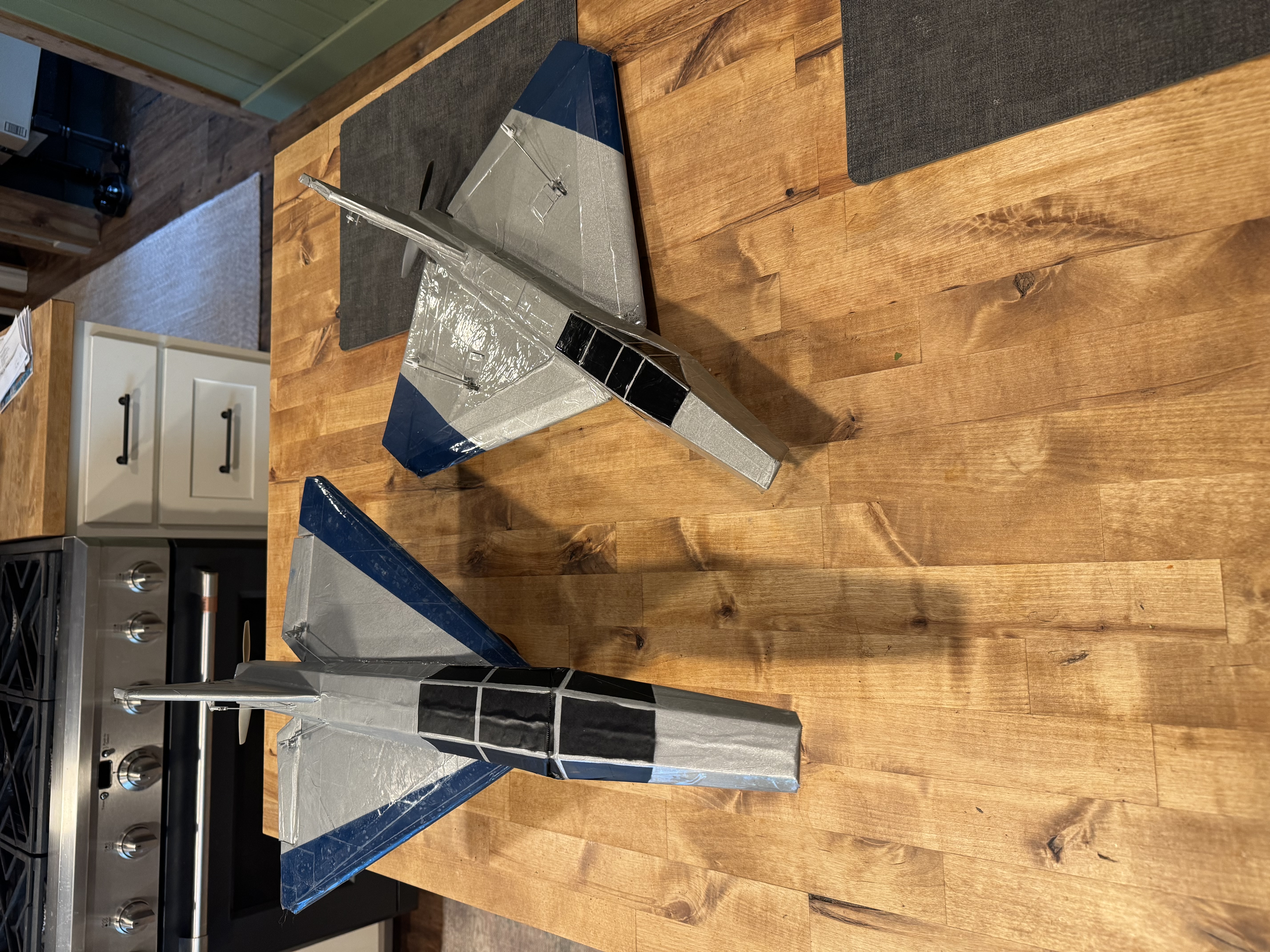

I built this as a tribute to the F16DWXL a while back, put a byme db in it….its first flight was a non stop direct to oscillation nation…no tuning was able to stop oscillation.
programming an A3 Pro V2 as a sacrificial lamb before putting an A3 in the F106 in the back ground for the speed test.

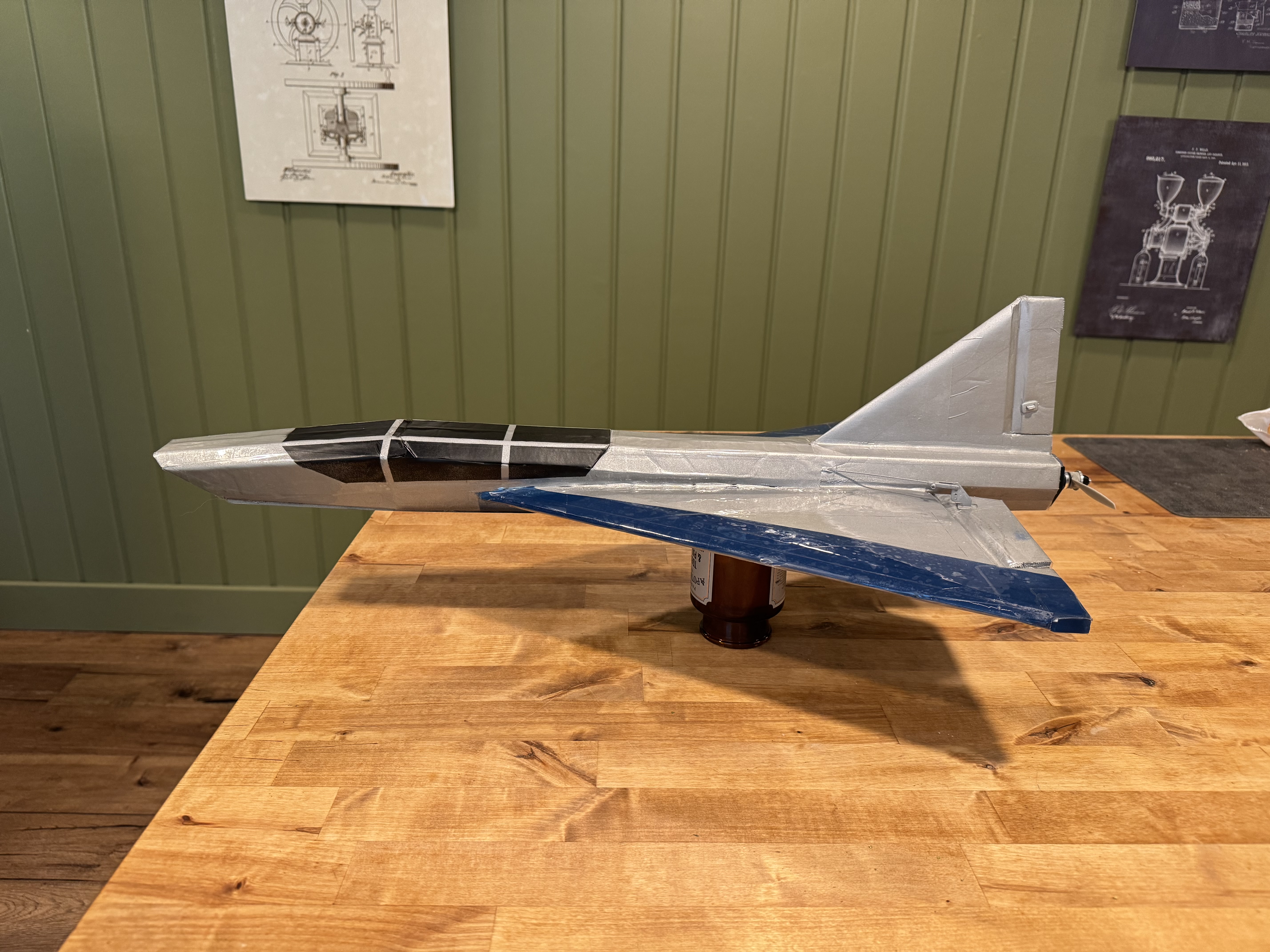

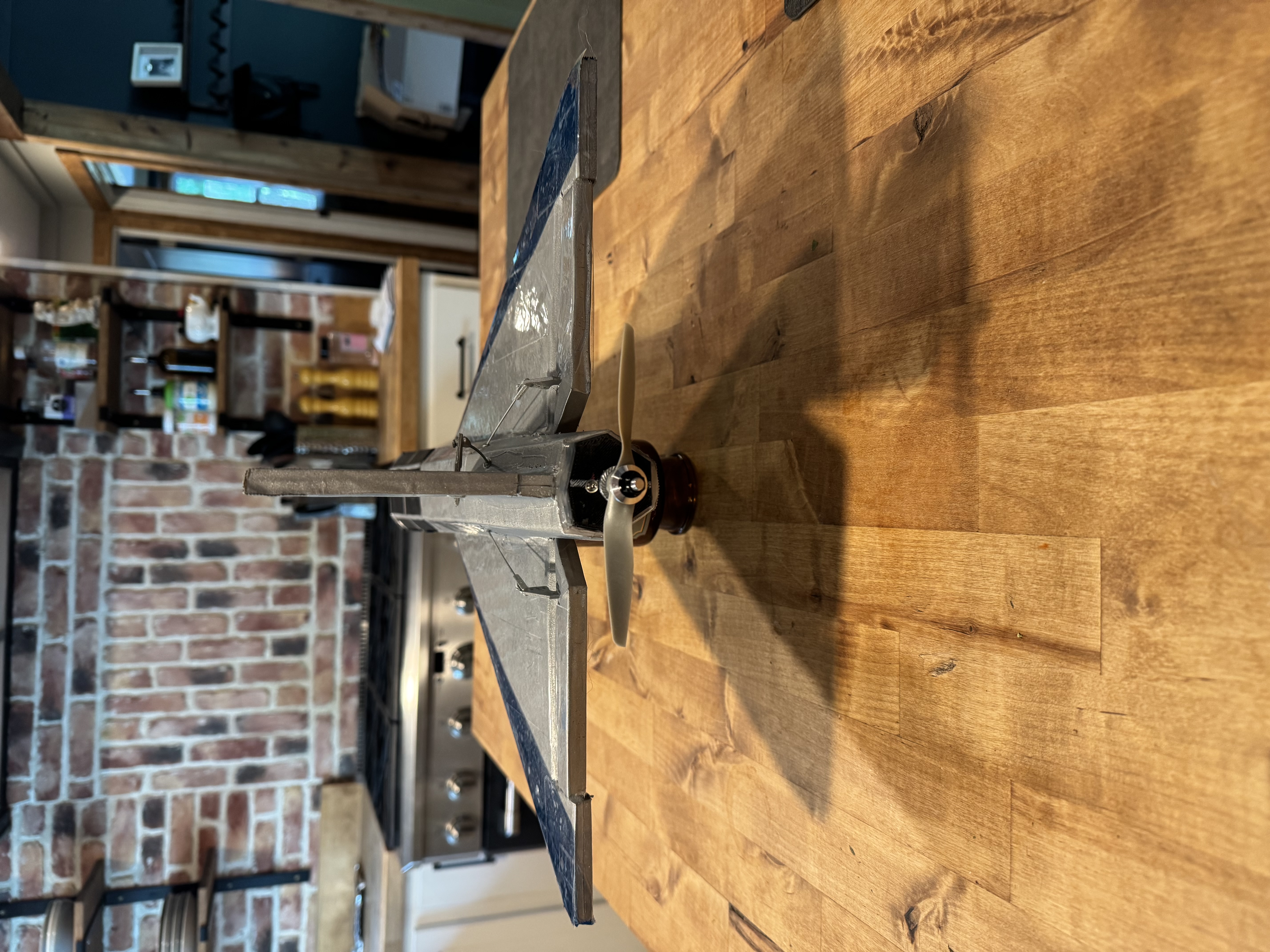

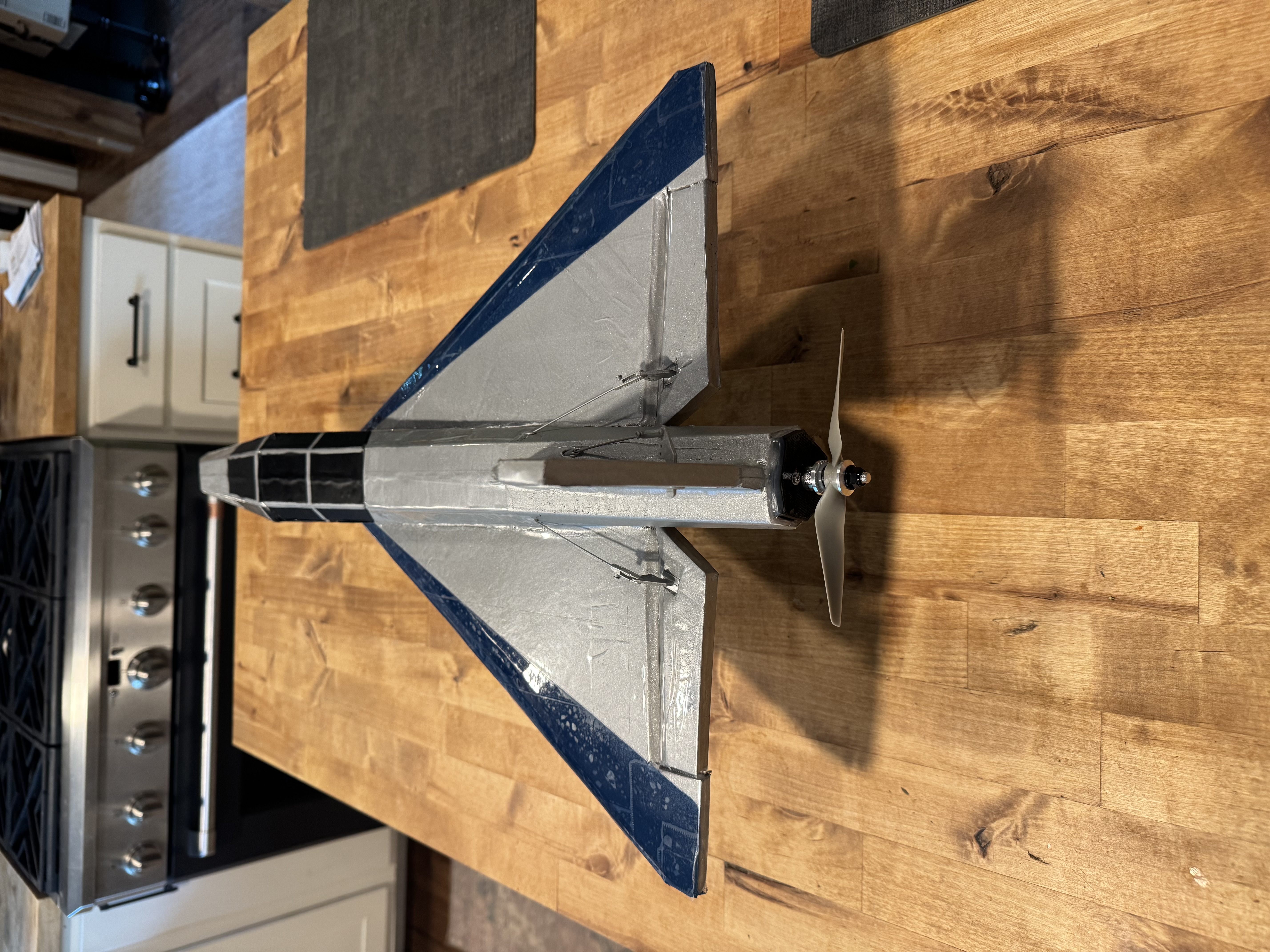

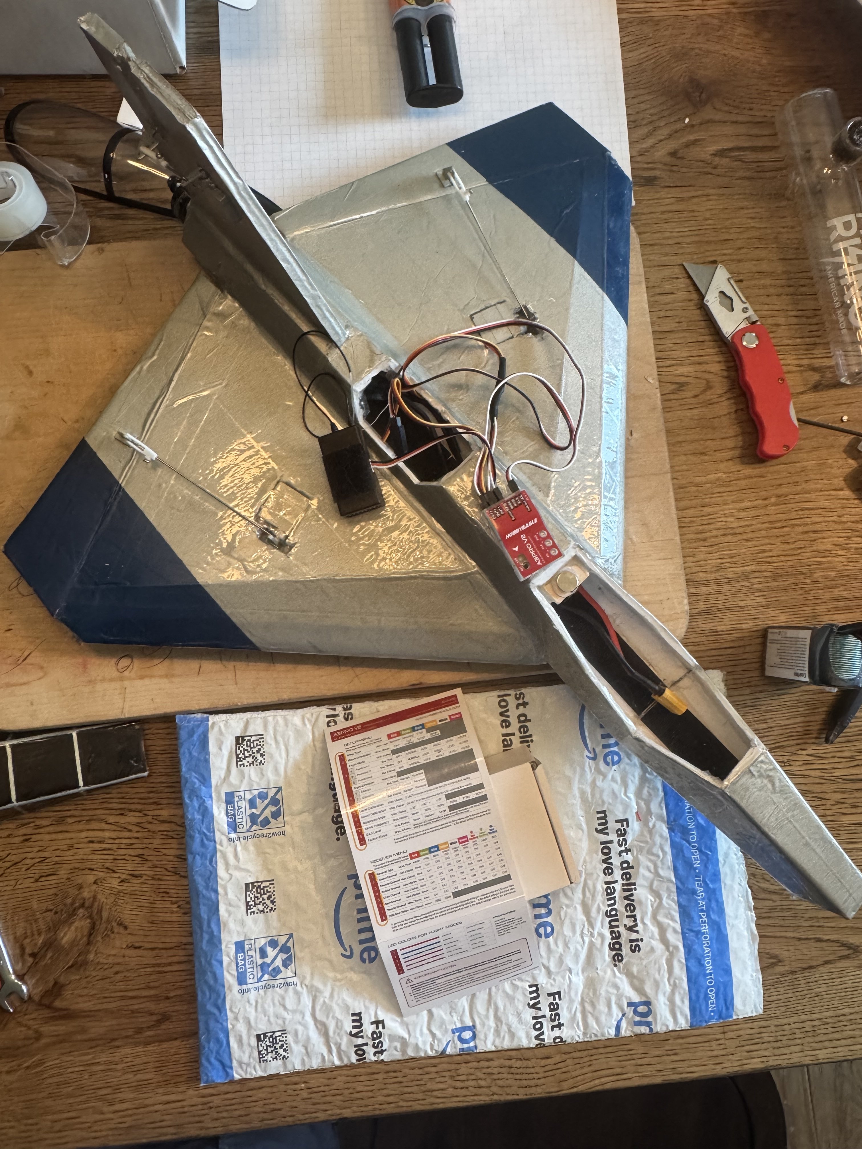

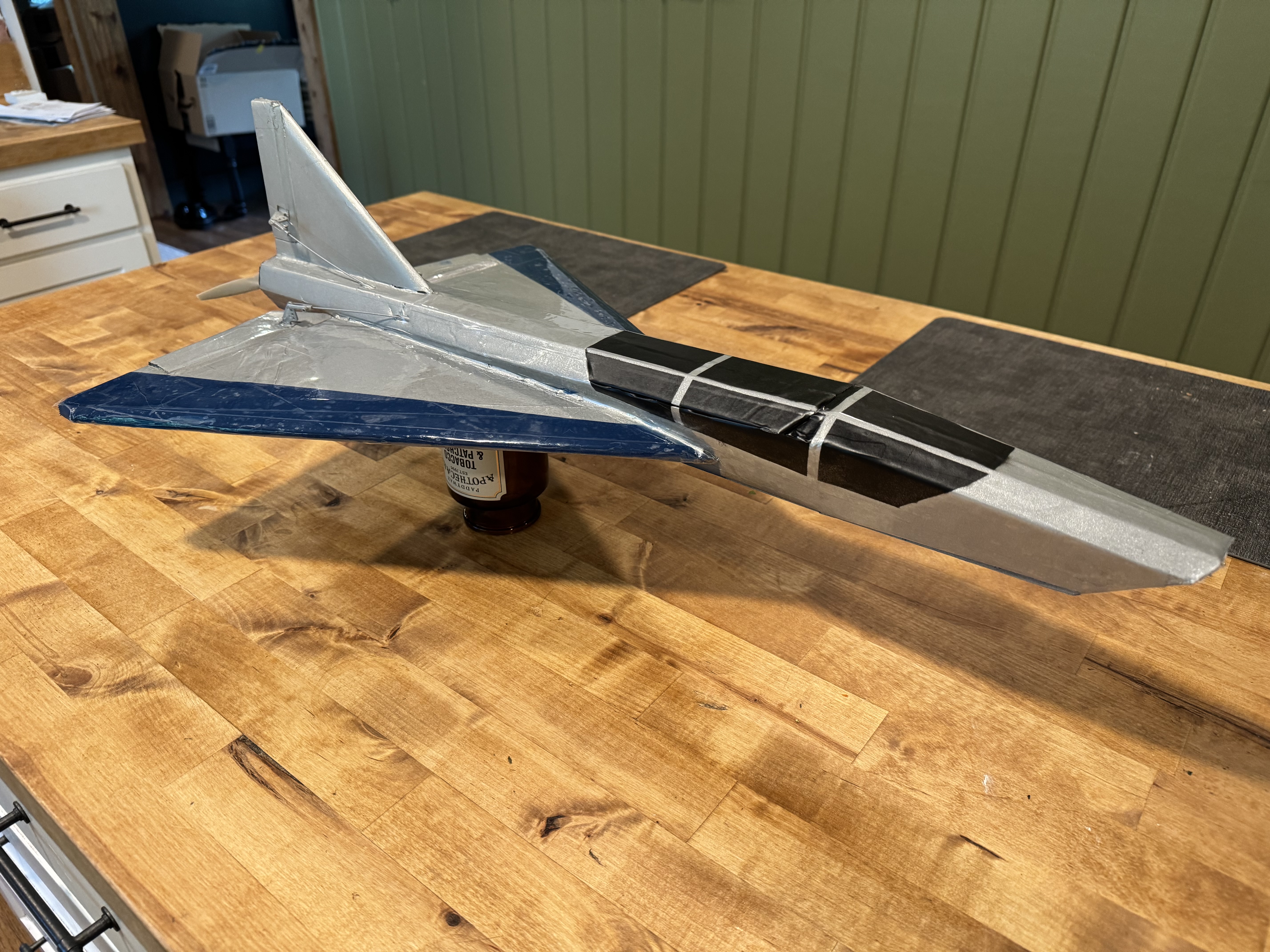

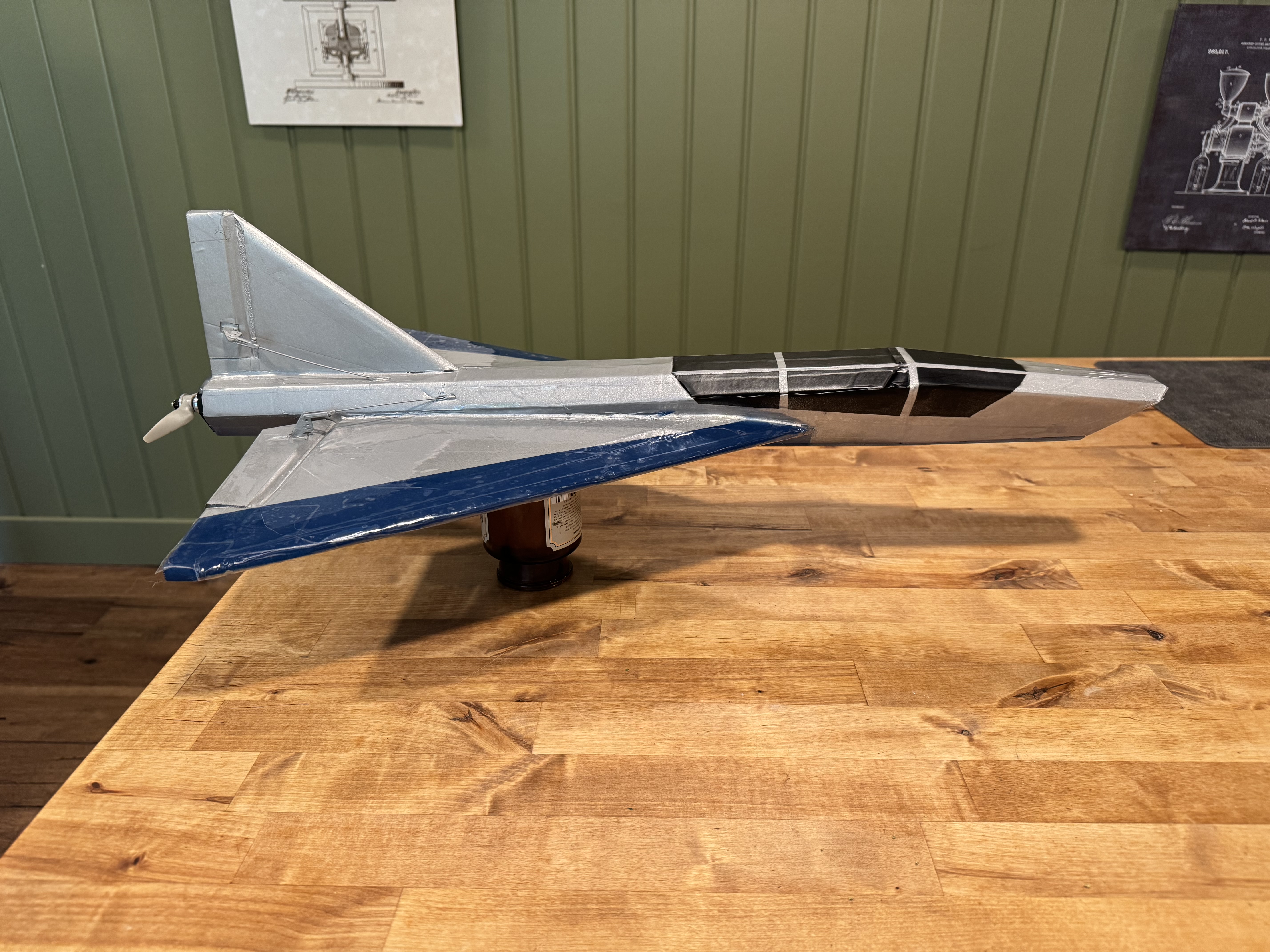

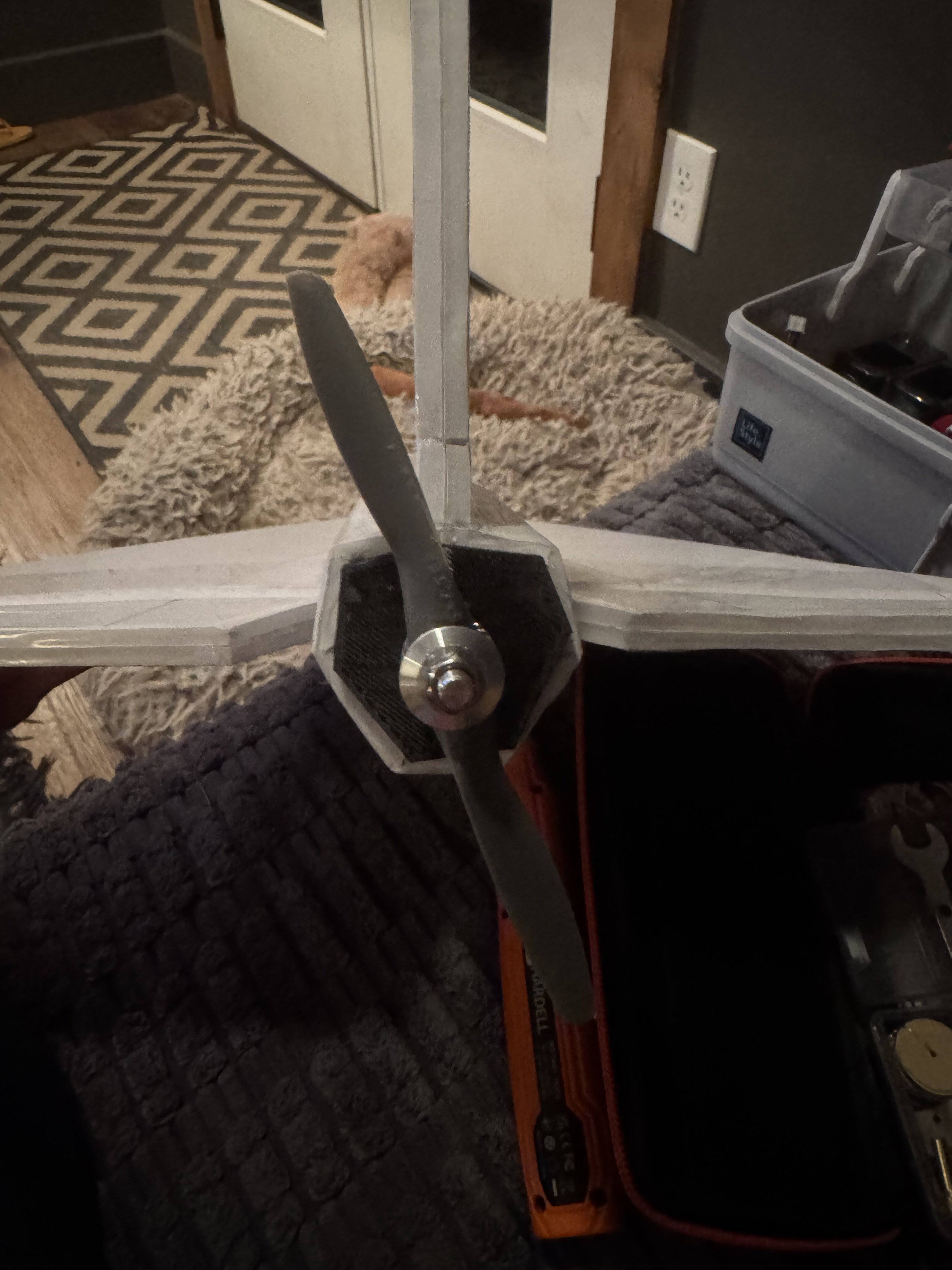

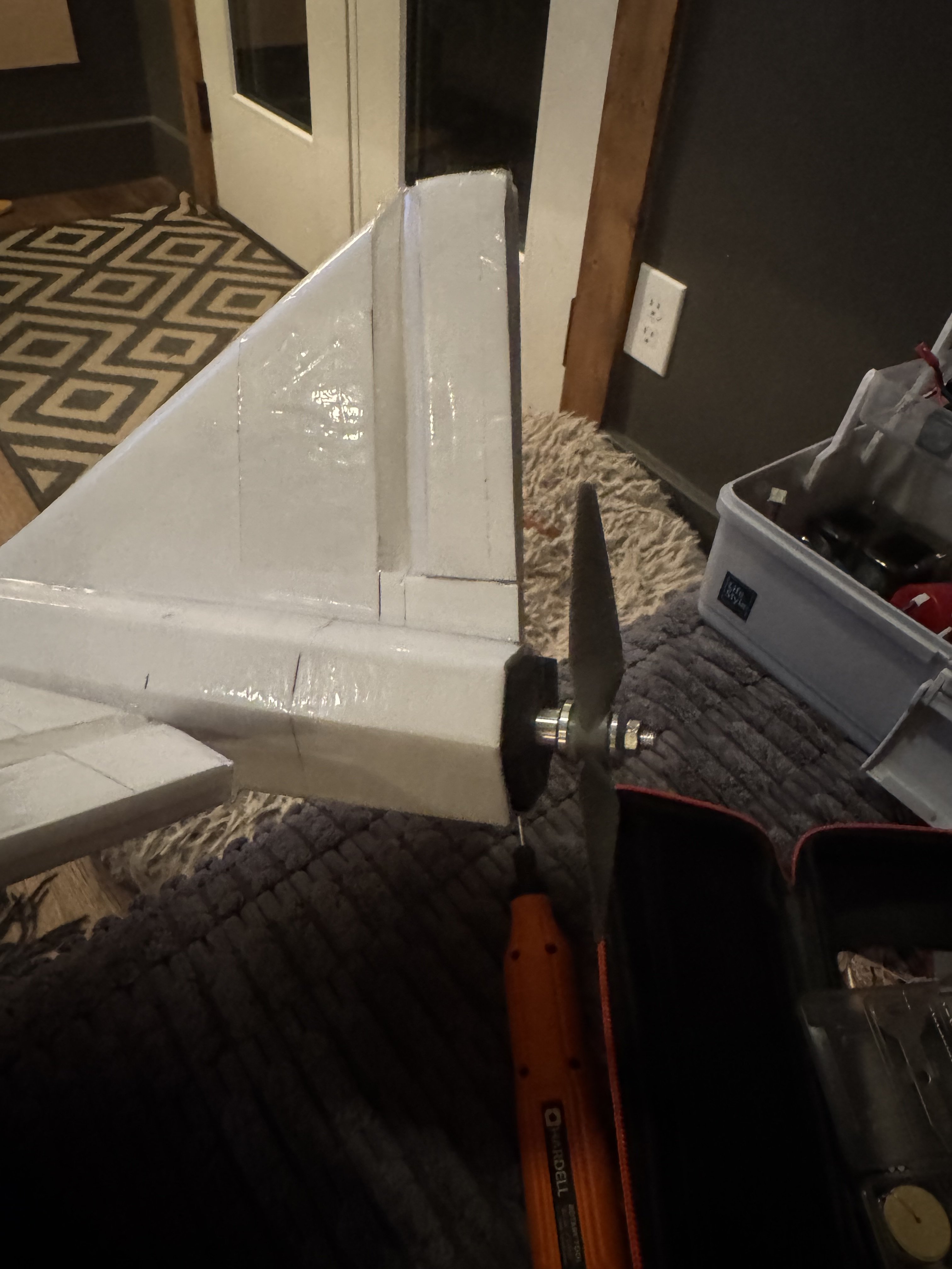

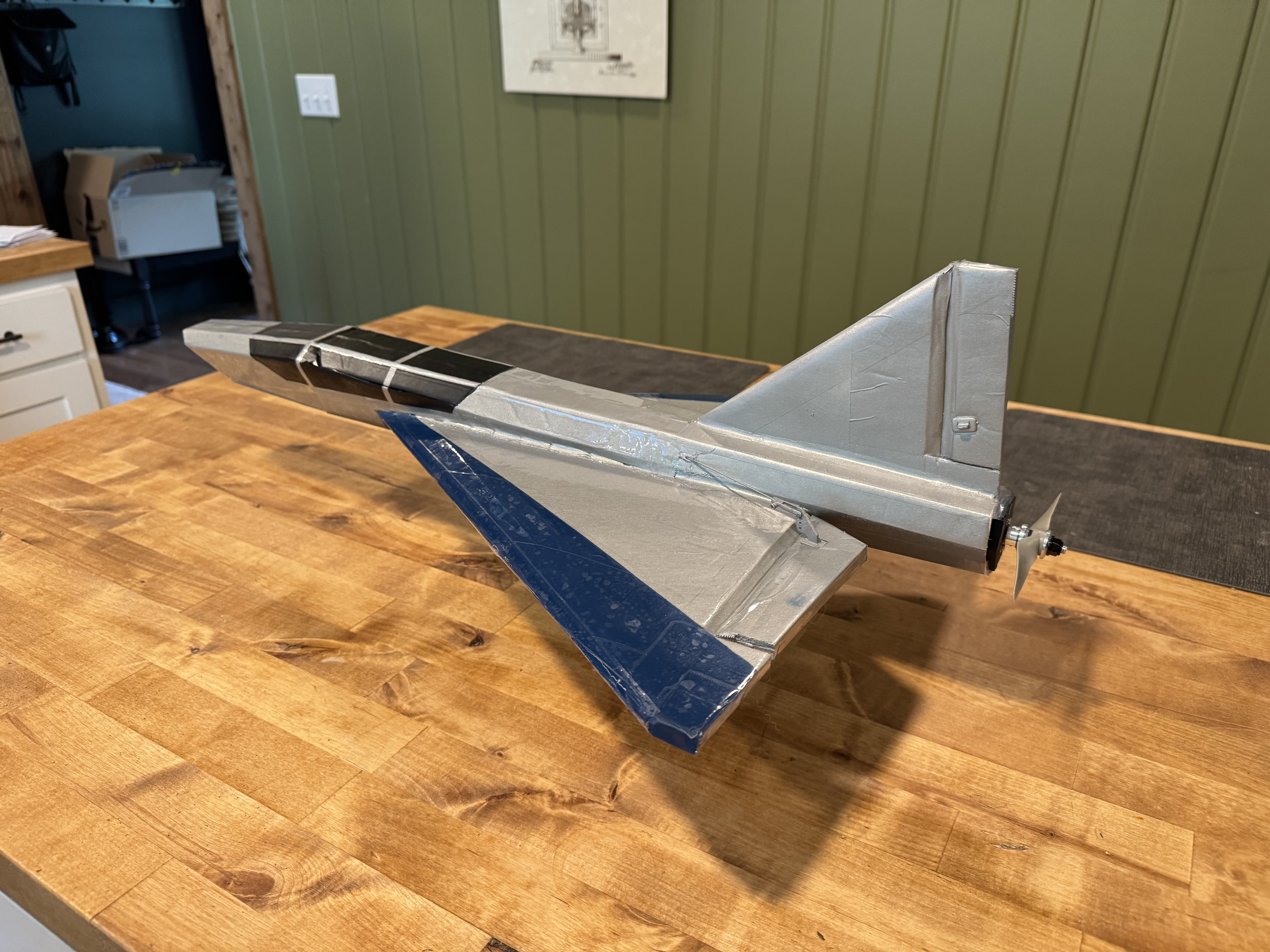

alright wild people….plane 1 of 2 is done.
f106 tribute
80 amp esc
2438 3800kv motor
prop…TBD
A3 Pro V2
first test will be 4s, i may go up to 6s via two 3s 850 mah running in series.
