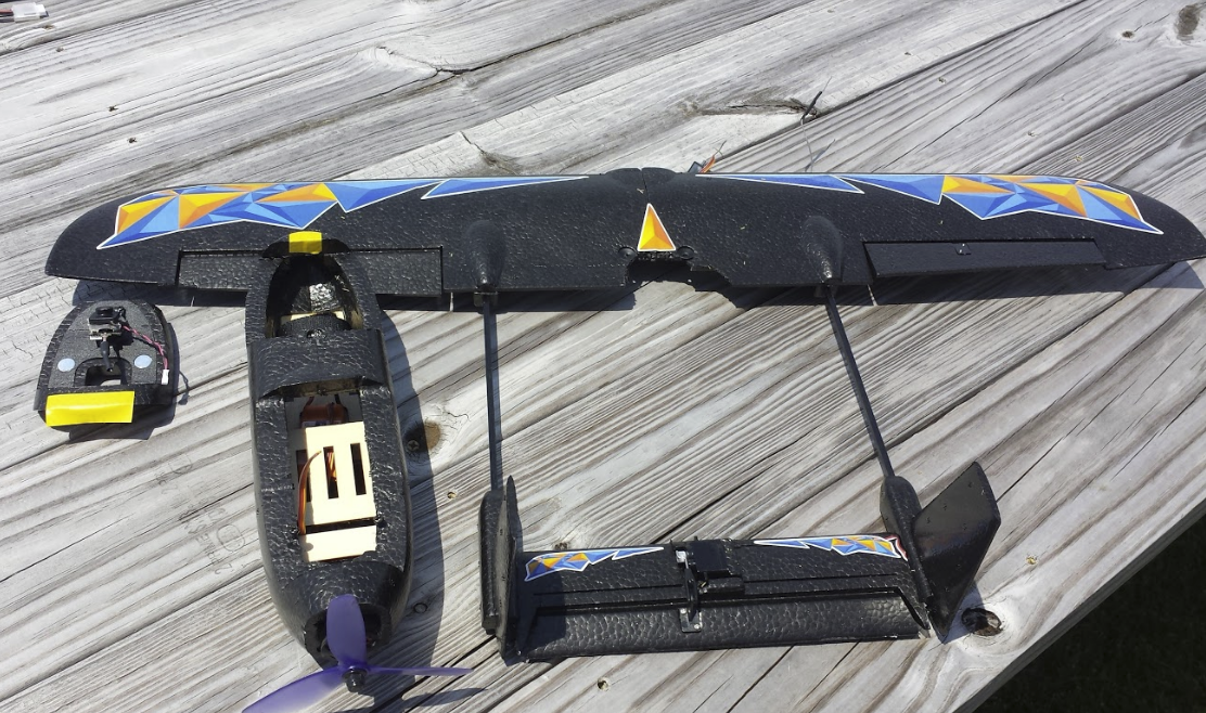

Hmmm, wing separating on a low wing high speed pull up. Hmmmmm
Never had THAT happen, yet. High wing band failure, yup all the time, flutter failures, check. High speed oops impact, yes. Low wing disassembly without folding at center joint, nope cant say I ever saw that. Maybe not enough bands holding it on for starters? I use 6 #64

I’m pretty sure he just folded it and it fell apart…

This was a high wing
There were prop marks on the top of the wing when the pusher fuse passed the wing.
I 3D printed a load spreading piece for the back of the wing and between the wing bolts. Fixed this issue. Then I started ripping elevators off. LOL
The weak spot is actually the glue that connects the horizontal stabilizer to the arms. I may try to resurrect what's left of my three nano Skyhunters for combat at flitefest. Same failed glue took me out last year after a great first combat. Spars and foam damage are extensive, so it will be a heck of a bandaid. But it's COMBAT!!!! Heck. maybe I should 6S it and blow it apart!!!
