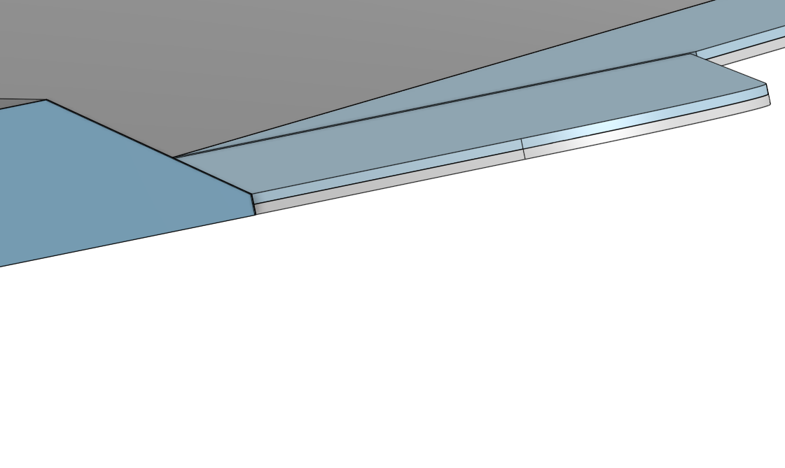

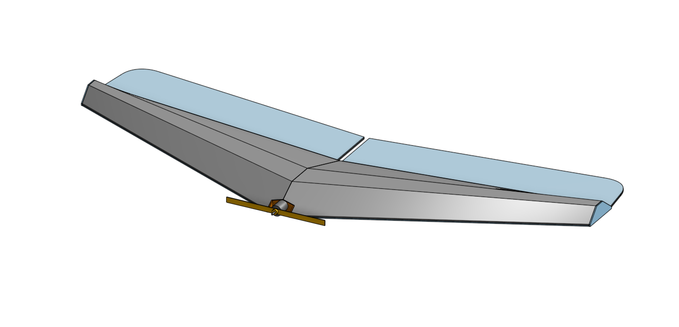

I actually modeled it out the first day the 2026 thread was posted😂😂
Figured I can program the FC to open the bottom control surface and to have it synced with the upper control surface, depending on how much control it feels that it has it can open the bottom one more or less: (If that makes sense😂) (I asked ChatGPT what the best specs would be for a flying wing to be able to fly walking speed and this was the result!😂 (Though I had the idea of the split controls)

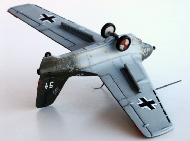

You might have some issues with pitch control even with split upper and lower surfaces - I think you'd most likely just end up with a big airbrake but no extra lift, or such a strong pitch down moment you couldn't fly. The only flying wing I'm aware of to successfully use flaps was the Me 163 which used split flaps much further forwards on the wing. Couldn't find a picture of them on the real thing but here's a picture of them on a model
Ah okay👍 It was just a mock up design😂😂 (I kinda wanted to explore some new areas, and was considering making a smaller version of whatever I do ..aka 4-5ft wingspan instead of 8ft🤣)

Thanks for the advice!👍
