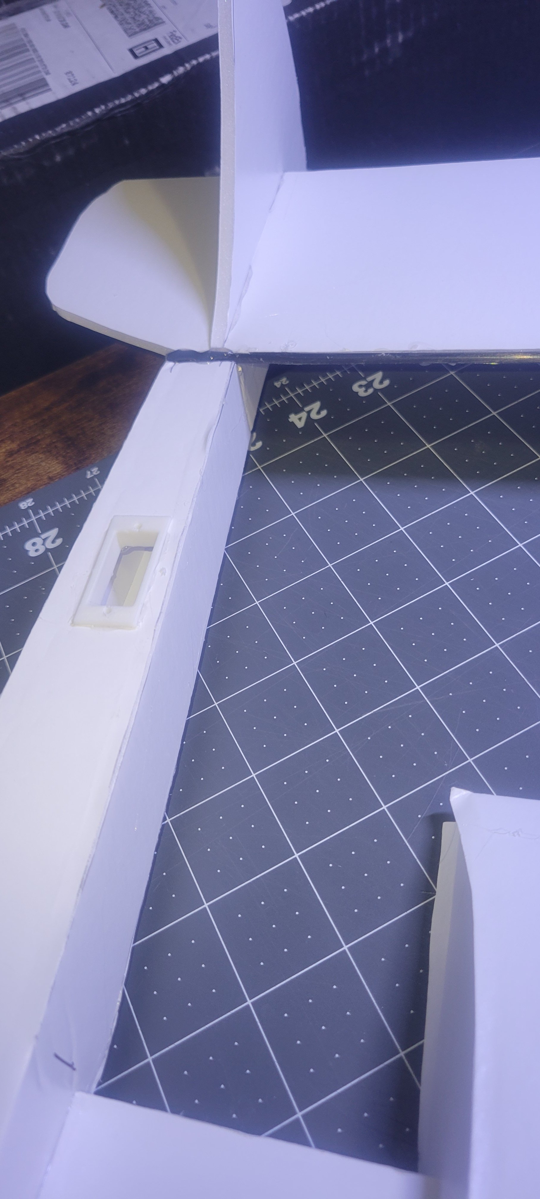

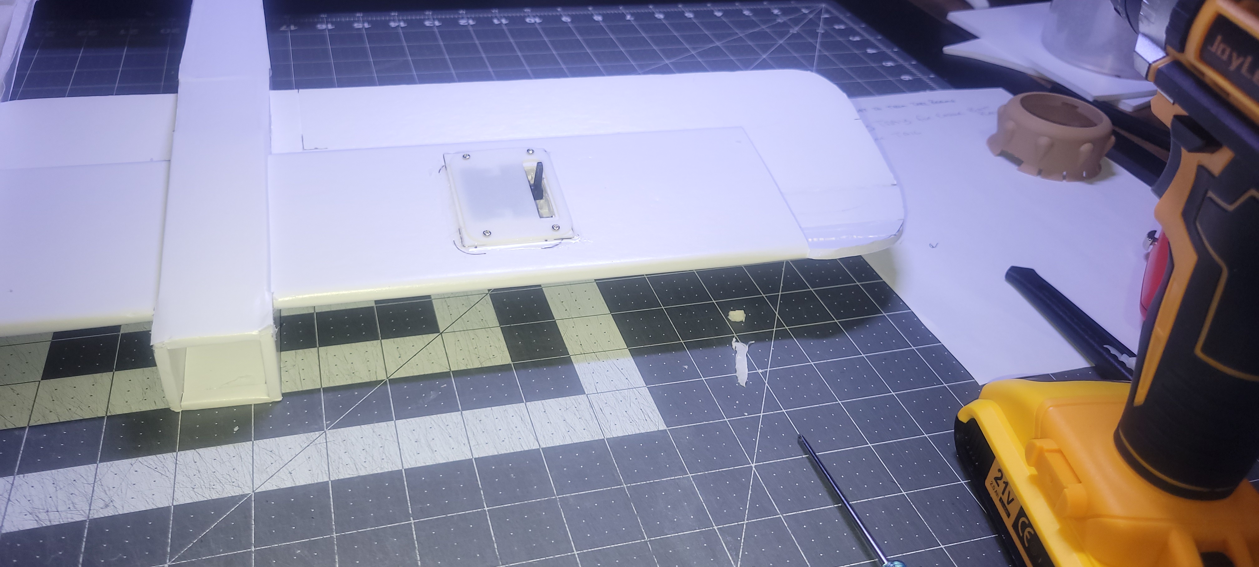

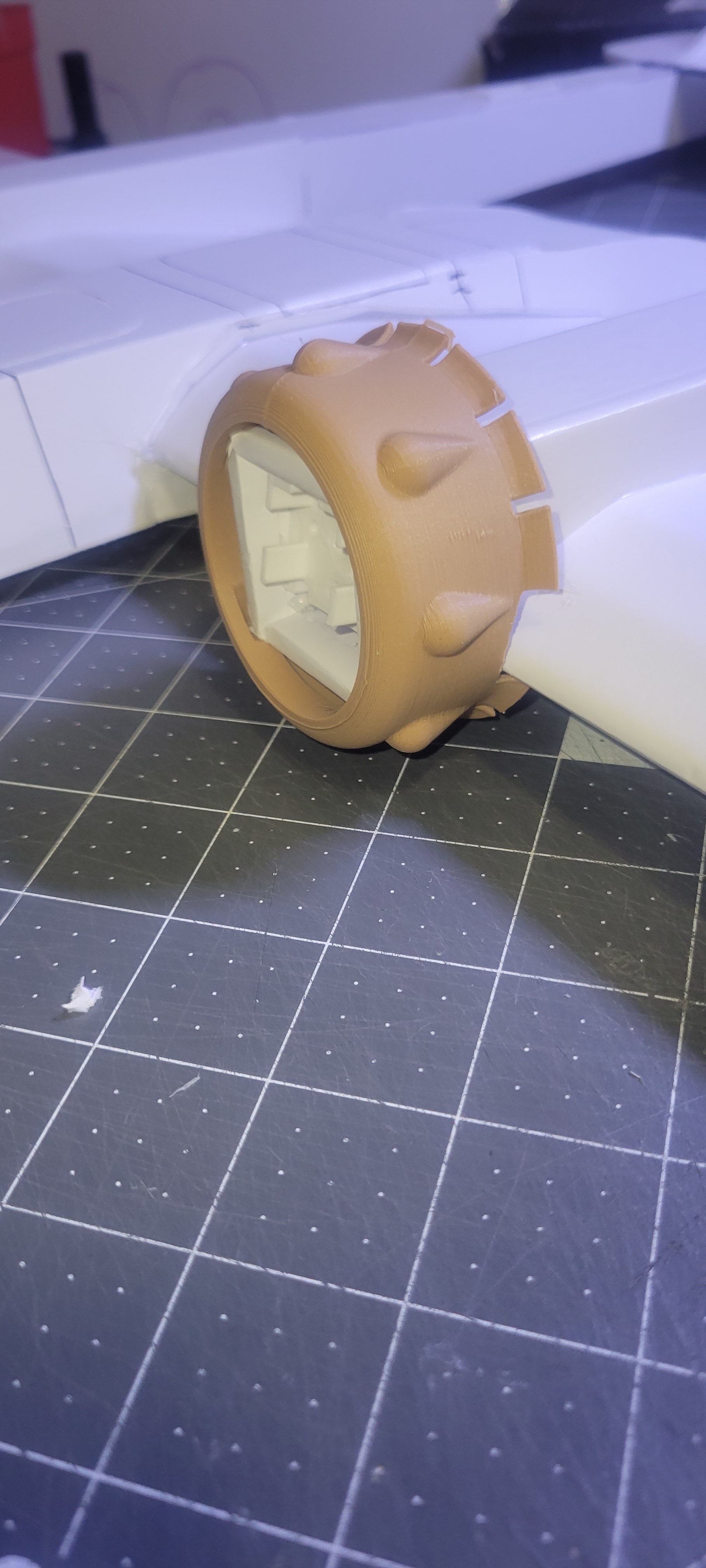

Servo mounts installed (I don't glue them in unless I have too), and cowling printed for the Duckling.

Ahhh! Makes sense less reflex, less drag. And I just designed motor mounts for it. Now let's see if I can figure out how to make a motor mount with thrust angle. Just a couple of degrees right?
yup, I also found that you can just move the motor mount in such a way to give it angle as you glue it in. As it has no supports other than the glue holding it onto the skins 😂. (I made my firewall 8mm thick for better adhesion)
