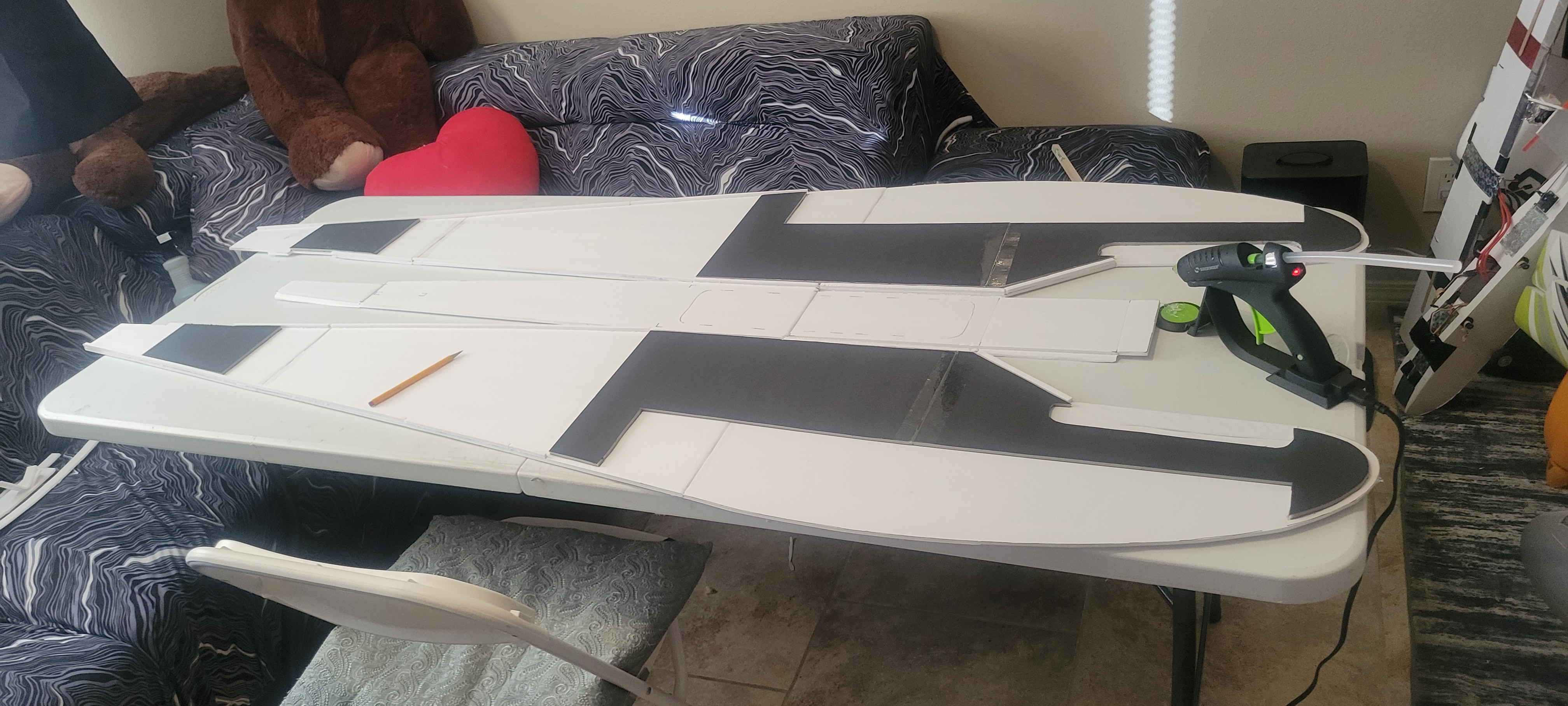

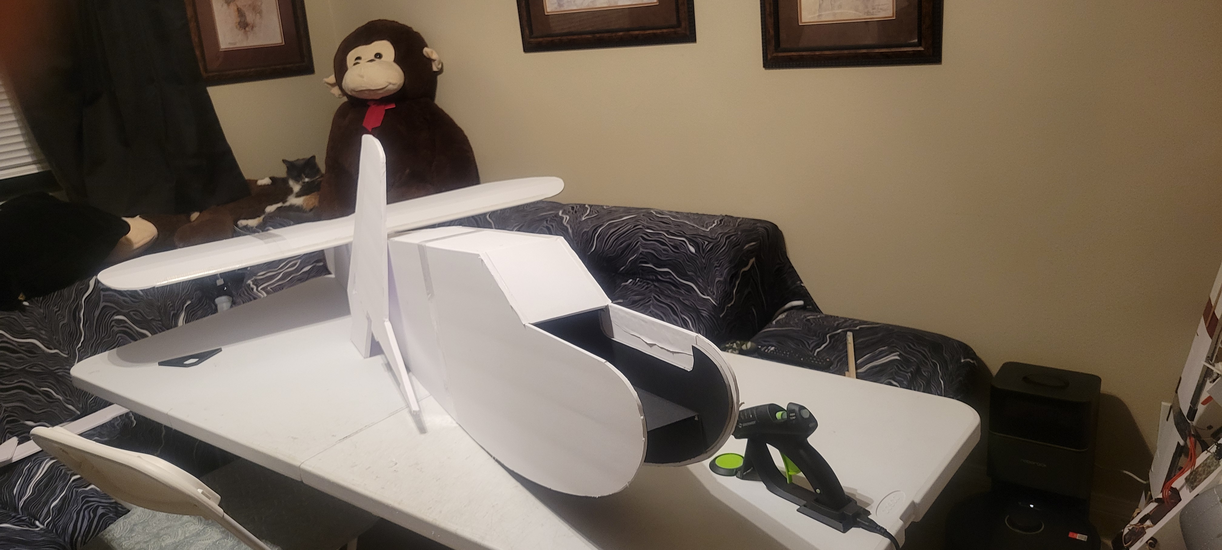

Been working on this for a few months. Gonna finish it this time. More Photos and details to come.

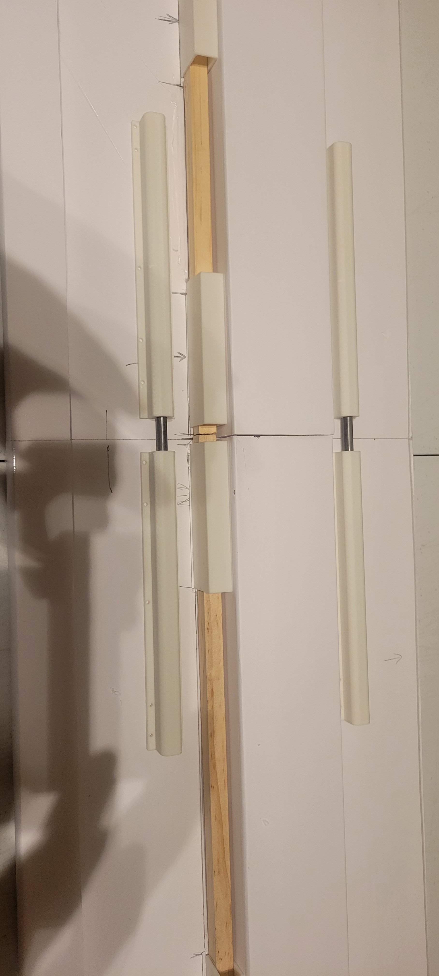

Wing attachment:

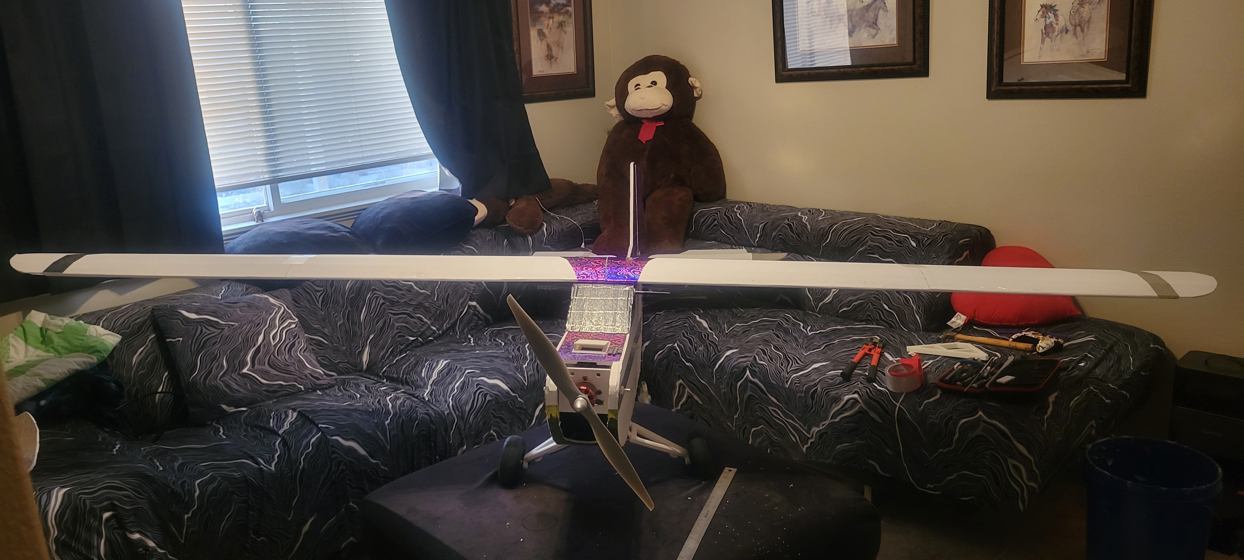

RickHunter
This thing is going to come in just over 12 lbs. fully loaded (not including the payload aircraft). With a wing loading just under 1 lb/ft² if I did the math right. She should be a easy flyer to handle. Finished installing the Servos today, will work on the control rods and control horns pry tomorrow.

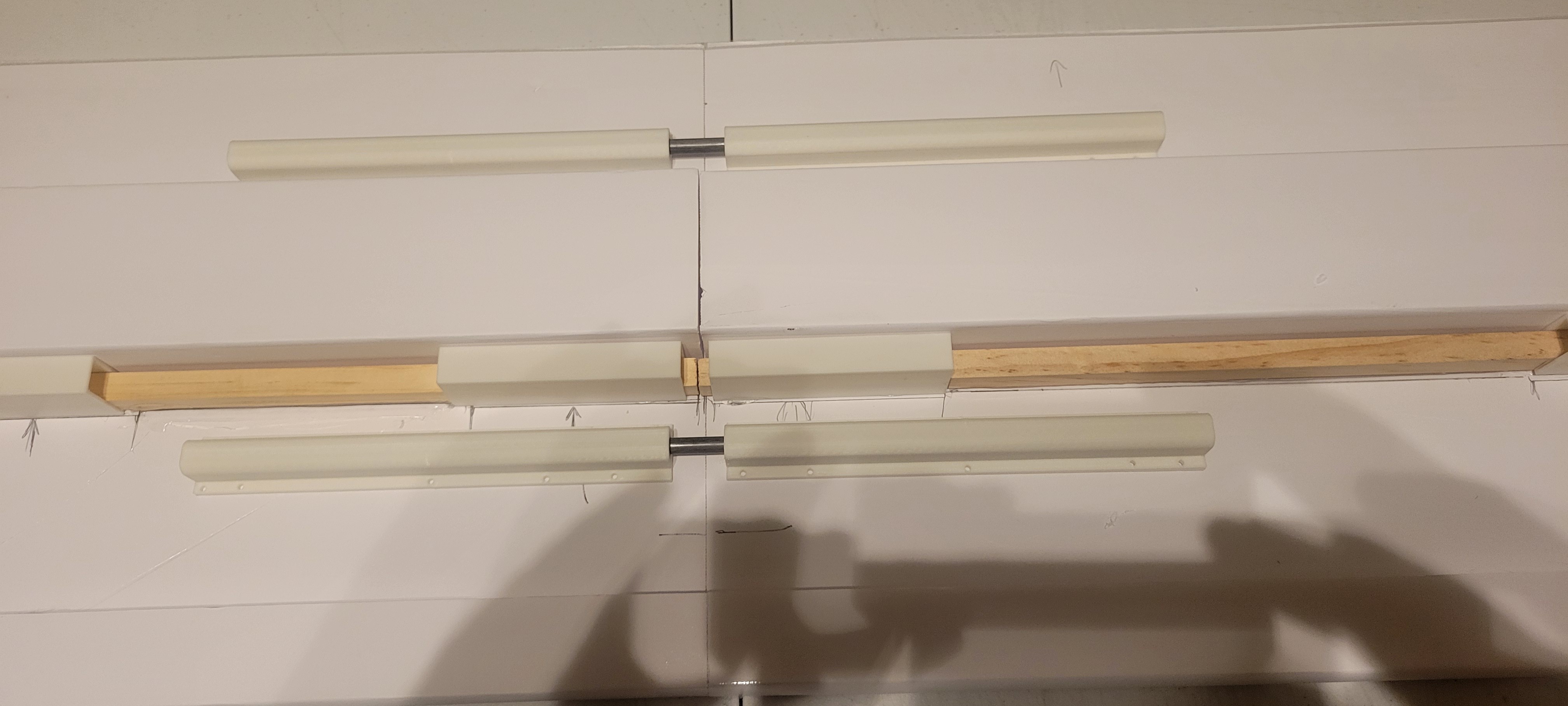

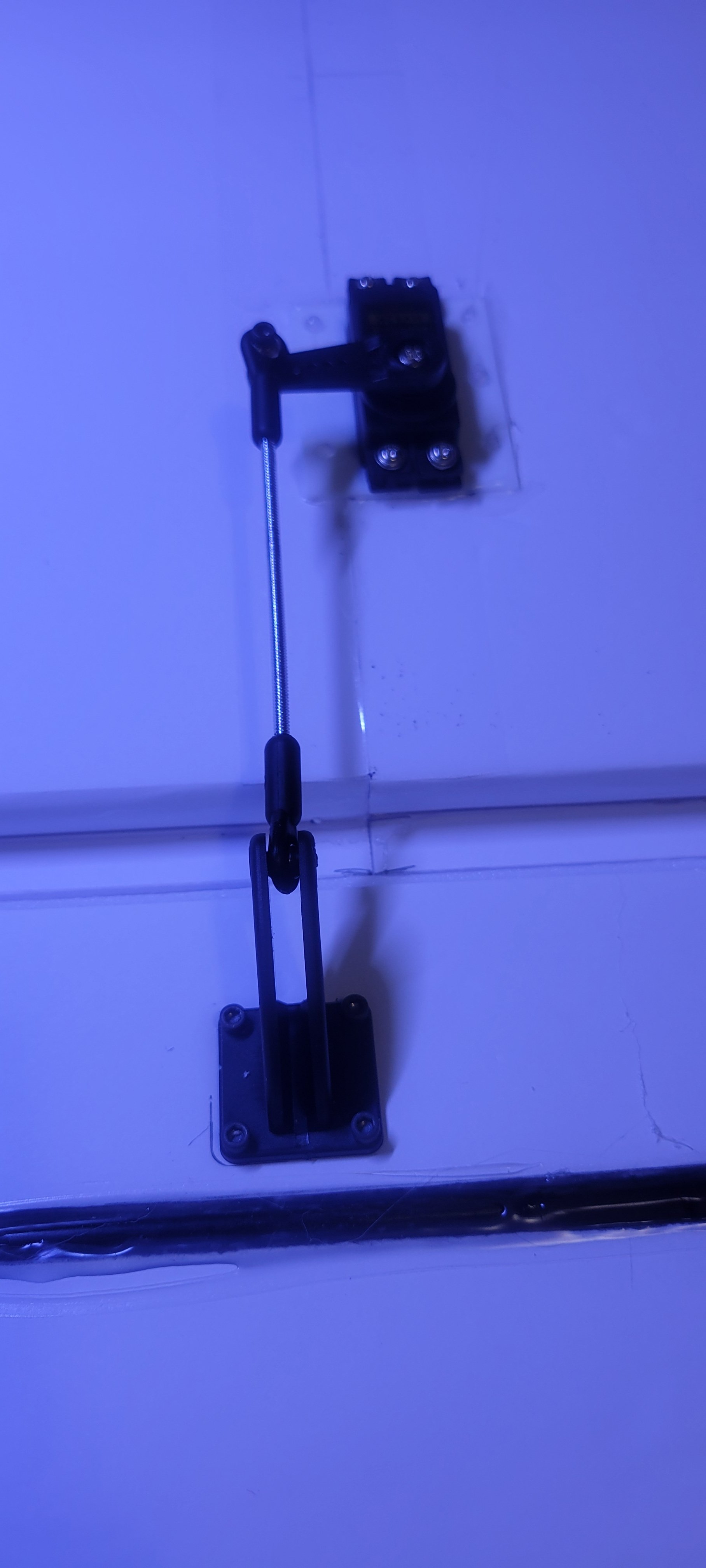

RickHunter

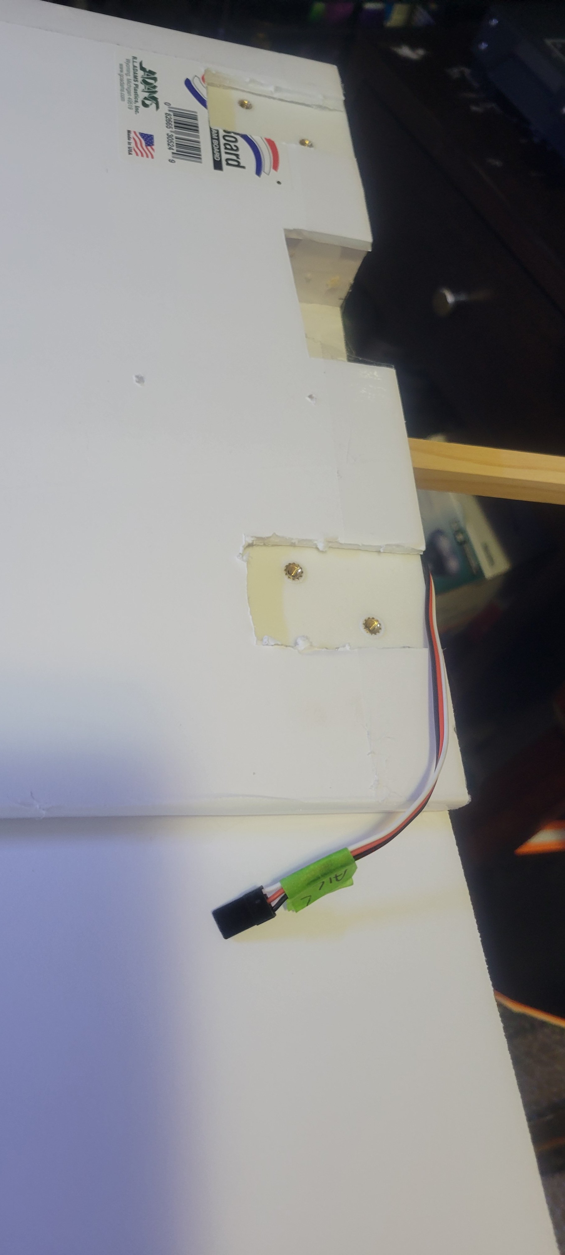

Haven't been able to work on anything for a while. Got the control rods and horns installed in both ailerons, and brass inserts for joining the two wing halves. Just the rods and horns in the rudder and elevator, landing gear, and decorations to go. If there is time, I might get the payload aircraft attachments done too (i might have to build the jet first to get the right fit), so we will see how it goes.

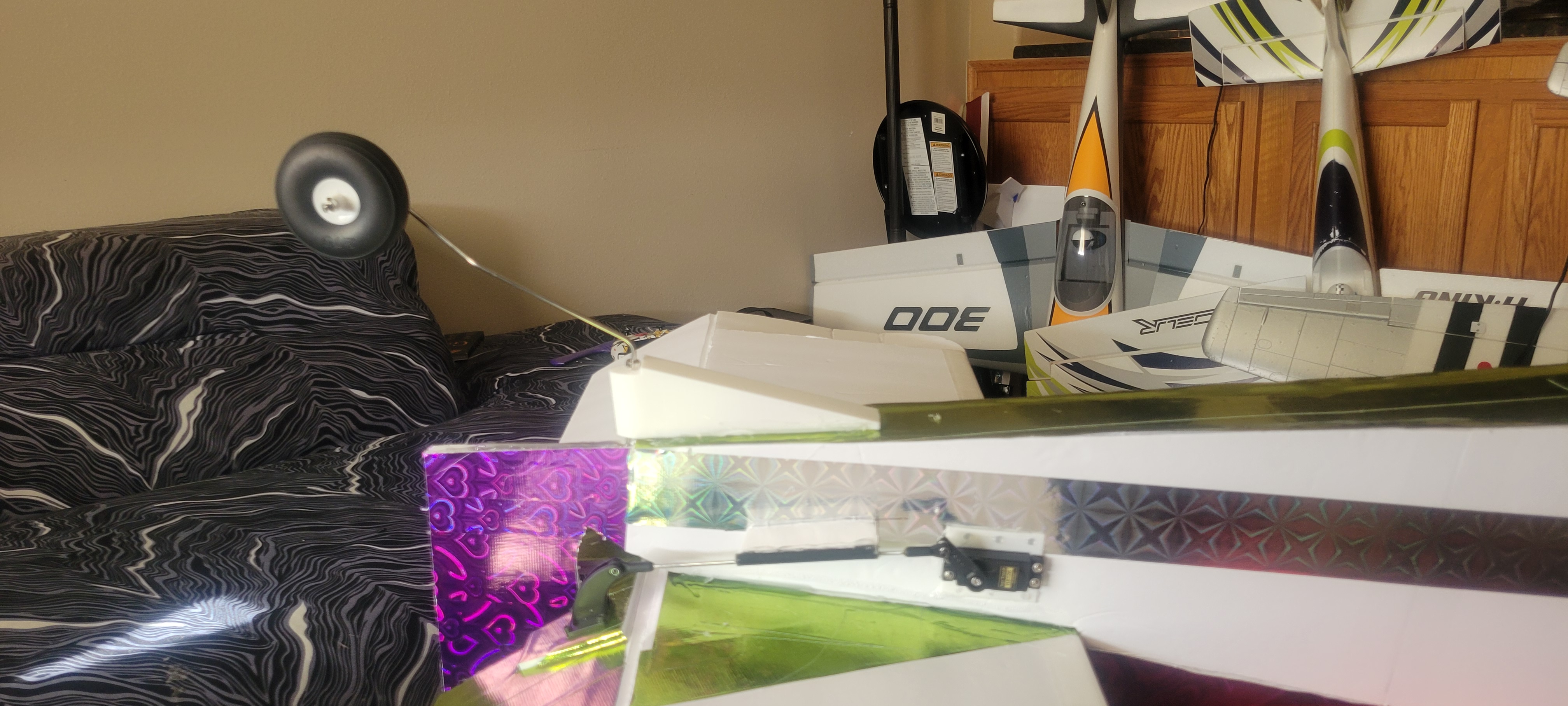

RickHunter

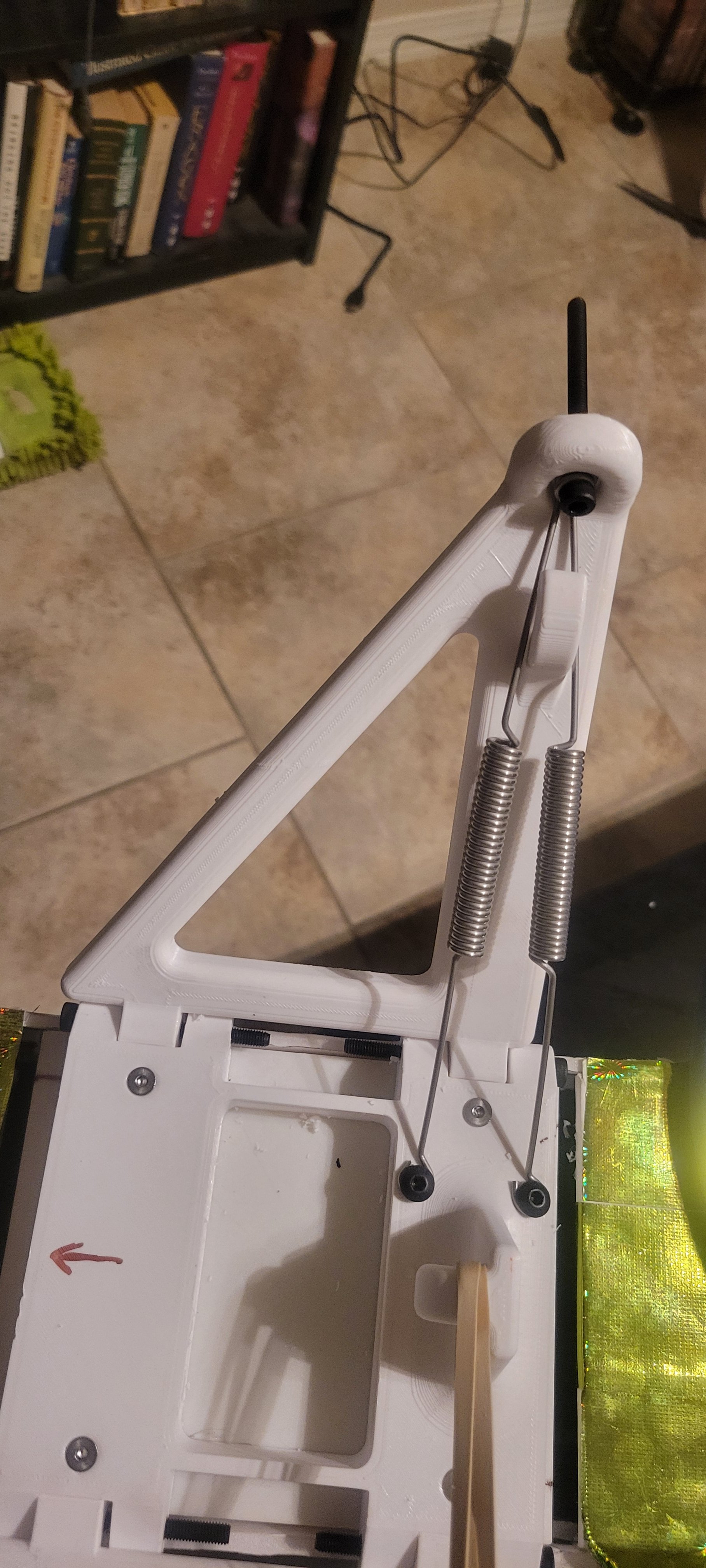

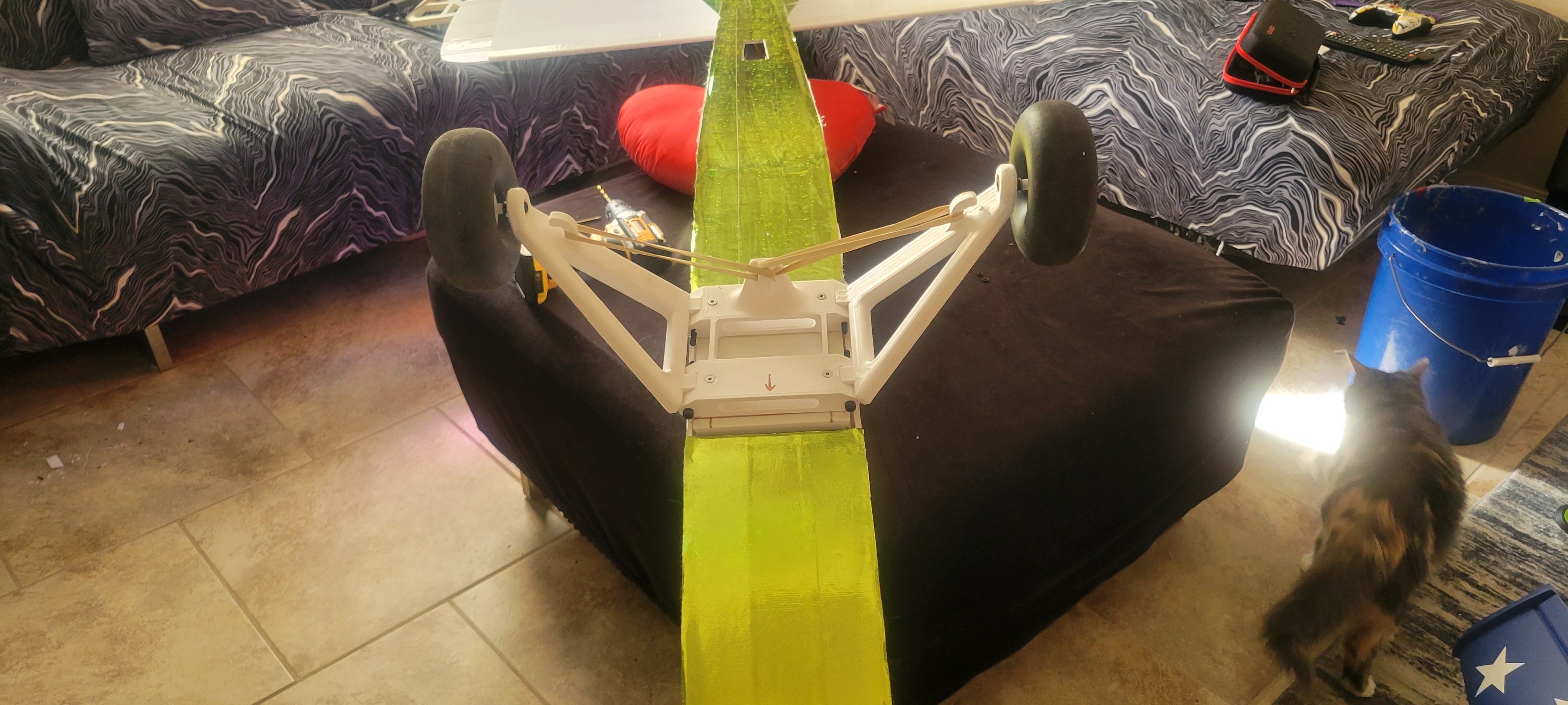

Finished the elevator and Rudder control rods and horns. Installed the landing gear. The rubber bands are just temporary, they will be replaced with some springs from a Twin Timber or maybe some throttle return springs. Then just need to slide the power pod in, hook up the receiver and she's ready to go.
RickHunter

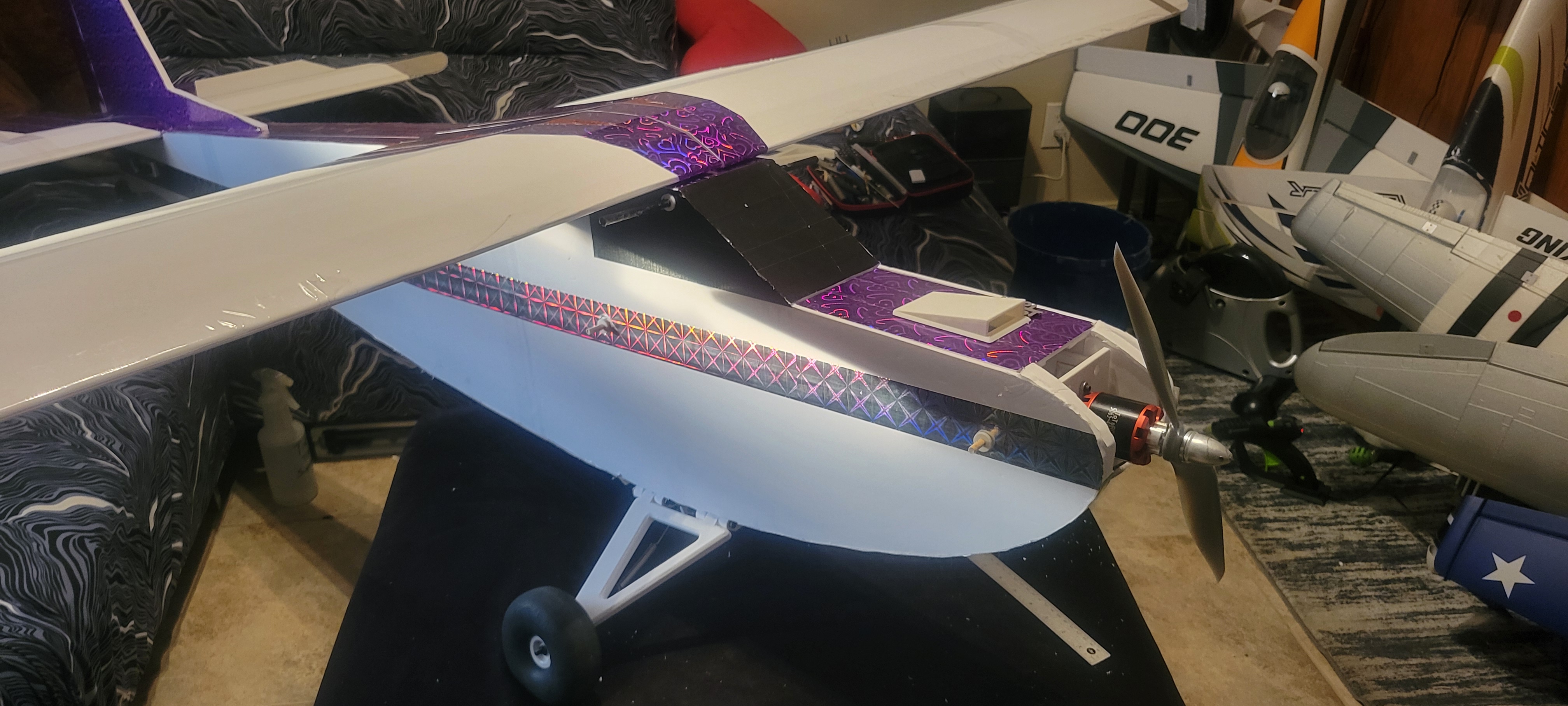

She is done! Ran out of reflective tape at the end, but had enough to cover everything but the wing tips. As usual pics don't do these monsters any justice. She runs a 6s setup on a 5065 400kv motor with a 19x8 propeller, and a 80amp esc. Hopefully I will get a break in the weather to maiden her in the next couple days.
