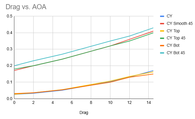

Generally solid advice for building a fast plane. In general, with drag reduction you get the big improvements by improving the overall shape of your plane (planform, airfoil, etc.) but this doesn't really matter without all the small improvements (covering gaps, removing sharp corners etc.).
As an example, for the Super Duper Sabre, the big improvements came from the shape of the fuselage and the choice of aspect ratio and airfoil for the wing and tail. Those enabled me to design a conceptually very fast airplane. However, the little things were still important. The use of internal control linkages keeps me from losing 4 mph off a 150 mph top speed (it's about 1mph lost per pair of external linkages for this design and 5 of the 7 linkages could be made internal).
The use of gapless hinges reduces total drag by about 8.5% (about 17% for just the wing which is about half of the drag of the aircraft) which keeps me from losing about 6 mph off a top speed of 145.5 mph. The data is for a Clark Y airfoil and assumes a 45 degree beveled hinge for the top and bottom hinge positions. If anything, the laminar flow airfoil will have more of an impact. For very thing wings, this is much less pronounced and for draggier foam board designs, I don't know if it really matters.
Having a tail cone on the back of the motor boosts thrust by about 6% which is another 4 mph (so much better installing a tail cone on an inrunner than an outrunner). I don't have data for using recessed screws vs. surface mounted, but I'm guessing that's another 1-2 mph across the whole airplane. So right there, just those few things could knock in the range of 15-16 mph off the top speed. Having gear doors in and of itself probably gives me another 5-10 mph right there.
It's very easy to take an aerodynamically excellent design and then cripple it with unnecessary drag.
