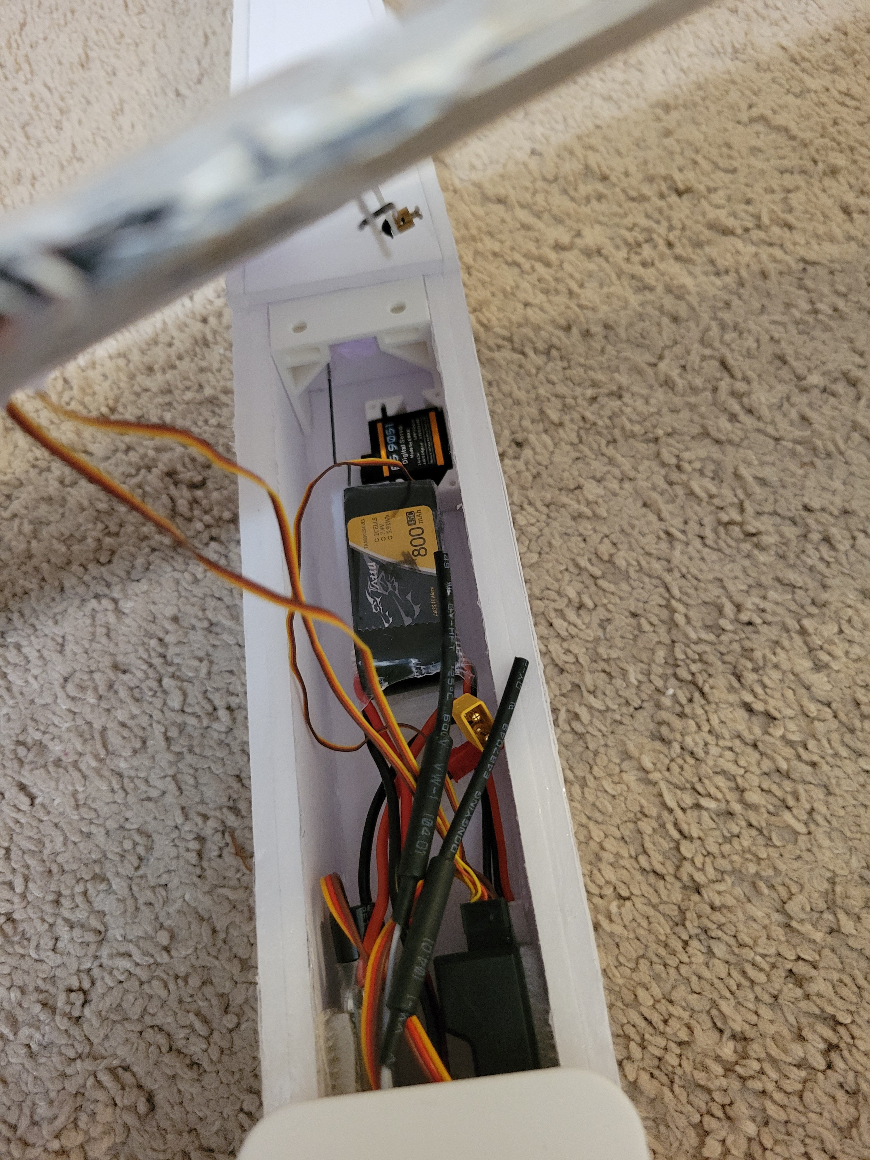

2S battery looks positively tiny in there, though I intentionally designed the fuselage to be able to hold larger batteries:

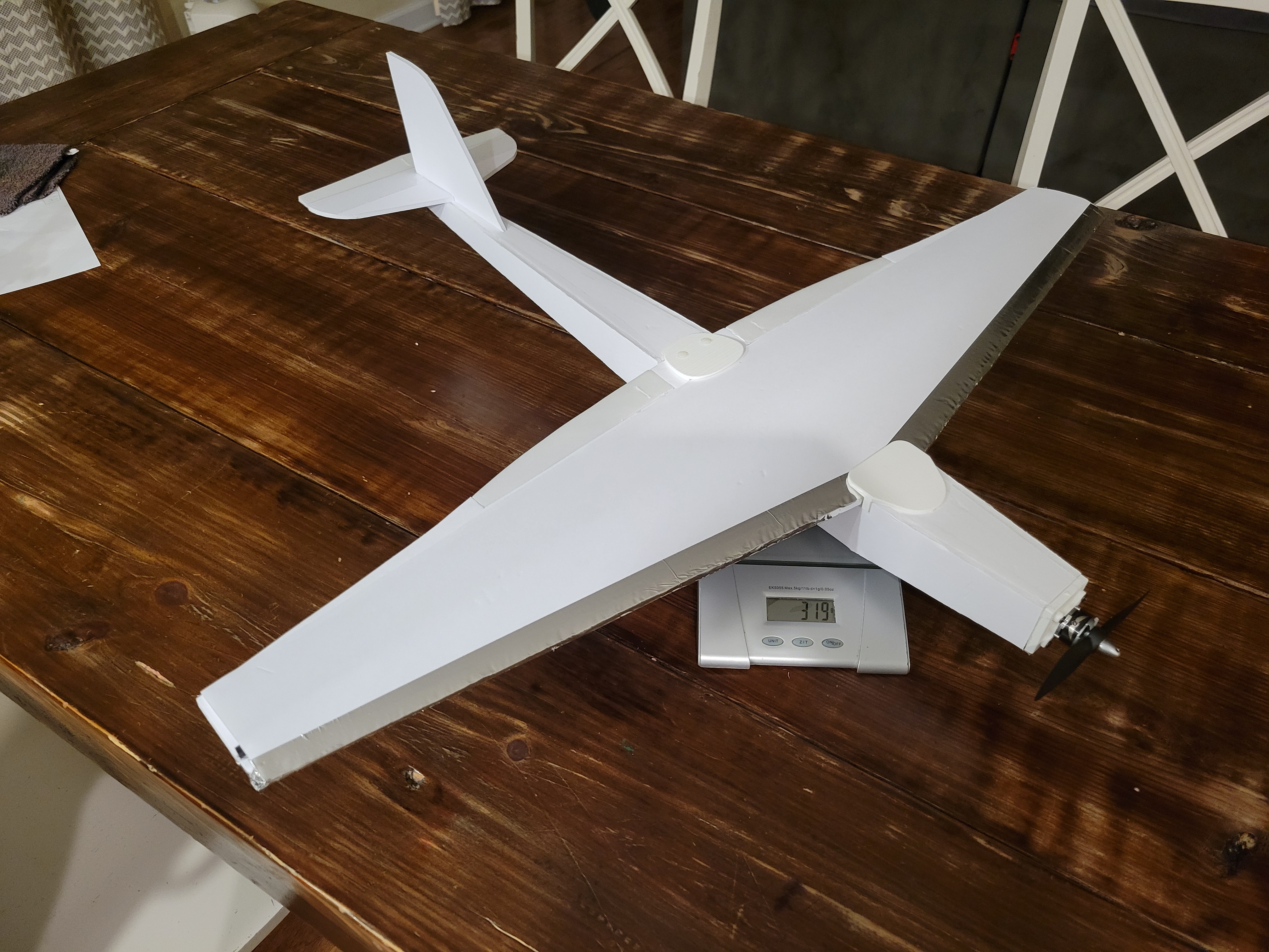

Put it on the scale. Ready to fly with the 2S battery it comes in at 319g. Not bad compared to my CAD model which said 299g, and that doesn't include things like glue, tape, pushrods, screws, and so on.
