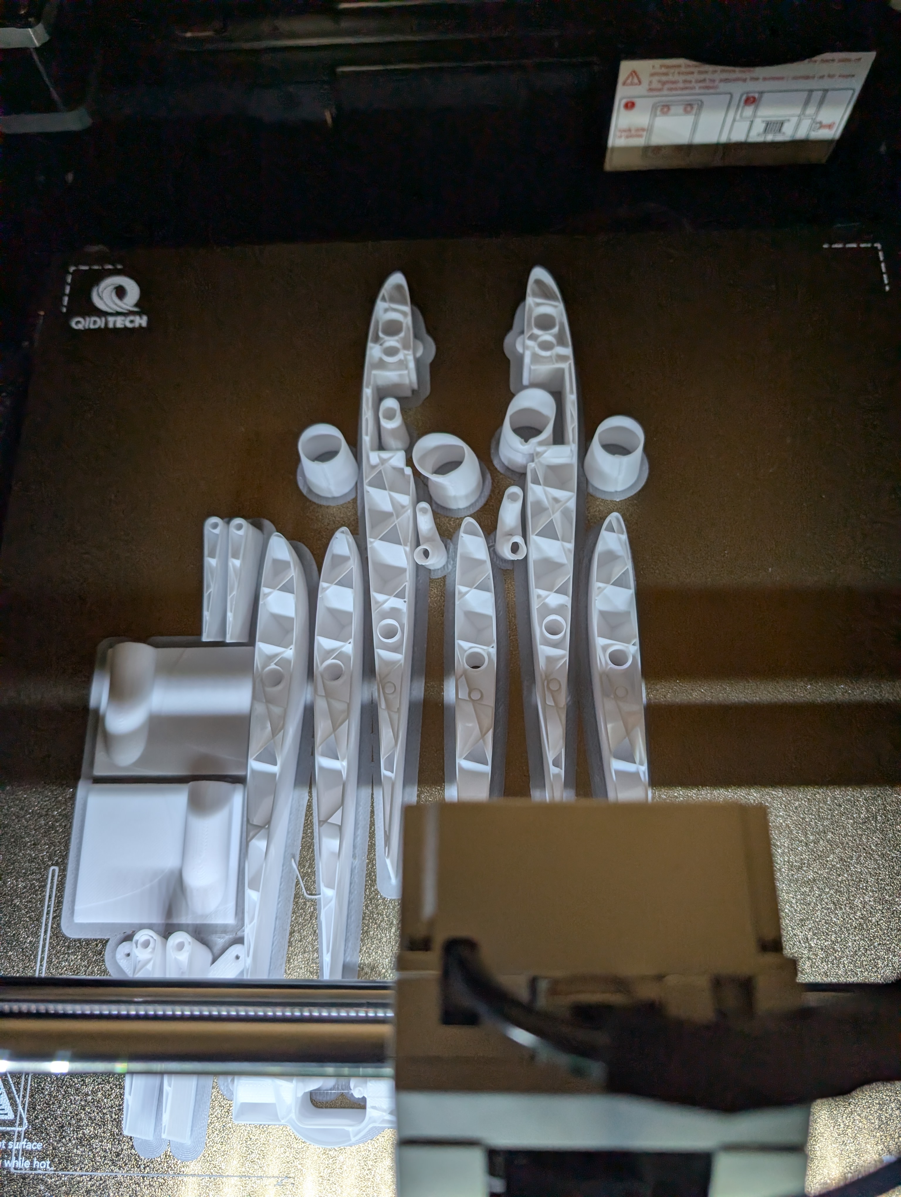

This Eliminator build is probably gonna be a little slow as I'm super busy with work and exhausted when I get home, but I'll get it done eventually. Just ordered a pack of PLA+ and got my 3D printer logged into the network at my new place. Gonna need to order the power system soon.

Parts are in production 😎

I'm printing the final piece (forgot the tail fin) and cleaned up the other pieces earlier this evening. The new Eliminator will be ready for assembly once I cut the CF bits.

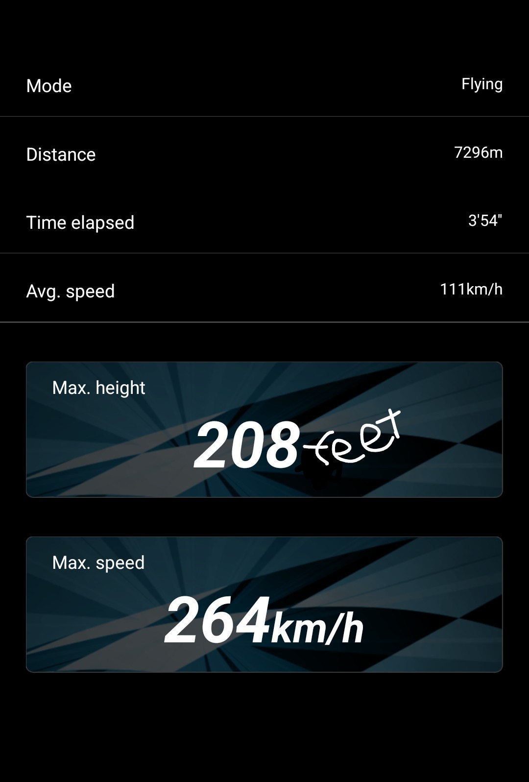

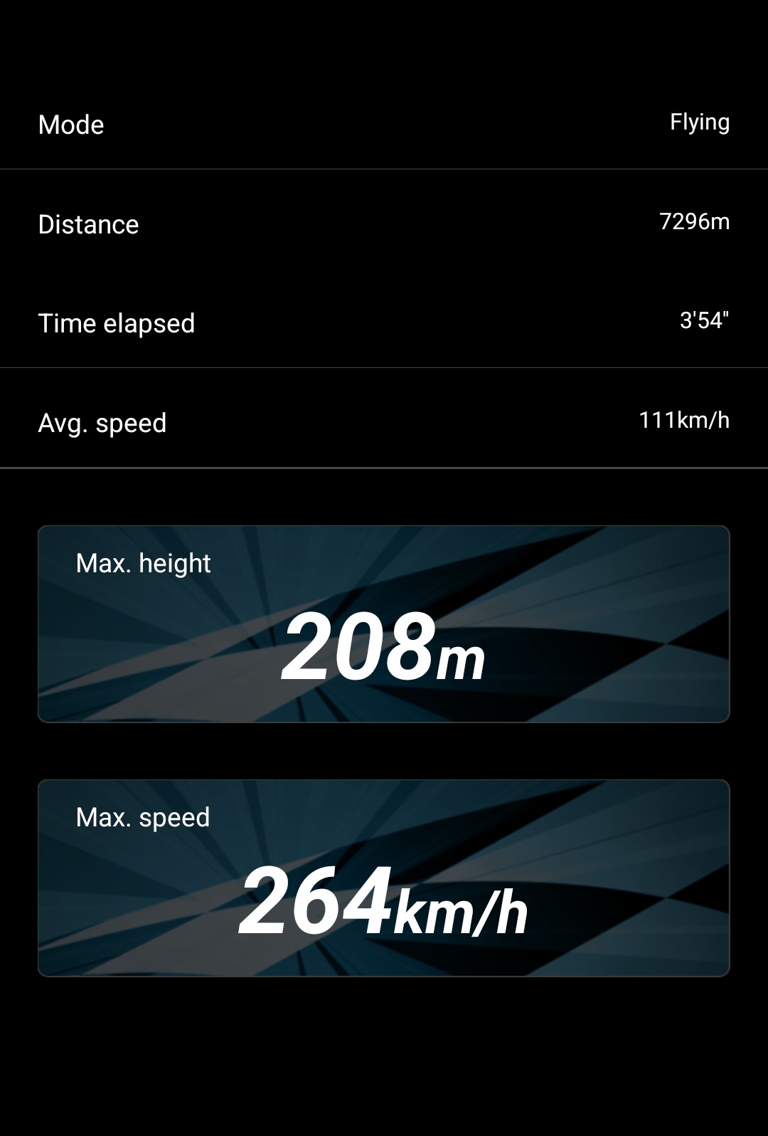

Soooo I got a flight in with the GPS and I was actually getting 164mph, quite a bit faster than I thought.
Wow. Nice job. That sets the bar high. It's gonna be fun to try and beat that. We got some work ahead of us now. Don't know if my Radjet can beat that. I do have a plan B just in case. Do you have a video?

No video, I was out testing drones for work today and just threw the Eliminator in the truck with a battery so I could make sure the GPS module worked.
To clarify:
THIS WAS NOT AN OFFICIAL ENTRY, THIS WAS A TEST OF AN OLD AIRCRAFT
Good job man! What motor/plane was that?
Stunt Double Eliminator, 3D printed (PLA+) twin motor wing. Motors are Emax Eco II 2306, I THINK 1700kv (MAYBE 1900kv, but pretty sure 1700kv... they don't say on the bells) on a 6S 1800. Props are 5.2x6. The prop change alone made a massive difference from the 3 blade quad props I had on it originally.

And y'all must be blind, that clearly says feet and not meters 👀
