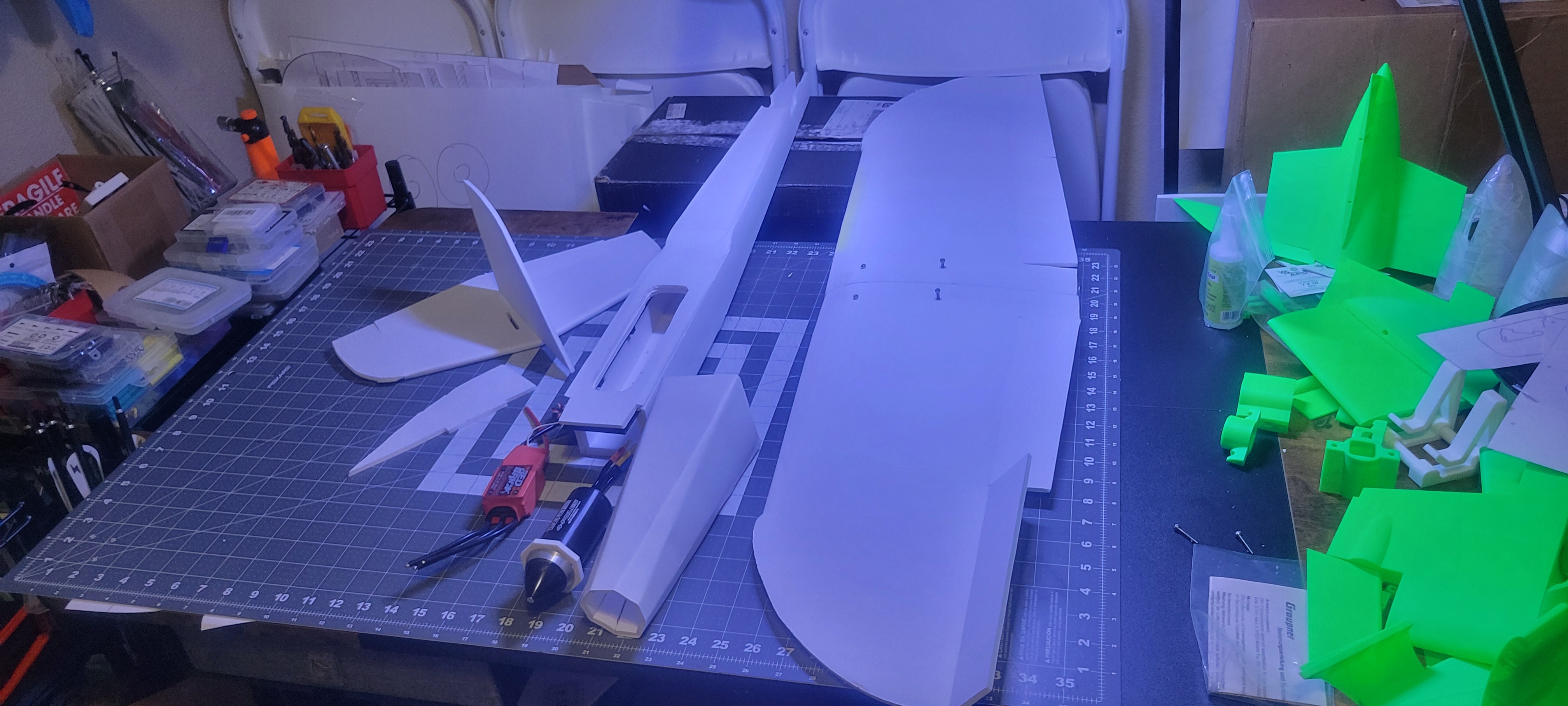

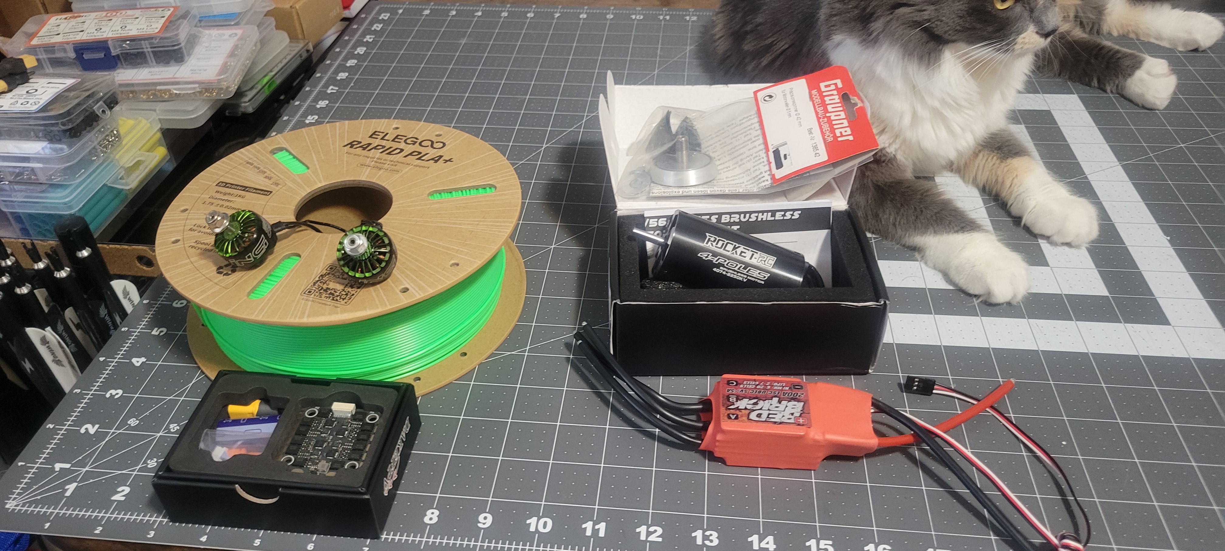

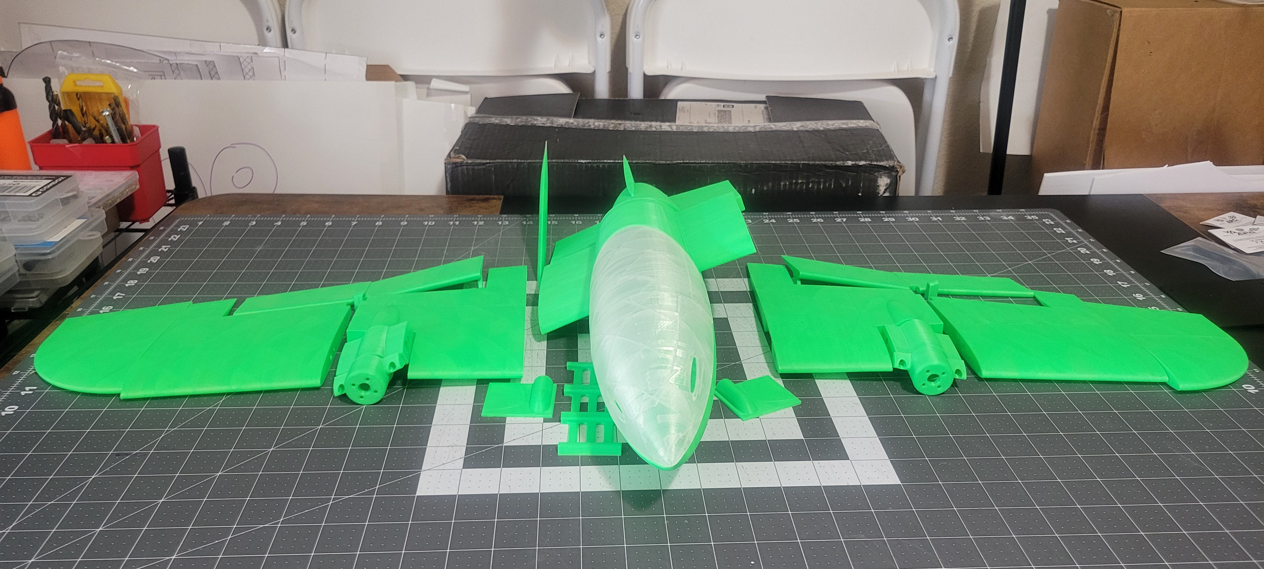

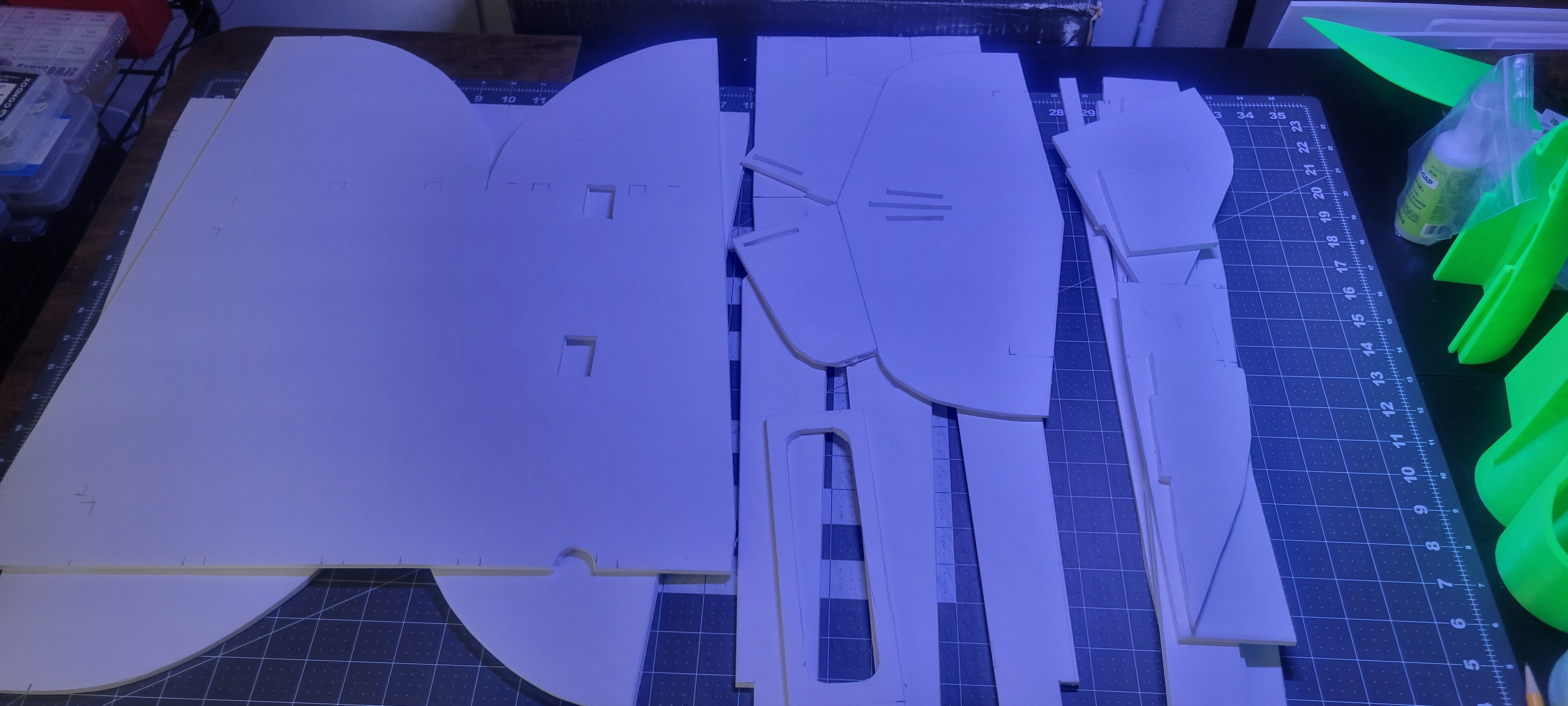

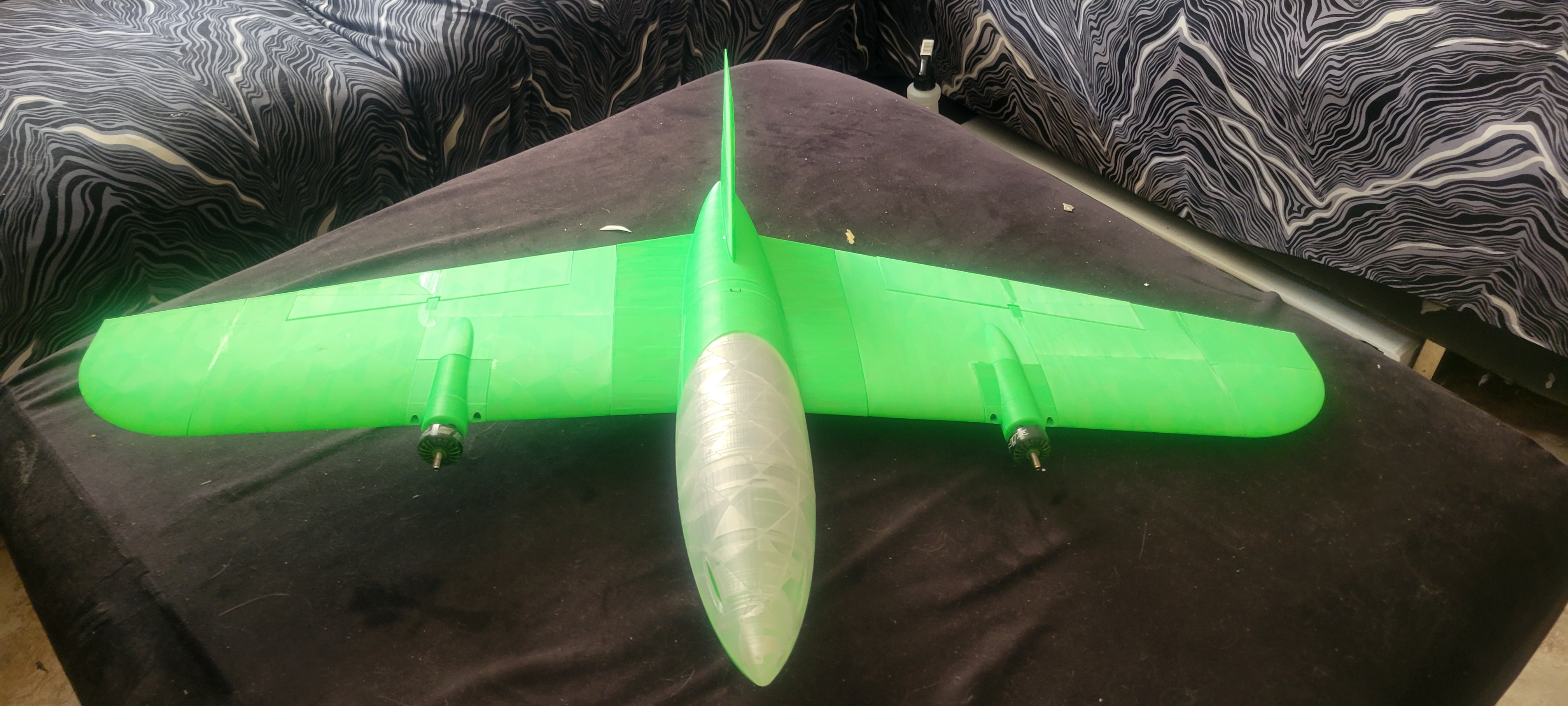

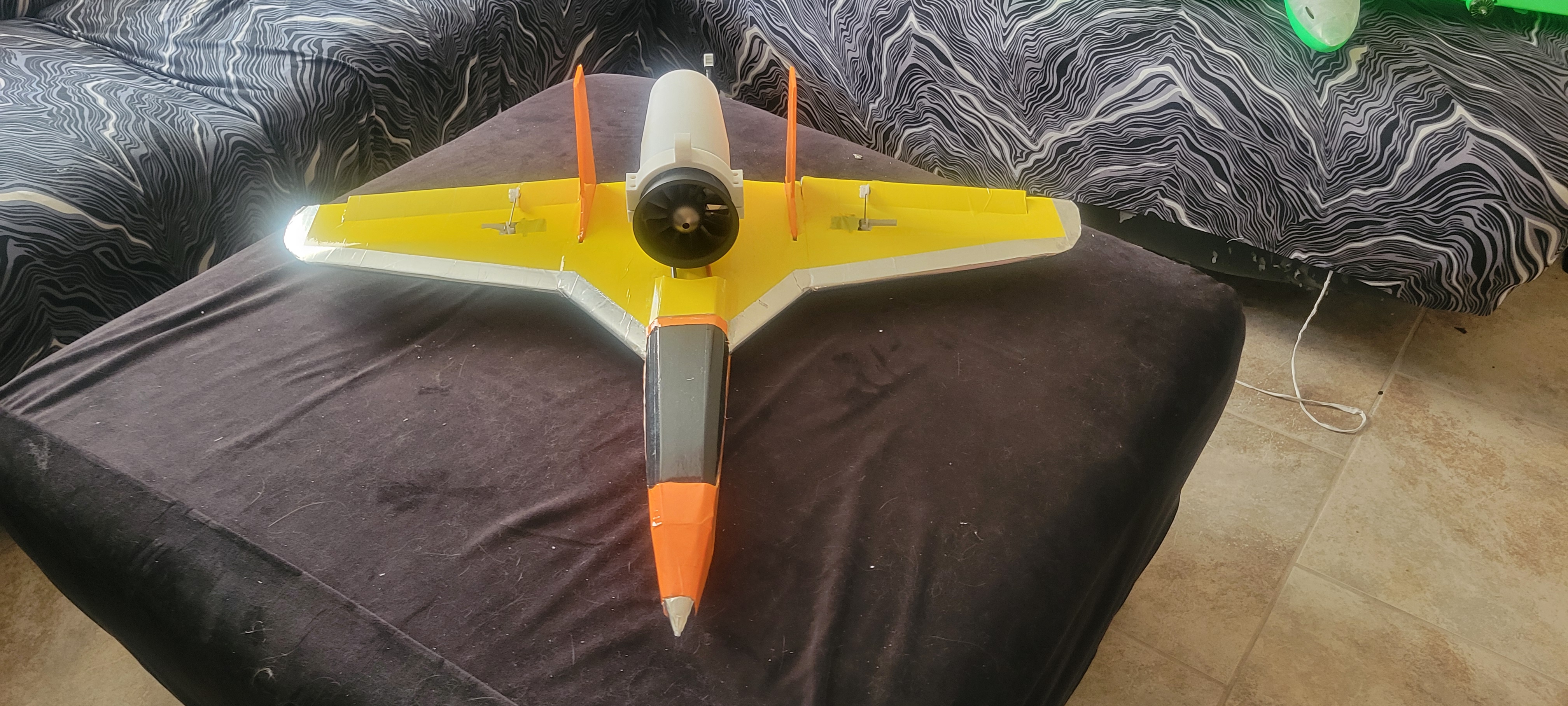

She's a pretty easy build(after close examination of the few pictures available), should be able to finish her and the Eliminator up by the end of the weekend. I used PETG on the Sharknado instead of plywood, so we'll find out soon if that will hold up. Also going to try a 4in1 70a esc for the first time on the Eliminator.

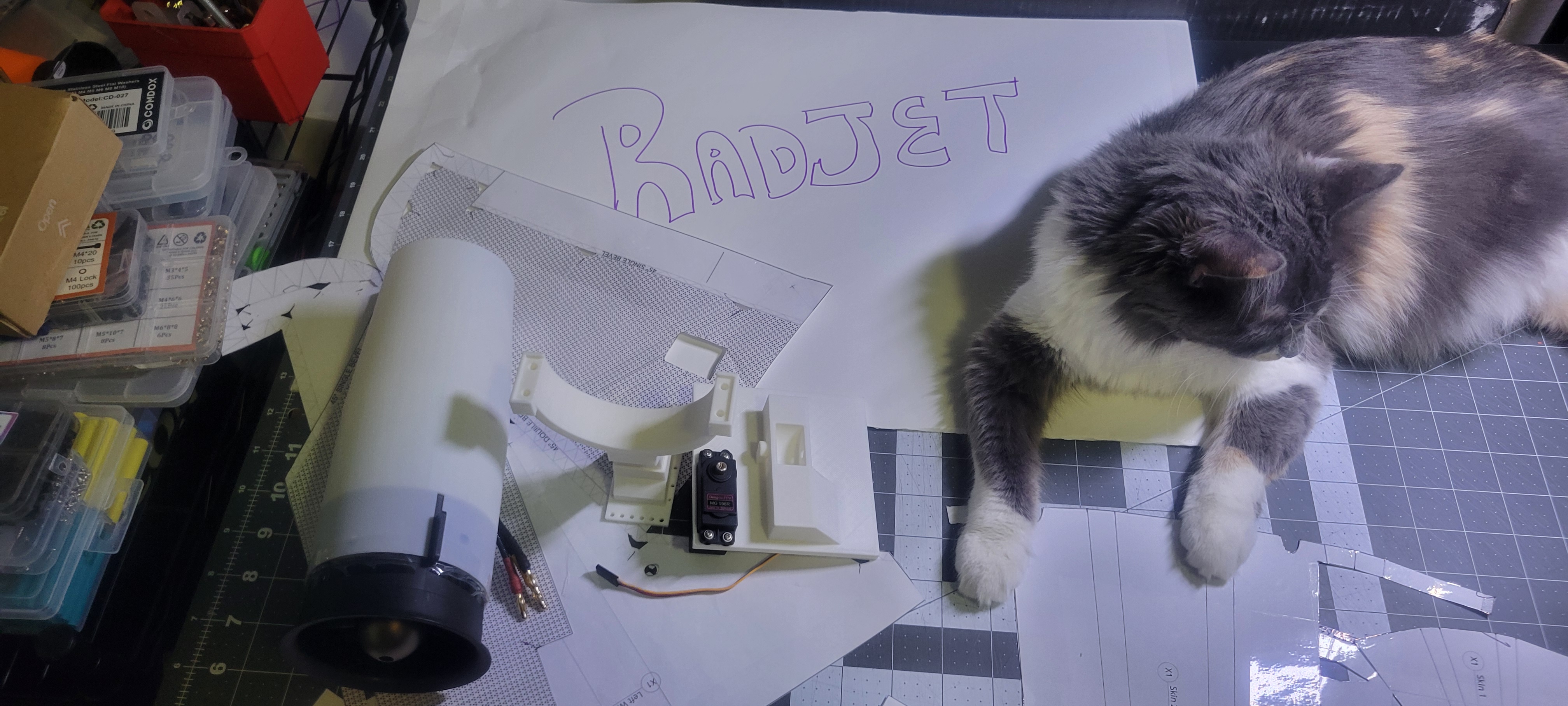

Nice!! I got most of my Radjet cut out last night.

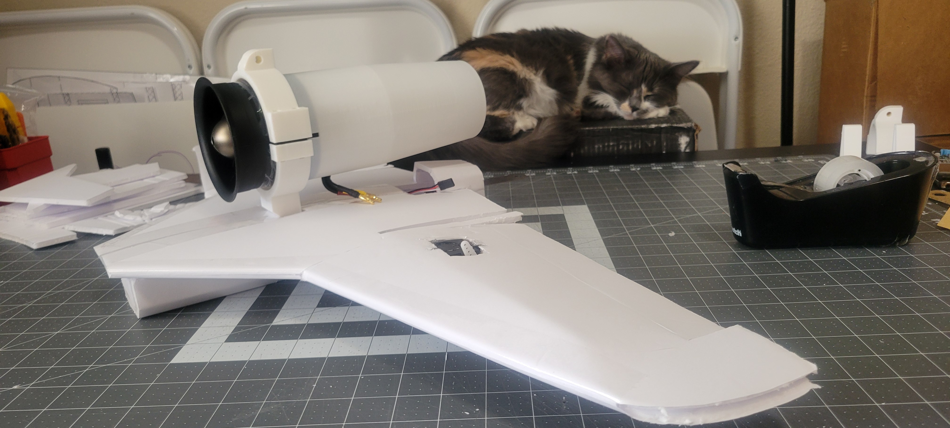

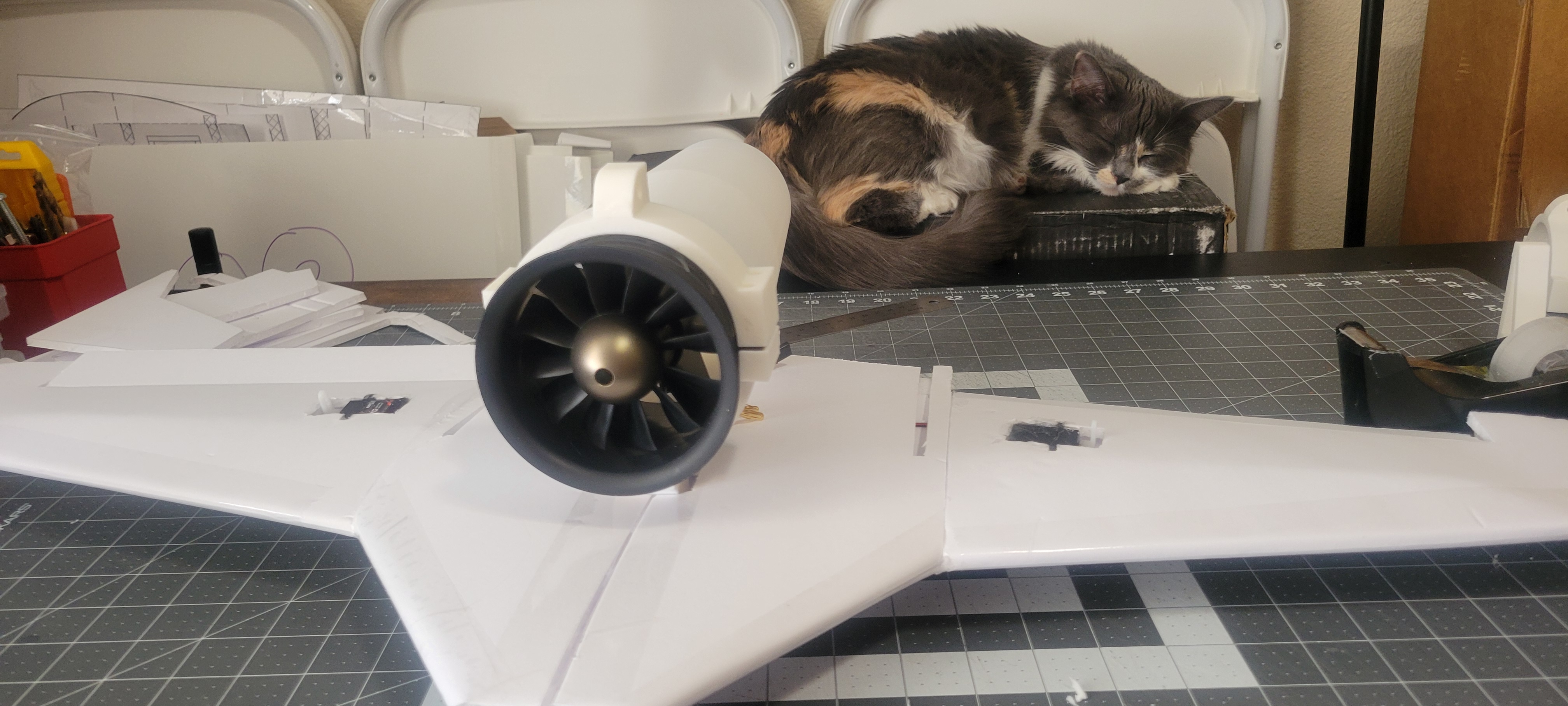

Just need the control rods in mine and she's ready. Messed up and glued the control horns on already, so gonna have cut a couple notches out by servos to get the arms unscrewed to put the rods in. No big deal. Not sure yet on mothership launch(due to weight), if not I'll just print out a launch dolly for her.

I think it will be able to lift it👍 I lifted 2,000g with my XL simple scout (no gyro or anything) and my radjet last year weighed around 650g.. Even though I had to fly it on full throttle the whole time, it actually didn't fly that bad! (I had it very over powered with 3548 1100kv motors😂)
