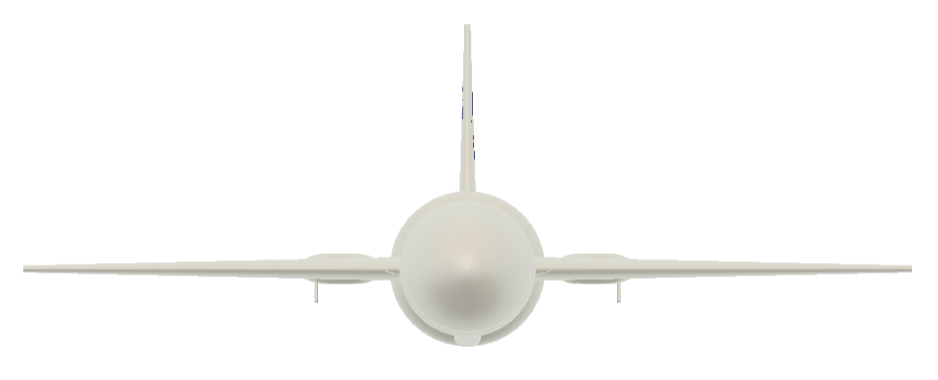

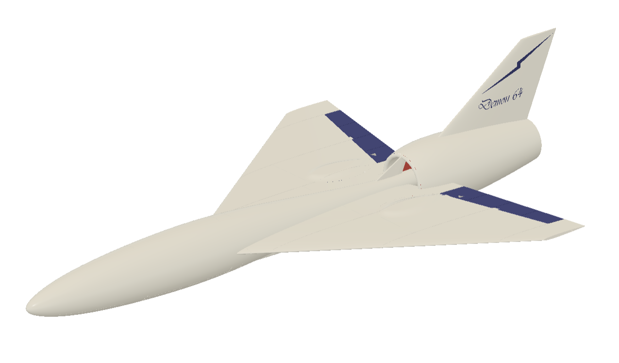

Sometimes a project just comes together. The 64mm design is one of them. Yesterday evening I was curious how a more conventional delta would compare to the cranked arrow/ogival delta I was looking at previously, and turned out the more conventional design is better, at least for RC plane speeds and scales. And then, a couple hours later, I had most of a design ready to go.
It's a very simple 3 channel plane with a fairly conventional layout but it should have about as close to zero drag as it's possible to get. The wing is symmetrical with no washout going from a NACA 0004 airfoil at the root to a NACA 0006 airfoil at the tip, but because it's a delta it can actually handle such a thin wing. The servos don't quite fit, so they go in bulged out fairings which based on CFD incur barely any penalty. Control rods are external for simplicity.

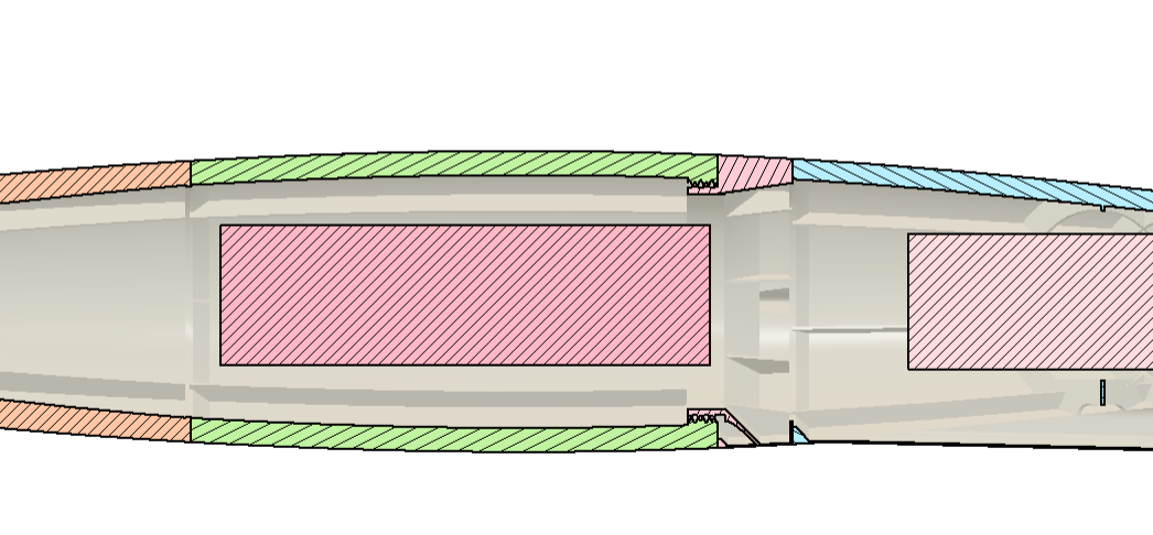

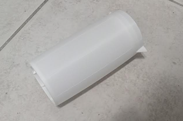

The only other particularly interesting thing going on is the way the hatch is designed. Hatches for these speed planes have been a problem I've been trying to solve for a while since you need them to be extra strong but also not add drag. So for this design the entire nose comes off using 3D printed threads and the battery will sit on a tray that projects forwards into that section (the tray isn't in the CAD quite yet). Ignore the threads not quite lining up - that's just Fusion 360 being weird.

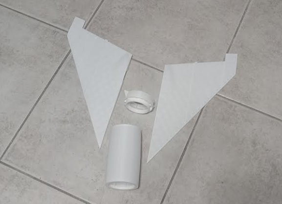

And I've even gotten the wings and the sections of the fuselage with the threads printed. The female threads print a bit messy but they still work perfectly well as you can see in the second photo.

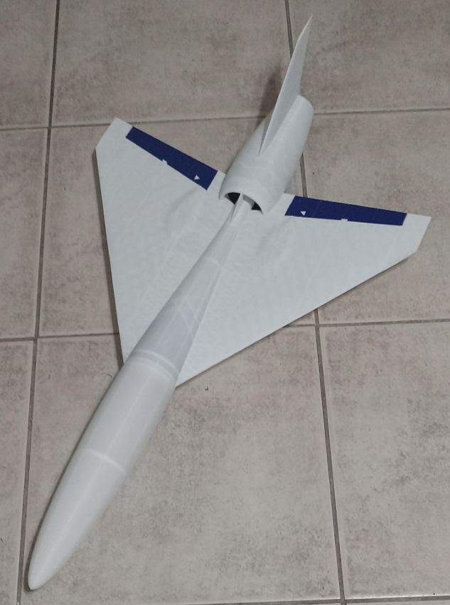

And the 64mm plane is done - and I actually flew it this morning (hence the slight grass stains on the left wing). And now it needs a name if anyone has suggestions - I kept the demon name when working on it, but I don't think it really fits with how graceful this plane looks.
Had one good flight and another attempted one that resulted in minor damage that has already been repaired. On the good flight, I asked someone to hand launch for me, and it wanted to roll left a bit but otherwise hand launches super easily. Thrust to weight is better than 1:1 so it climbs like a rocket with unlimited vertical and top speed is pretty good though I don't think I'm quite hitting 140. It slows down relatively well to land too, since it can come in high alpha like any other delta wing plane. Weirdly, despite the speed, this is not that hard to fly so long as you can keep track of it, and it would probably be super nice if made with LW-PLA instead of normal PLA and a lighter power system.
It's also probably the toughest plane I've ever built. On the second flight, I tried to hand launch myself and it also wanted to roll left, but I couldn't correct in time, and it hit the ground going 50 mph. The picture above is from this evening, post-crash. The nose cone was completely shattered so I reprinted that, but the only other damage was some minor and easily repaired cracking in the vertical stabilizer (it must have cartwheeled) and a bit of cracking in the motor wire channel which doubles as a landing skid. When it went in I was sure I'd be reprinting the whole thing, but it was only about 15 minutes of actual work from me to get it back in one piece and most of that was filling and sanding some dents in the vertical stabilizer that did not need to repaired to get it flight-worthy (the prints took about 5 hours combined, but I could leave the printers to do their thing). To avoid future crashes from bad hand launches I'm building a launch dolly so I can do ROG takeoffs and not have to worry about it.
I had the GPS onboard, but forgot to start it recording, so I don't know how fast it went and honestly can't really give an estimate beyond quite fast. I'm used to planes getting twitchy or otherwise weird as they get near their top speed and this one doesn't really do that, so it didn't feel that fast, but it gets small quick, and I did a low pass where it suddenly became obvious that this thing gets up and goes. Filming this thing will be pretty tough since it's so quick and fairly small (about average for a 64mm jet - 35" long with a 22" wingspan) but hopefully I can some speed measurements and a good video this long weekend if the weather lets me.
