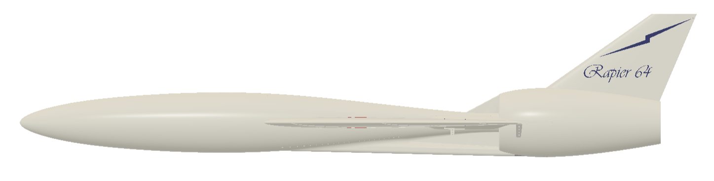

And the 64mm plane is done - and I actually flew it this morning (hence the slight grass stains on the left wing). And now it needs a name if anyone has suggestions - I kept the demon name when working on it, but I don't think it really fits with how graceful this plane looks.
Had one good flight and another attempted one that resulted in minor damage that has already been repaired. On the good flight, I asked someone to hand launch for me, and it wanted to roll left a bit but otherwise hand launches super easily. Thrust to weight is better than 1:1 so it climbs like a rocket with unlimited vertical and top speed is pretty good though I don't think I'm quite hitting 140. It slows down relatively well to land too, since it can come in high alpha like any other delta wing plane. Weirdly, despite the speed, this is not that hard to fly so long as you can keep track of it, and it would probably be super nice if made with LW-PLA instead of normal PLA and a lighter power system.
It's also probably the toughest plane I've ever built. On the second flight, I tried to hand launch myself and it also wanted to roll left, but I couldn't correct in time, and it hit the ground going 50 mph. The picture above is from this evening, post-crash. The nose cone was completely shattered so I reprinted that, but the only other damage was some minor and easily repaired cracking in the vertical stabilizer (it must have cartwheeled) and a bit of cracking in the motor wire channel which doubles as a landing skid. When it went in I was sure I'd be reprinting the whole thing, but it was only about 15 minutes of actual work from me to get it back in one piece and most of that was filling and sanding some dents in the vertical stabilizer that did not need to repaired to get it flight-worthy (the prints took about 5 hours combined, but I could leave the printers to do their thing). To avoid future crashes from bad hand launches I'm building a launch dolly so I can do ROG takeoffs and not have to worry about it.
I had the GPS onboard, but forgot to start it recording, so I don't know how fast it went and honestly can't really give an estimate beyond quite fast. I'm used to planes getting twitchy or otherwise weird as they get near their top speed and this one doesn't really do that, so it didn't feel that fast, but it gets small quick, and I did a low pass where it suddenly became obvious that this thing gets up and goes. Filming this thing will be pretty tough since it's so quick and fairly small (about average for a 64mm jet - 35" long with a 22" wingspan) but hopefully I can some speed measurements and a good video this long weekend if the weather lets me.

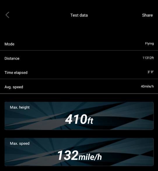

132 mph! On an old slightly puffed 30C lipo to boot. It won't break any records, but on only 870 W of power, it might be the most efficient setup in this competition.
This was the warmup flight for an intended set of speed passes with a newer 120C pack, so I think it's got a bit more in it - probably 140, maybe even more.
I also want to look at the impact of a couple of design features. My design approach to this was to CAD something up, run it in CFD, go woah, that's low drag, and then build it, so there is almost certainly room for optimization.

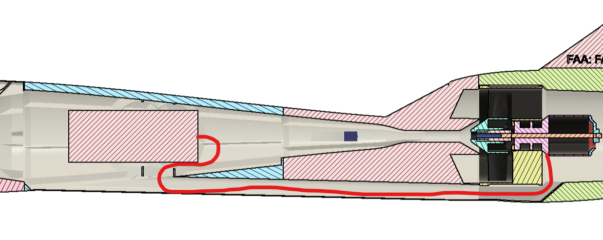

64mm Powerfun EDF with the bell mouth removed - it currently won't fit any other EDF. To remove the bell mouth, there's just a bit of tape you can cut to take it off so it's to easy to remove/replace. A more significant thing is that the wires from the EDF to the ESC have to be lengthened so they can run through the wire channel, but that can be done using separate wires and banana plugs so it doesn't need to be a permanent modification either. Personally, I just spliced some 16 ga wire in though (same as the EDF wires)

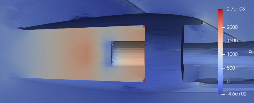

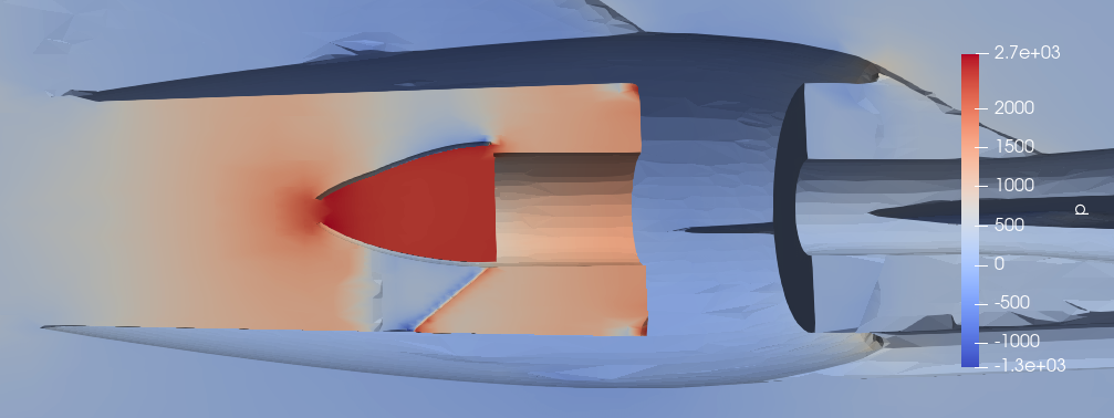

Figured out why my predictions were a bit faster than the plane - almost 20% of the drag on this design is coming from the motor can on the EDF. On one hand this is frustrating since it's hard to change, but on the other hand, it does show just how streamlined this design is.
Unfortunately, my first though for a tail cone (mounted on struts) is only about 2% better than not having a tail cone at all, since the struts are quite draggy, but I think I may be able to improve that.
