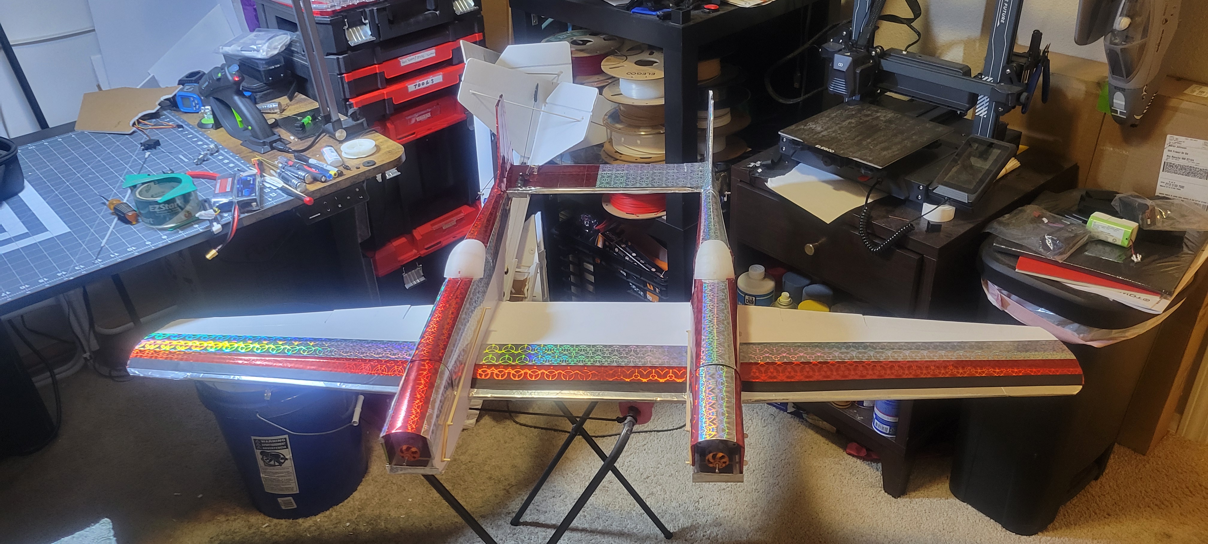

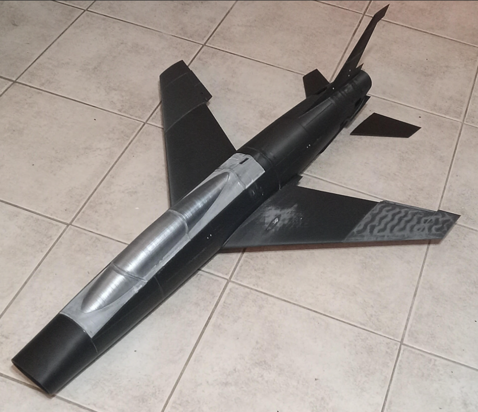

And we're back in business - got the canopy for the Super Duper Sabre printed - only things remaining are the flaps, nose gear, rudder, latch, and some control linkages

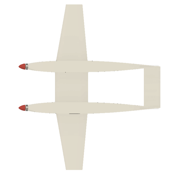

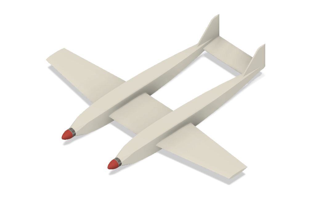

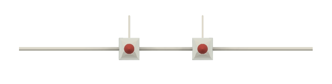

Continuing to do anything to procrastinate building the Super Duper Sabre, I've been thinking about what I would do for a foam board speed plane. The layout is determined by the limitations of foam board and my limitations as a pilot. For a foam board design, an EDF will not cut it - the combination of the poor efficiency of an EDF and higher drag of foam board won't work well together so a prop is necessary. However, I tend to really struggle with the torque from the powerful single prop needed to drive a plane very fast, so a twin motor design will make life much simpler. Adding nacelles either side of a central fuselage also adds drag, and just doubling up the fuselage is sleeker so I ended up with a design something like an F-82 Twin Mustang. The wing is thin but still airfoiled since this is lower drag than just having a single flat plate for larger chord lengths but the tail is a flat plate design since it's a shorter chord.
I didn't try to round the edges of the fuselage since I'm not a particularly good foam board builder so limiting the number of folds and complexity of the build is very much in my interest. The wings are designed to use carbon fiber spars and the entire airframe is meant to be wrapped in packing tape to add strength. Flutter is also a concern with foam board so I'm thinking that adding 3D printed mass balances to the control surfaces may be a good idea. In general, I plan to 3D parts that would typically be made of plywood since that's a lower effort option for me.
Not sure if I'll try to build this and it would definitely come after the Super Duper Sabre if I do but it's a fun thought experiment at a minimum.

Nice design. I did something similar(ish) with a modified FT Bronco design. With two 3536 1780kv on 6s with 8x6 propellers I got to the high 120s mph. This is a much more sleek design and wonder what it could with a similar setup.

Predicted top speed is ballpark 180 mph, but I have so little data on props and no data on foam board planes, so that could be very far off in either direction. The intent would be to run 5x8 props on twin 2306 1900 kv motors, but I've struggled to find to find such high pitch small diameter props in the past and have gotten stuck with 6x6 props. Should draw around 120A on 6s with only a 30" wingspan.

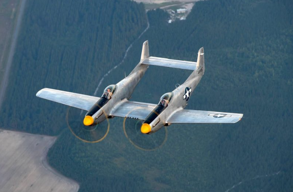

Looks kinda like the F-82!😁👍
telnar1236
One of my main sources of inspiration. My design was mostly inspired by wanting to minimize the impact of the motor's torque, but I also remember seeing somewhere that WW2 twin fuselage designs were something like 20 mph faster than their single fuselage counterparts - as you see with the Twin Mustang (F-82G) having a top speed of 461 mph vs. 440 mph for the P-51D.
The other one was the Pond Racer which isn't really a twin fuselage design but still has a similar look to it. There's a pretty neat 3D printed version of it that I saw a video of a while back and I've been itching to try my hand at something similar.
RickHunter
That pond racer is pretty cool. I have a foamy f-82 in my hanger. It was never built for speed, but it is a lot of fun and looks cool in the air. Plus it does flat spins like crazy. There is no torque roll whatsoever with the duel props in opposite rotation.
Suggest you get in contact with APC props on the west coast.
Ask to talk with the teck person and explain your situation and this guy should give you a handle on what to do.
Years ago, I was interested in 4D flying and asked him about reversible props. They designed one and he stated that it was about 80% efficient in both directions. Never even expected that. So give them a call. Also they have quite a data bank on their props and what they can do. May have to hunt their site to find info. Pylon racers are always trying different engines and need different props.
With dual engines, agree like others, that you will need cw/ccw props. On my 2 motor VTOL, ran just CW props, then CCW props and then CW/CCW and best result was CW/CCW with the FC. Also flew a big flat piece of blue foam doing cw/ccw and would not with 2 cw motors with a FC..
Frontal drag is the biggest culprit, if you are looking for speed, if the tail feathers can be V-tail, it will add big gains. Pylon racers proved that.
