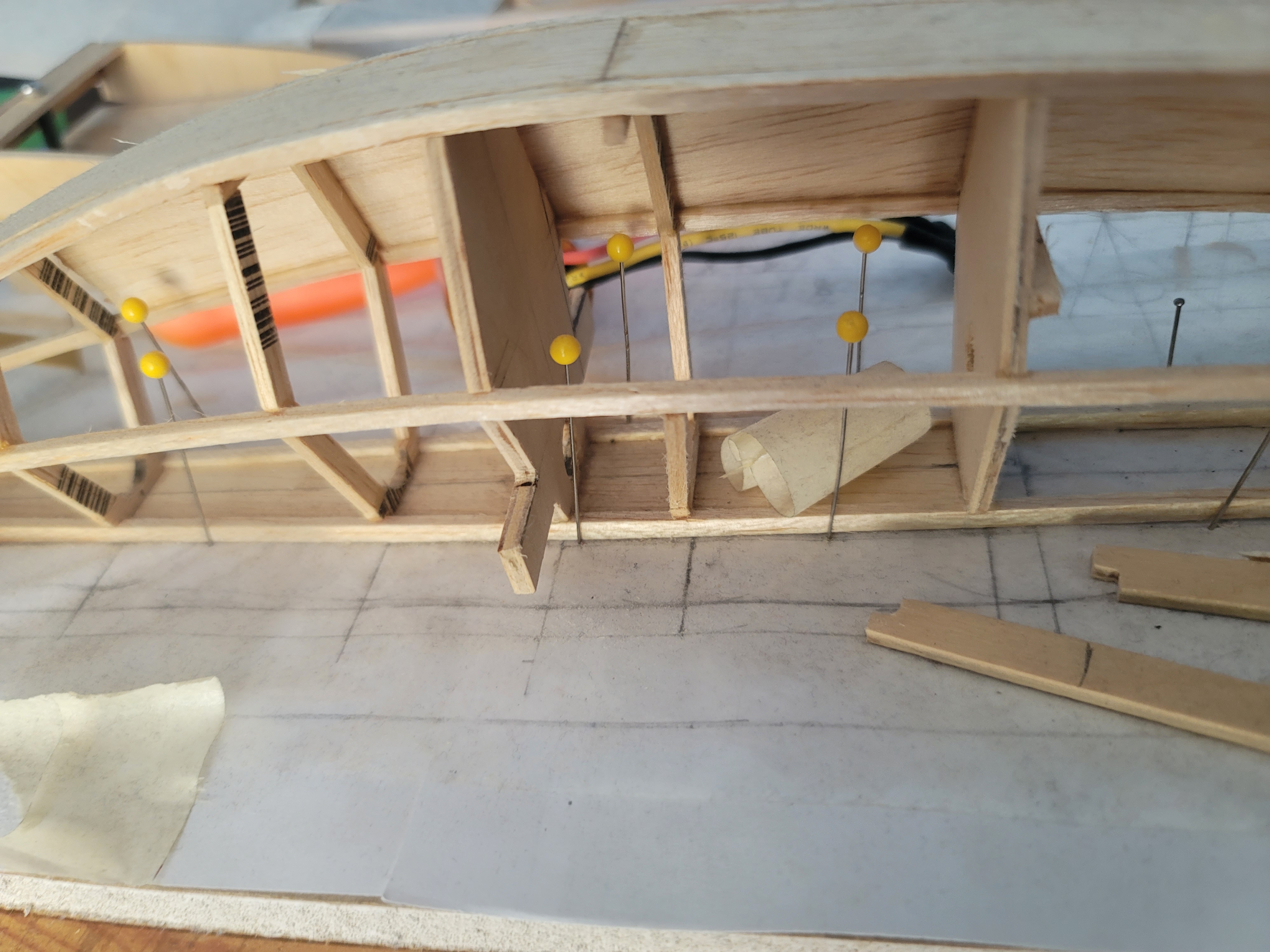

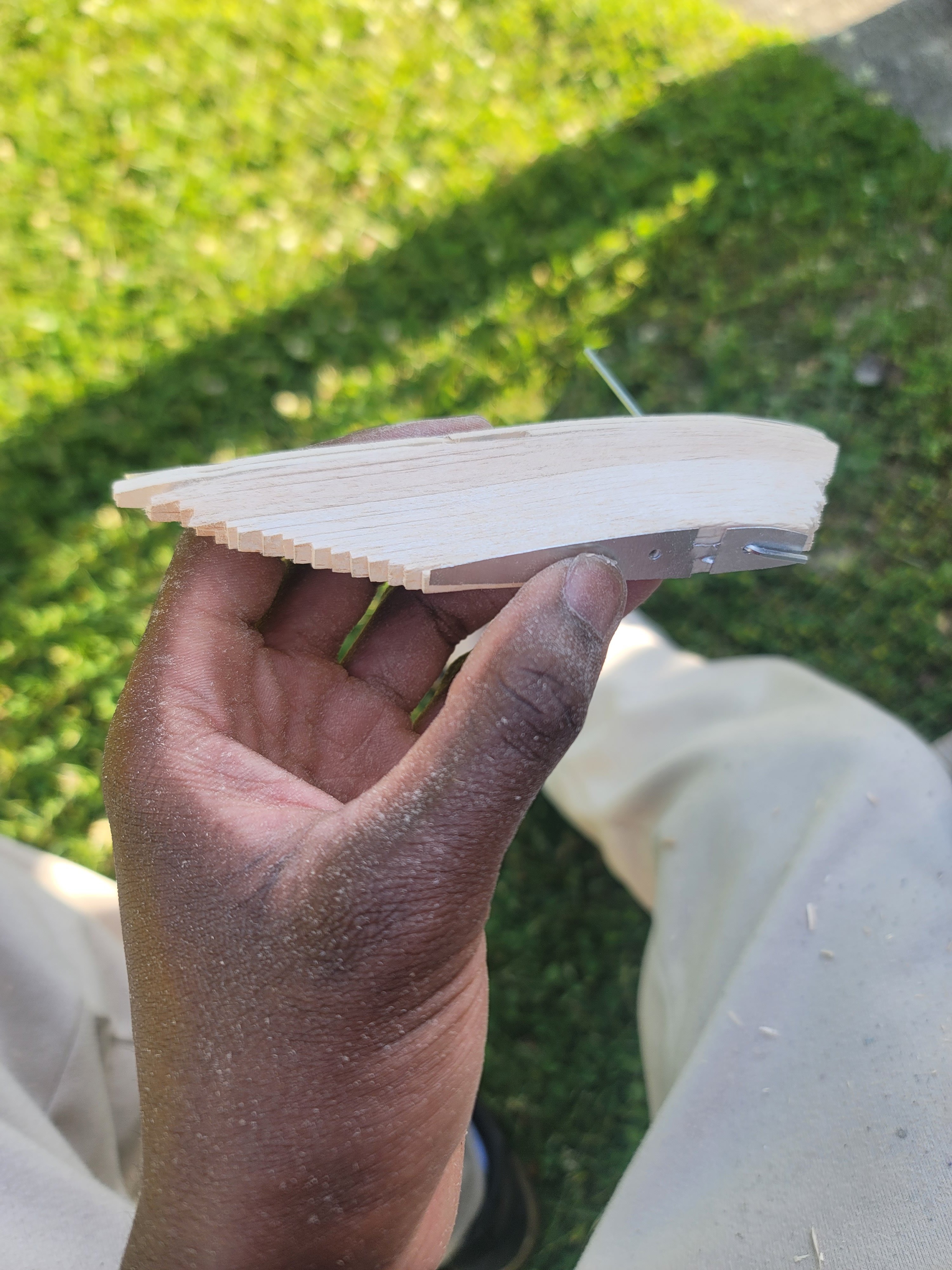

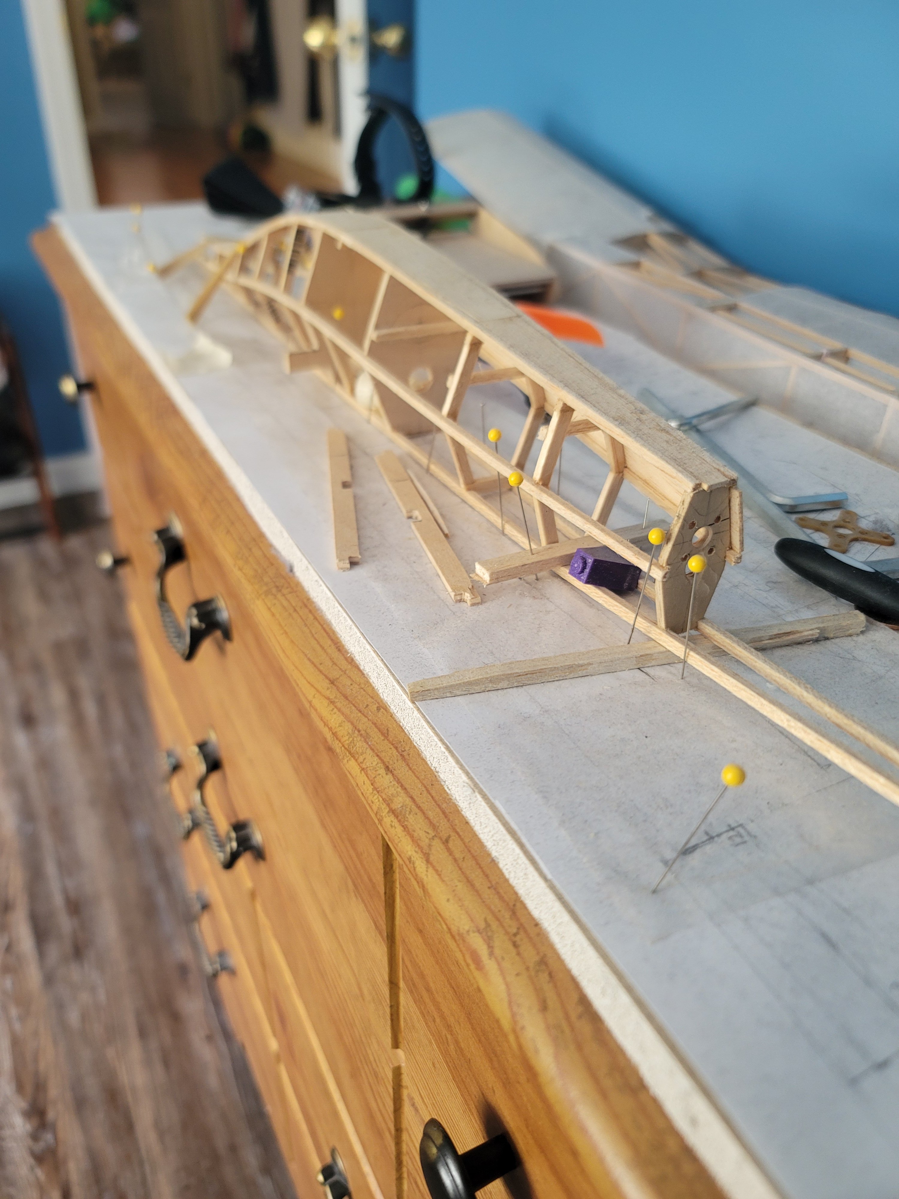

Sure. So going from where we left off, this is the state of the fuselage. It's good apart from a broken former. I guess my plan was to sheet the thing with 1/16 balsa

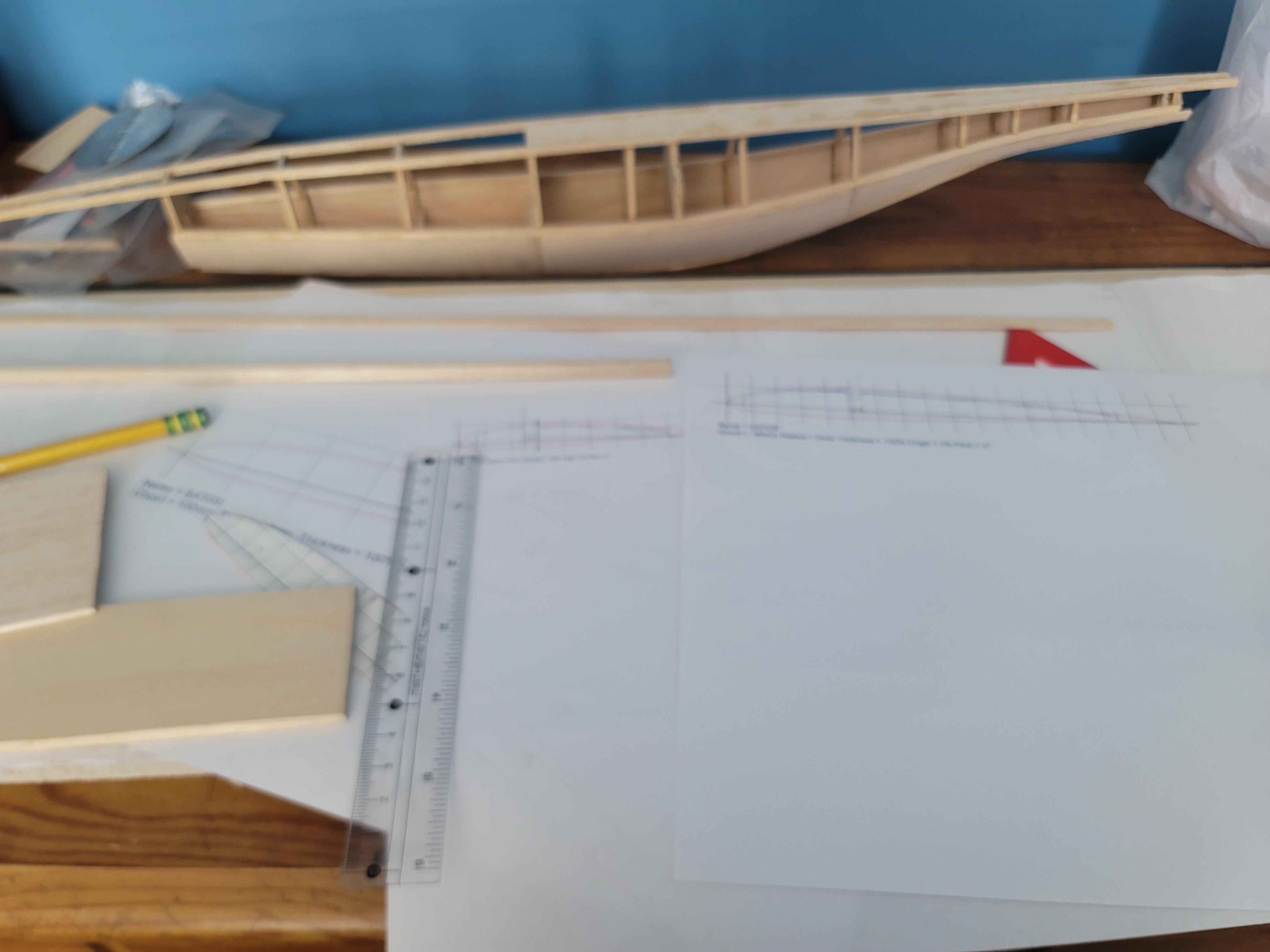

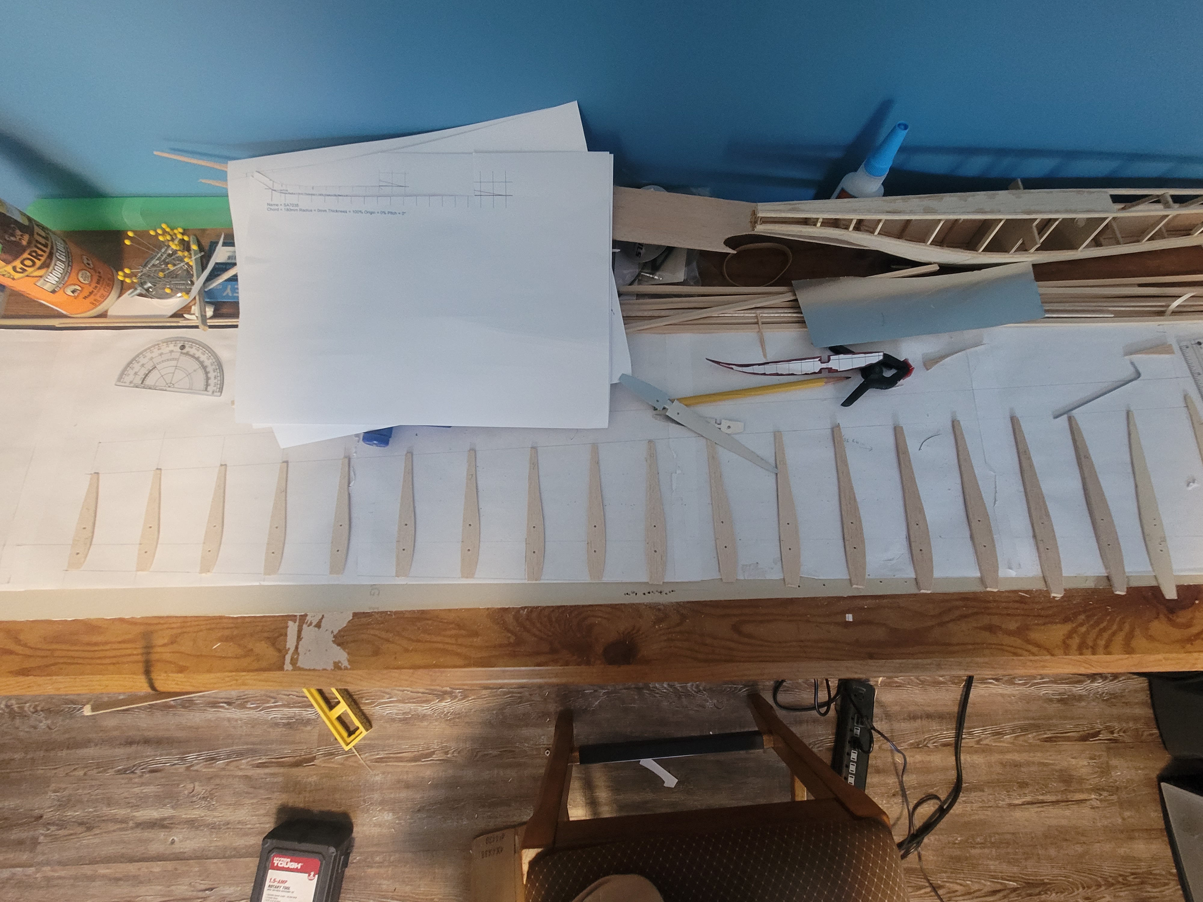

Working on the wings now. Im changing a couple things. I reduced the chord width and switched from gull wings to normal dihedral. The fuselage is looking good.

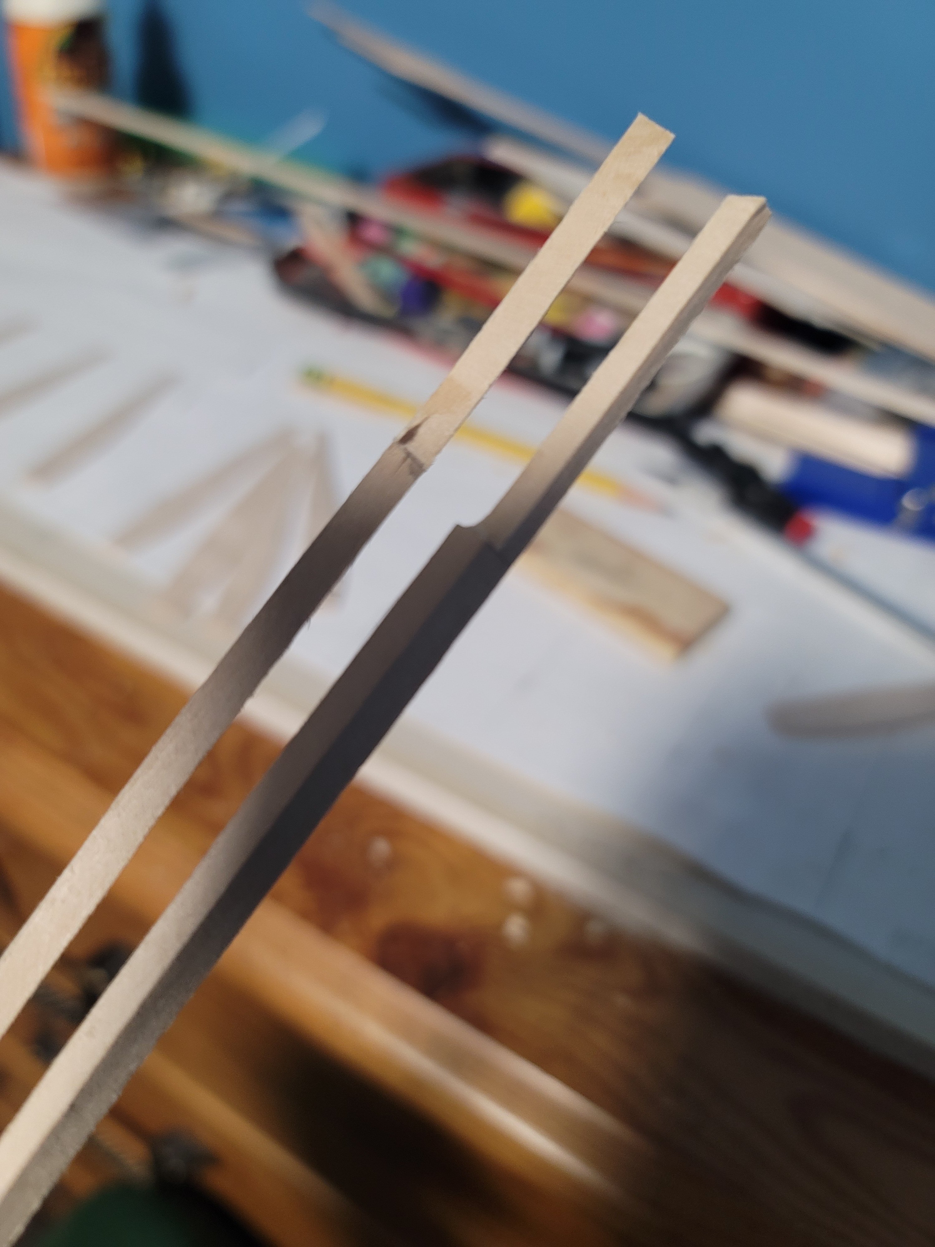

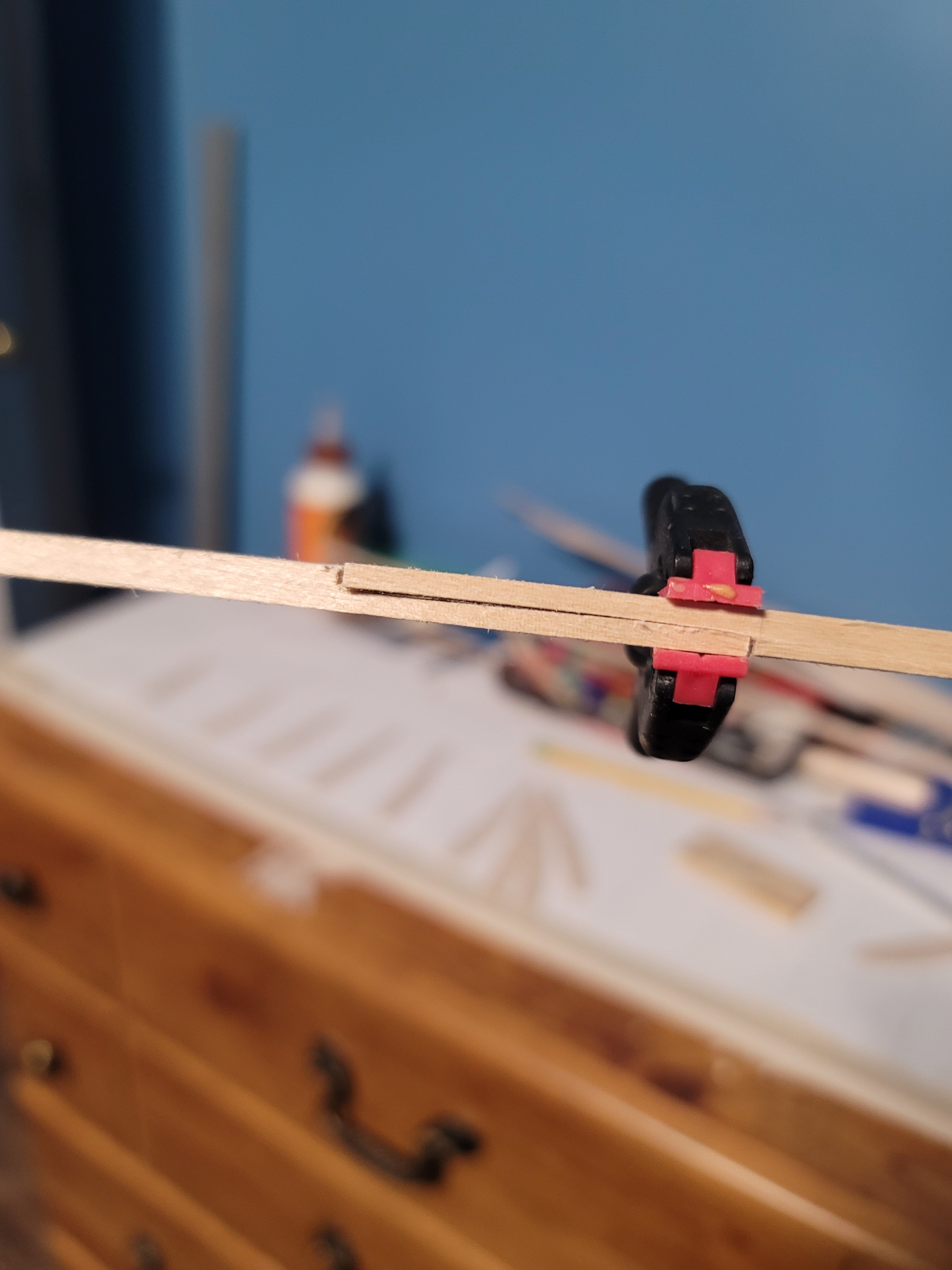

Taking a slot out of the spars so I can splice them together. Basswood only comes in 2ft, not long enough to span a wing. It's usually done with epoxy. Since I'm working in my bedroom, I'll use wood glue instead to avoid falling into a permanent sleep.
