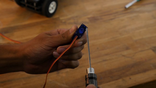

The first step is to open up the servo.
Once you have it open, DO NOT start ripping gears out right away. Take a good look at the layout, or better yet, take a picture. The gears will need to go back in just they way they are when we are all finished.
Once you have a good idea of how the gears sit, remove all the gears and any pins holding them in.

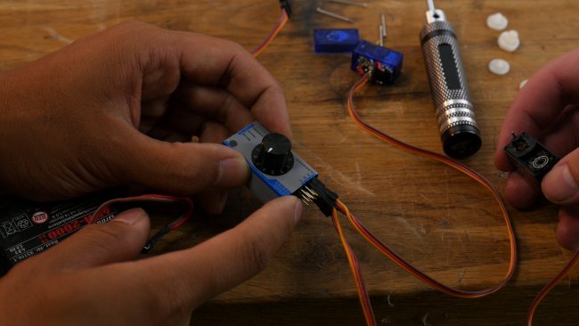

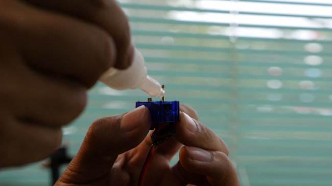

Next, you'll want to center the potentiometer. Hook up the servo to a centerer or center the trims on your radio if it's bound.
Once you hook up the power, you'll hear the motor make a high pitched noise. This means it's trying to move the motor to move the gears which move the potentiometer. Move the potentiometer left or right (slowly!) until the motor stopps humming. This means the potentiometer is "centered" so it stops moving the motor which is exactly what we want!

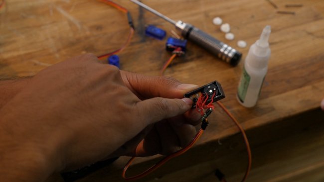

Now that the potentiometer is in the correct position, lock it down with some super glue, or use thin/medium CA.

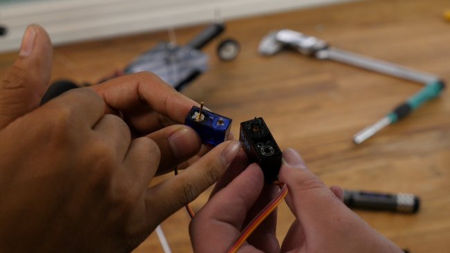

The potentiometer is hidden on the EMAX servos a bit. You'll have to look at the bottom under the wires. Just like the 9-gram, stick a screwdriver in the slot and rotate left or right until the motor stops humming. Glue it down so it no longer moves.

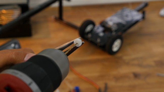

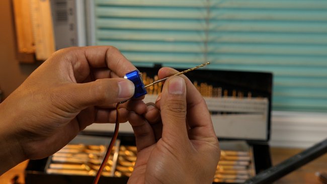

Find yourself a drill bit that slightly larger than the potentiometer rod.
The gear that provides the feedback to the potentiometer is usually friction fit. If you take away that friction, the gear will spin freely on the rod. This is how we negate any information going to the potentiometer. It's now glued down and the gear that usually talks to it will do it's best impression of the teacup ride at Disney.

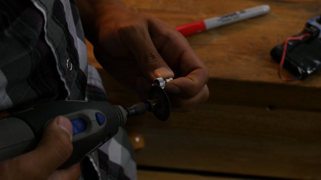

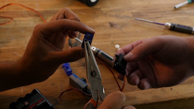

For the metal gears the rod is not on the servo body, but the gear itself. The exact same idea applies, just remove the rod that would talk to the potentiometer! Be careful of sparks and debris when cutting metal! Wear saftey glasses and don't hold it in your hands. Peter is reckless. Don't be like Peter.

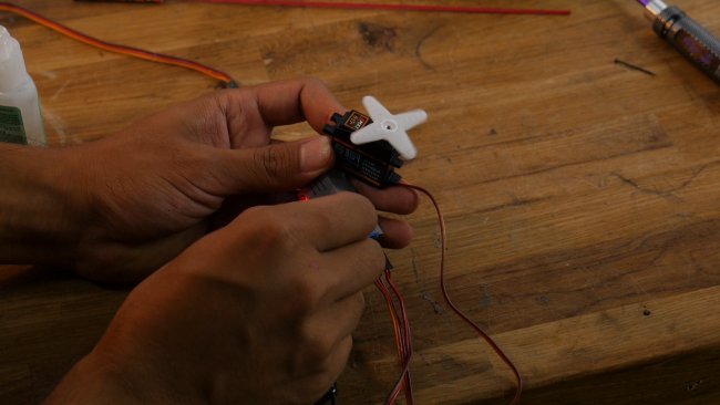

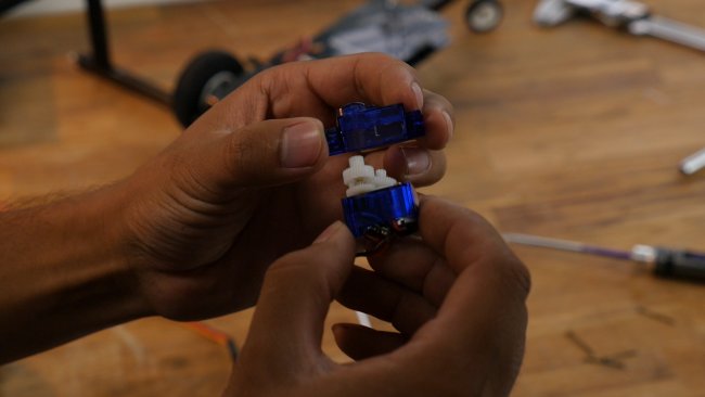

All that's left to do now is reassemble the gears just how they were and screw the housing back together.
