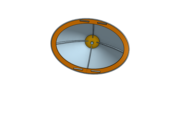

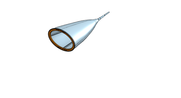

So I did another weigh calculation and it seems like they will weigh about the same if I use a 1mm skin and those formers or of I use those longerons and .8mm skin....So currently it is giving us about 30g in PLA...
That's still pretty heavy. The nose cone on my comparatively sized Saab 105 is only about 11 g and even on my big 6 ft long 90mm EDF is only 24 g

There! AUW is 12g in LW PLA:
