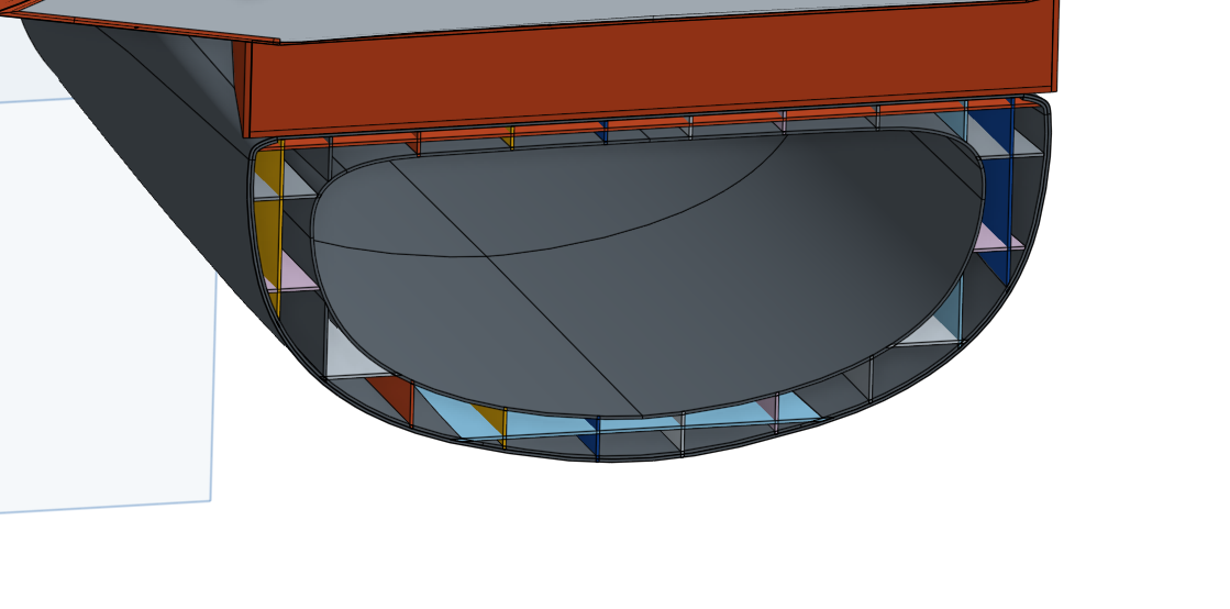

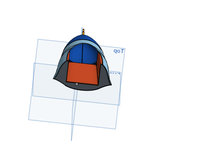

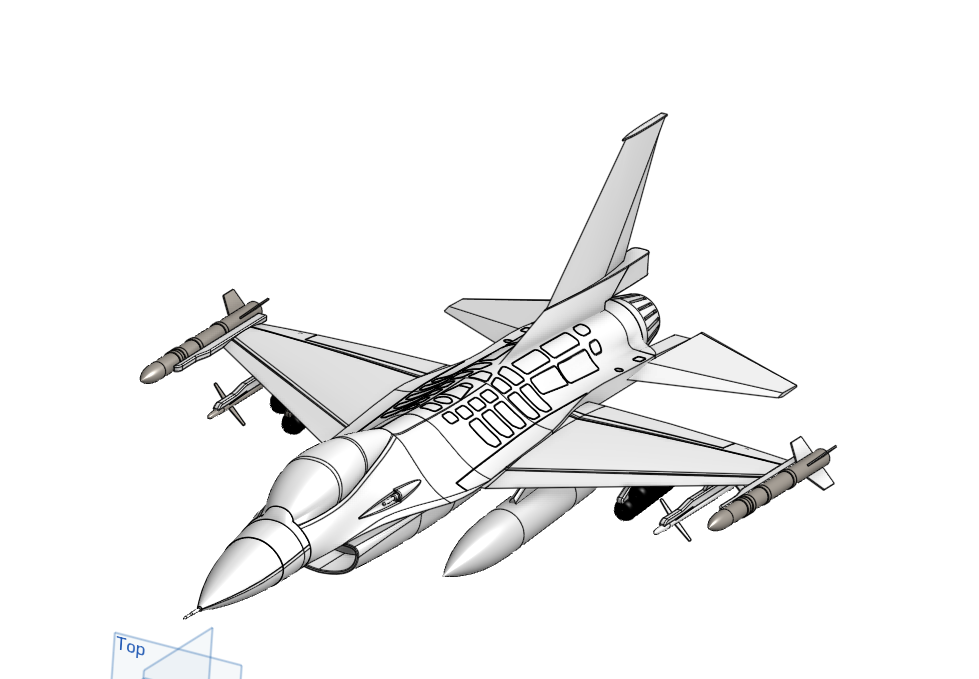

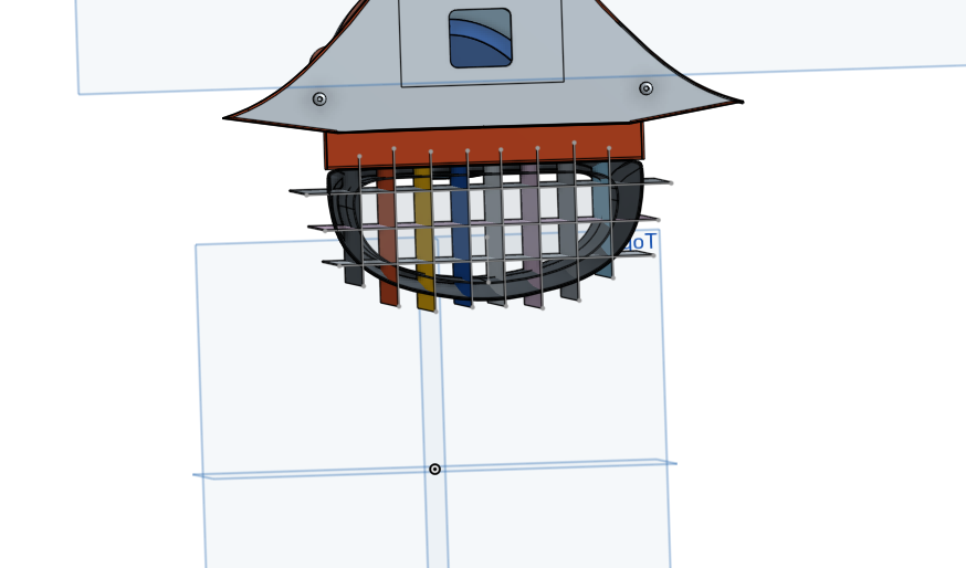

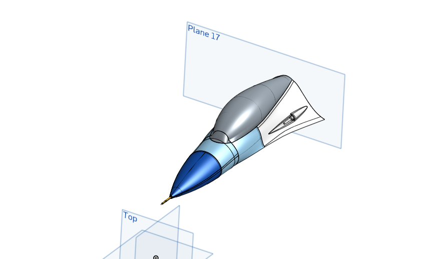

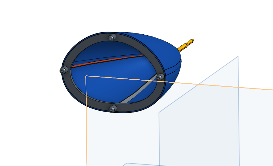

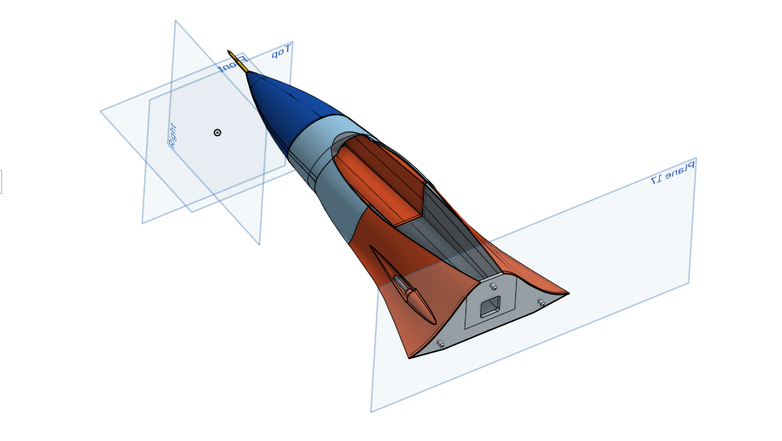

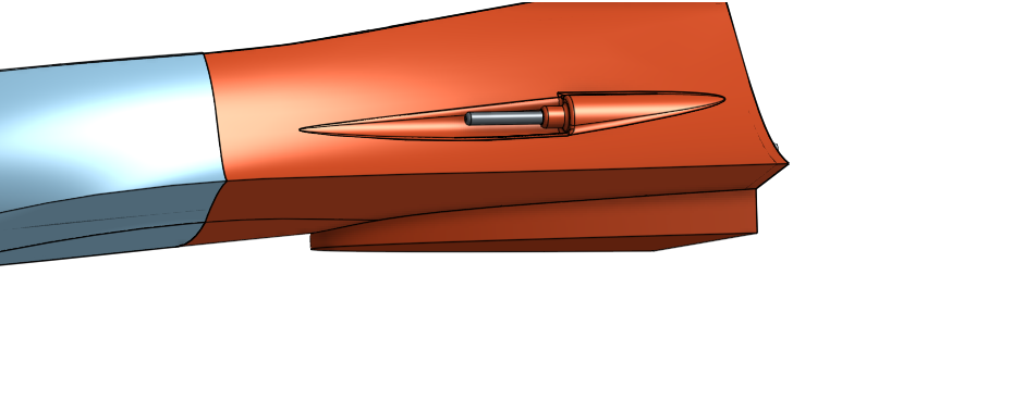

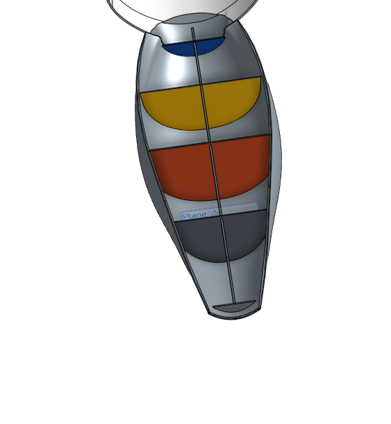

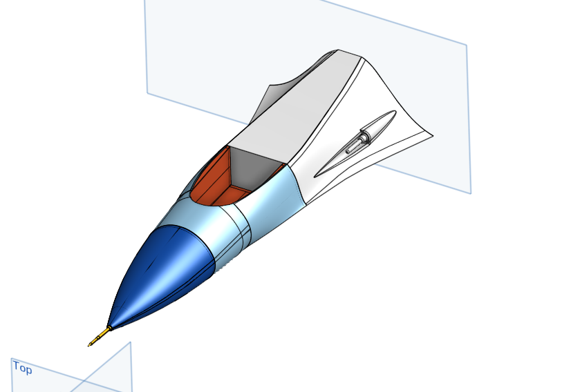

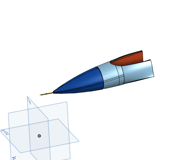

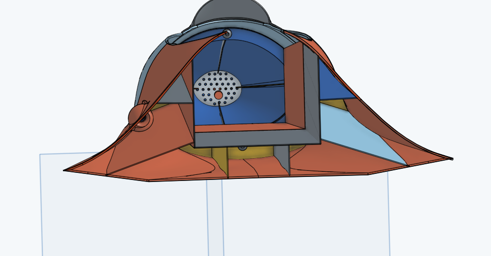

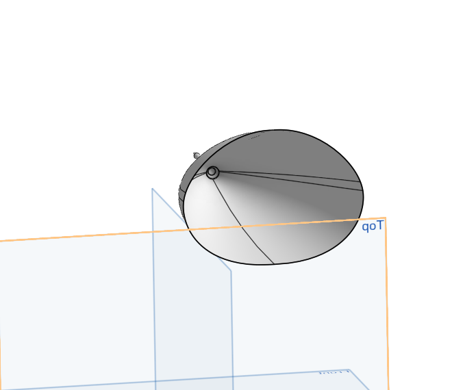

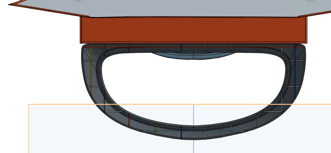

All done! JK 😂 I was having a hard time getting it to look to scale, and then @Mr Man found me this already made design in Onshape. So now what I’m going to do is make each part its own piece (since it’s basically all one piece!) so I can edit it, shell it out, and make my internal structure
nternal structure.
AI seems to really like thicker skins on 3D prints for some reason. If you're using LW-PLA, a 0.8mm skin is ok, although not really necessary most of the time, but with normal PLA, you would end up with and extraordinarily heavy plane for its size. You basically never want a skin over 0.4 mm. Some slight deformation will basically always happen in the skin of an airplane under load - you can even see it in full scale ones - and it's not necessarily a bad thing. All I'll give Chat GPT is that it's better than Gemini on this particular recommendation - I was curious what a plane designed by Gemini would look like a couple months ago and it suggested a 1.6-2mm skin in one place which is even less practical.
As a whole I'd take AI suggestions on how to build a plane with about a whole shaker of salt. It's a fairly niche hobby and AI clearly doesn't have enough data to give reliable answers on it just yet.
I wonder if its confusing balsa building with 3D building...Also 3D printed planes seems to be quite a new thing...
