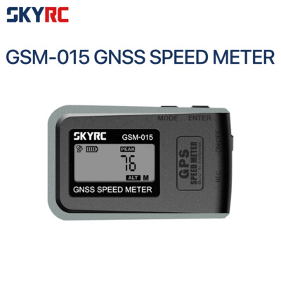

no not sure I was thinking maybe a speed gun but something that goes in the plane would be great.......
Like this?
