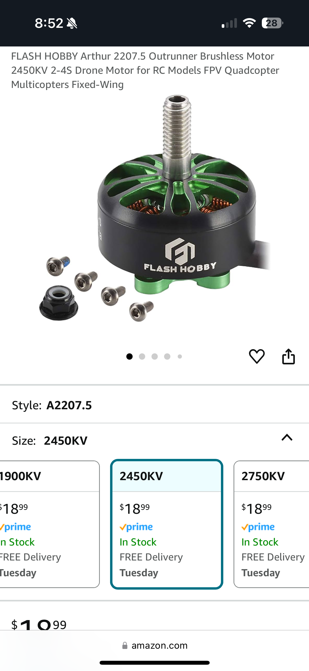

am i allowed to lost links here? it was the only 2208 i could find on amazon, was actually a 2207.5.

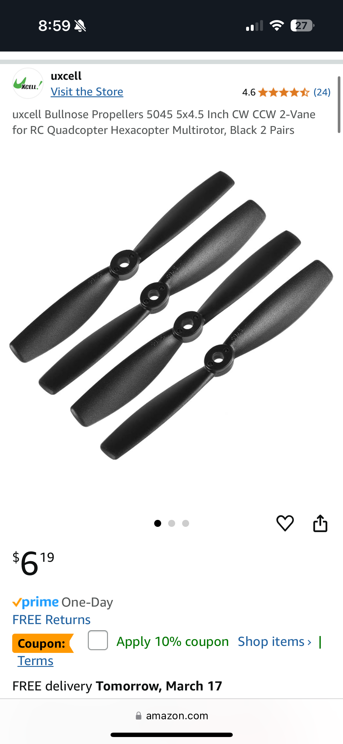

so 5x45 prop?
i have 5x4x3 but they dont seem very strong, pretty flimsy.

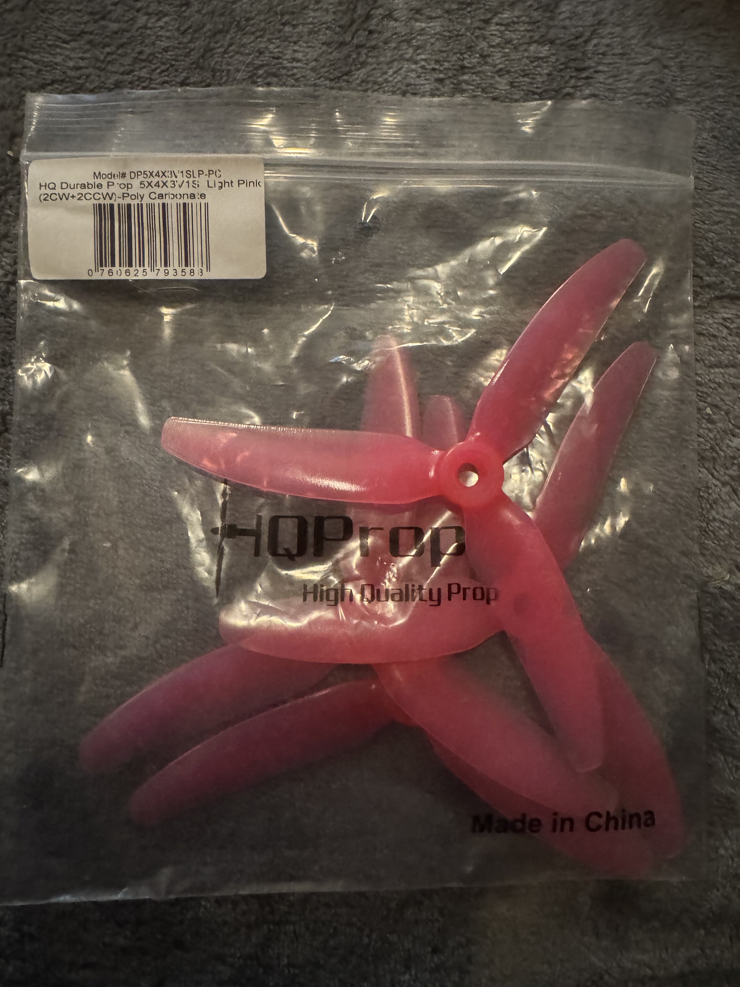

also have these, these are pretty strong, i am confident they would hold up providing its the correct size snd pitch.
