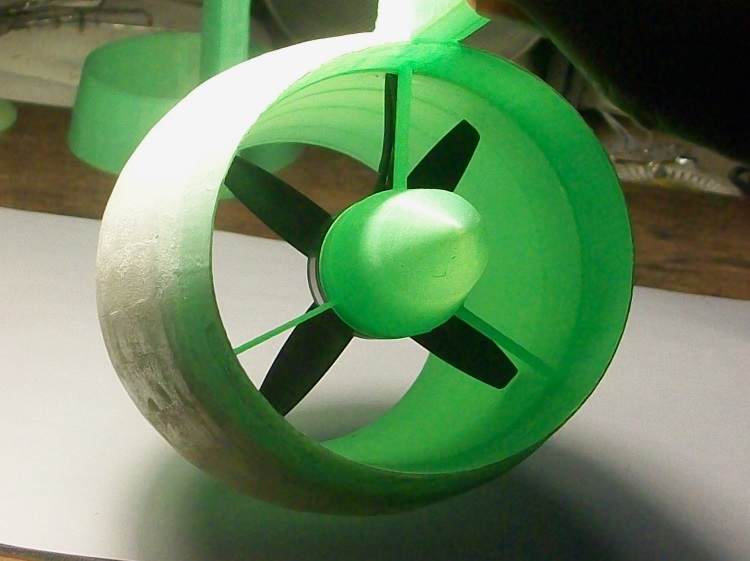

In this case a pair of them on 4s happily drive 3x4.5 four blade "quad" props inside the nacelles of a scale Airbus A350.
