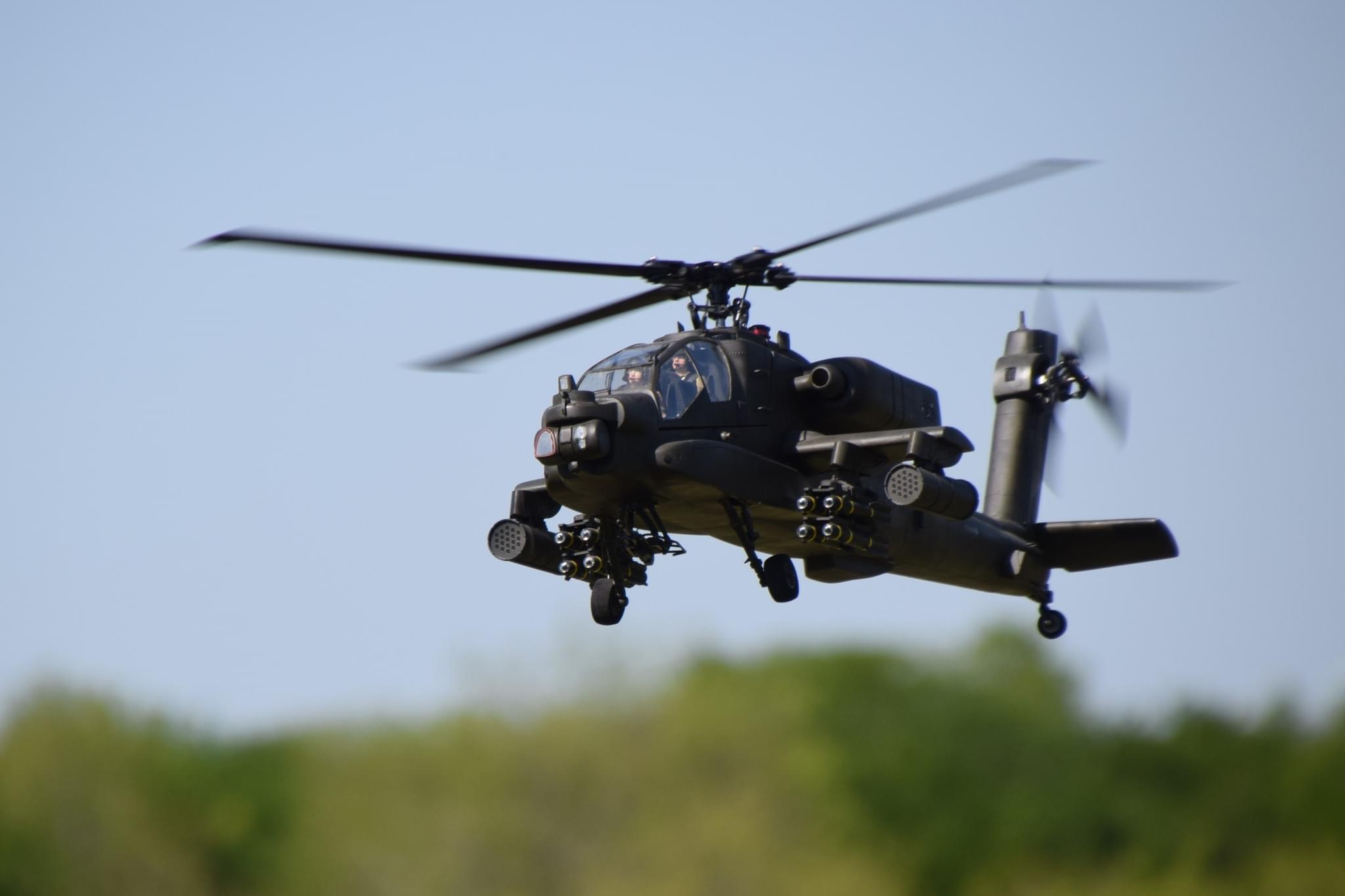

A few more photos from flying this morning. First time out trying the new tail servo in some heavy winds. It performed perfectly! Tail held rock solid. I think that I have finally cracked the code to making this an everyday flyer!

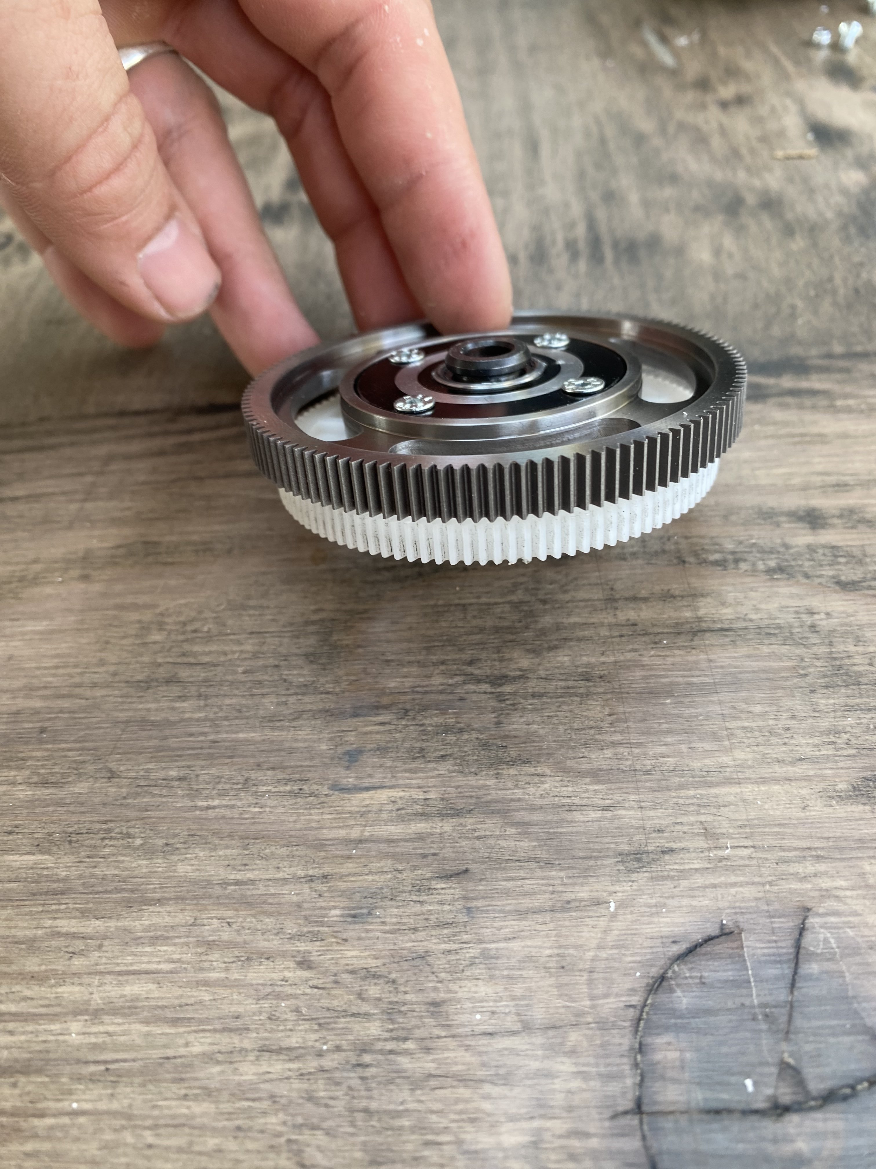

Finally received my Aluminum gear this morning, and I can’t wait to start getting the Apache back together. The gear came out great!
What a beautiful machine! I boucht one second hand (new) and want to build it like yours (they painted is not so good…). I offcourse dont want the gear problems, is there it possible you have the CAD program drawing for me?
If it’s built light enough, and you use the stock belt drive tail, you may not have the problems that I have. Others have built it and made it work stock without any issues. Mine is one heavy machine (9.5 lbs!) ready to fly, and I think that’s the primary cause of the issues. If you still want to see about a metal gear, that might be more difficult. A friend custom made them for me, and he owns all the files. If you PM me, I’ll send you a link to his Facebook profile where you can contact him.
Best of luck with your new Apache, I hope yours comes together easier than mine did!

Michael is very bussy, but….. fount someone crazy enough making me a custom metal gear.
There was a piece of titanium yellin use me!!! So he’s making it of titanium, i’m wondering what it wil do with the heat… do you use some lubricant? And with witch pinion do u use at the end? 13/14 teeth?
That is awesome!! I certainly wish mine was titanium. Mine is 6065 aluminum and I'm slowly wearing through it unfortunately. I use the Aeropanda Dry Gear lubricant on mine: https://aeropanda.com/collections/grease-lubricants/products/dryfluid_gear_10ml. I run a 14T brass pinion on mine to attempt to minimize wear as well.
