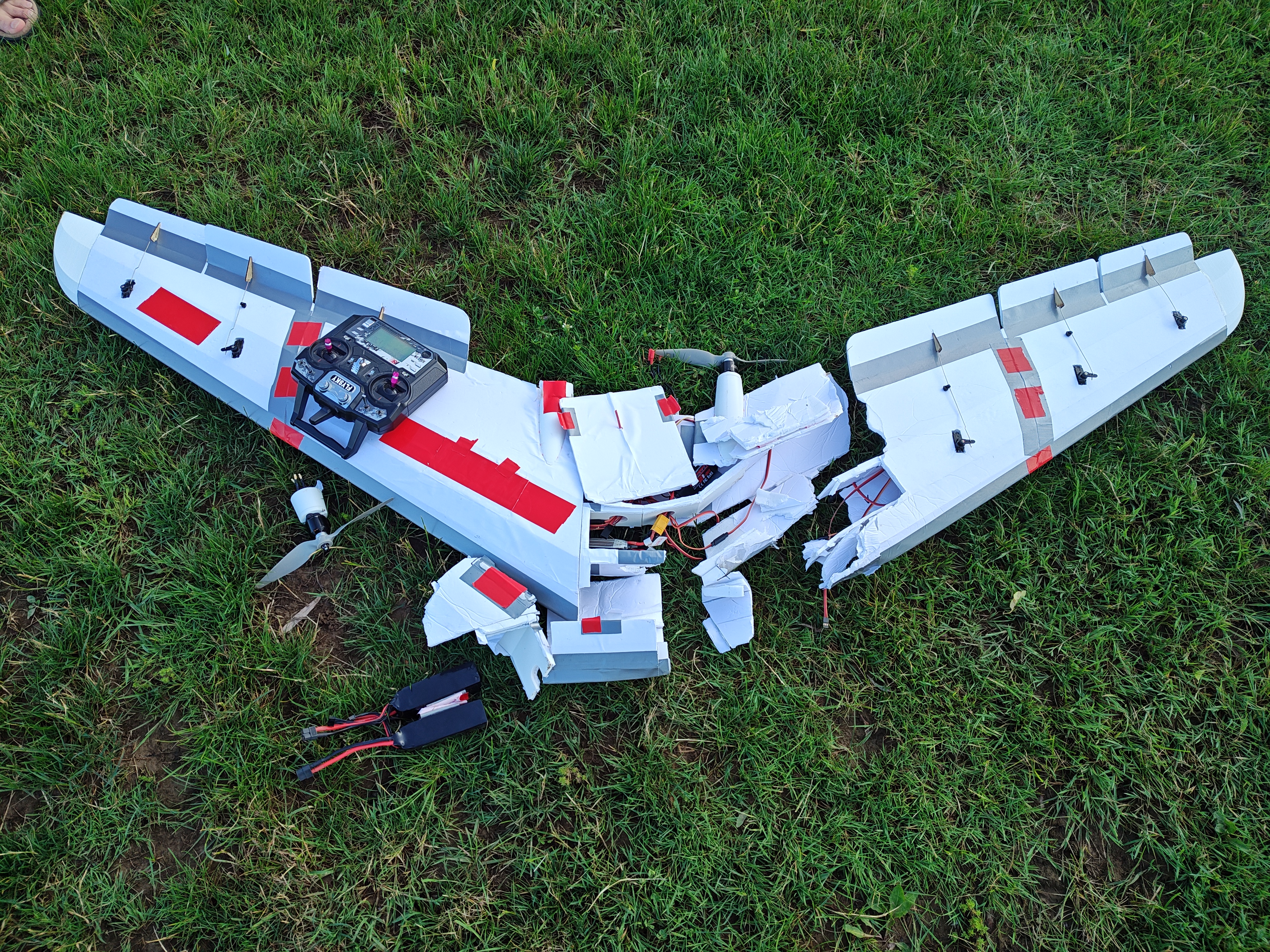

I finally got around to printing and installing the wingtips, hopefully they provide a meaningful increase in efficiency

I've found wings to be much simpler and more stable, as long as the cg isn't tail heavy and you're good with bank and yank flying.
Idunno, looks to be too many fiddley moving parts to do combat, or at least what I did. Does it work with intentional failures of 2or more controls?
Firestar119
I haven't tested with intentional failures, but the control surfaces are split into 3 sections for that exact reason.
Firestar119
How did you control the roll/yaw problem and how about a video to show it flying?
The wing is decently yaw-stable already, but the airbrakes do give it more stability at lower speeds.
Footage is coming soon, and I'll also record during the combats at flite fest.
Firestar119
the roll issue was fixed by just allowing the airbrakes to act as elevons instead of rudders (it was useless anyway)
L Edge
What about gusty winds? What makes it yaw stable?
The tip elevon sets could be set up as drag brakes with a touch more of up, but you trend towards tip stall which may or may not be a desired option or even a 3way mix with rudder channel in addition to aileron and elevator
