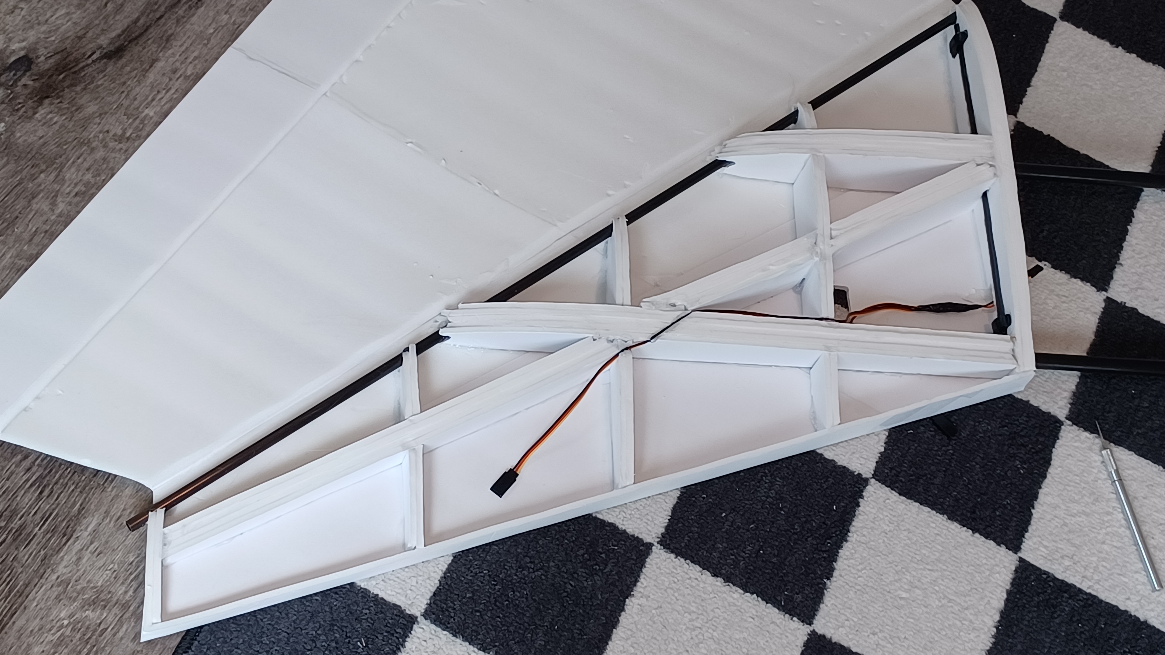

The conclusion I have come to over my time in combat is that nothing short of fiberglassing the leading edge or the entire wing will prevent major destruction in a hard-hitting midair. Last year I had carbon tube along the leading edge and quadruple / quintuple-laminated foam spars around carbon tubes. One good hit with an XL scout was all it took to break my wing. The Scout, in comparison, just had a kinked tail and gently spiraled to the ground, under partial control.
I would bet that fiberglass over foam core would be the ultimate for combat impact resistance: tough outer shell to take the hit, homogenous core to distribute the load. I've got a year and a half of composites experience now from my work, and 2 plies of 8oz over foam core is so rigid and tough that it's hard to comprehend compared to foamboard.

It could definitely work. An aluminum tube down each leading edge would definitely be strong. It would be a question of how much wall thickness you need, and how much weight that adds, how it distributes that load into the rest of the structure, and what that structure is.
My hunch is that fiberglass over foam core would be more impact resistant per unit mass than an aluminum leading edge on an otherwise traditional structure - because the foam core distrubutes the load and as such lowers the stress compared to discrete structural components, and because the bond area between the glass and the foam is so large.
Whatever the leading edge is it certainly has to be on the outer surface of the wing (not buried behind foam like I did, since that will easily snag on the foam layer above) and made out of something with good radial strength (not uniaxial pultruded carbon tube like I did).

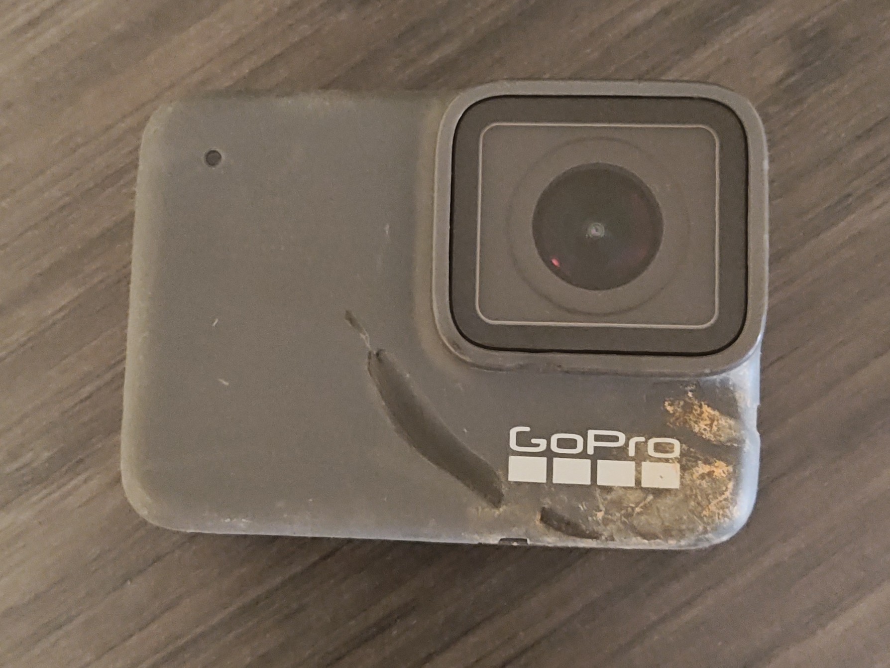

I just checked the GoPro, and it's completely dead. So much for "action" camera, it broke the first time it got any action. No visible damage, I guess the blunt force shattered something important
Is it lighting up? Because there just might be a loose wire that needs some soldering…
