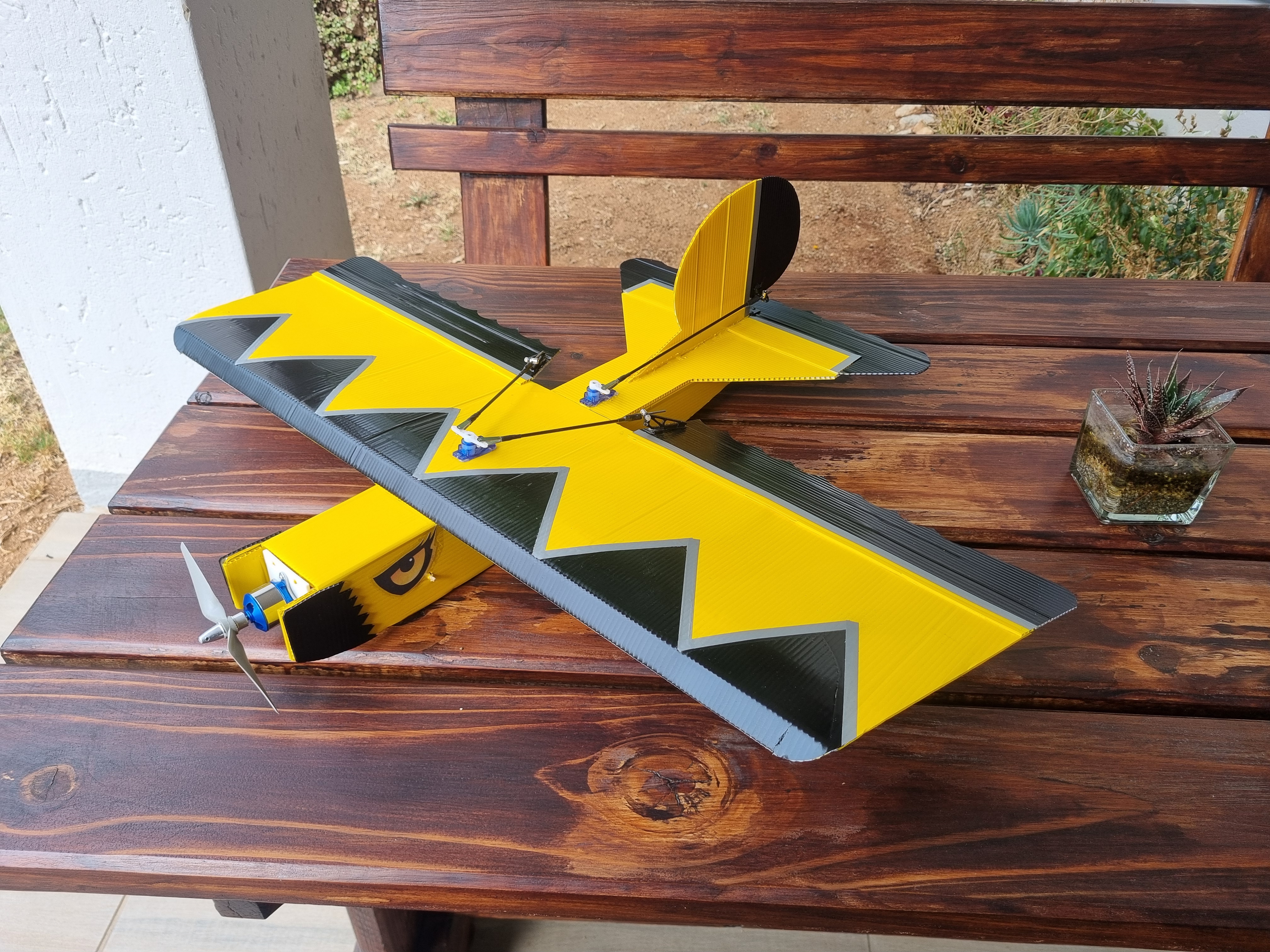

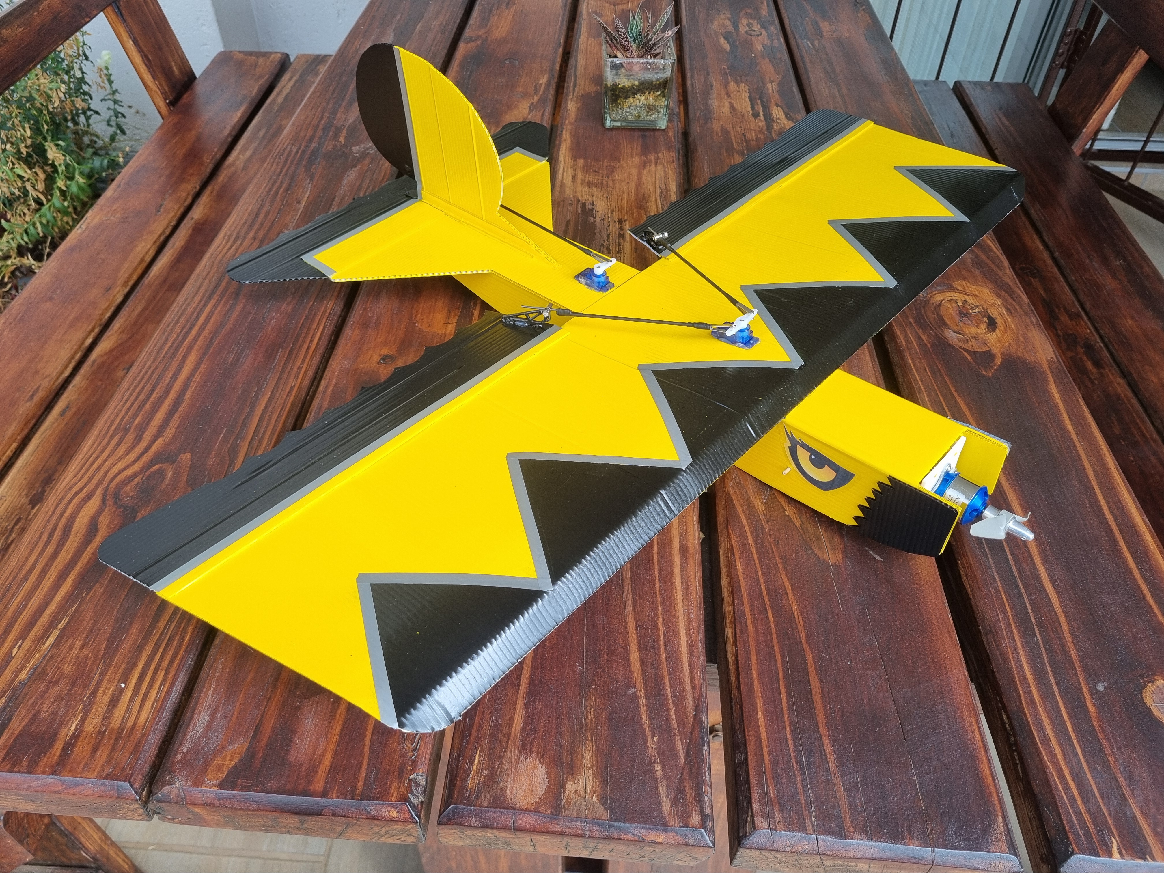

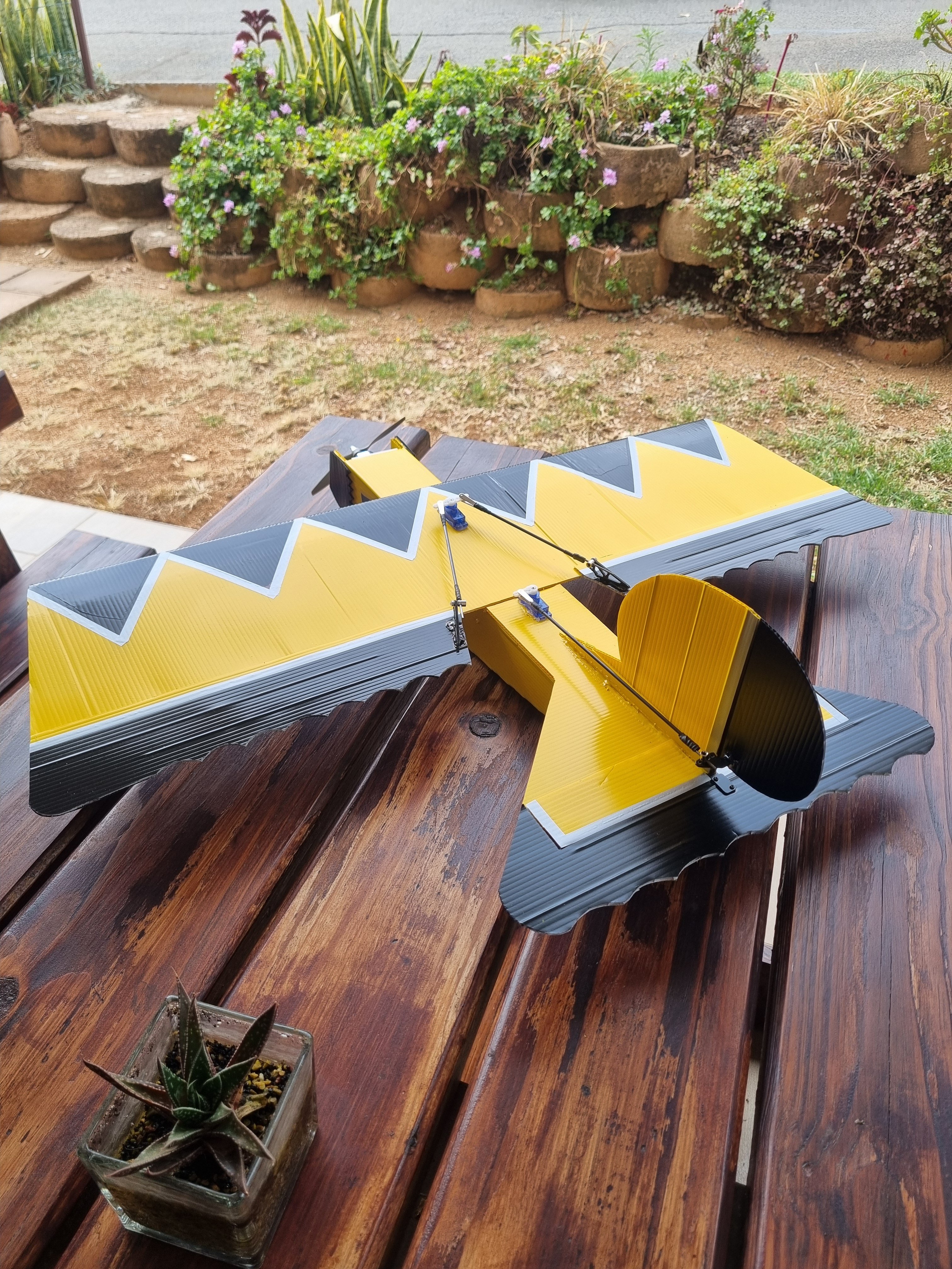

So my Bloody Baron is painted now. Was a bit of a mission tbh. Trying to do 2 colors on correx is always a mission because even after 3 days of letting the paint dry, when I masked the yellow and sprayed the black, then remove the masking tape - it just peels the yellow away. I used silver vinyl to cover up my mistakes as best as I could.
I tried a 5x5 prop with the 2212-2700kv motor but it didn't make it go quicker, it made it go soooooo much slower that I only flew for 1min, its probably not making enough thrust, needs more kv. I'd like to try my 6x5.5 prop but at 43A on the bench my thinking is it will be slower then the 6x4 because its probably stalling the motor and it'll most likely overheat. Not sure though how far these 2212's can go though before they give up.

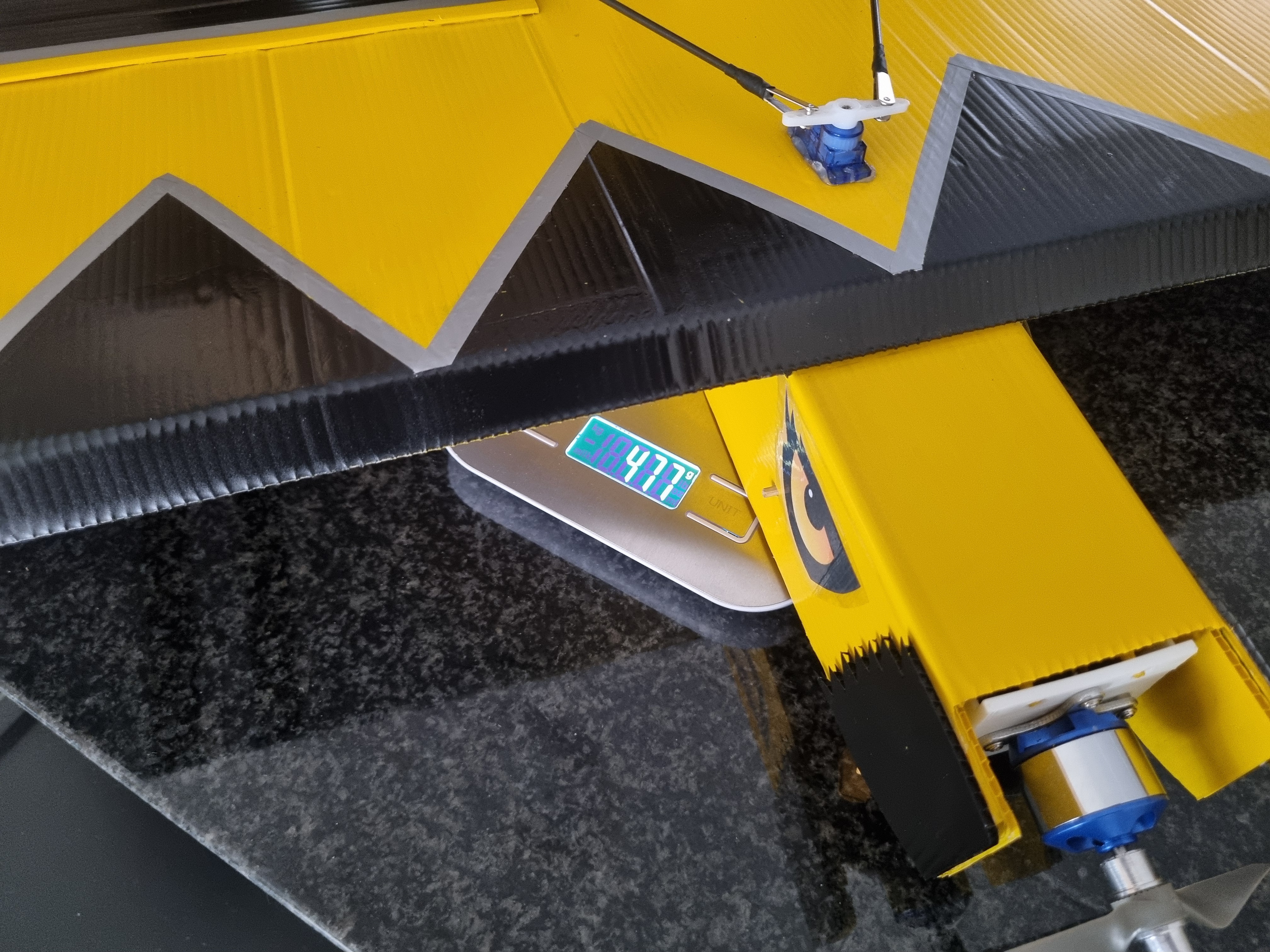

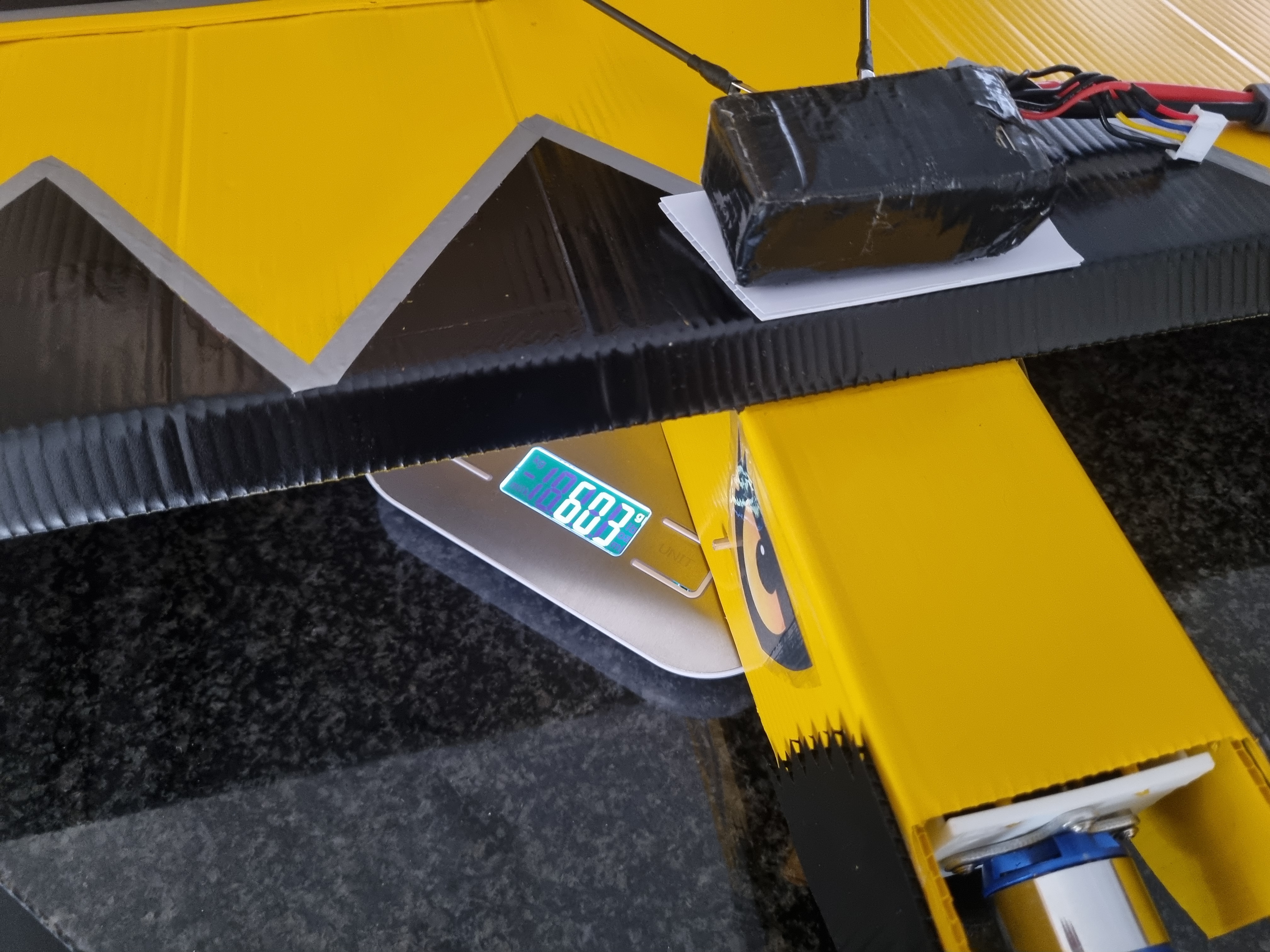

AUW with my 3S 1500 45C Lipo is 603g. Pitty I am off by 3g 🤣
Without the batt I am at 477g. Paint work did add some weight in the end but it does look cool in the sky.
