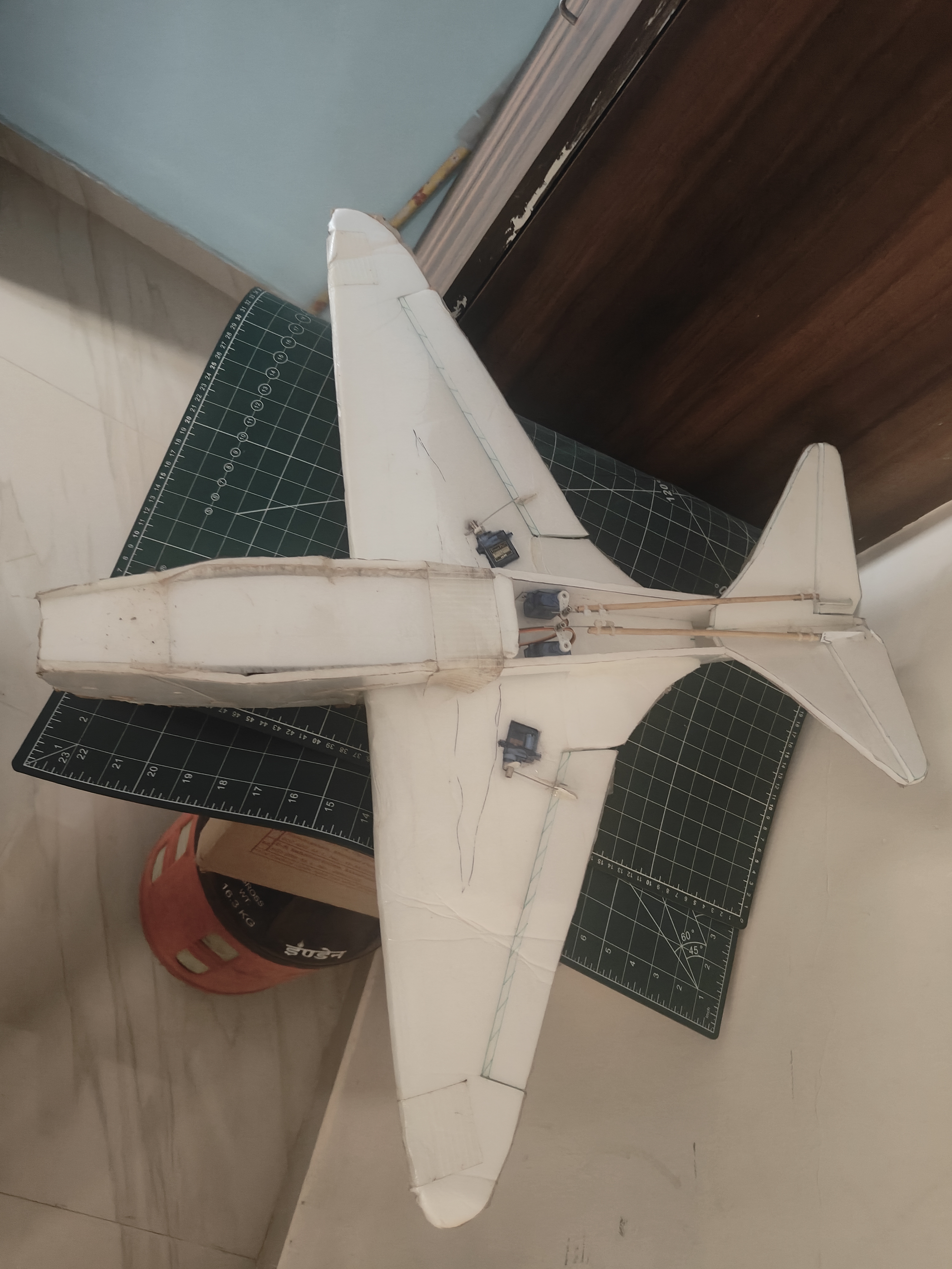

Hello all,
This is the plane which was maiden and returned safely.I used Bamboo dowels for V-tail pushrods as the regular 1mm steel pushrods were bending and flexing during servo movement. How to avoid bending of pushrods?
