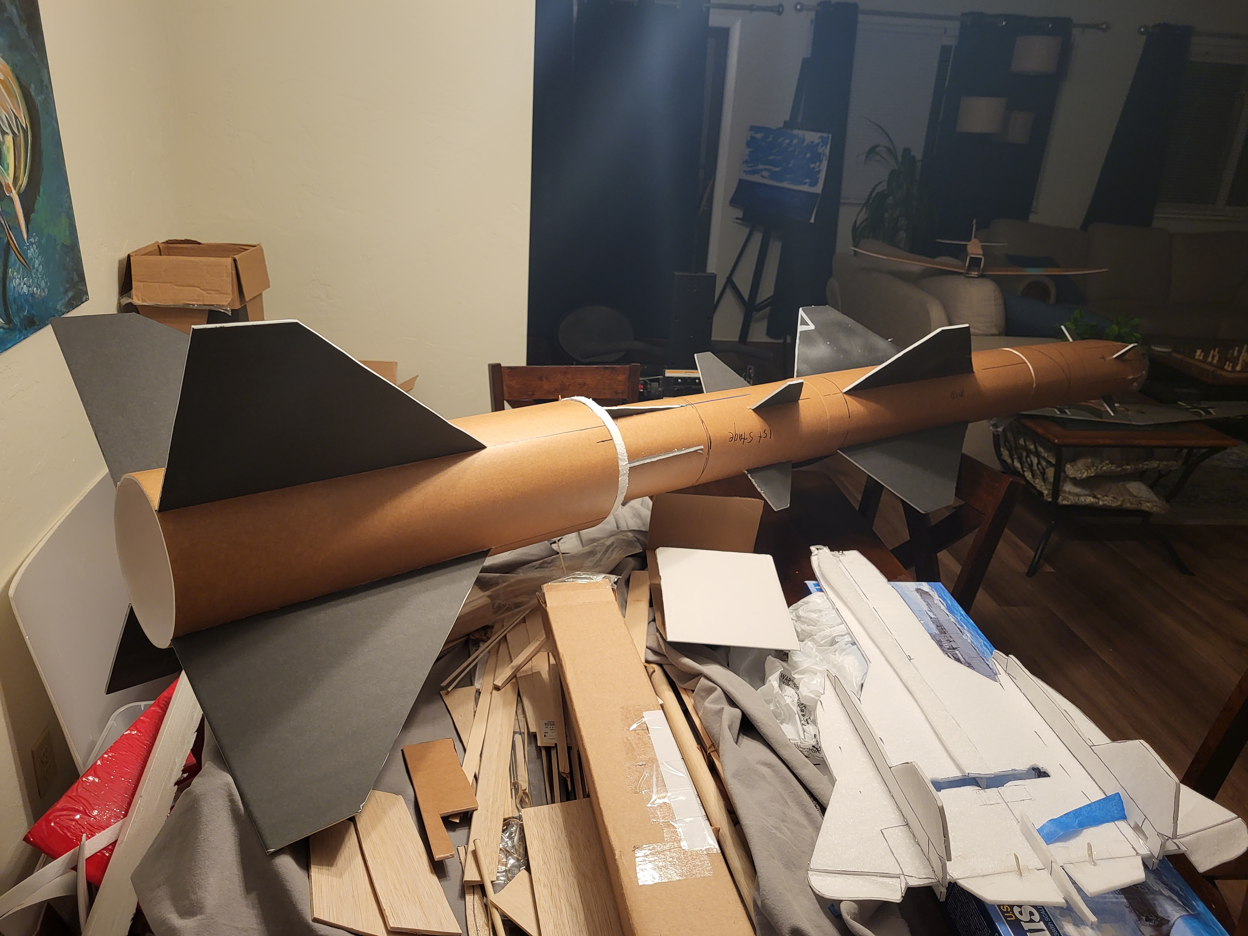

Apologies if you've already covered these questions:
  1. Is that just DTFB for the tube?
  2. Yeah, weight too? (@L Edge)
  3. How'd you roll it so perfectly round especially at the seam?
  4. When flying, how do you visibly know which side is up/down/left/right so you don't direct it the wrong way?
Inq
By having the concentration and the only way to land these is in no wind.
You do need to have 3 axis control so you need prop flow across all. Toughest was yaw on trying to land. Even played with 2 motors facing each other cw/ccw in upper centerline section to get rid of the torque.
There were no plans, so you tried from what you know.
https://forum.flitetest.com/index.php?threads/will-it-fly.66489/page-2
Looked to fly fine! (y)
No worries!
1. The tube and fins are carefully bent flite test Addams board. I used recycled 6" EPS discs about 1'' thick for the bulkheads, just hot glued in.
2. I have not weighed it yet. I am thinking 3lbs. Which is funny, its way heavier than that AIM-9 from the video, so it will probably be a rodeo on the maiden (trying to trim it)
3. I peeled one sheet of paper off one side and used a 3" PVC pipe I had laying around to hand bend it to 'mold it'
4. I had an idea of ripping the AR636B (AS3X/SAFE) receiver out of my Turbo Timber and bind it in SAFE mode, to keep wings level, but then I read on the RC groups I might alter the firmware on accident that has the SAFE programming if I plug in my Spektrum programmer and set it up for EVELONS. I don't want to risk it. Its the only SAFE Rx I have.
I will probably spray one fin BRIGHT florescent Orange to tell orientation.

Cool having access to the real thing... or at least a dummy of a real thing. :cool:
Mutley
My old man is one of those retired guys hanging out in the air and space museum, he gives tours. He 'looked the other way' when I stepped over the rope and took that picture.
Inq
:ROFLMAO::ROFLMAO::ROFLMAO:
I think it's great! It was especially funny when you said you had no camera man... and how you asked us (the audience) if we could see it?
