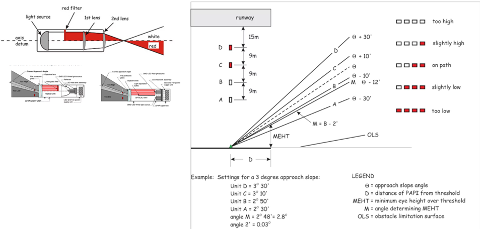

Does anyone know more about the PAPI landing systems. Specifically the Lensing, or the how might I achieve the similar effect with Off the shelf parts, or SLA printing?
https://www.opticsforhire.com/blog/papi-optical-design/
I wanted to put these either in or on the rear wingset.
I'm thinking an LED in a Pen tube or slivered Straw set on a printed (incrementally angled) base.
I don't think PAPI is going to be of much use on a moving target. Seat of the pants and luck are going to be required. you could fake it with red and white LEDs. Especially if you had altimeters/GPS altitude on both aircraft and you could compare distance and altitudes.

The papi was mostly for fun and i think would be a nice touch and. But i really like the idea if using gps positions to shine an appropriate color.
It will be a fin intro into modelling and printing.

Landings. I remember the rotor riot quad re-fuel on a Kraken attempts. While some of the issue is the speed delta with two independant flight vectors thrown asunder by the windy moment. Sine if it was landing with corrected orientation. I thought traditional landing assist stuff might be a help here too.
