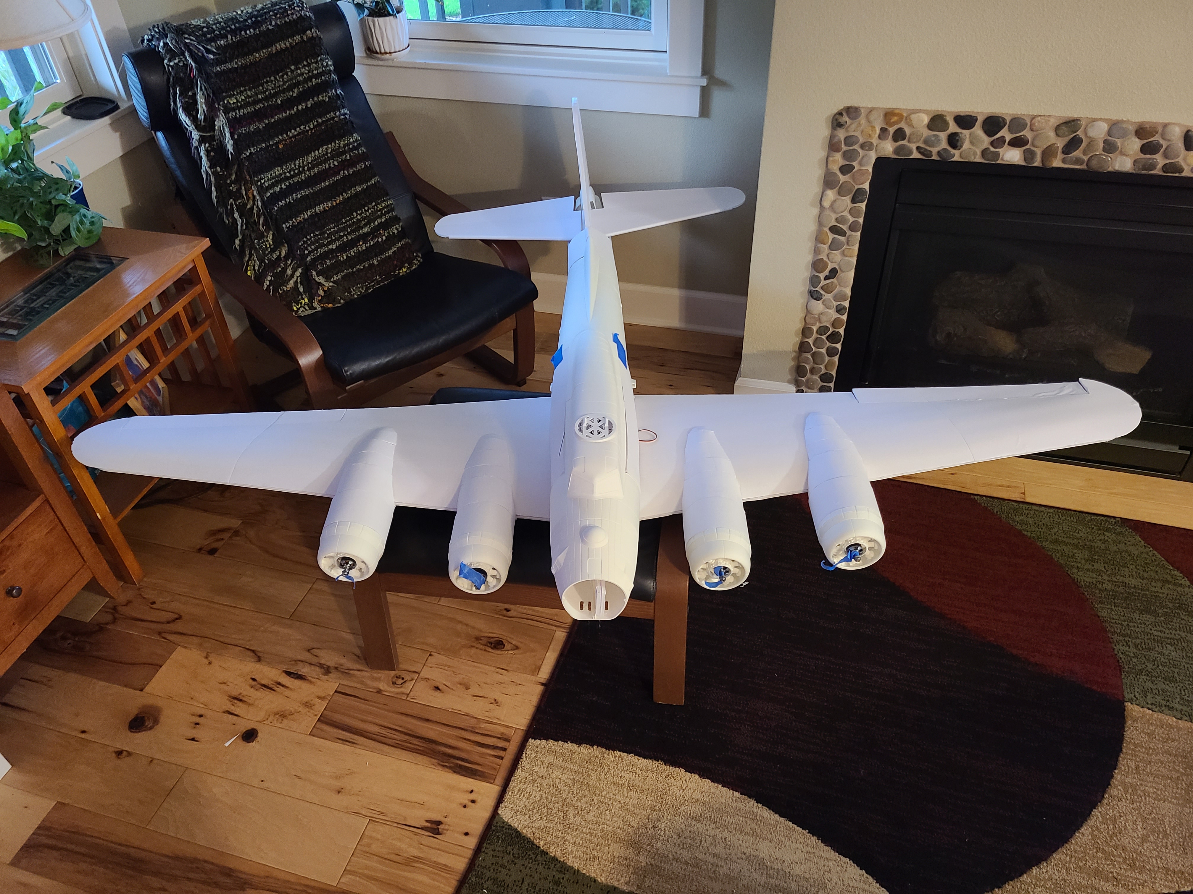

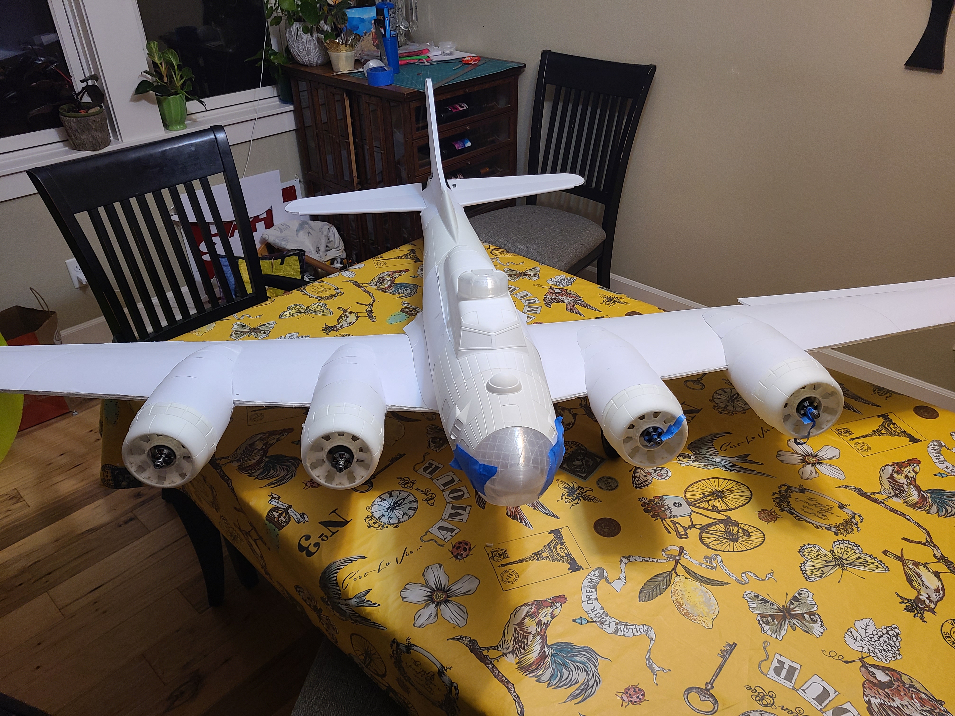

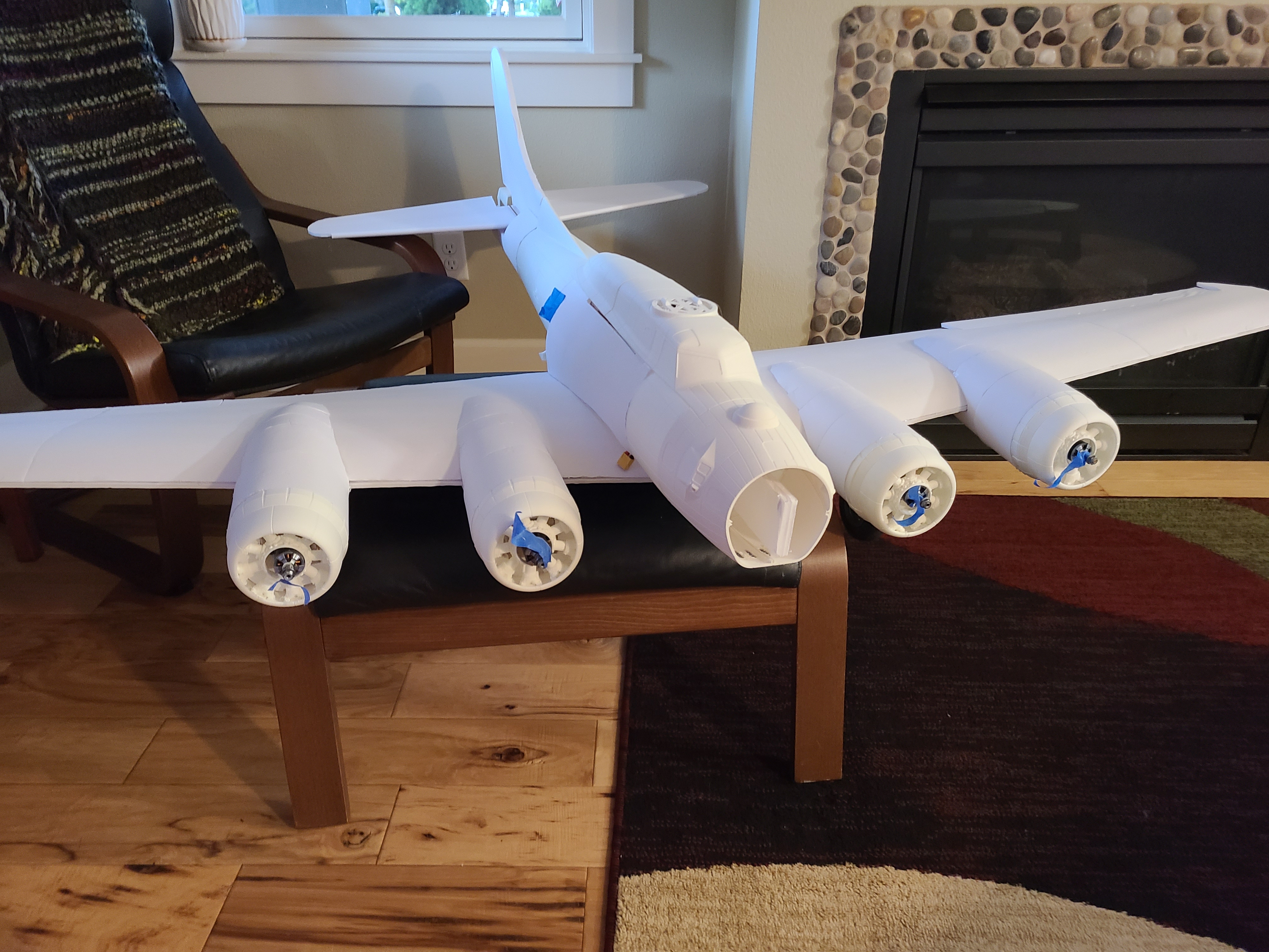

Another night cutting foam on the B-17 (2nd version). You may notice the tail feathers are a little bit crooked. It slipped during the glue up. I'll have to fix that.

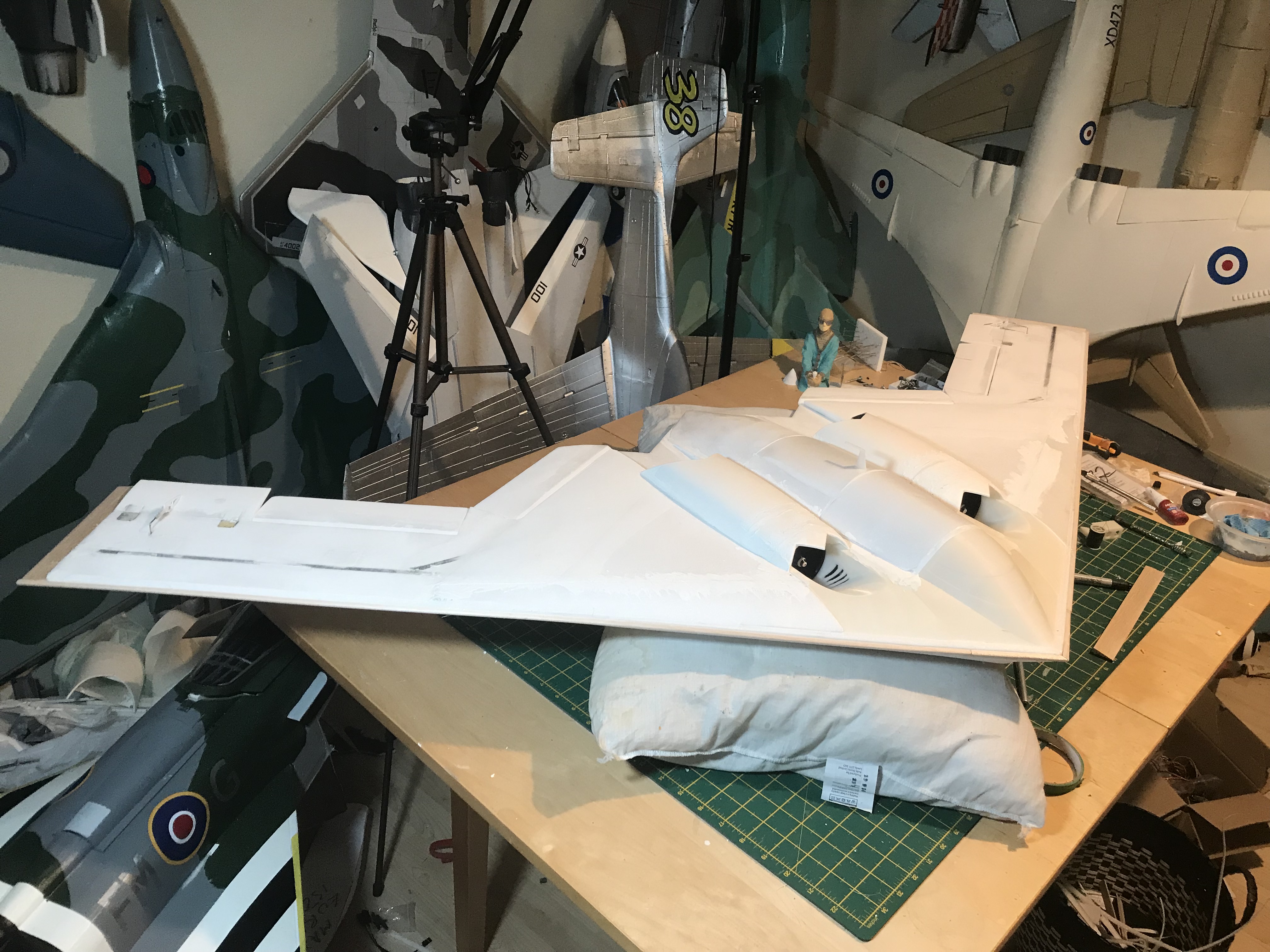

here’s light from my 1st one
Could you explain how you approached the rudderless situation? Using a FC or gyro(s)? Noticed the drag brakes.
my last build and this one will have working Drag “Rudder”
I tested it with both gyro the last time and worked good most of the time but found gyro had it crabbing at times
without it worked great also, did what I wanted it to do and when…. But not ruling out a gyro would be beneficial to a wing 👍
i have drag set on 2 different channels, in a servo centred position they are both set open at 20* (degrees) = split 10*10*
if I push full left on rudder the right drag closes and the left will open to approximately 50* (degrees)
this could be achieved with a y cable however it would take more fine tuning of servo and control arm position.
when on separate Chanel’s let’s say the left (drag) I reduce the end point on the radio 1st, then push full right stick & keep it there,
then adjust the end point until it closes fully without servo stressing. move stick full left and hold it there - again adjust end point till I get the desired ”full open” position
repeat the process on the Right “Drag” rudder in opposite directions
the Aim is to have one close while the other opens. When rudder stick is released the both return to “equally” open at around 20*
this build I’m thinking of adding 3pos switch to the Drag rudders ……. With some mixing on radio …… tx16
pos1- (bottom) - both closed to reduce drag and get flat out speed 😂🚀
pos2 - (middle) - normal flight operation with Drag rudder
pos3 - (top) - both open and used as drag brake
still not decided on this tho lol

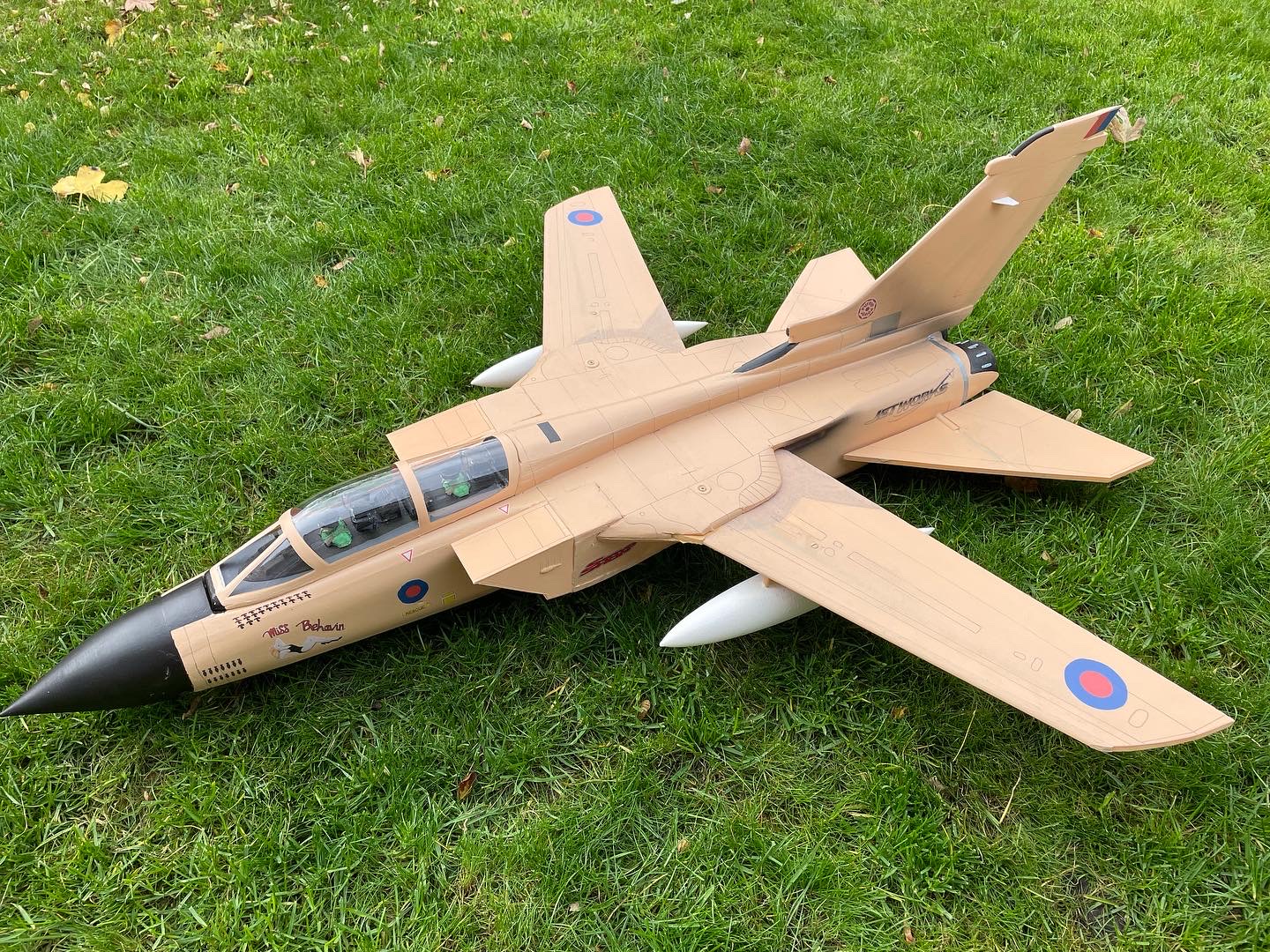

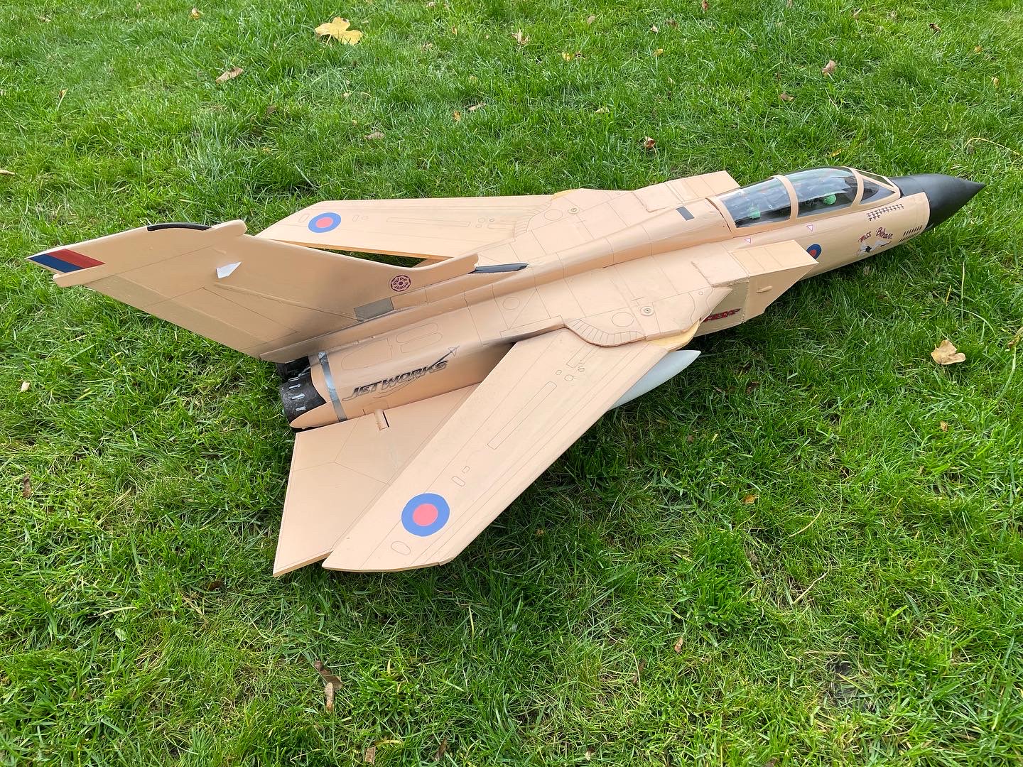

Very nice shady! I just checked out your channel. I really liked your tornado. Very underrated plane here in the states.
Thanks buddy 👍🏻 I try to put up as much info on the builds as possible but miss things at times for the excitement of a maiden lol , I have ran the Tornado on the 70mm and recently switched it to pusher and love it still , great swing wing model

How did you end up addressing the “long grass breaks stuff” issue? Mow the lawn or change the design a tad? And that thing is so darn pretty. So impressed.
