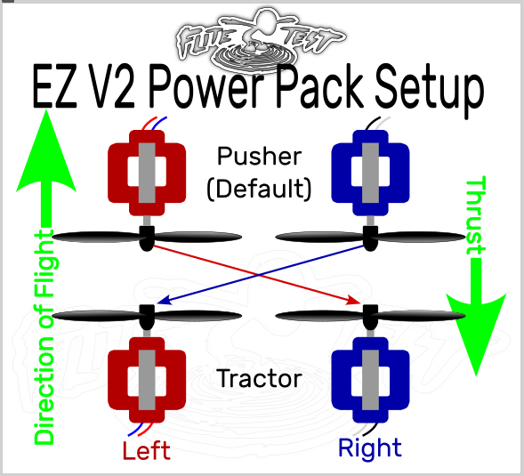

Yo guys, my FT EZ Power Pack doesn't work! 🥺 It always yaws left (or was it right) for no absolute reason. On tests, it works fine, but when I actually put it on a plane, well. Nope. ...
Have you flown an EZ plane successfully before?
What EZ plane are you trying to fly? FT kit? Community design? Your design?
If you reduce the throttle to zero, the EZ planes will not fly. The motors/props are the gyro.
The board MUST be installed in a specific way. Vertically, with the LED down and battery plug forward.
Motors MUST also be installed in the correct orientation, with the props in the correct orientation.

In a static test, with motors running a bit, when you yaw the plane left it should increase the left motor to try to correct it to the right. Does this happen for you?

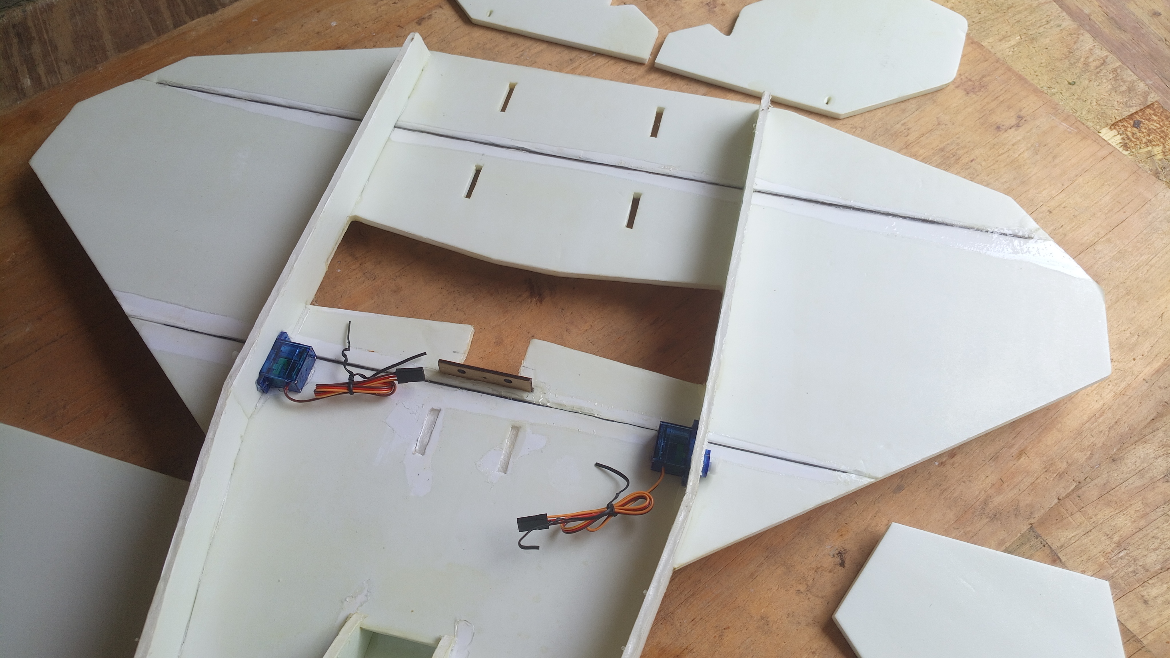

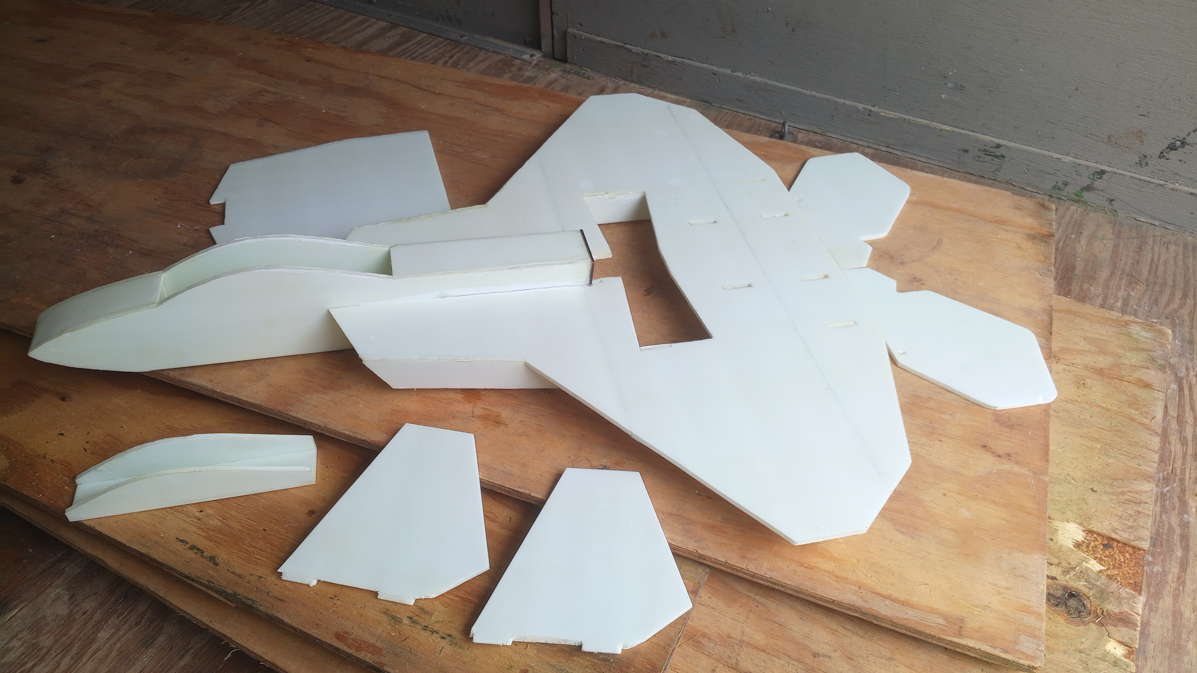

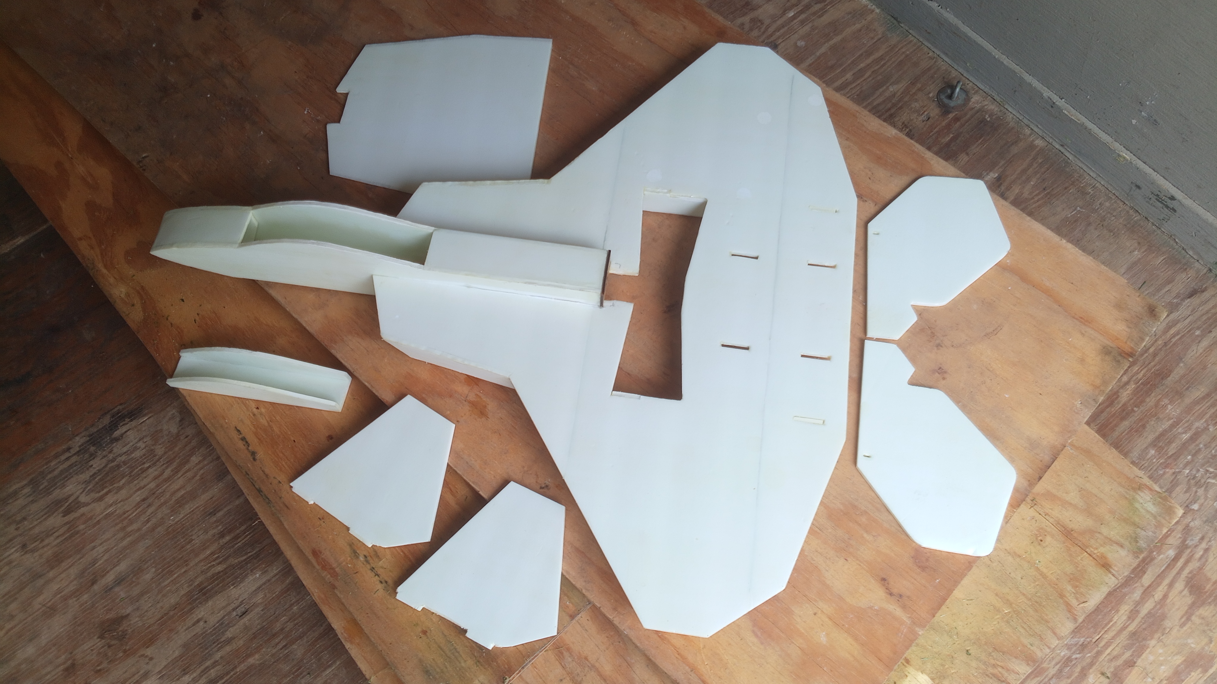

Working on a FT22. Just did polyurethane last night so I'll let this sit for another day or more before assembly and some vinyl and paint. I had to do it again, but full size this time. I'm missing my mini Raptor after it got shredded on a vineyard trellis awhile back.
1mm x 3mm carbon bedded in the wing.
Would like to add FPV if the CG will allow it.

You probably have the props and in wrong motors...try holding it in mid air and see if it tries to push back and keep it straight when you yaw it quickly.(y)
The props are going the right way. In tests, it goes straight, it's not spinning like crazy. But when I put it airborne, yeah, it HAS to be balance
