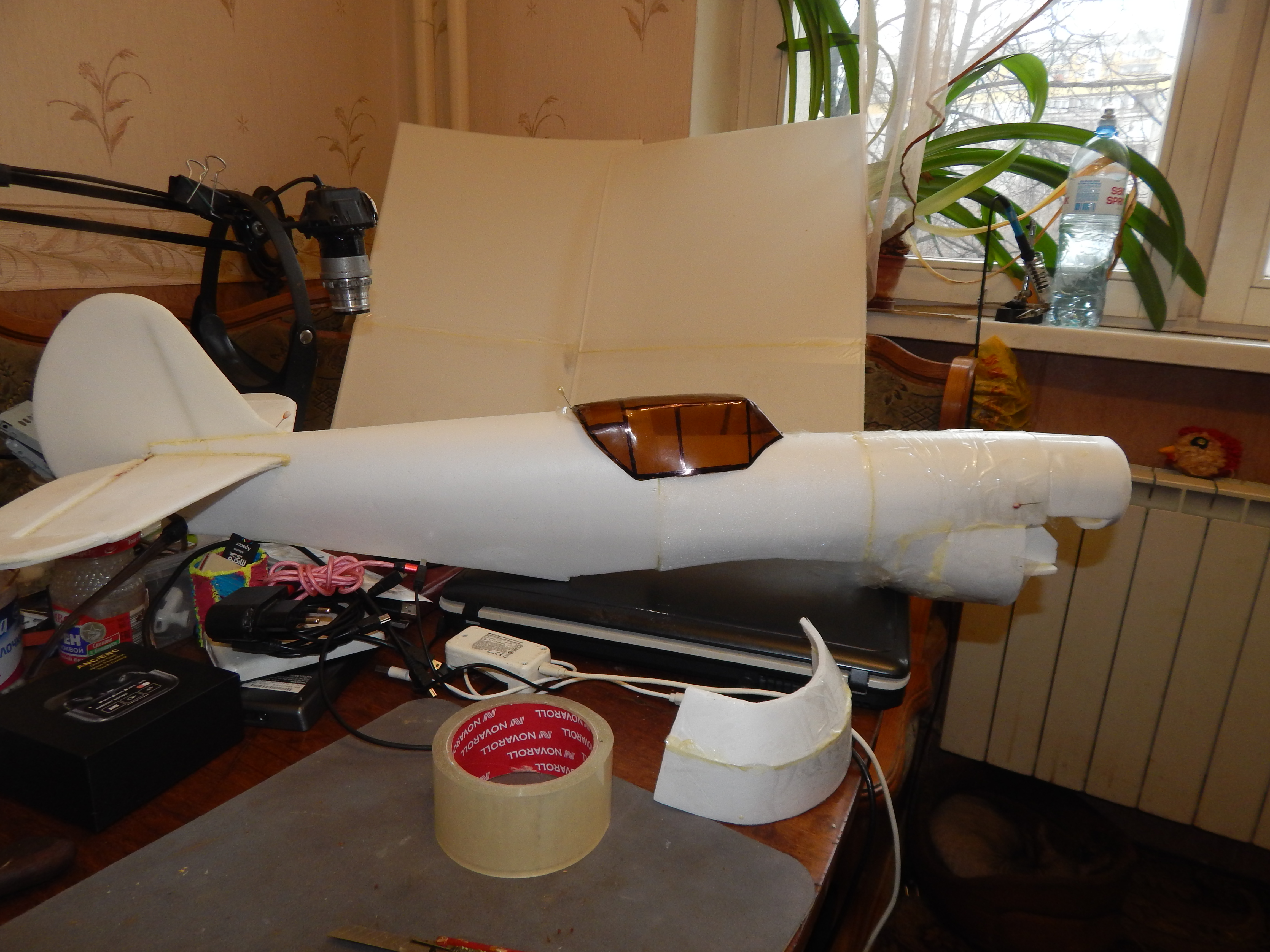

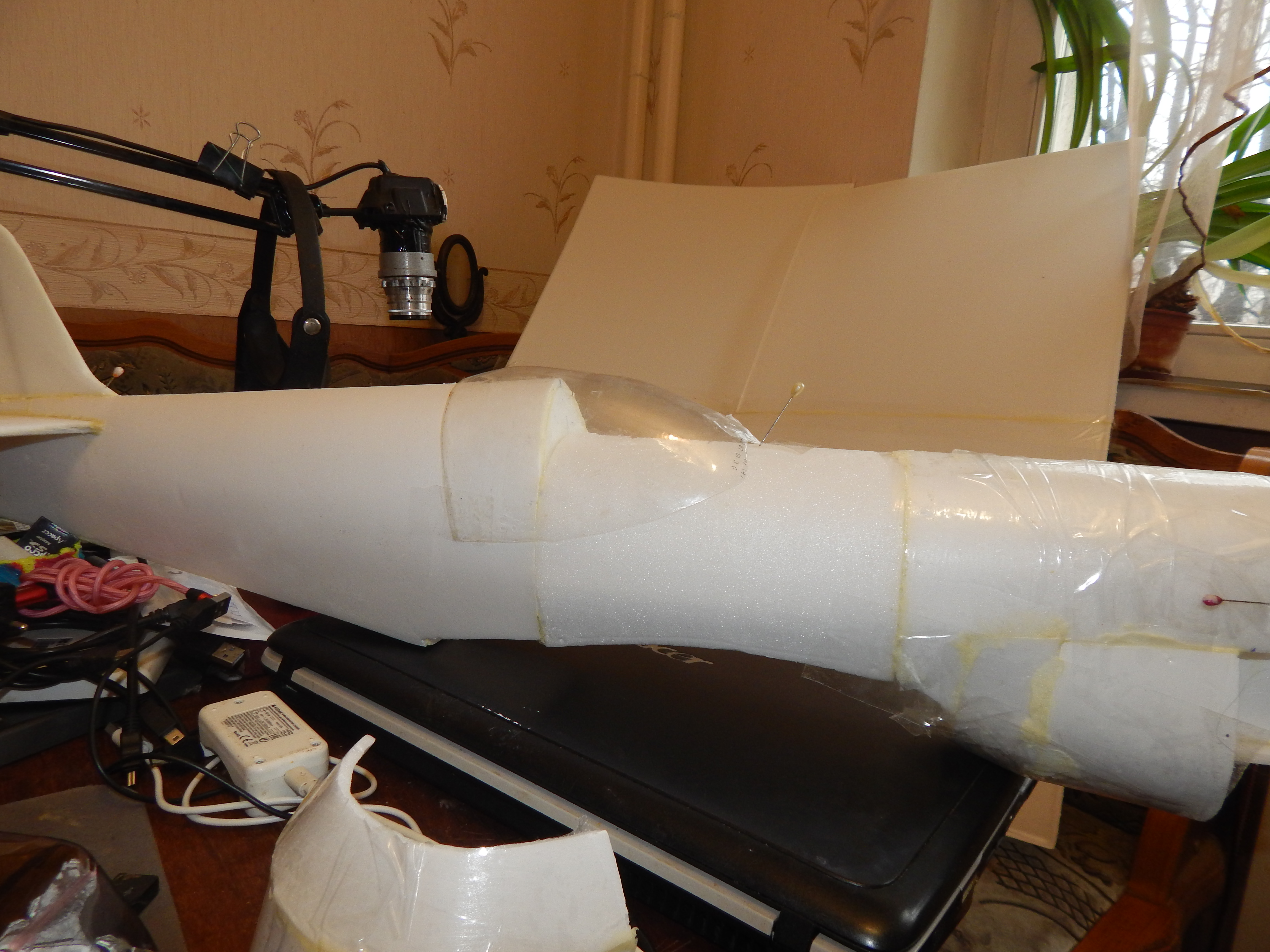

I finished the fuselage of the P 40 Hawk yesterday. It took 2 days - 6 hours. He moved on to the manufacture of the wing and.... when trimming the foam plate, I cut off the tip of my thumb. I'll post photos of the fuselage later. I wanted to make a mock-up of a plaster lantern, but I found a Messerschmit lantern. This model is not a copy, and you will see the flashlight in the photo. A friend gave me a realme note 50, which I repaired: I inserted a new charging chip. But I can't connect it to my laptop yet. Installed a bunch of drivers... nothing.I took photos on my phone, there are no batteries in the camera yet.

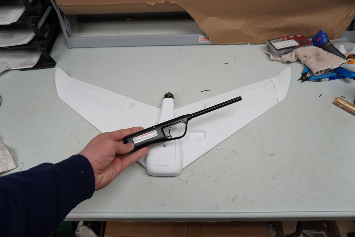

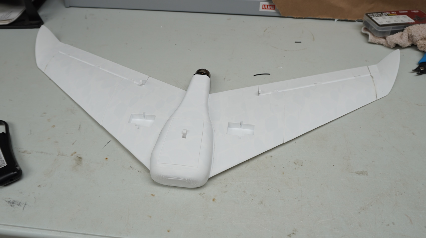

Guys, a friend just gave an old XFly twin 40mm Eagle (weird flying wing). I really don't feel like fixing it up, so I'd rather build something with the electronics. Any ideas or things yall have tried?
An A-10? Oh, an SR-71!!! (Jk, there aren’t many good designs for that yet, I know @Houndpup Rc did make one, but it didn’t fly too well apparently, and @Horseman3381 made one too for 50mm edf’s, and it didn’t fly well either)
Give me time!😆😆😆 I either want to try rebuilding it, or if you do another MS challenge I might try making on that is similar to build...if that's possible...(Though I will be MUCH better at Onshape this time!)
short_nathan
Actually, an SR-71 wouldn't be that bad of an idea, remember my crap design? I have one of the prototypes sitting around my house, and the nacelles seem perfect for 40mm EDFs, so this might end up being my first design to get airborne
