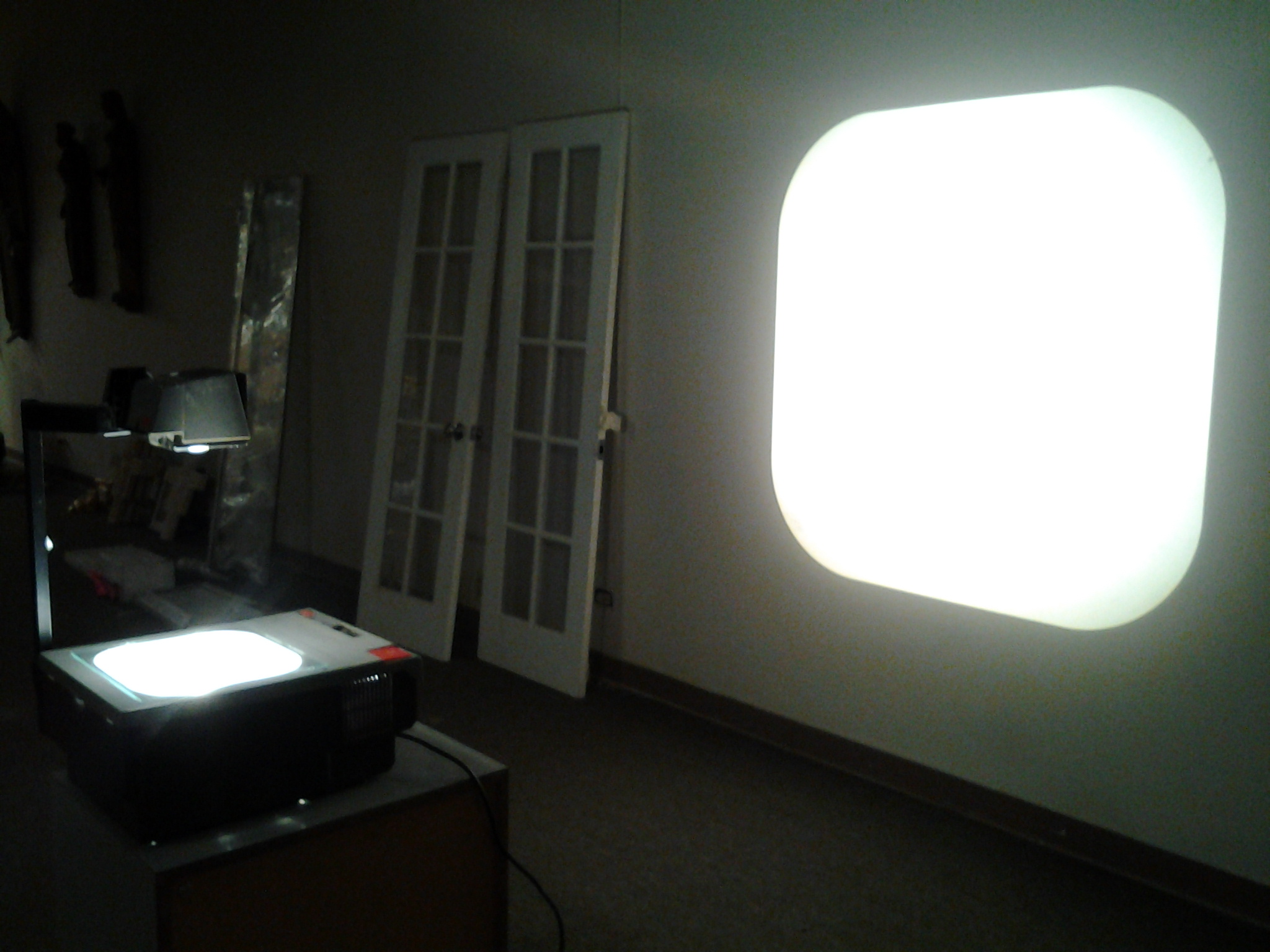

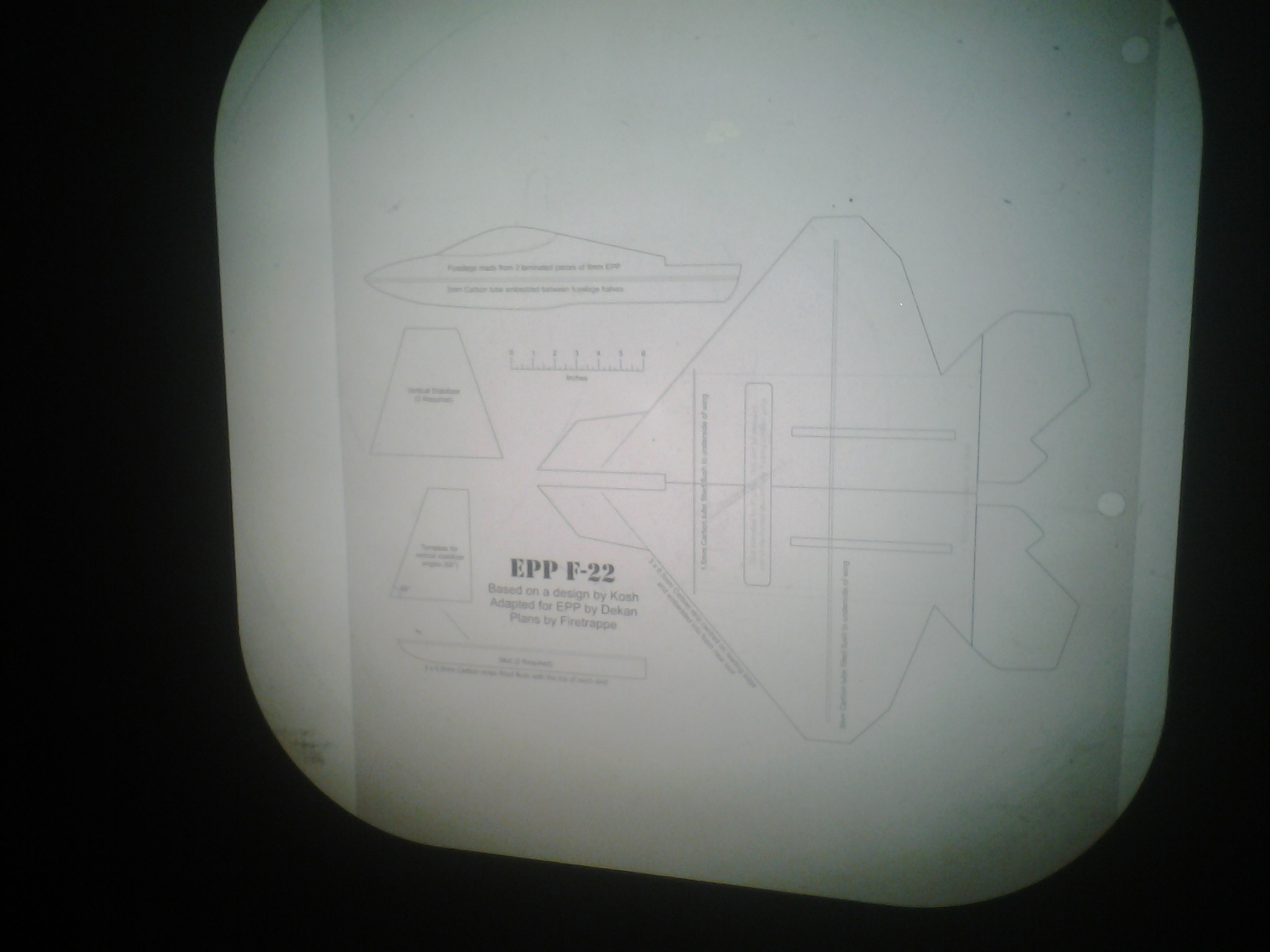

ok so i did this for a couple of my builds, if you have a projector or an overhead projector. you can transfer the image to th wall using you phone or pc, it is kind of tricky you are going to use the wings to get the correct wingspan. if you are going to do 73 wingspan you measure the wing until you get the right wingspan. you do this by backing up the projector away from the wall. are are also going to make a line in the middle of your score cuts and make a new score cut because the old one expanded when you exploded the image. u are also going to use the image printed on the image to align the wing making sure it measures the same all the way through. like it might measure 1 1/2 on one side and on the other it might be 1" you got to make sure all the squares on the printed ruler are the same size. once align do not move the projector. use the same distance to trace ur plane. if the wing needs two pieces of foamboard hot glue them and add packing tape. warning tracing the wing on the wall i8s like doing yoga every bone pops nerves scream. well, this is only a suggestion. Remember Its all about having fun. I got to see if my plane garden is sprouting i have planted few over the years.
