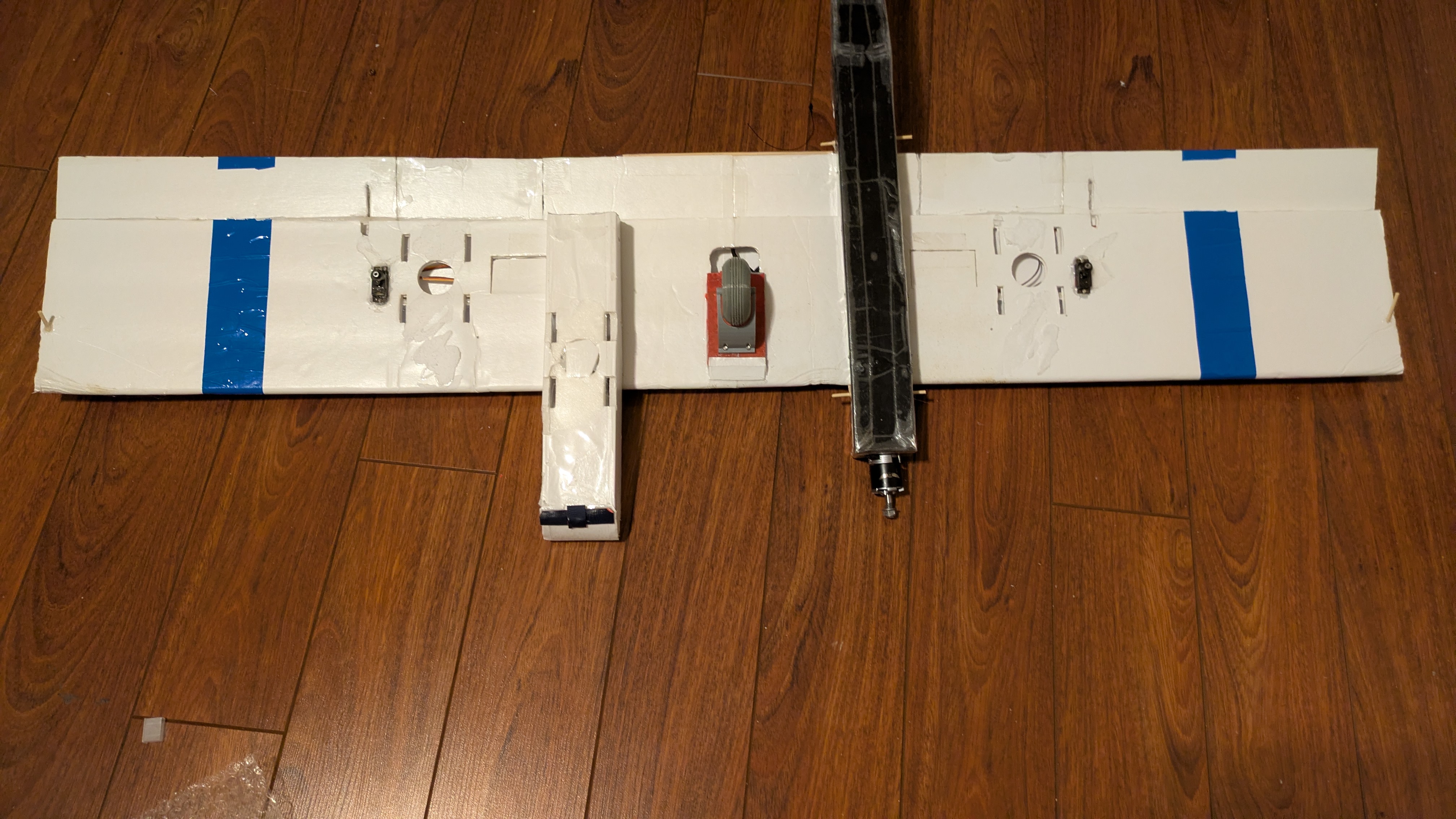

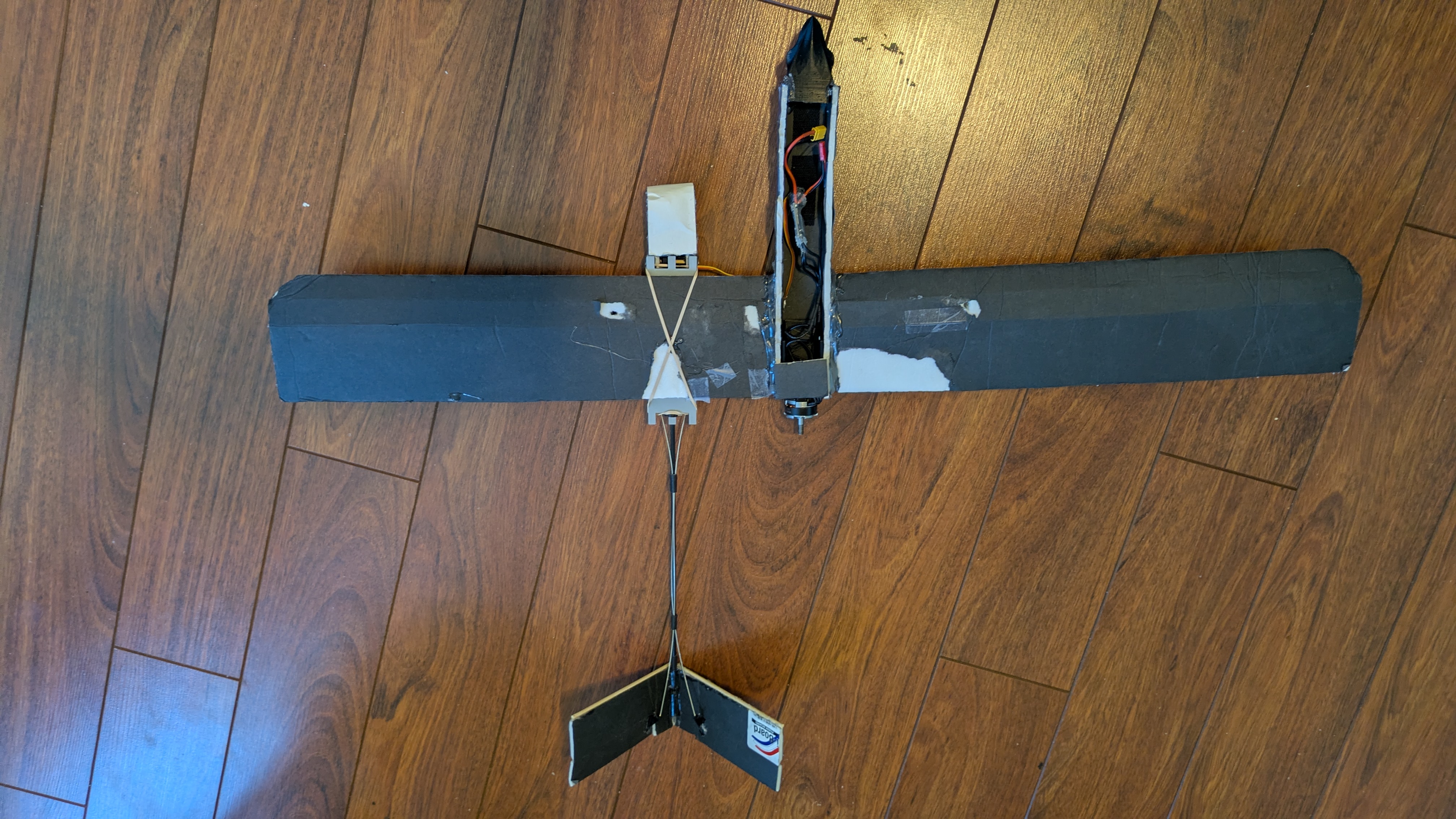

So I am making another weird airplane. The general idea of this one is to make an asymmetric airplane that can have a large and swappable payload pod. I am using a wing from a guinea pig (that I found in the trash at ff24), a custom fuselage I made a while ago from this build, and some kind of swappable cargo pod thing that I haven't made yet. I have tried this before, but it was a little too asymmetric. You can probably guess what happened...

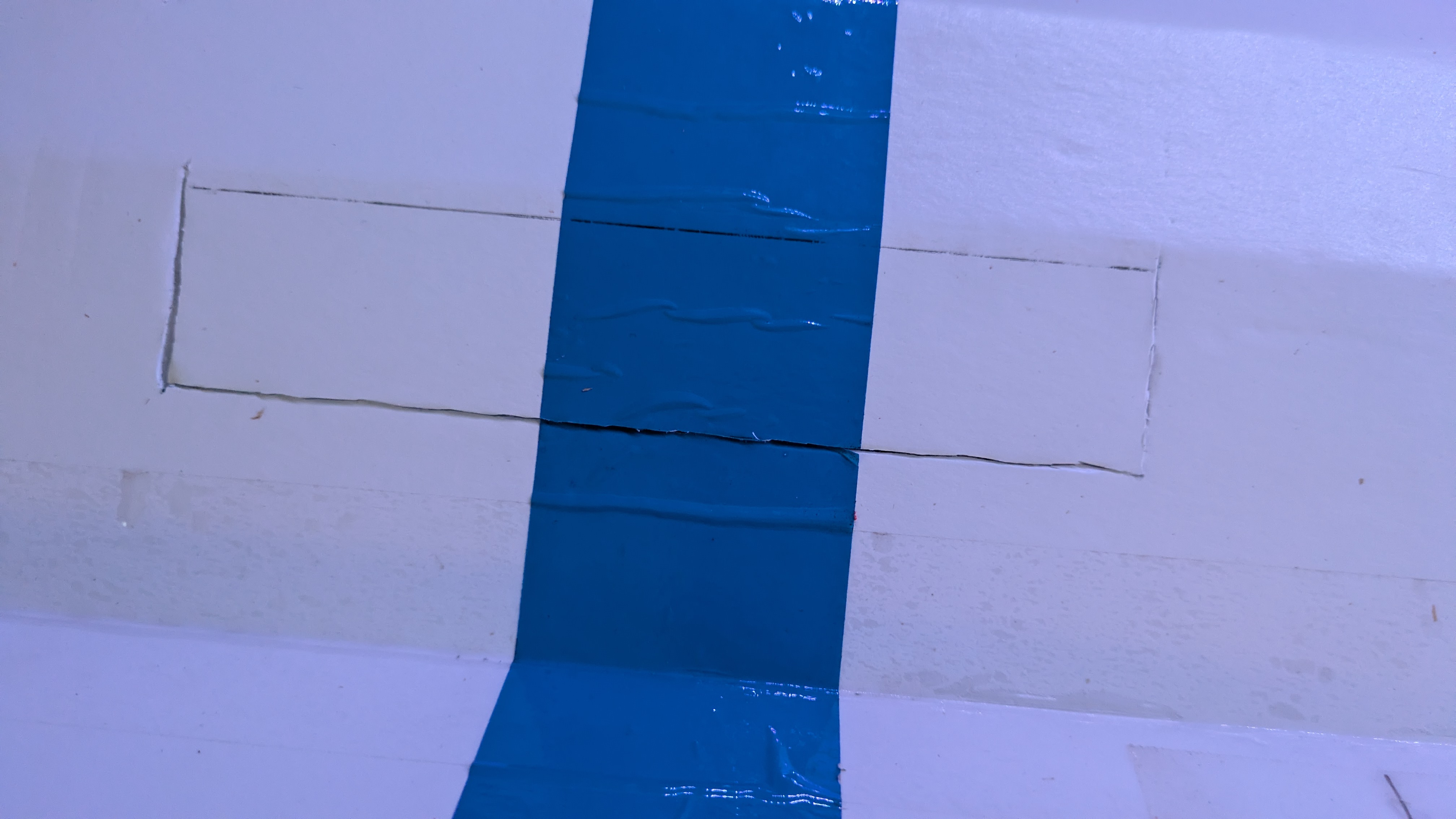

Anyway, I am wondering if anyone has experience with spoilerons, specifically in combination with full span flaperons. My theory is that the flaperons will take care of both flaps and also small adjustments, while I could make the spoilerons kick in later for large adjustments. Any thoughts?

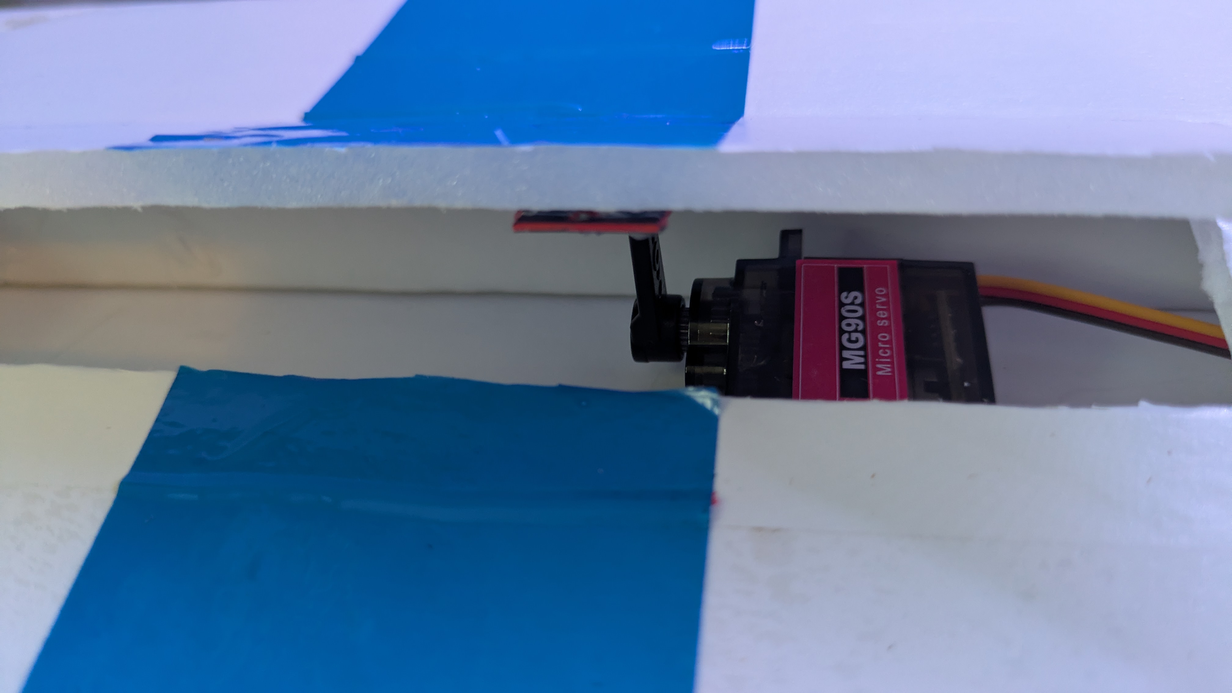

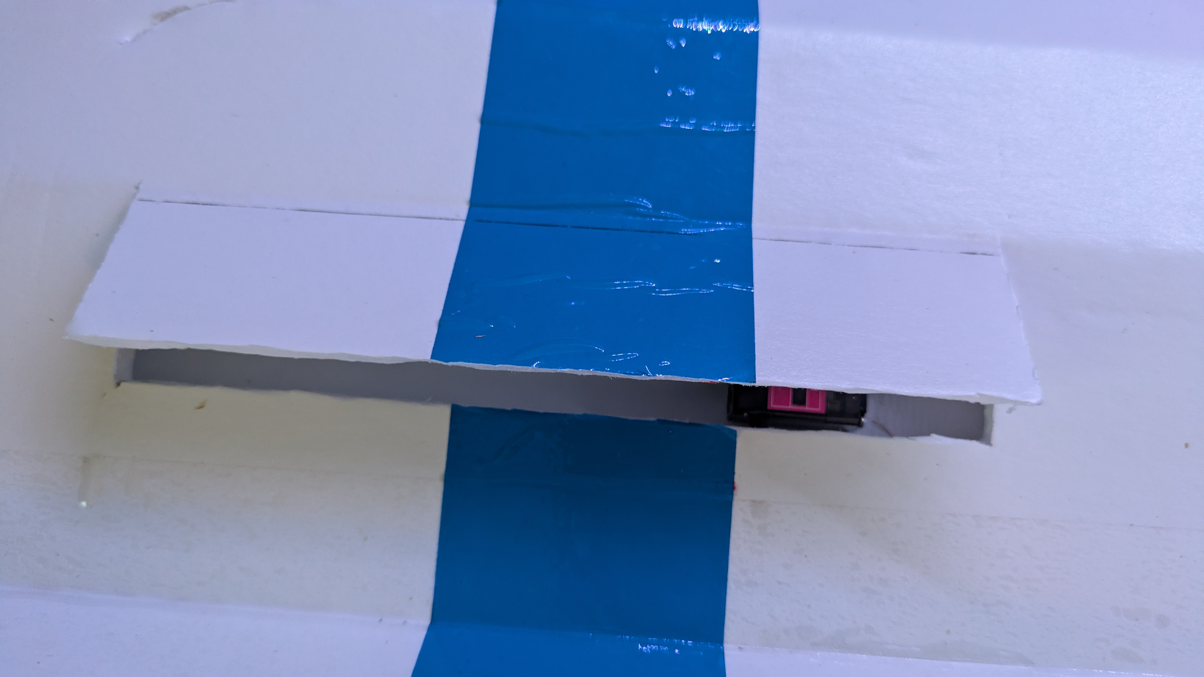

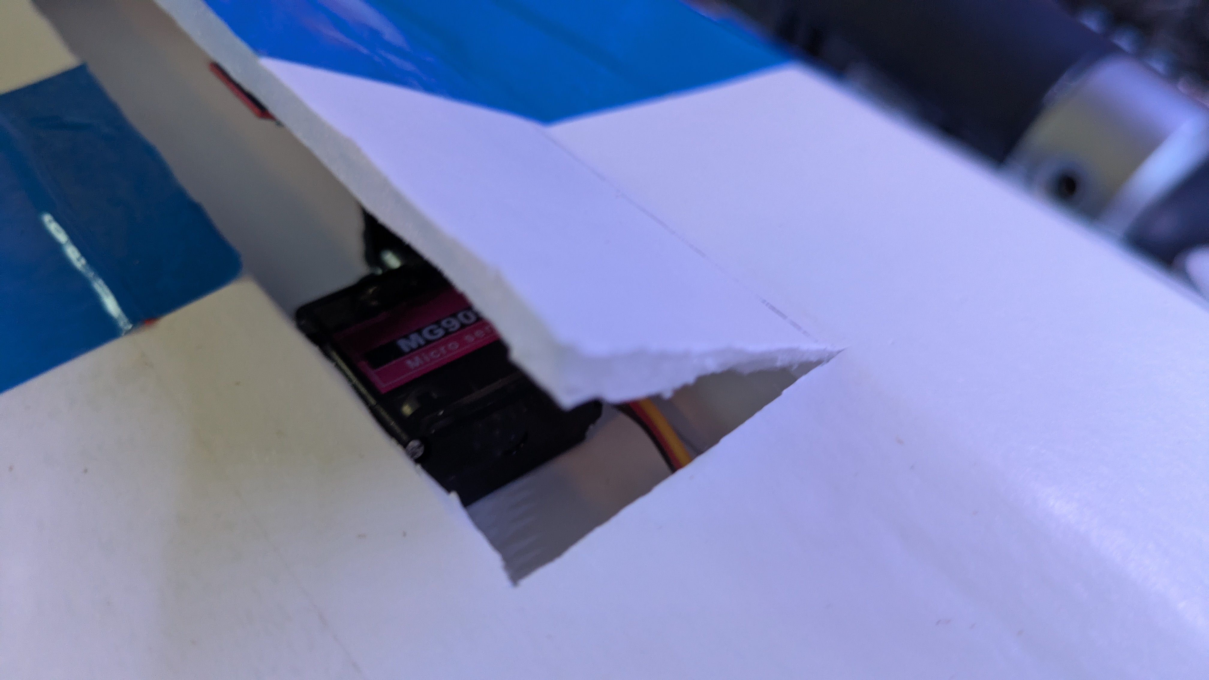

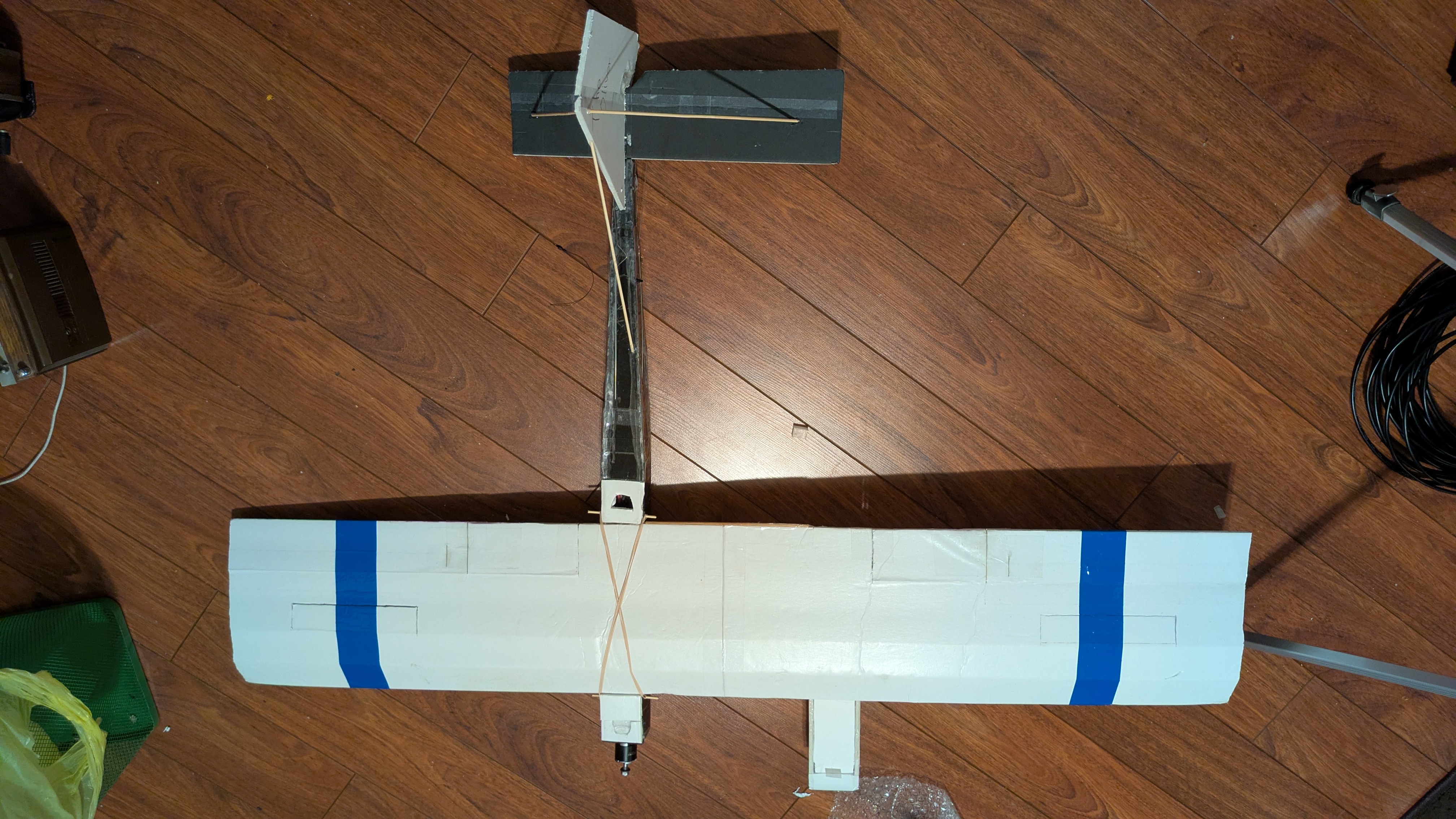

I have finished making the spoilers. I have also finished hooking up the tail. However, I think that my servo tester just killed three servos. I have never had any problems with these servos, but I have also never used them with a tester. I have been using the same servos with a receiver for a while, so I'm not sure what is going on. Very weird.

I am interested if I have the motor close enough to the center, because I tried this one other time, placing the motor pod where the motor would have normally gone. That's where the holes are in between the pods and the blue tape. Asymmetric airplanes are quite interesting, because you can get away with so much and it still flies normal. Of course, there is a limit. Project Air on YouTube has a great video on this. I do have the motor angled out slightly and a big rudder, so hopefully I should be able to fly it straight.

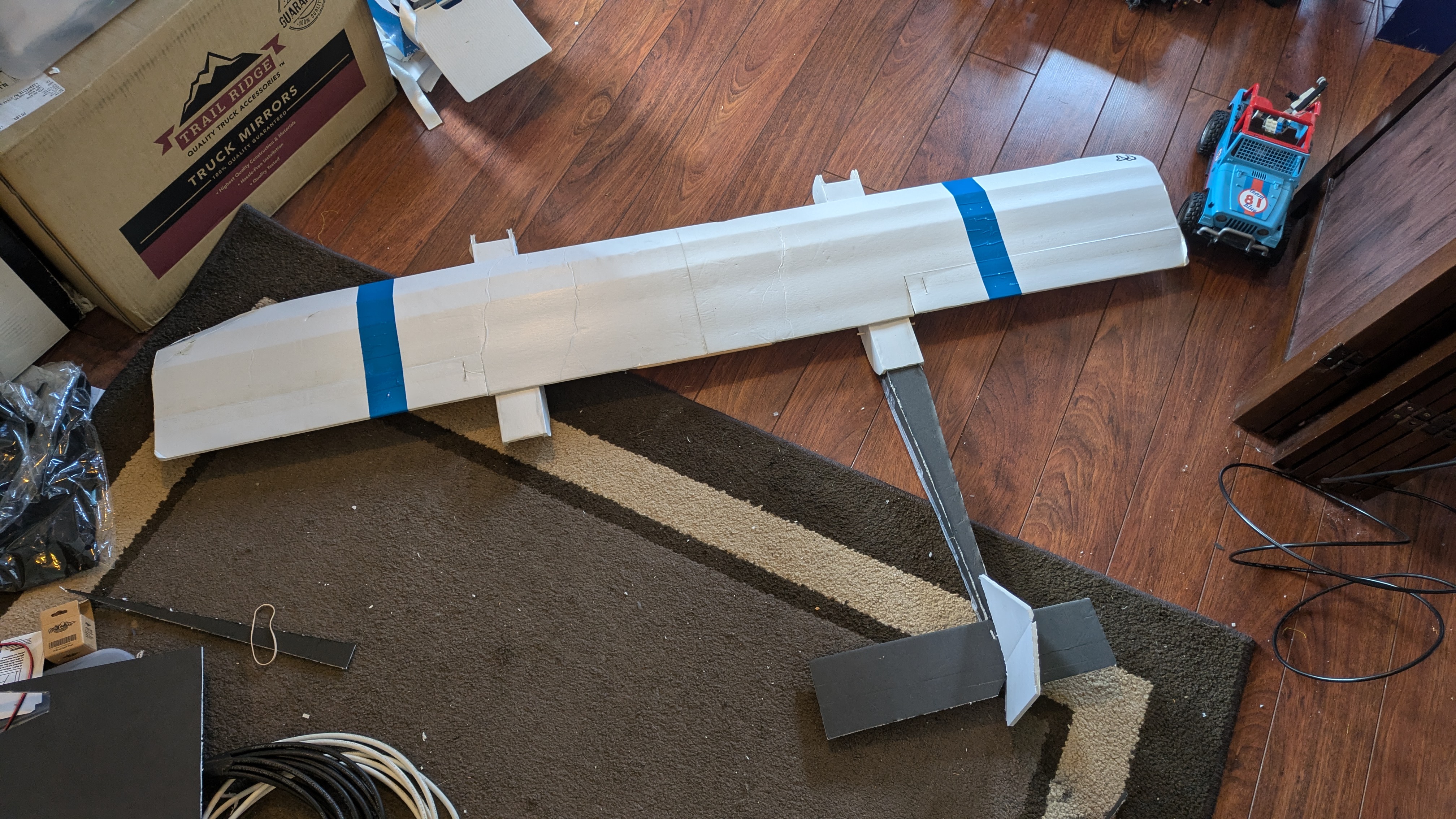

So apparently you can't hand launch an asymmetric plane. I think it needs to speed up more before taking off, otherwise the motor's thrust just turns it. I might be able to repair it, but the front part of the motor pod is bent up so much that I can't bend it back.😟😕☹️

Thank you. I think I need to make the landing gear takeoff gear as well. It should be repairable. I think the problem was that it didn't have enough airspeed for the rudder to do anything. I also think that it being tail heavy didn't help anything. :)
