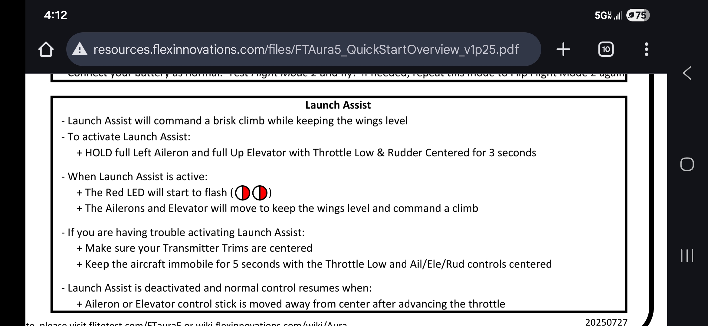

Launch assist is done with the sricks not with a flight mode
Yes sir i understand that. what i meant to say was the only reason im using the aura is the launch assist. and that i am still trying to get my gyro modes setup like i want them with 3 positions, The switch up as gyro off, the center as gyro on and the down as acro mode

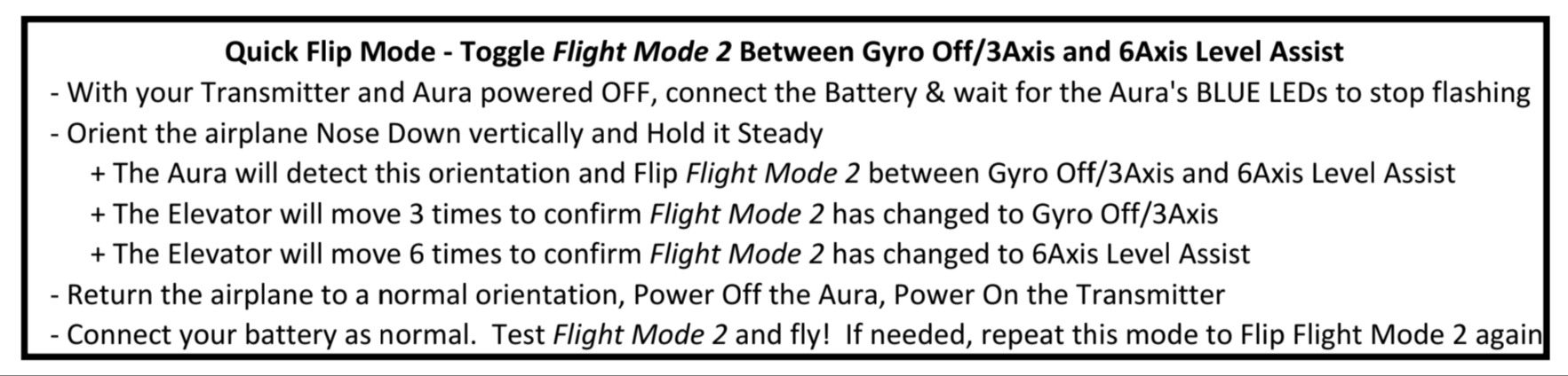

Ah, OK. The latest FT firmware has the autoleveling mode off by default. They are aware of it and are going to work with Flex Innovations to fix that going forward. I have also brought that to Flex's attention. There are several ways to enable autoleveling in the center switch position like in the past.
The three modes in the past were:
Manual - No gyro or leveling
Autolevel- (6 axis) Leveling and gyro stabilization
Gyro - (3 axis) Gyro stabilization.
If you look at the latest quick start guide, there is a way to do it by holding the plane in a nose down attitude after plugging in.
By default the three position switch for flight mode needs to be on RC channel 5. This can be remapped with the configurator.
