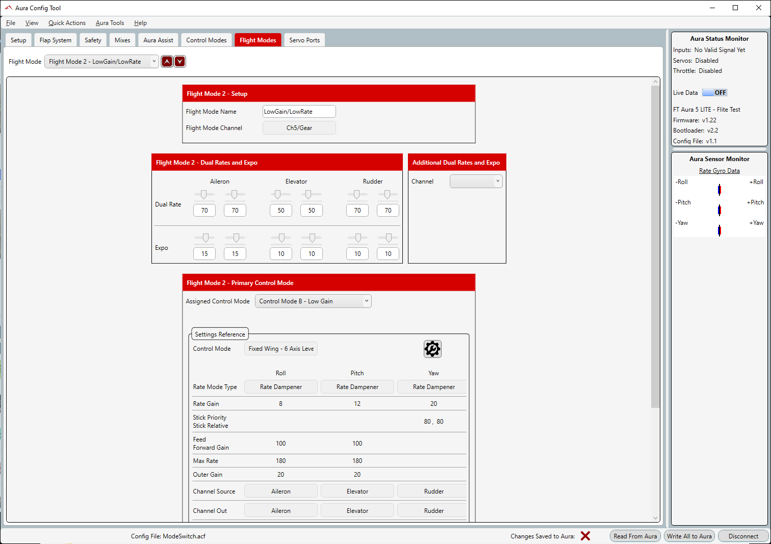

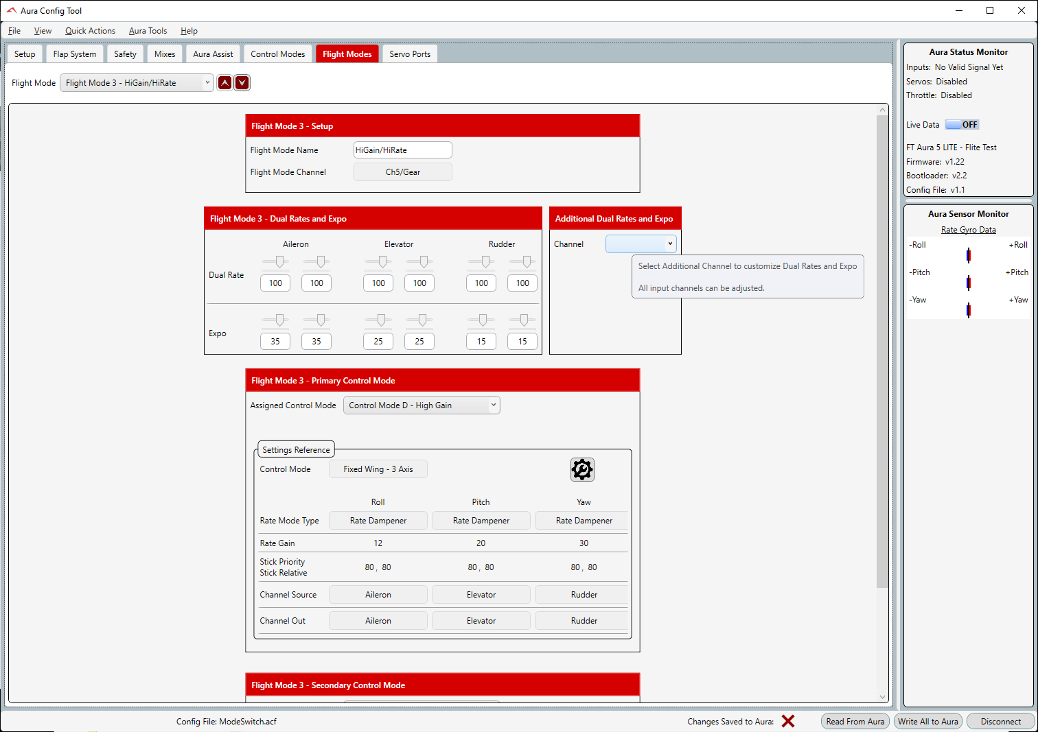

I just purchased the FT 5 lite and cannot figure out what the secondary and 3rd control modes within the flight mode settings tab are used for. Can they be controlled with a switch? I have looked thru the on line manuals and multiple you tube videos and guess I'm missing something. Can some one please point me in the right direction?

I agree . I have that set up with no issues. Under the Flight mode tab there are second and third control mode. I not sure how those parameters are used. I attached a picture that hopefully helps.

Actually, What you want isn't a switch reverse. you want to swap two modes between positions also.
Digging out a spare aura board and the configurator.....
Unfortunately the config files are not plain text, so it will be manually moving settings between the fields in the Flight Modes...
