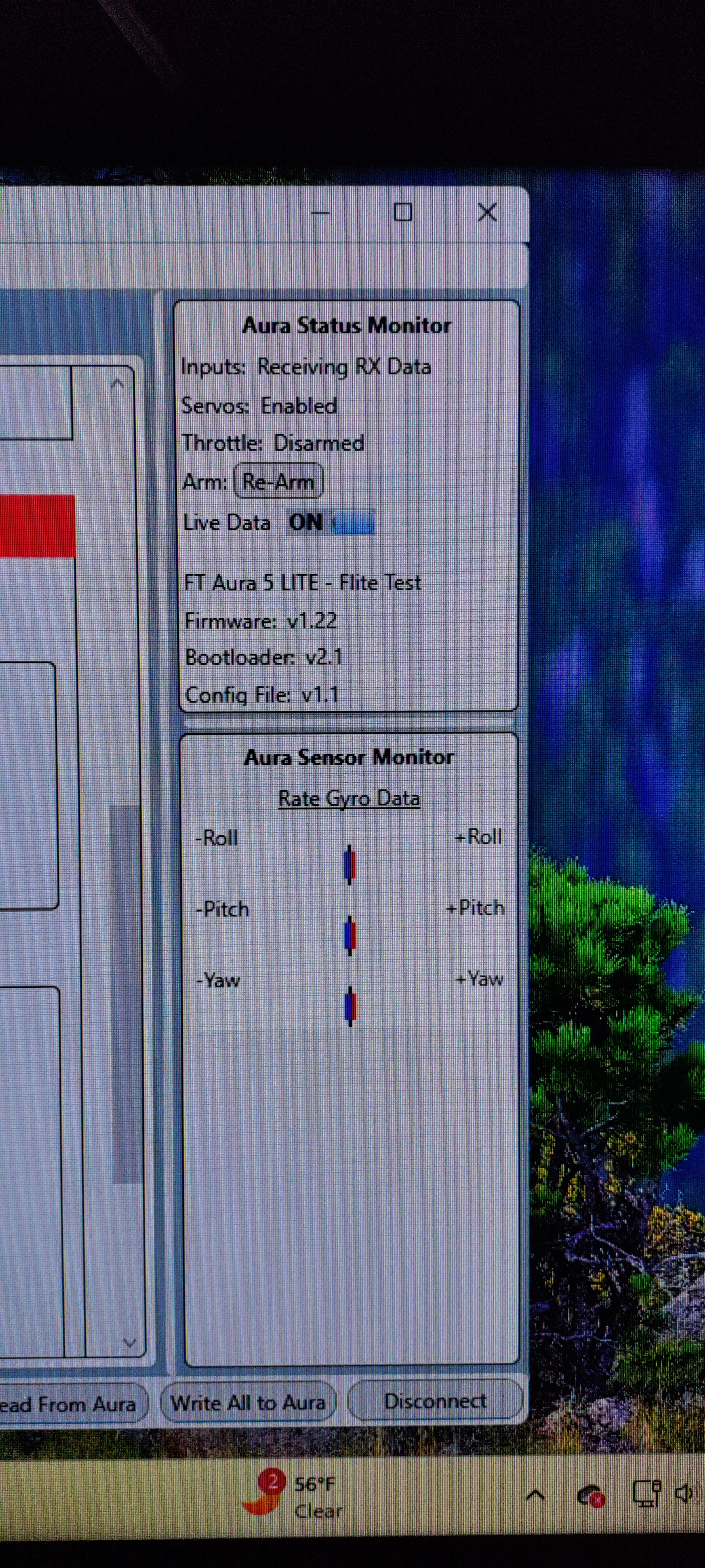

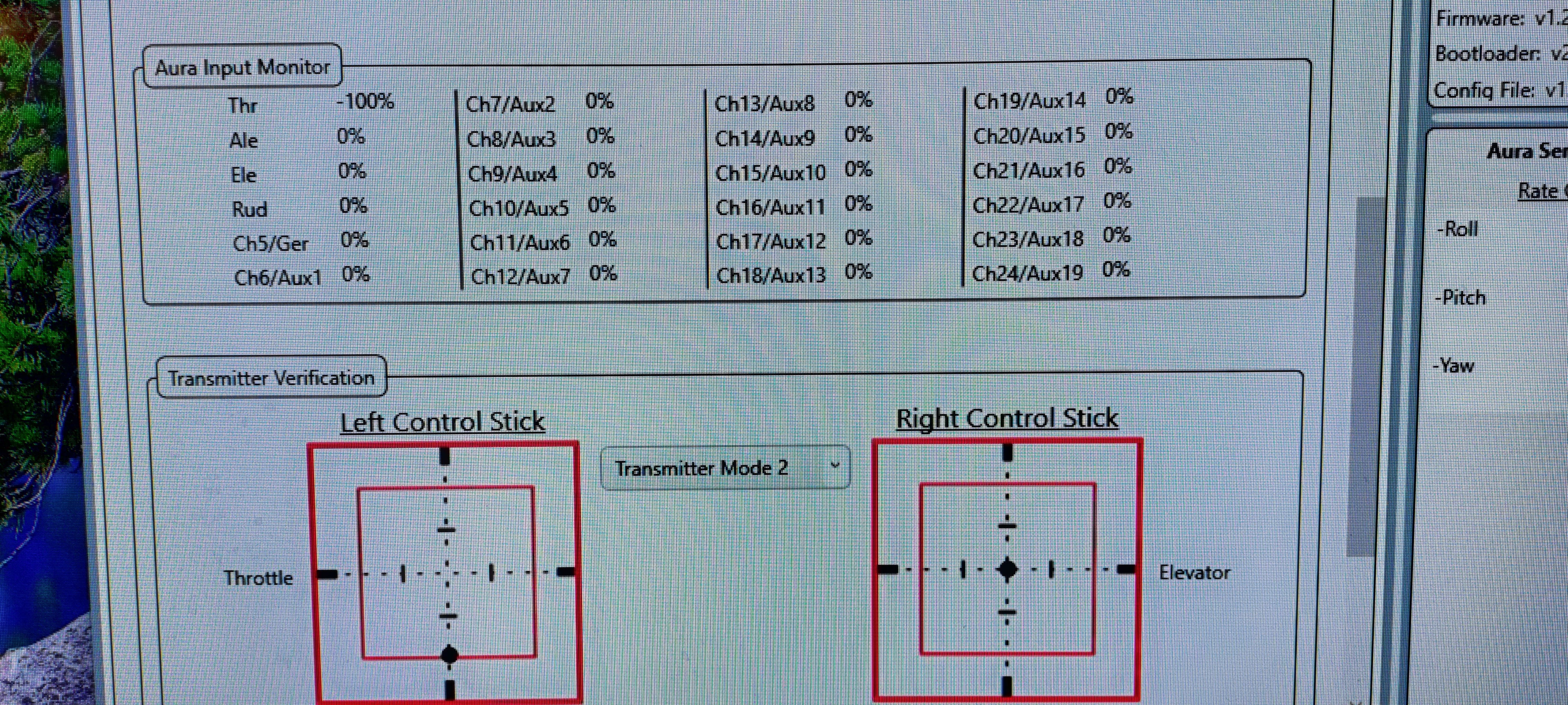

I just purchased an Aura 5 and am in the process of setting it up. I have a Spektrum DX6 on the latest firmware 2.11. I am using a SPM4650 SRLX2 serial micro receiver. I have bound the receiver, all servos work. I have the mode switch working, It changes in the aura config tool when I flip the switch. but the throttle does not work. I have the ESC plugged into port 1. When I plug in the battery the ESC only beeps once. I put a servo in place of the ESC and powered the aura through a different port and the servo moves to and holds at a certain position, but does not change when I move the throttle. In the Aura config tool it says throttle is disarmed and to re arm. I re arm till the cows come home but it never arms. I tried with the trim down and even changed the throttle servo output to 125%.
What am I doing wrong???
