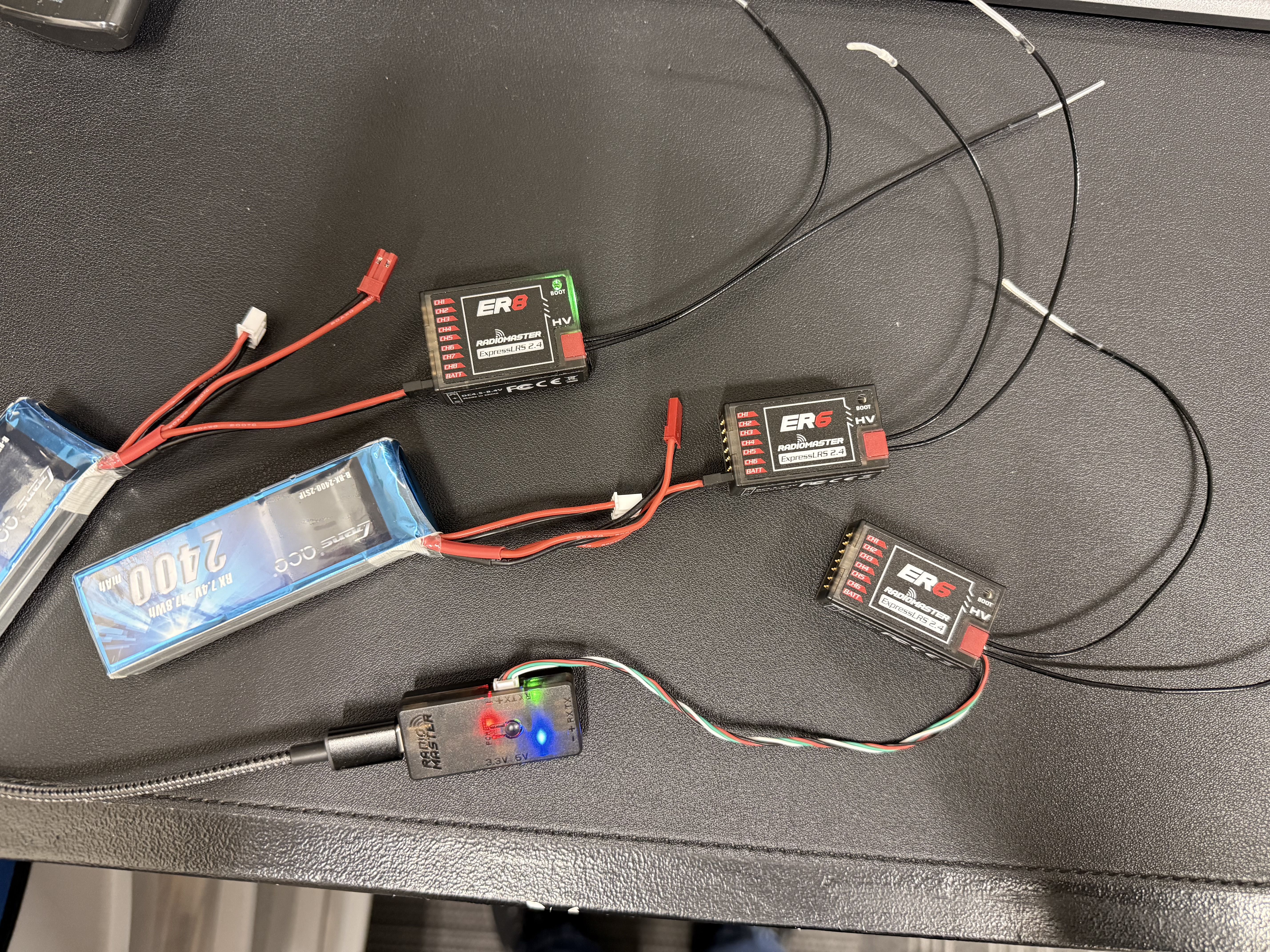

My Radiomaster USB UART Flasher V.2 finally came today. My ER6 RX is working again. Here is the story:
1. When I first got my ER6 I did a Wifi flash to 4.0 (the LED on the RX was working as expected)
2. After I cycled power on the RX there were no LEDs. The ER6 appeared dead. I could no longer see it as a wifi option on my laptop
3. I purchased the Radiomaster USB UART Flasher V.2
4. I followed the instructions on the YouTube video posted above by LitterBug using the 4 pin serial cable (ER6 has that option). It didn't seem to work. No LED showed on the ER6. ER6 appeared to be dead. (In the video it shows the light on the rx coming on, so I thought that is what had to happen when I used the UART Flash tool. I didn't realize that my rx had booted even though no rx light came on.)
5. I tried holding down BOOT button while powering on flash tool a few more times (desperation). Nothing changed.
5.5 I was feeling defeated at this point, but being stubborn I went on to step 6 just because.

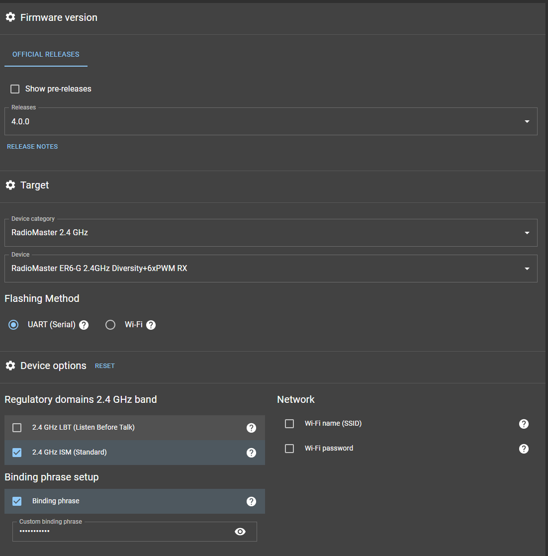

6. While my RX and Flash tool were connected to my computer I brought up the ExpressLRS Configurator, put in the proper settings and chose "UART (serial)" flashing method. To my surprise green and blue lights flashed in the UART Flash tool and the Configurator told me the update was successful. The ER6 still looked dead, but the lights in the flash tool and the message on the screen suggested that I had just successfully communicated with the ER6.
7. After scratching my head and wondering why it still seemed it wasn't wirelessly receiving I once again checked wifi connections on my phone and there it was -- "elrs receiver" (don't forget to wait a full minute). There were still no lights on the rx (still looks dead), but now I could log into it an do whatever I needed to do. My TX is bound to it and it's ready to go.
Note: I'm not sure if this is relevant, but the very first firmware up done wifi I had selected the wrong ER6 version. The box didn't tell me I had the ER6-G version. Perhaps that is what caused the initial bricking? I selected the wrong version when using the UART Flash tool, but it just told me Flash had failed. On a whim I correctly selected the G version the next try, and to my surprise, it was "successful."
