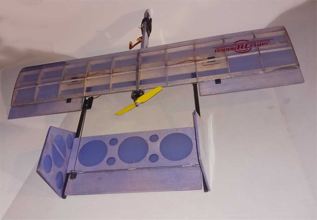

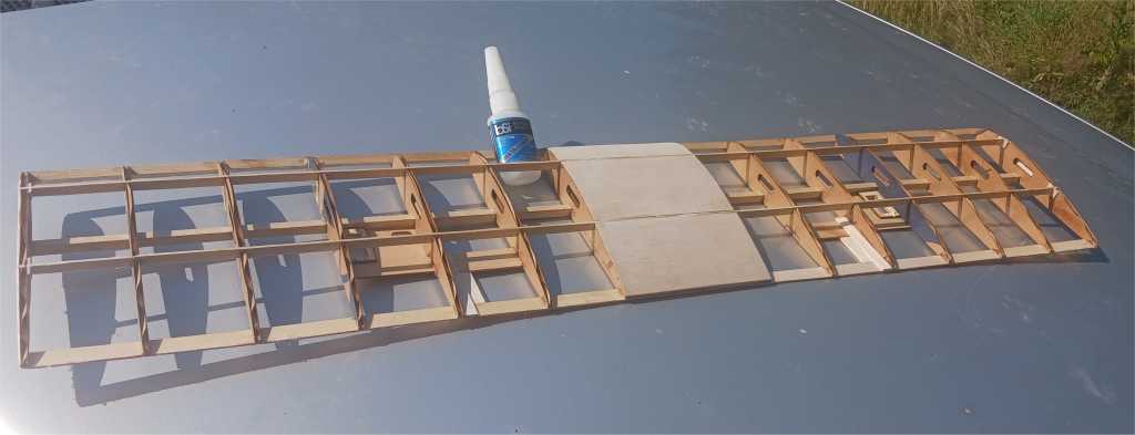

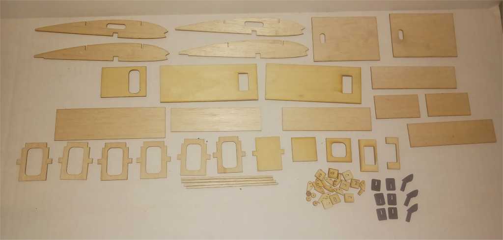

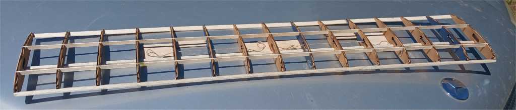

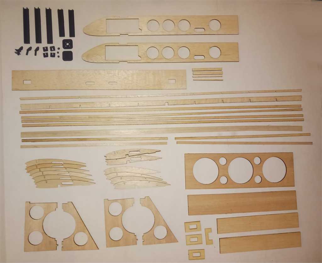

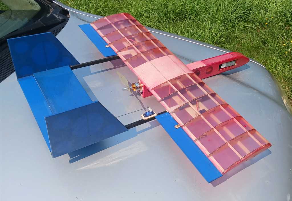

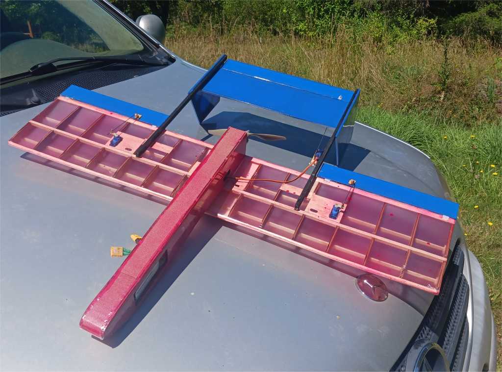

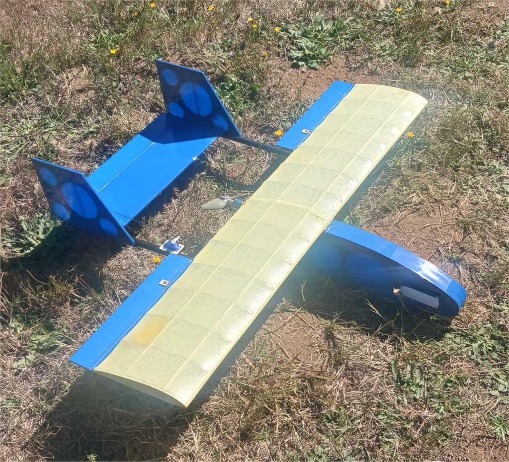

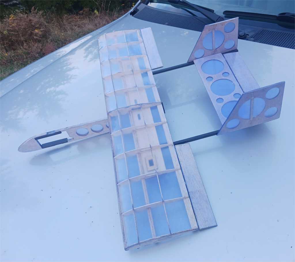

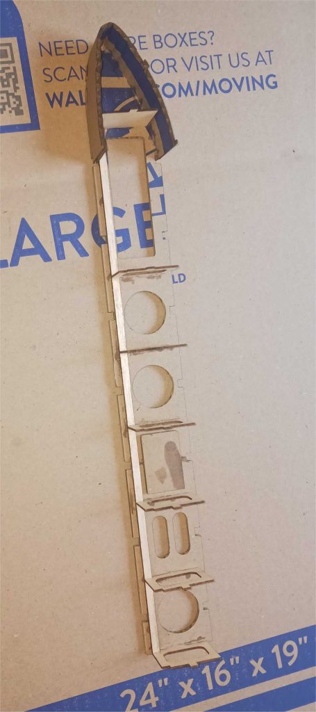

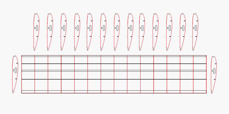

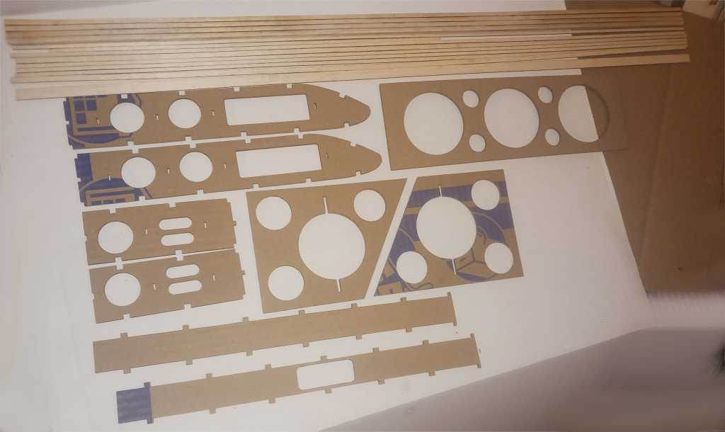

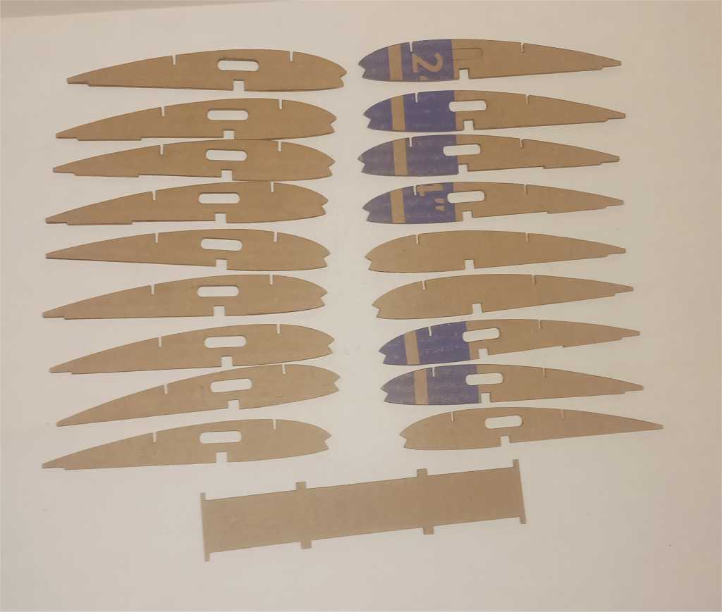

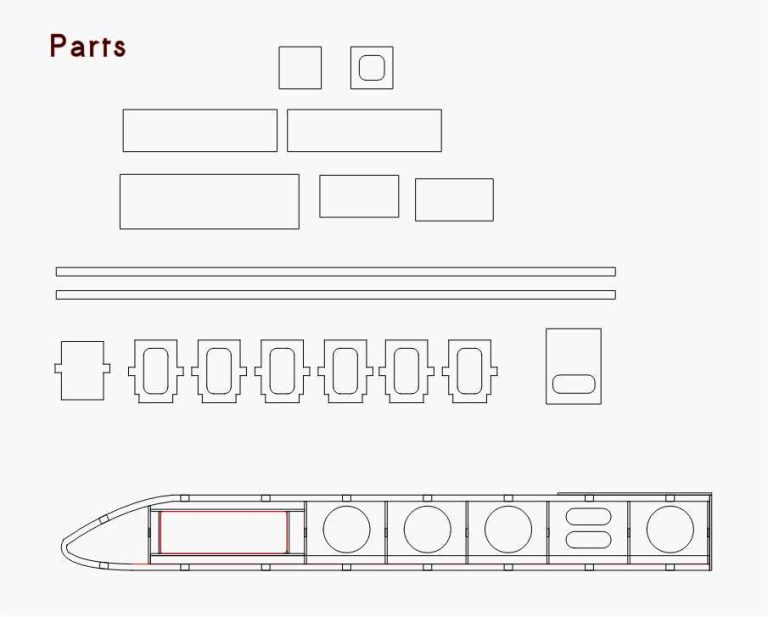

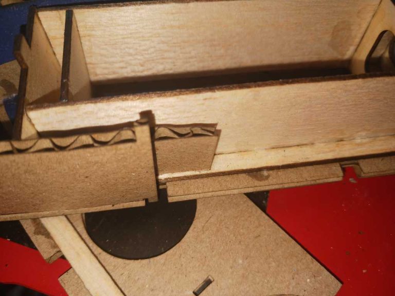

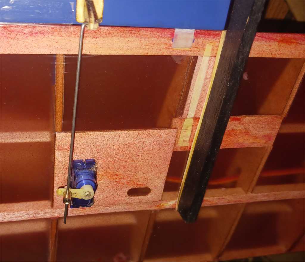

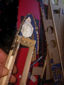

My experience with this design began a while ago and have built and flown several out of foam and also full balsa. They all flew well, predictably, even a brand new creation, scaled or in the different materials, it was always the same plane, the go-to reliable and easy enough to fly including into the winds within reason. I am sharing the starting point all of those years ago of which you are urged to bust out your own upon:

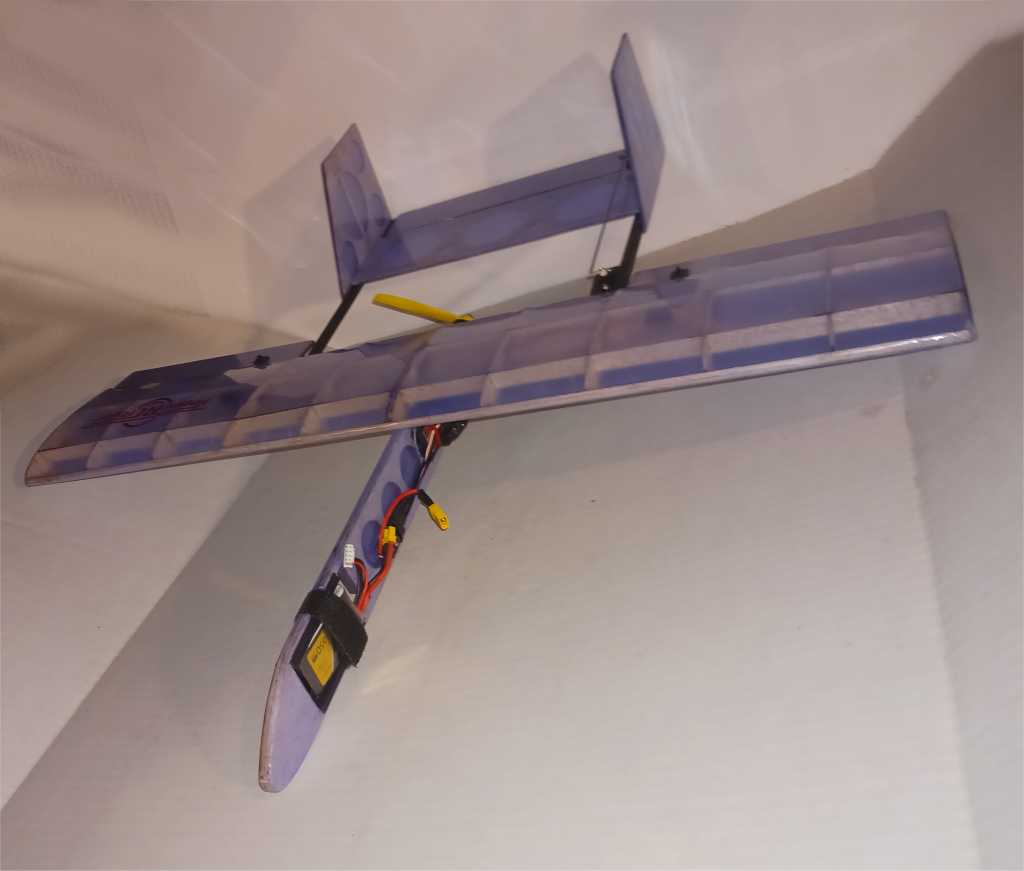

One of my latest versions of it is cardboard based with balsa and thin ply integrated along with. I also have a smaller version, full balsa profile format too.
The covering on it is a combination of Ultracoat Parklite for the opaque/blue and tinted Doculam for the rest.
I have and continue to build some sophisticated planes, lots more hours to build and more refined, this still is one I will bring along with regardless, it's just that kind of bird and I know regardless of what material you use and scale, you will fall in love with it too. My version/s take some creative liberty, so keep that in mind for those old school want to stick to the original format and plan purists for it's original design back in the day.
I do kit these, resell, etc., but it's a side business and it's a giant amount of time and nothing along profits are concerned to even talk about, you do it for the love of the hobby type of thing, ez to find me googling up Happy RC Flyer. One of our great people moderating here has a kit of it in his hands so prompting him into this post/new thread via private message and will be helping him along the way with his build upon.

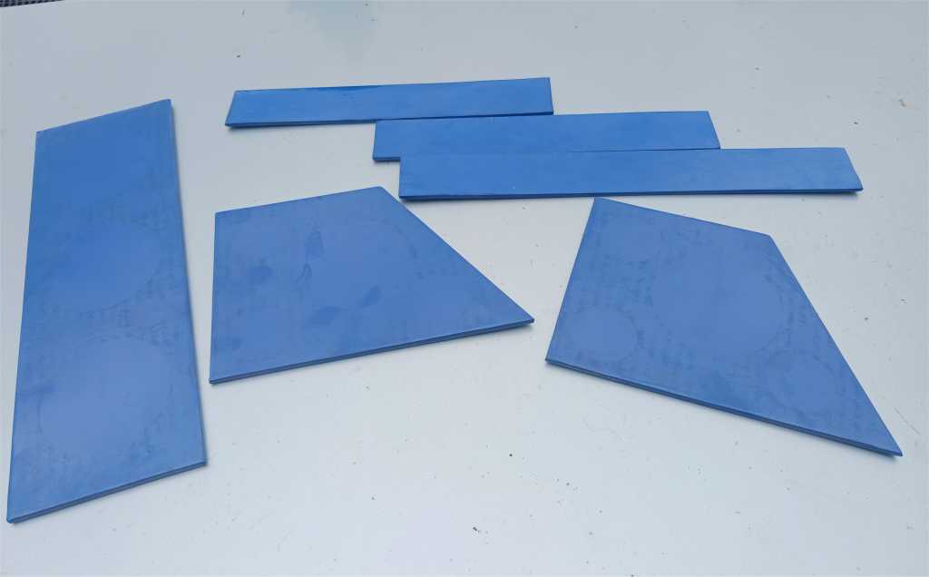

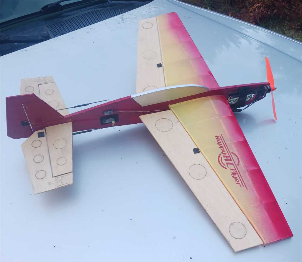

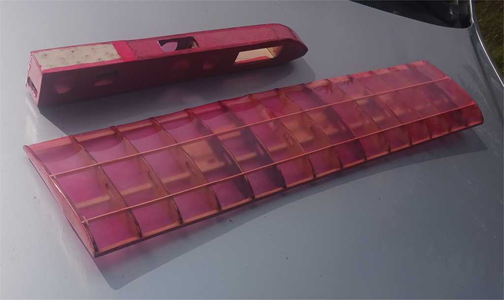

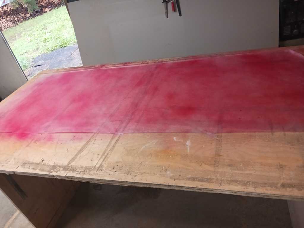

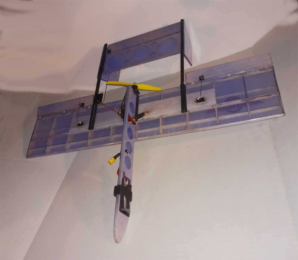

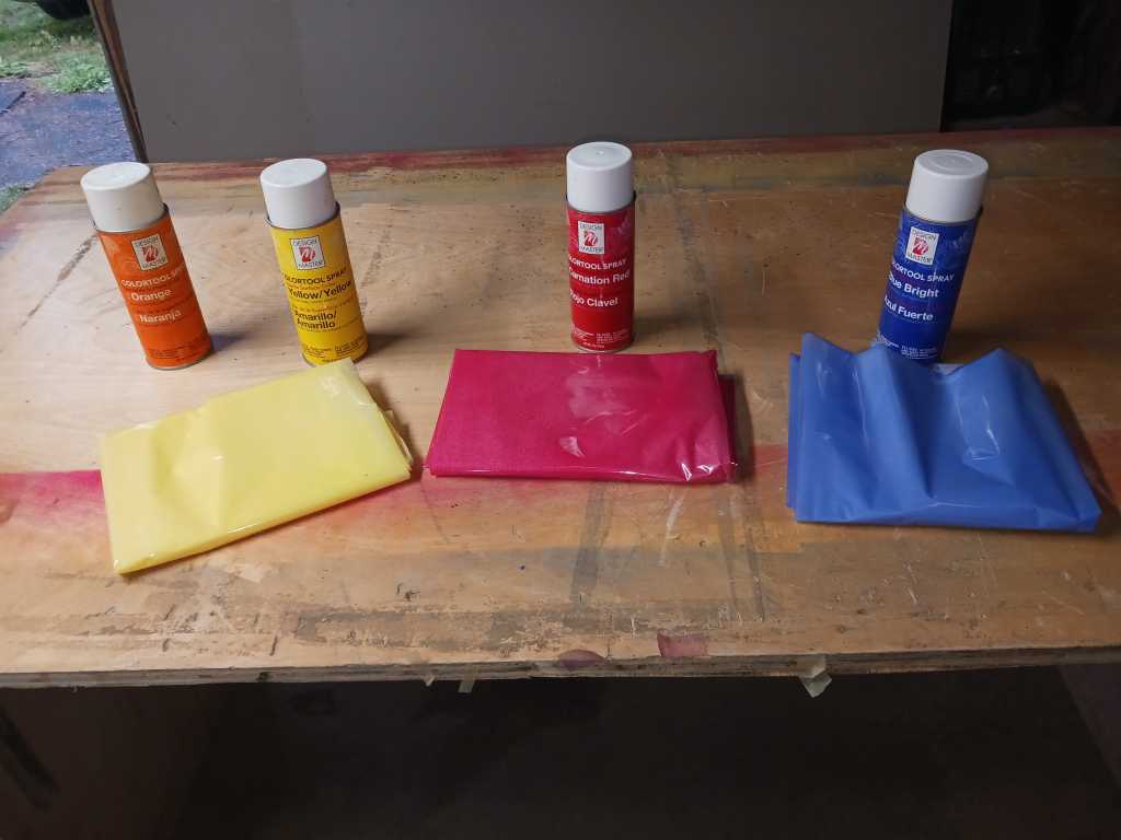

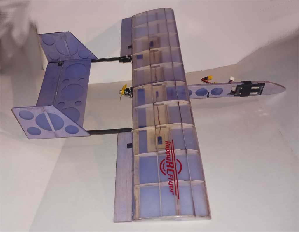

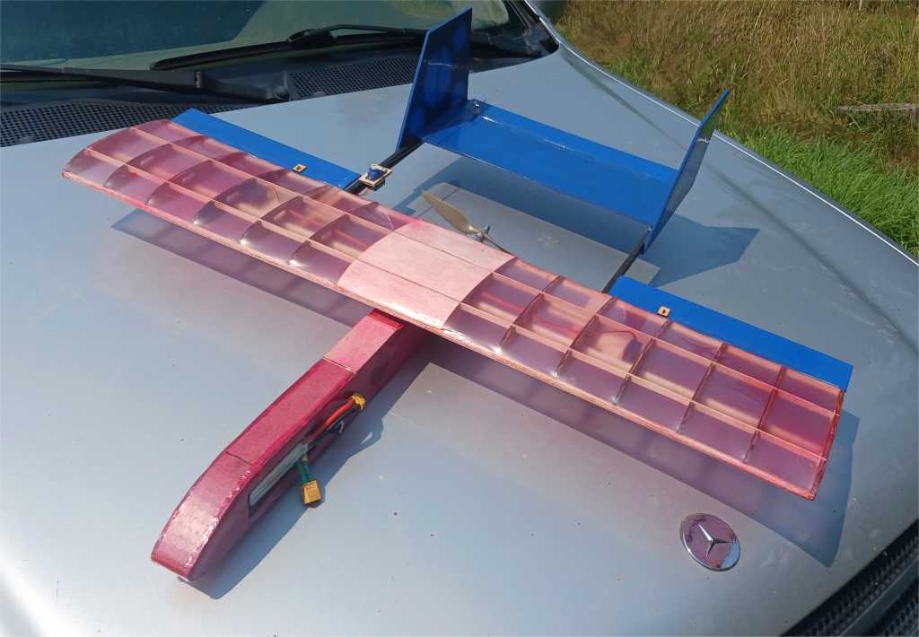

I use a specialty paint to give it color and spray it on, on the adhesive side. I'm sharing how it can be done up not just for tinting, but also opaque and in this case, something conventional coverings can't do, with the faded red and yellow theme. I supplement the process by applying glue stick to the surfaces it's going to adhere too, something helpful more so with the thicker applied coats like this. Just tinted though the adhesive doesn't have a problem doing it's job and it's nice that you don't have to worry about the paint scratching or flaking off from the surface.
You have plenty of extra Doculam to play around with and try out different paints and the rest upon.

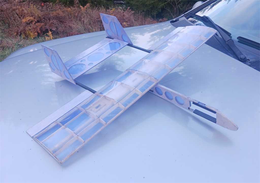

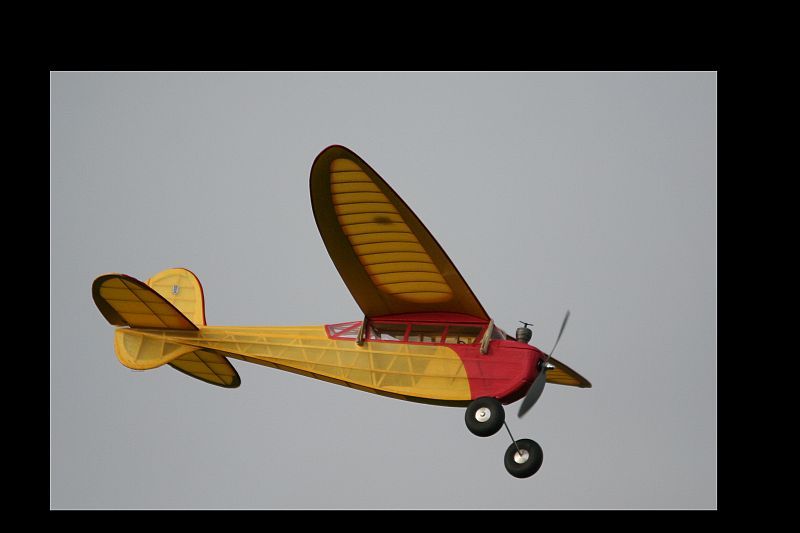

You can scuff up the outside of it and paint it that way too. I haven't tried it yet but the Doculam can be covered in tissue for a vintage type of look, shown in the attachement. I still like using just regular tissue from time to time, mainly out of nostalgia since that's what I grew up with using, it's also something I recommend for people to practice with since you can lay it down with glue stick and remove it afterwards. On one of the twin boom photo's it shows an earlier format I did with the rounded nose/fuse format, the wing was covered in dollar store tissue.
