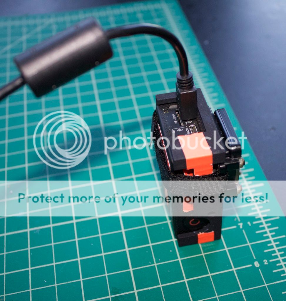

For my GoPro protection I drilled and dremeled out a spare waterproof case I had. I removed the buttons, made the holes bigger, removed any material that I didn't think was necessary, and I also removed the mounting tabs, door, and latch. The GoPro is held in with rubber bands. The I dont have a scale, so I cant compare the weight, but its been through many crashes and nothing has broken. If anyone is interested I can post some pictures.

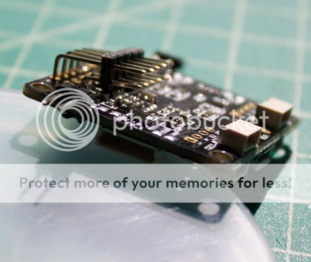

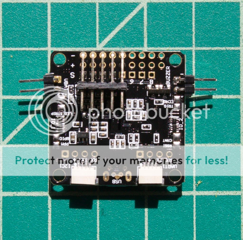

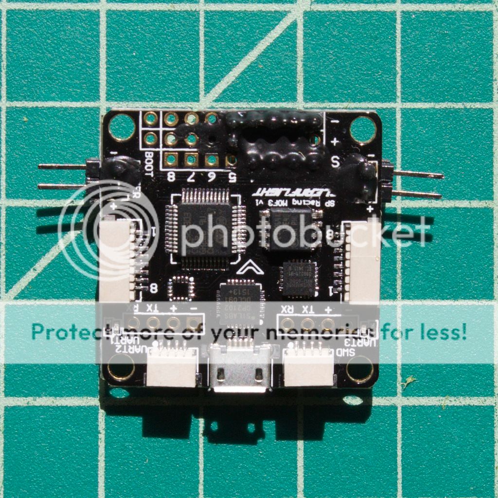

I'm going to try out the SP Racing F3 on this quad. Here's what it looks like after I soldered the pins on:
One thing that I don't like about this board is that all of the passives are on the bottom. They kind of get in the way of the pins if you attach them to the bottom of the board like I like to. I had to mount the pins at an angle.

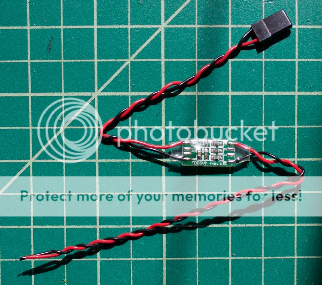

I'm switching to the X4R-SB receiver since the SPRF3 can handle the SBus signal natively. So far I have been unable to get SmartPort telemetry working on the SPRF3. I added a FrSky FBVS-01 to use instead.
I soldered the voltage sensor to the PDB on the quad and swapped out the wires going to the rx with ones that fit the telemetry connector (not pictured).

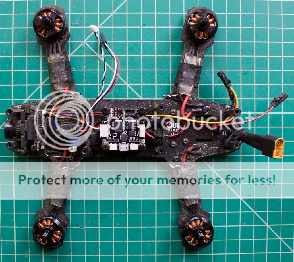

Here's what the quad looks like with the FC installed:
I had to update the firmware on the ESCs to version 14 of BLHeli to get OneShot to work with a looptime less than 1200. I'm currently running a looptime of 800. I don't have the tuning quite right, but here's how it flies so far:
