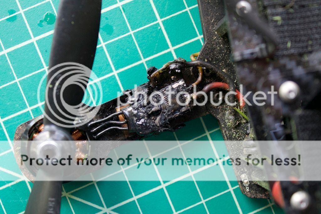

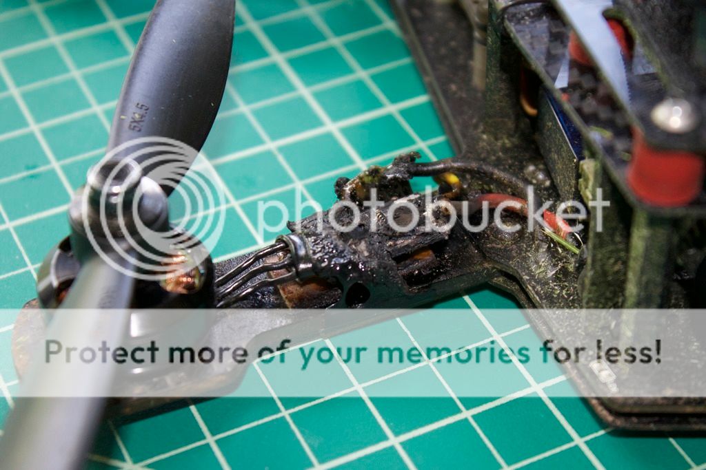

Ouch! Do you have any spares? Hope the motor is ok...
I have a couple spare ESCs. You can barely see it in the photo, but the coating on the wires in the motor is melted off in a few places. I'm probably going to put the 1960 KV motors back on.
C0d3M0nk3y
was it from a crash? or what happen.. fire yeah? did you see flame?
I crashed into some tall grass. I think the impact could have jostled a wire loose and shorted something out (less likely) or I didn't get off the throttle in time and the prop bogged down in the grass was more load than the ESC could handle (more likely). Yes, there were a surprising amount of flames. I was able to just blow them after I unplugged the battery though.

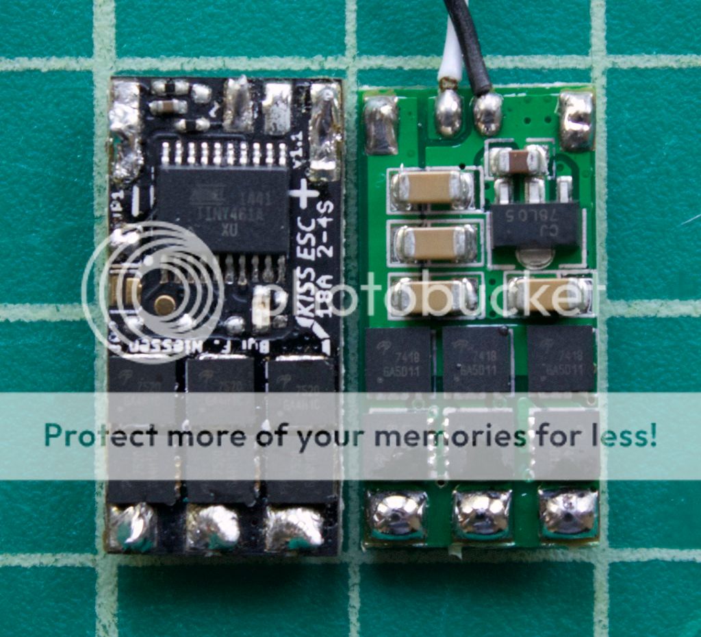

they look well made.. why did you have to flash the new ESC tho. they come with bheli already yeah?
chris,
narcolepticltd
I unbuild stuff regularly
Looks like slightly different fets... not that I know the difference and way too tired to research it. Let us know how you like them compared to KISS... always nice to see competition out there!
