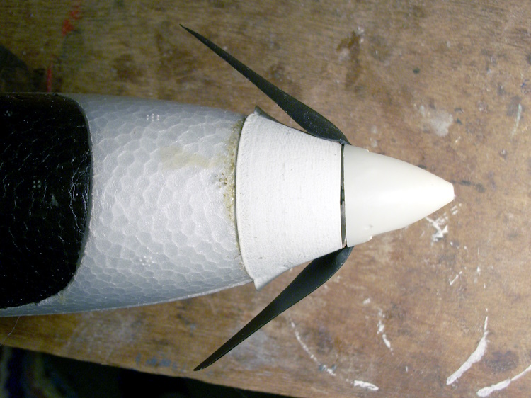

The FX707 is indeed a very nice plane just crying out for a neat power installation. It doesn't need to be any too powerful. It is after all a pretty efficient glider.
On mine I went to the ultimate and gave it a fully streamlined motor installation with a folding 5x3 prop.
The final modification was to add big flaps. Three settings 0, 20 and 40 degrees. All five servos are 3.7g.
344g with a 1500mAh 2s ,just 25g heavier than the original glider, it has a still air endurance of 27 minutes. If there is lift about there is no limit! Landing with 40 degree flap is interesting and very slow.

Nice job on the motor cowling and folding prop. 3d printer job? Mine is 350g including 800mA 3s. As you say, it looks like a very efficient design, and I could probably have got away with a smaller motor, but I had the BR1806 kicking around so used that. With luck I get to maiden on Wednesday weather permitting. Video should follow. I doubt if I'll be soaring at that location though. Maybe!
